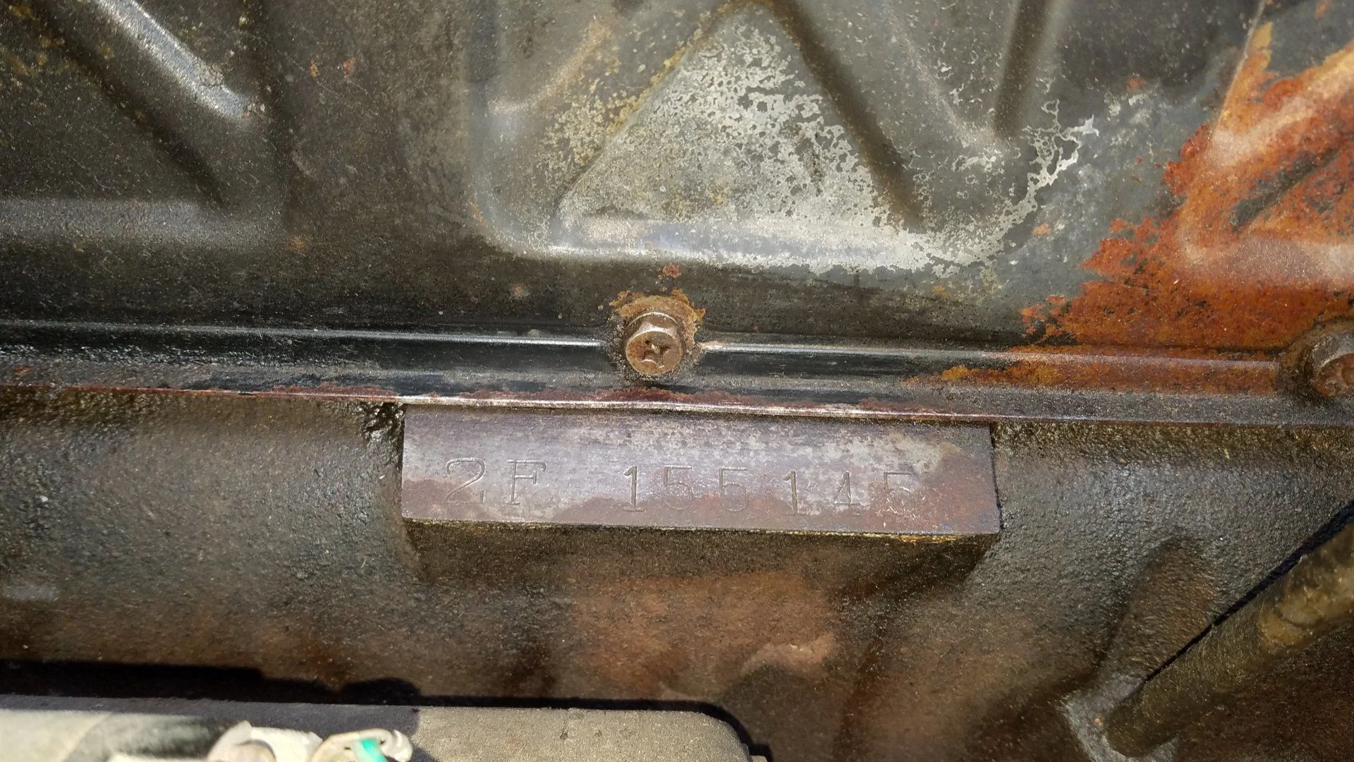

My '77 is a March built NA vehicle, serial is 219344. Engine number is 2F 155 145....any clues as to if it's period correct or original ? I was told it was the original motor, but don't totally trust the previous owner who was just flipping it for a profit. Engine runs really strong, I almost suspect it's either been rebuilt or has very low miles - or just lucky.

After 1964, they stopped stamping the data plate win the engine serial number. You can get a good idea based on production date and the info on this forum and SOR website, but there’s no certainty in it. Because of that, collectors don’t twally seem to care with these trucks. It’s not like the muscle car world.

I knew at one time they engraved the plates with the engine serial, didn't realized it was stopped that early in production years. I was just curious more than anything, otherwise the engine appears to be original to the vehicle, which is good. Doesn't ever appear to have had the head off, either, odd.

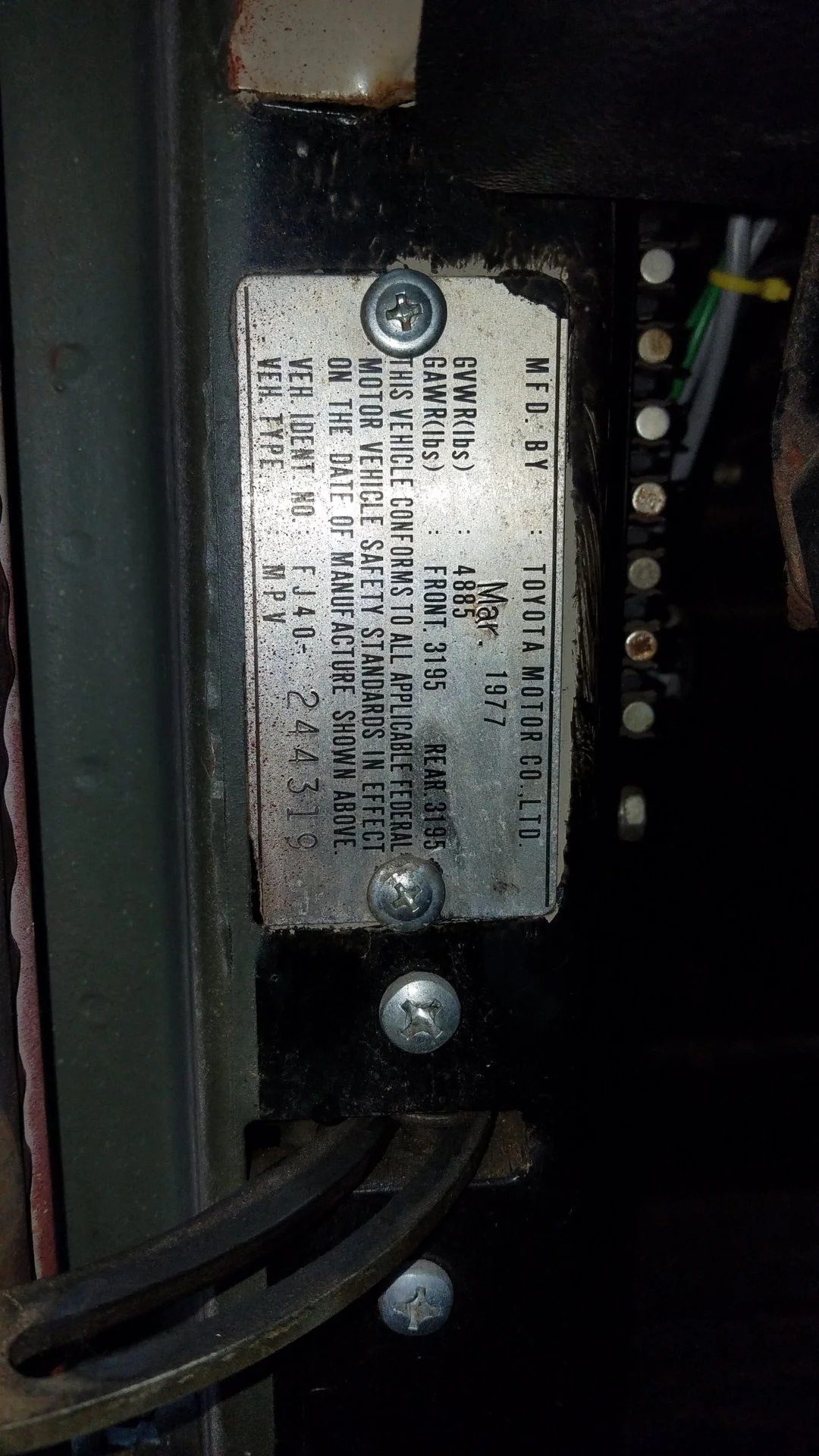

Build date on the truck is 03/77...? At least that's what the main tag says on the door jamb.

I'll grab a photo of that VIN plate from the door jamb, this is really bugging me.

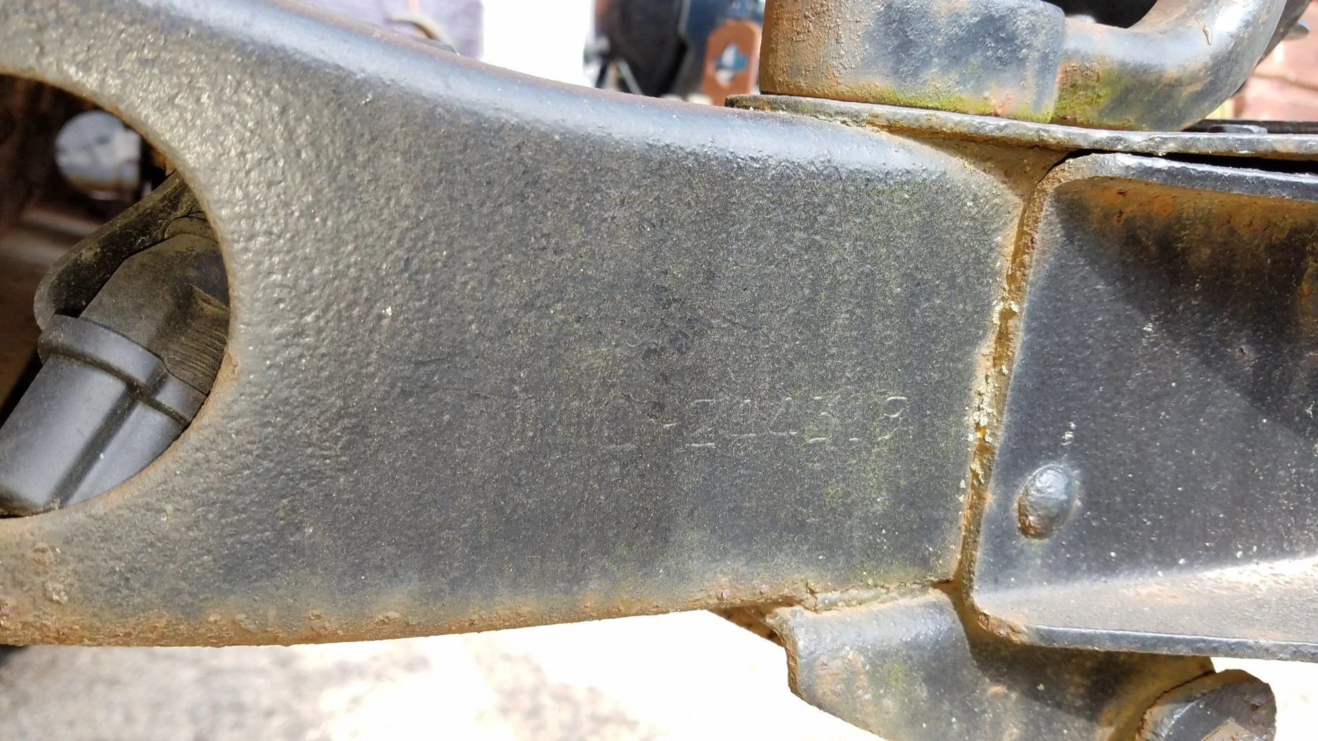

Well, something is off in the information, either the data base or this particular truck. Door jamb VIN tag matches to the frame serial - all the same.

You original post is off :)
You posted 219344
Tag says 244319 tag is correct for 3/77
But it’s ok because I read your engine number wrong .... I thought I read 115xxx but... the number you posted 155xxx is correct for the time frame and looks to be original
One thing for sure, the door jam tag is screwed into it and all were originally riveted. So, someone was doing something.
Since the frame number and door data plate have matching numbers, my guess is that someone did a tub replacement at one time and swapped the vin plate onto the donor tub. That is why they screwed it on. I would be more concerned if the frame number did not match. People are always swapping bodies on these cruisers. I would rivet the plate back on though just so it looks more original.
You're right - I pulled the number out of my head and that was obviously a mistake, lol - glad that got solved. I noticed the screws when I bought it and brought that up with the seller - he claimed it was pulled off during the paint work, but the black paint obviously goes around the tag, looks like it was just masked off - albeit sloppy at best.
