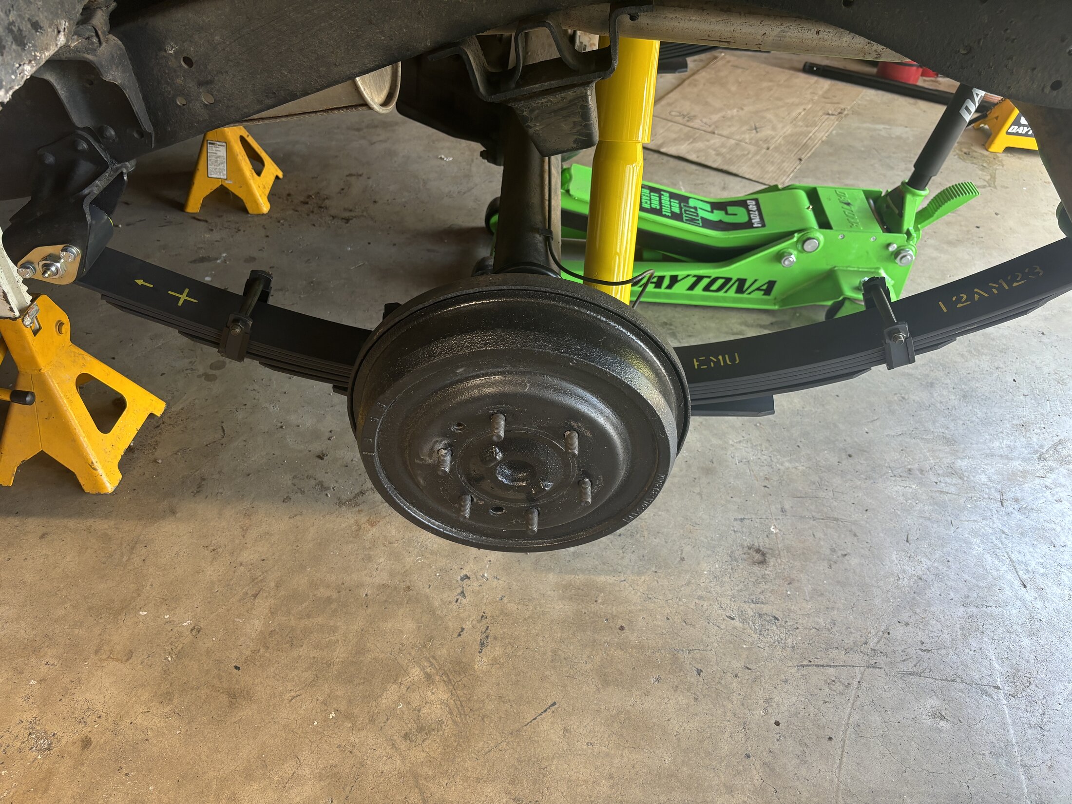

Everything arrived yesterday. Today was day one of removing the rear springs. I got a late start and summer has returned to Texas, so there is a mix of sweat and PB Blaster on the floor, lots of rust and dirt mixed in. I was able to get the rear shackles off with some hammer and punch persuasion. The fixed ends are a different story. They are very difficult to shift. The pins are rusted inside the dried bushings. I blasted everything with penetrating oil and decided to call it a night. Tomorrow's another day.

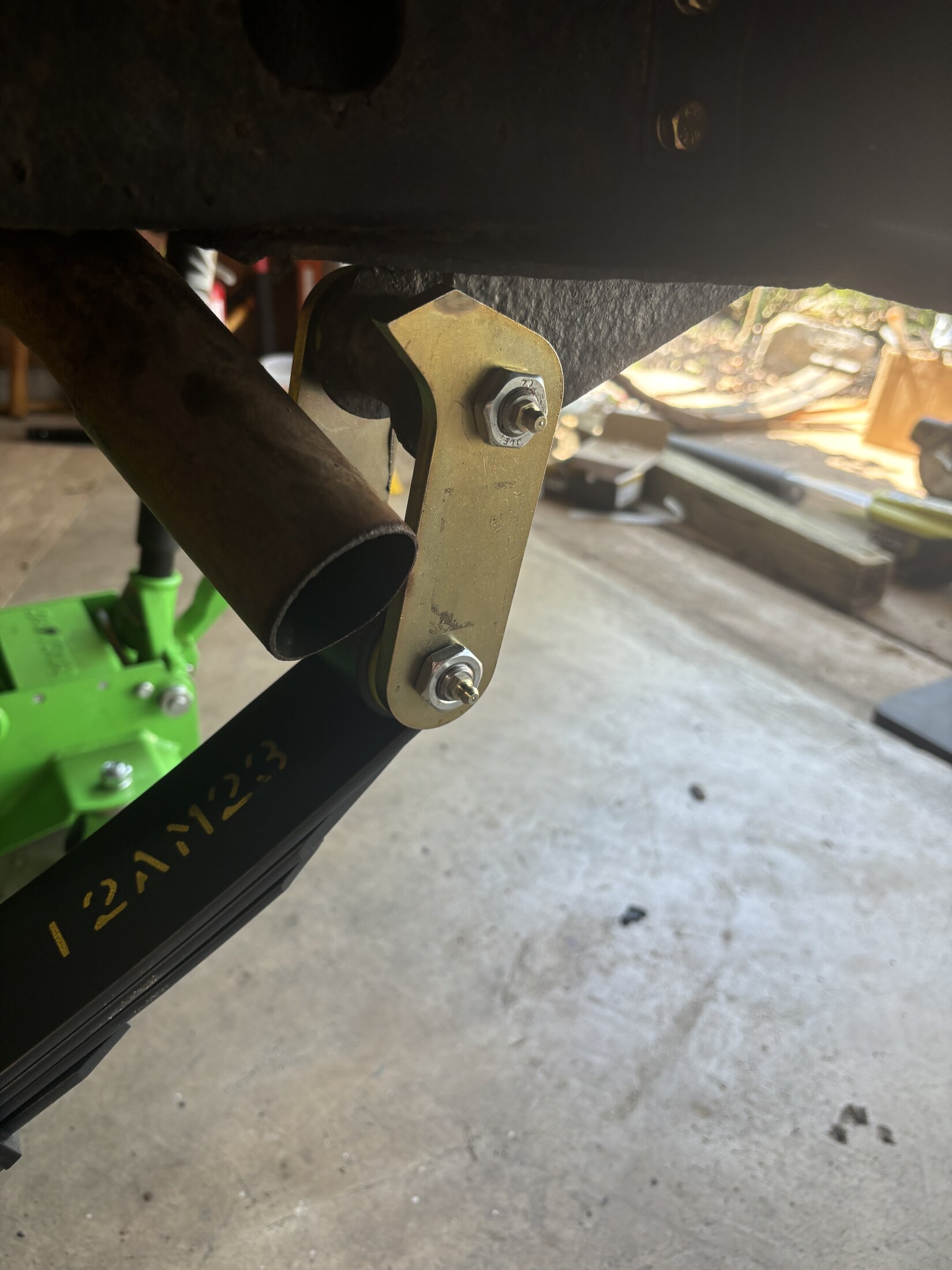

I finished up the rear end and started on the front. One issue I encountered is the driver's side upper shock mount is stripped. Apparently by the PO. All the rest were 12mm castle nuts and this one is now 10mm and stripped. I'll need to figure out how to get a die on it up under the chassis. I went ahead and mounted everything so I could show you all the progress and get an inspection. I think I have everything oriented the right way, let me know if I missed a detail. These are the driver's side, passenger side is a mirror.
I am super excited, the ride height in back is significantly better.

Thanks! I am amazed at how complete this kit is. The only parts that I have to go hunt for now are replacement washers and castle nuts for the shock installation. My shock mount hardware was toast. I was planning on getting some stainless fender washers unless someone says that I really need those $3 curved washers... :)

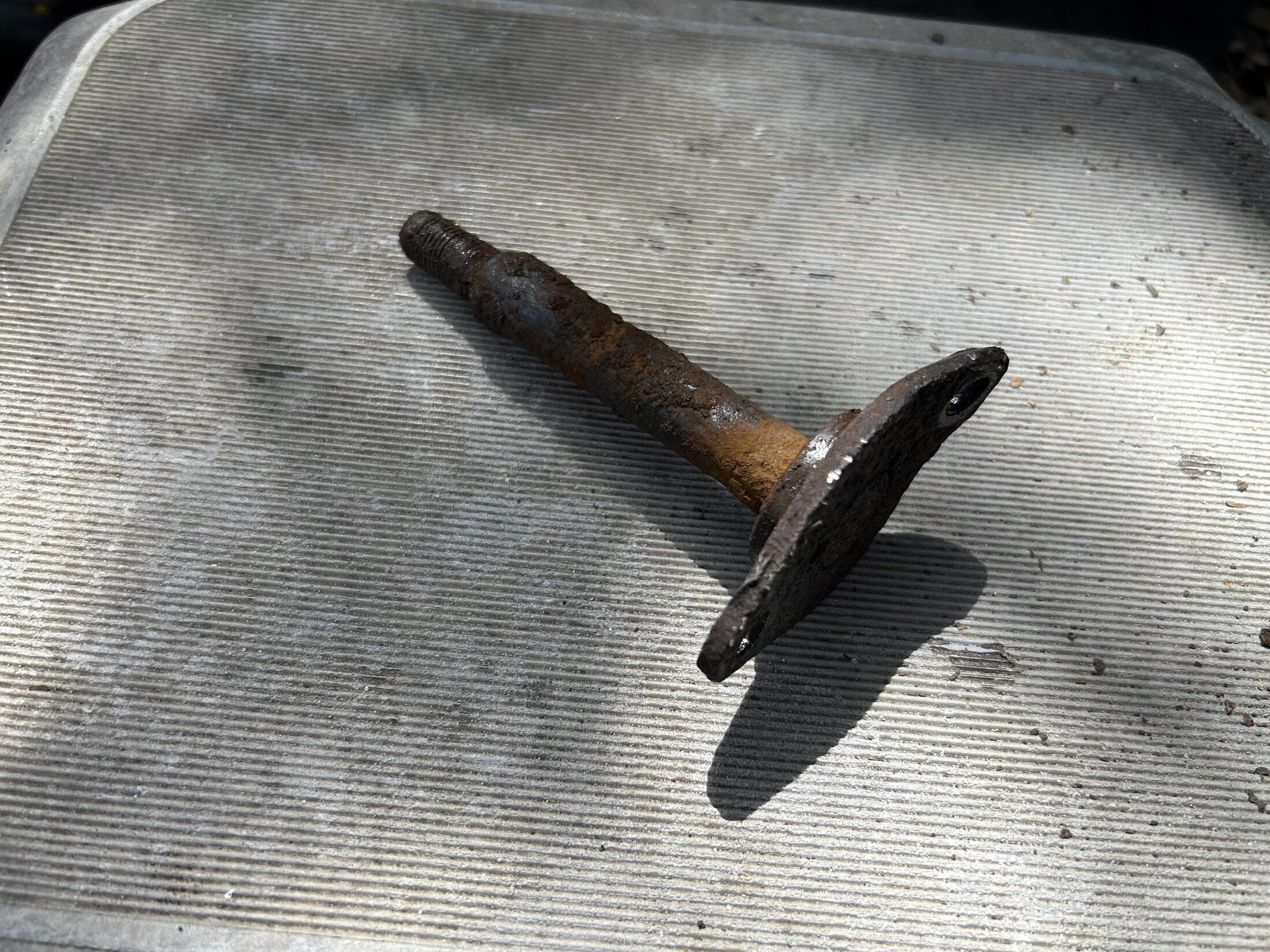

Round outer dies are for cutting threads, octagonal/hexagonal are for chasing threads - usually.
On mine it looks like the "bolt" is welded in. Center punch the dimple, drill it out, install new bolt and weld it in

One more spring to go.
Mine looks the same. I didn't know about the thread chasing dies, I'll have a look.
I am going to try and fix it in place for now. Replacing it will have to wait 'till I take the body off (and learn to weld.) :)

Ran into another issue on the front passenger shock mount. The front shocks did come with replacement hardware, unlike the rears, but the threads required to get the castle nut started just aren't there, So I got it "good enough" to move it back into place while I order new castle nuts all around.
