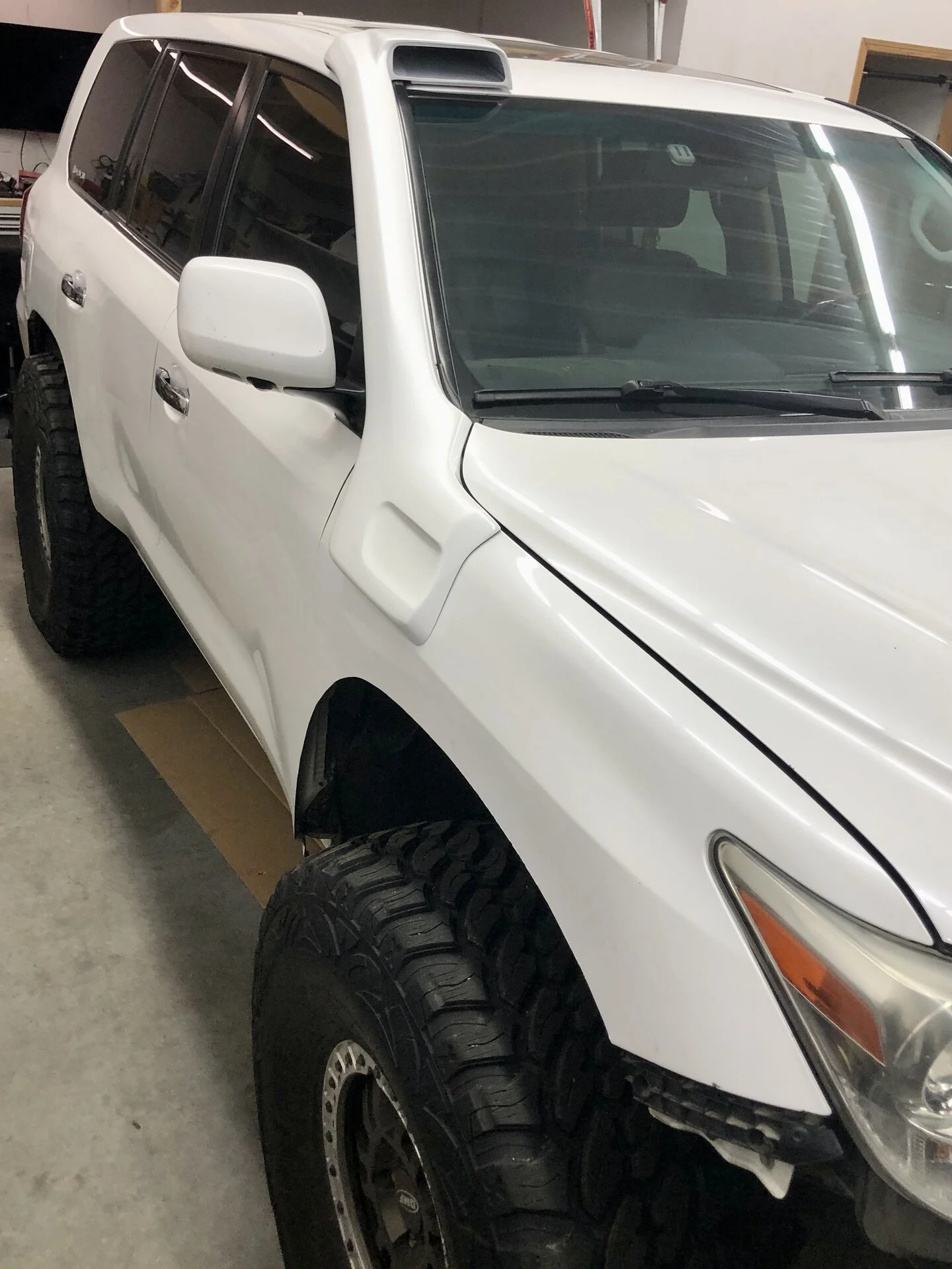

Anyone going down this road would want to make sure to get the specific model for either a LC or LX. They are not the same and won’t fit the fender contour well if they’re the wrong part.
Also, the installation isn’t straight forward, or plug & play. As has been mentioned before, the inner fender tubes don’t fit perfectly and I had to cut the inner tubes shorter and trim the factory plastic tube that goes from the engine to the inner fender. Have to be a little resourceful to make it work.
This is the proper one on my LX…

So, my primary motivation was the look, to be honest. I had taken both my 80 and 100 through water deep enough to be a concern w/o a snorkel, then after installing snorkels on both of those rigs, I never found myself in deep enough water to need them. Now on 40’s, I doubt I will ever be in deep enough water to need it, but I do like the look enough to have justified the cost and installation.
I think my first one took a couple months to arrive after ordering right when the war started. Then the second one, there was a shipping mix up and it took at least that long. I think they are able to arrive much more quickly, but it didn’t happen for me. And no, I didn’t pay for expedited shipping.

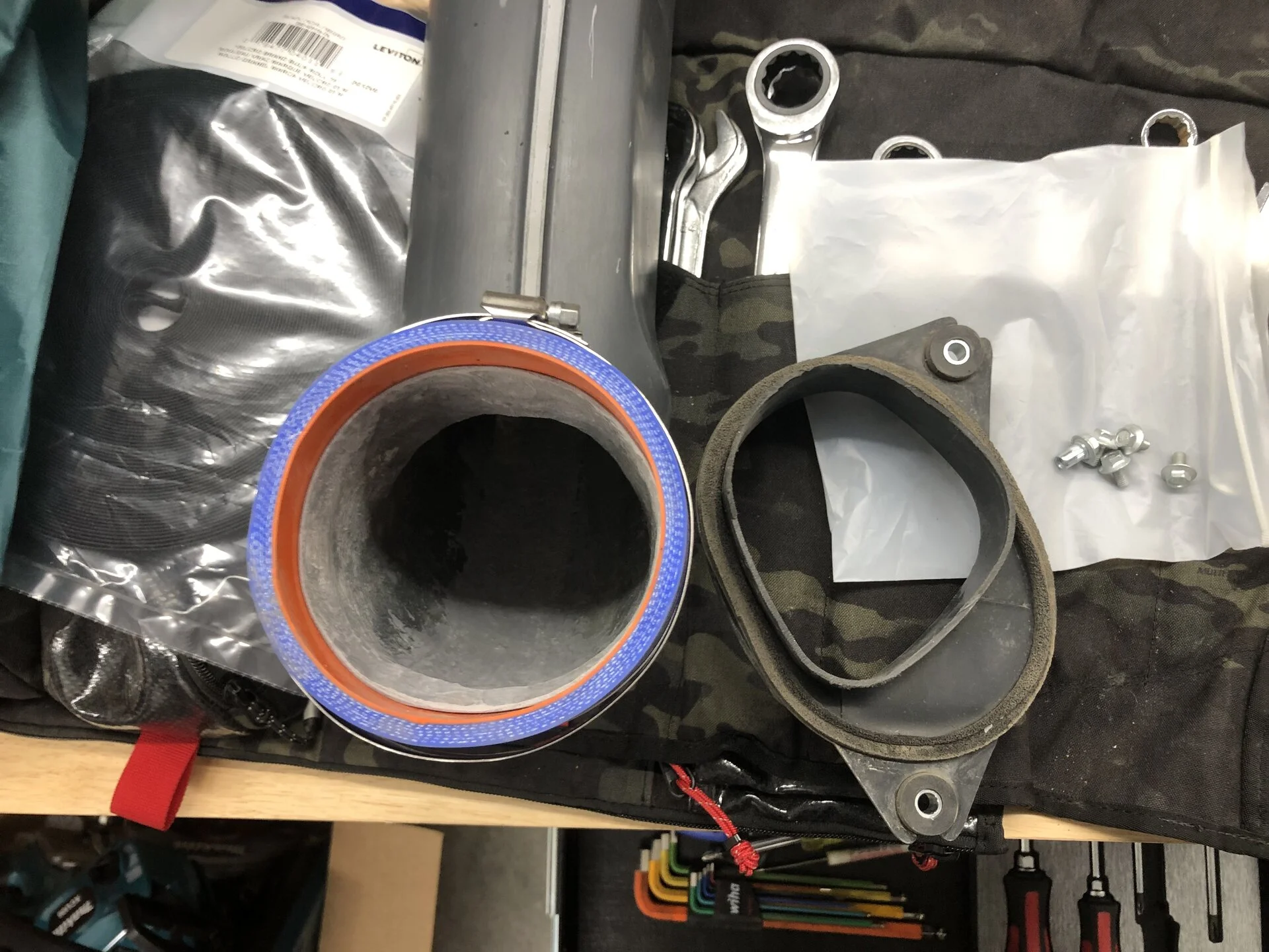

I didn’t document the install, but I’m always happy to answer any questions. The plastic OEM tube that extends through the inner fender isn’t round, and the tube and silicone gasket is round, so it’s a lot of work. I trimmed back the OEM tube and you can place the silicone gasket on that first, then the Mons part can slide into that, with a lot of frustration and no room to wiggle it around.
Then you’ll find (or at least I did) the two fiberglass tubes are too long to properly fit together. So off to cut, trim and slot those. I haven’t completely finished installing yet but I can admit it isn’t perfectly sealed up watertight in my opinion. You can probably make it watertight with some RTV (which I think someone else mentioned doing this) or similar sealant. There is also a rubber water drain on the bottom of the first inner fender part that doesn’t look like it would open easily but just isn’t exactly watertight either.
That said, I would still do it again 🤦🏻‍♂️
