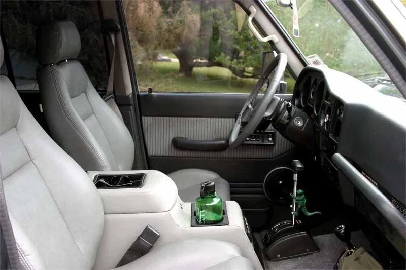

Procars in a FJ62 (my old truck)
attachment.php
What center console is this? ^^^

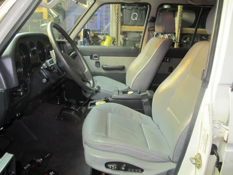

Tor @ Torfab did some BMW seats that look AMAZING! Stealing/consolidating threads here a bit...
Leather, heated, power, and supposed to be lower than the volvo equivalents. I'm tall so that's important to me.
My stock seats are in great shape (in the 84), covered to stay that way... but these are really tempting!
attachment.php
from his thread here.
:princess: is always cold, so i usually cook until she warms up... seat heaters to the rescue (hopefully). Getting warm after playing in the snow without waiting for the truck to blow hot air... another bonus. And ability to lower the back and raise the front of the seat bottom to support long legs. VERY tempting...
any more info on how he got them to fit? the price for that console is amazing! I have a friend that can do the brackets, but any insight as to what he did would be great

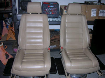

Subaru seats
These were my sunday project. I think they are from a 99 or 2000 subaru legacy. I picked them up on C.L. for $120. Rather straight forward install. I used cruiser slider assembly. The passenger seat required me to build a frame underneath. The driver only required a 3" piece of steel and flipping of the subaru bracket.. The mounting points on the seats were wider and longer than the originals. I picked up the rear seat as well. That will be more difficult to adapt. Not entirely sure I will use it yet. The 60/40 split backseat would be nice.. I just need to wire up the heated seat grids and I will be in buisness. The funny thing is that Outback is imprinted in the seat back. And they match the interior perfectly.
