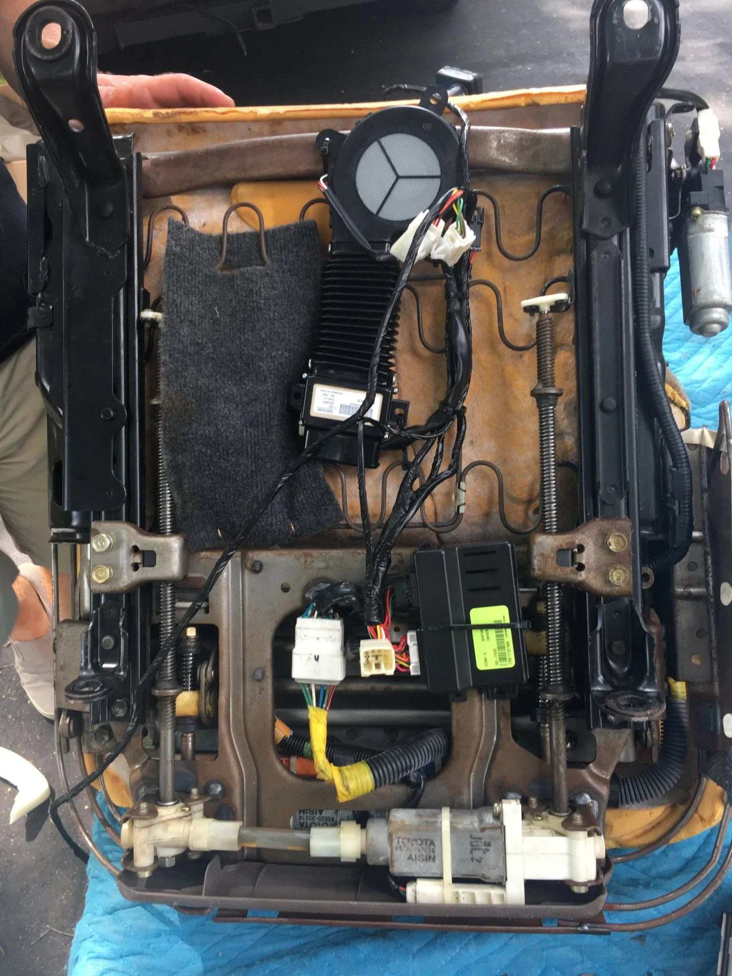

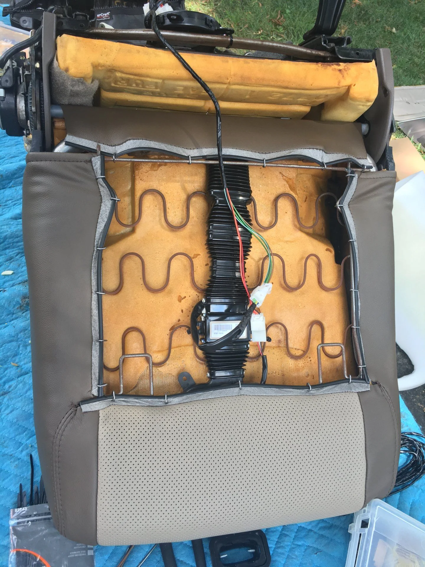

Ducting for the seat back:
Ducting for the seat bottom:

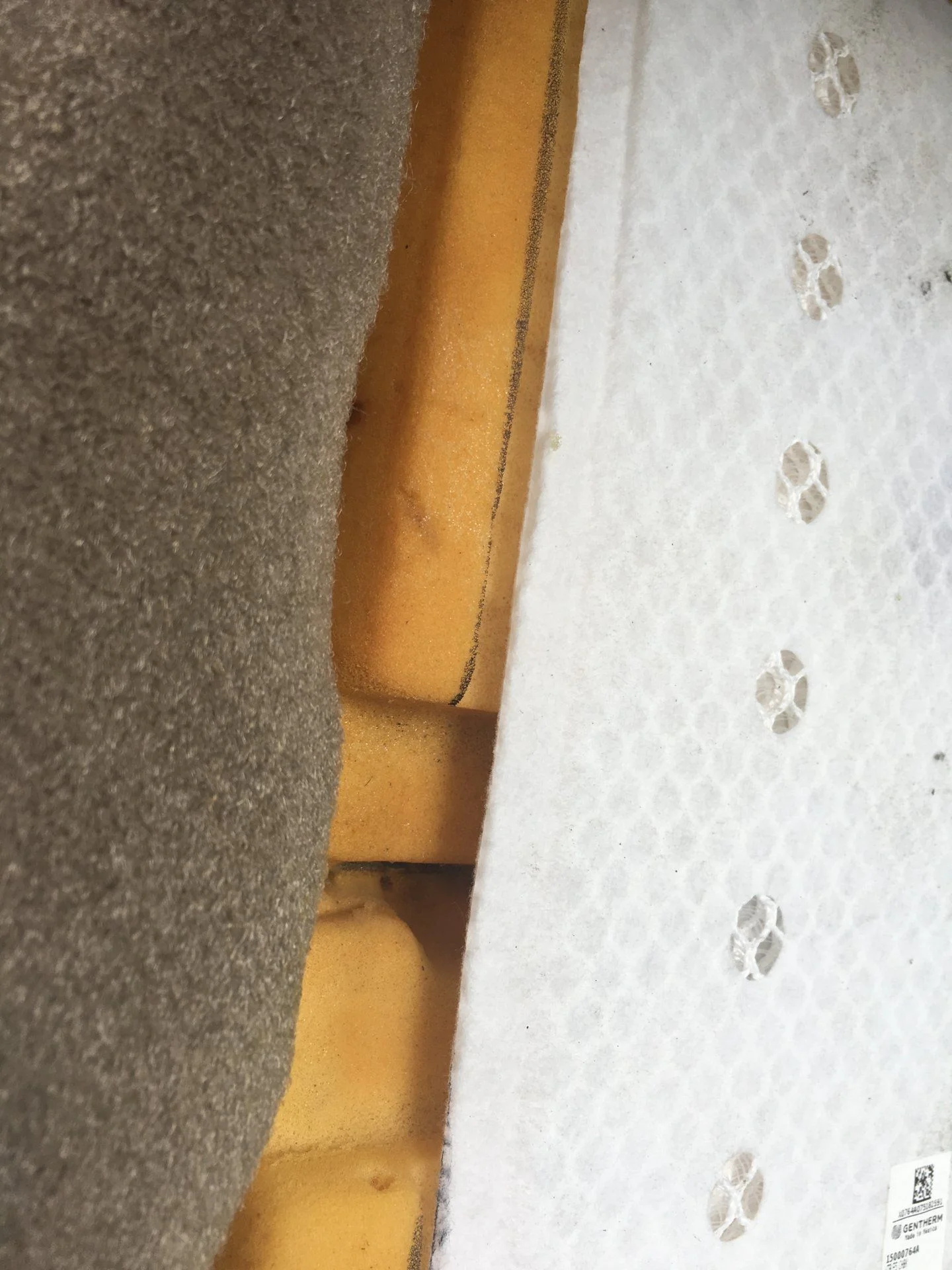

The computer is just held in place right now - final placement will be chosen to ensure it clears the rear heater that sits under the passenger seat.

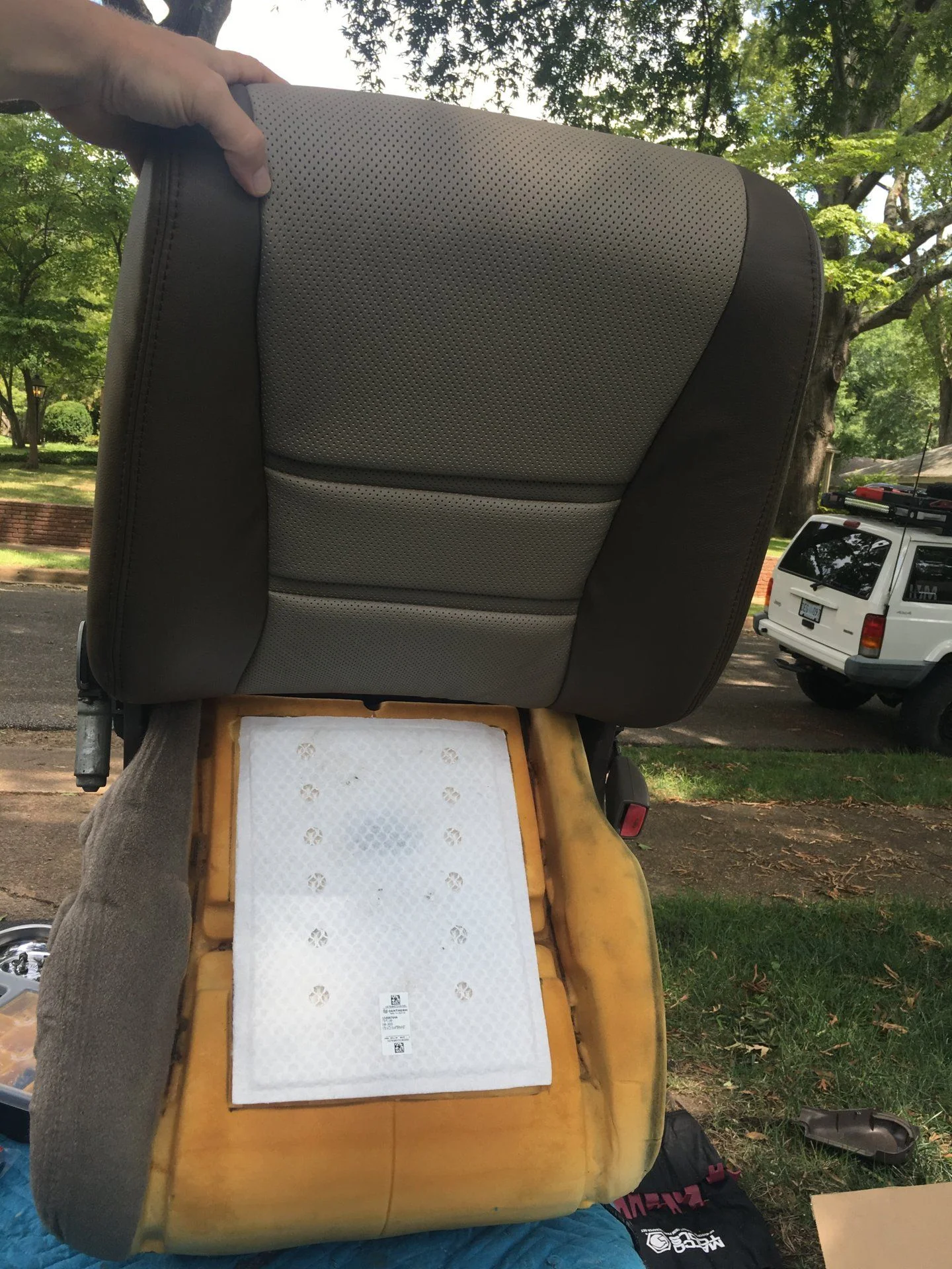

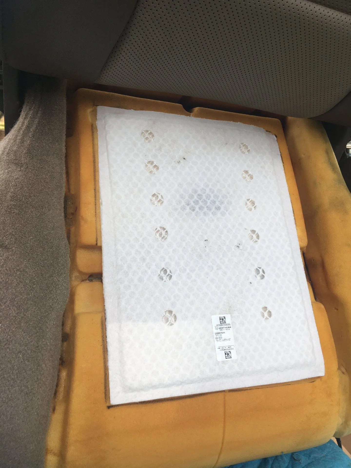

The distribution pads are recessed into the foam so that they are not seen or felt. The easiest way is to slice the foam to depth with a razor blade in strips or cross-cross pattern, and remove the pieces.
Result:

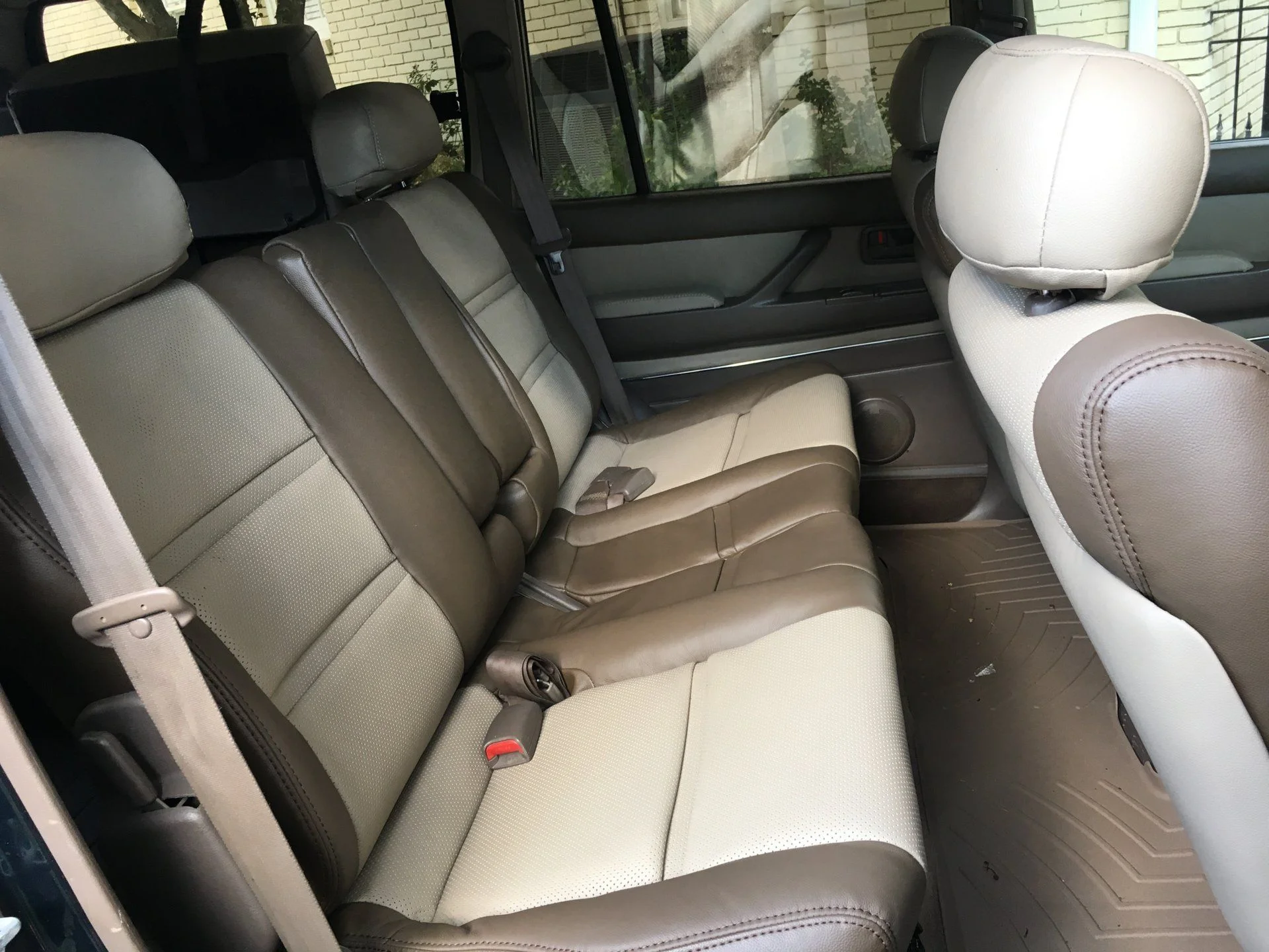

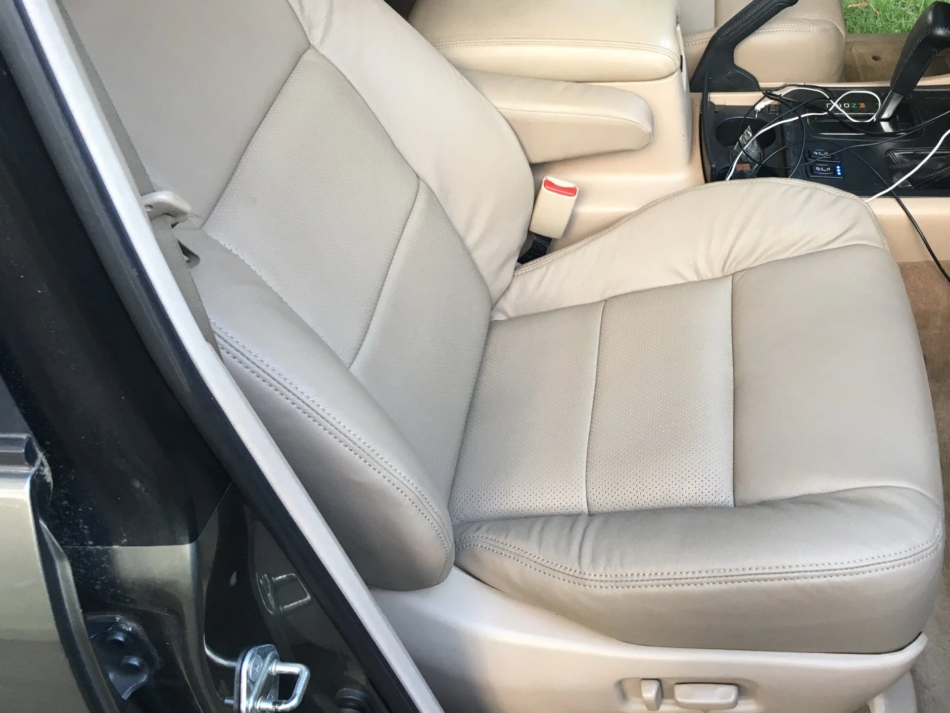

A full 2 row leather install with the coolers has taken my guy a full day, around 10-12 hours depending on what kinds of issues he runs into. Keep that in mind if you plan on tackling this yourself. He mainly does new car installs for dealers, which I’m sure go smoother.
He did get all of the seats in the first day, but had to come back to do the door panels. These kits come with the lighter colored door panels, and this truck’s upper dark brown pieces had holes in the ends, so he recovered those with new brown vinyl and swapped the panels.
If your doors are fine, I would highly recommend just replacing the armrests and leave the rest alone.

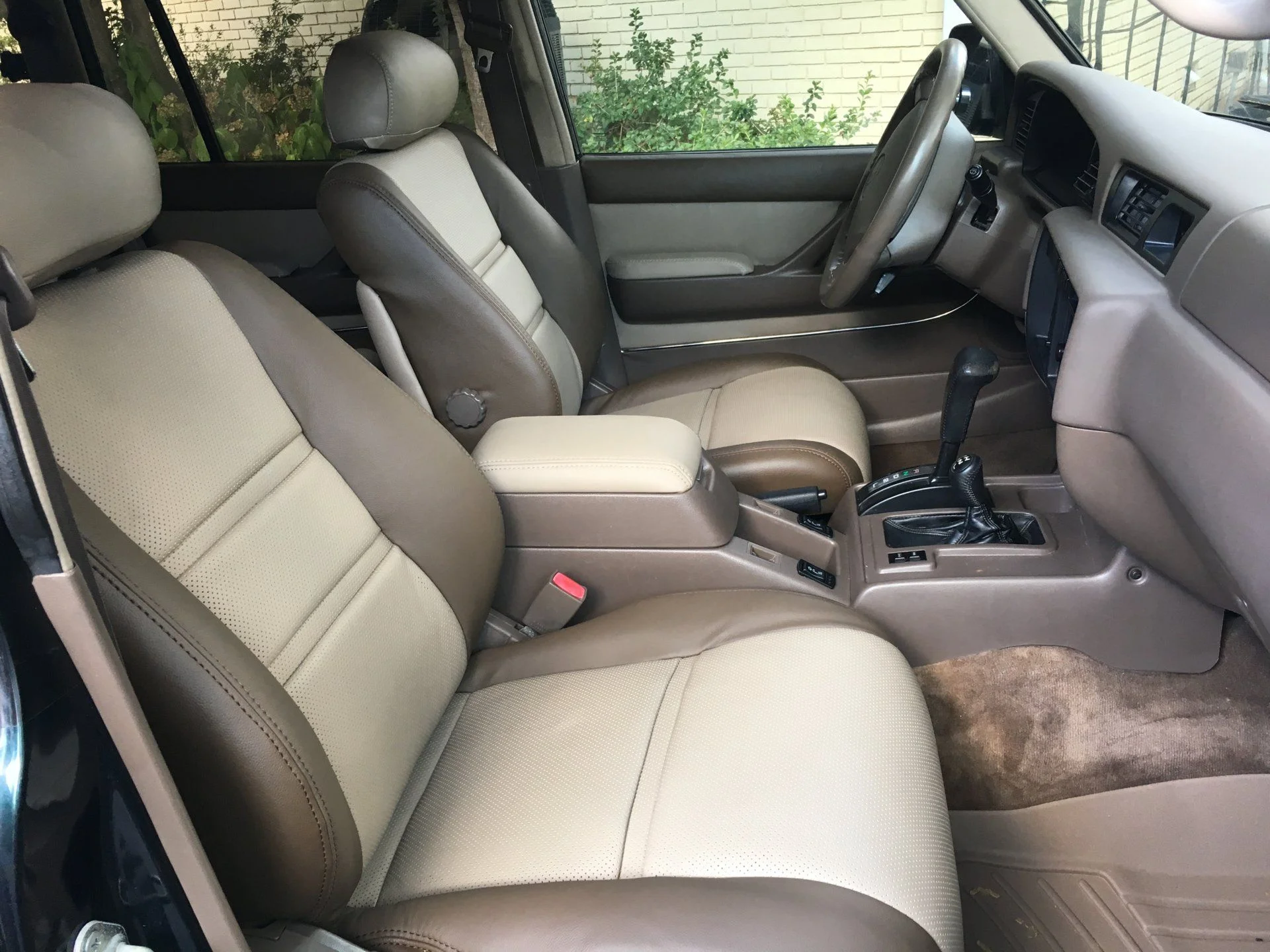

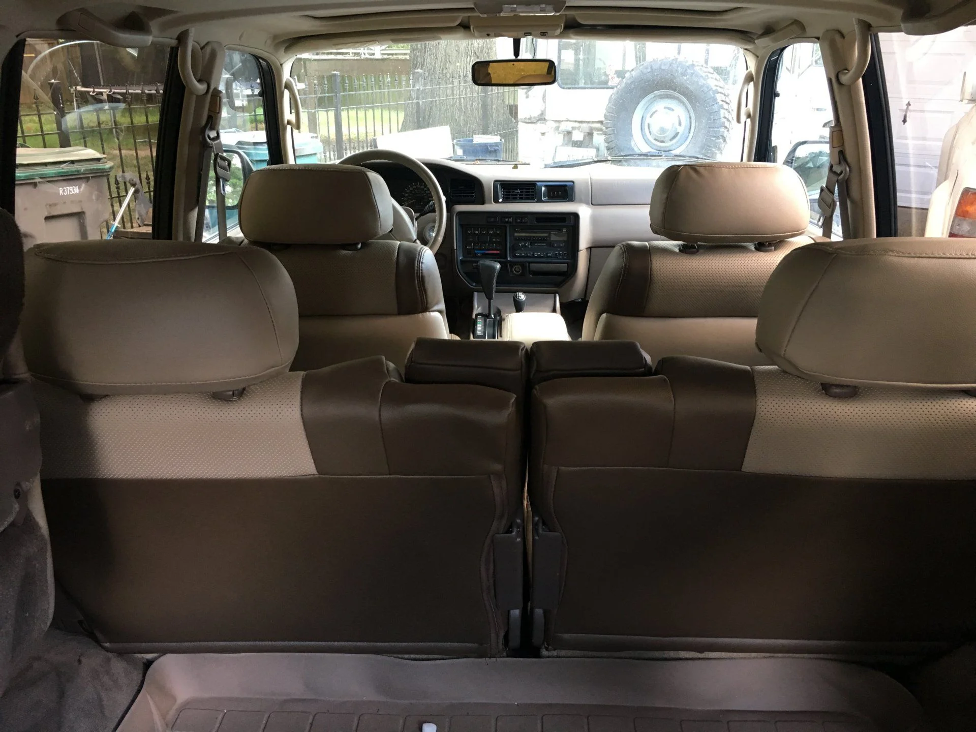

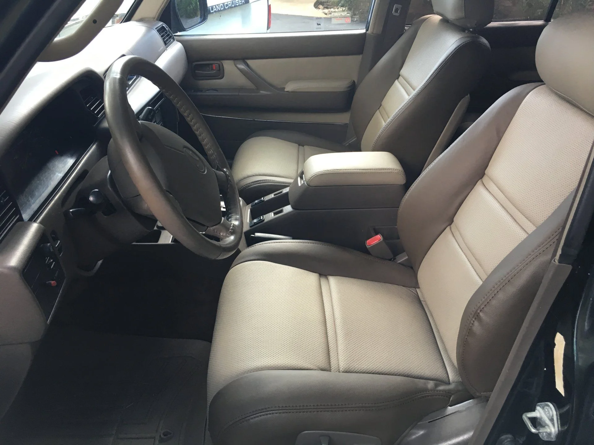

But here are the finished pics:

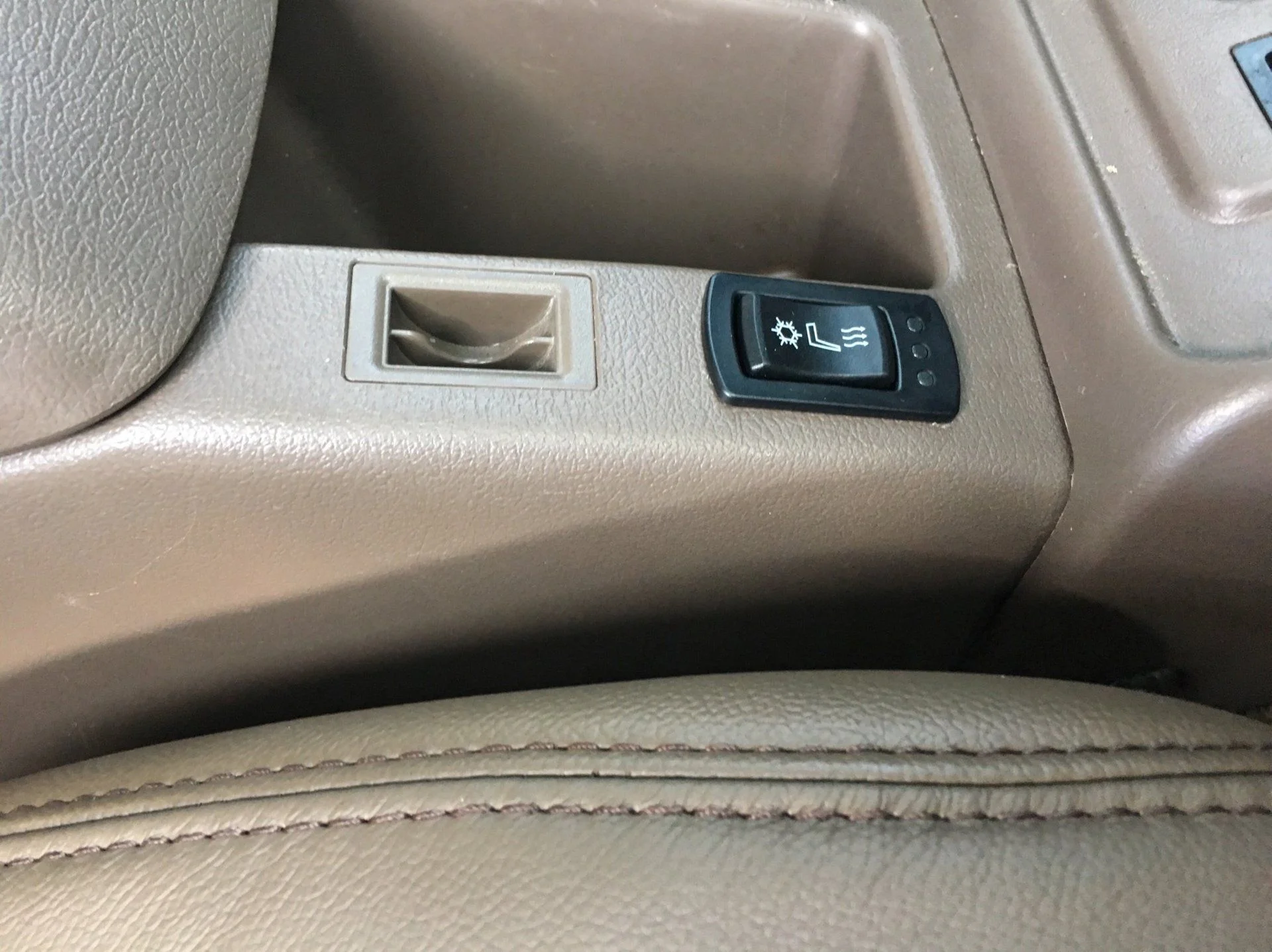

I originally bought a relay to provide switched power to the units, but he found unused plugs with a switched power source under the seats (factory seat heater circuit?) and tied into that.
The switches went into two of the coin holder spots w/ the holes opened up.
I’m really happy with how these turned out. The leather is super soft. And the coolers work great.
On my 100, I only perforated part of the insert, thinking I only needed to do enough for the pads (and thinking it would look better), but I was totally wrong. Full perforated inserts is the only way to go.
On high, these sound similar in volume & pitch to the air nozzles above your head in an airplane. Once I feel mine working, I usually turn them to medium. Once my junk is fully freshened, I switch to low for the duration, which is practically silent.
