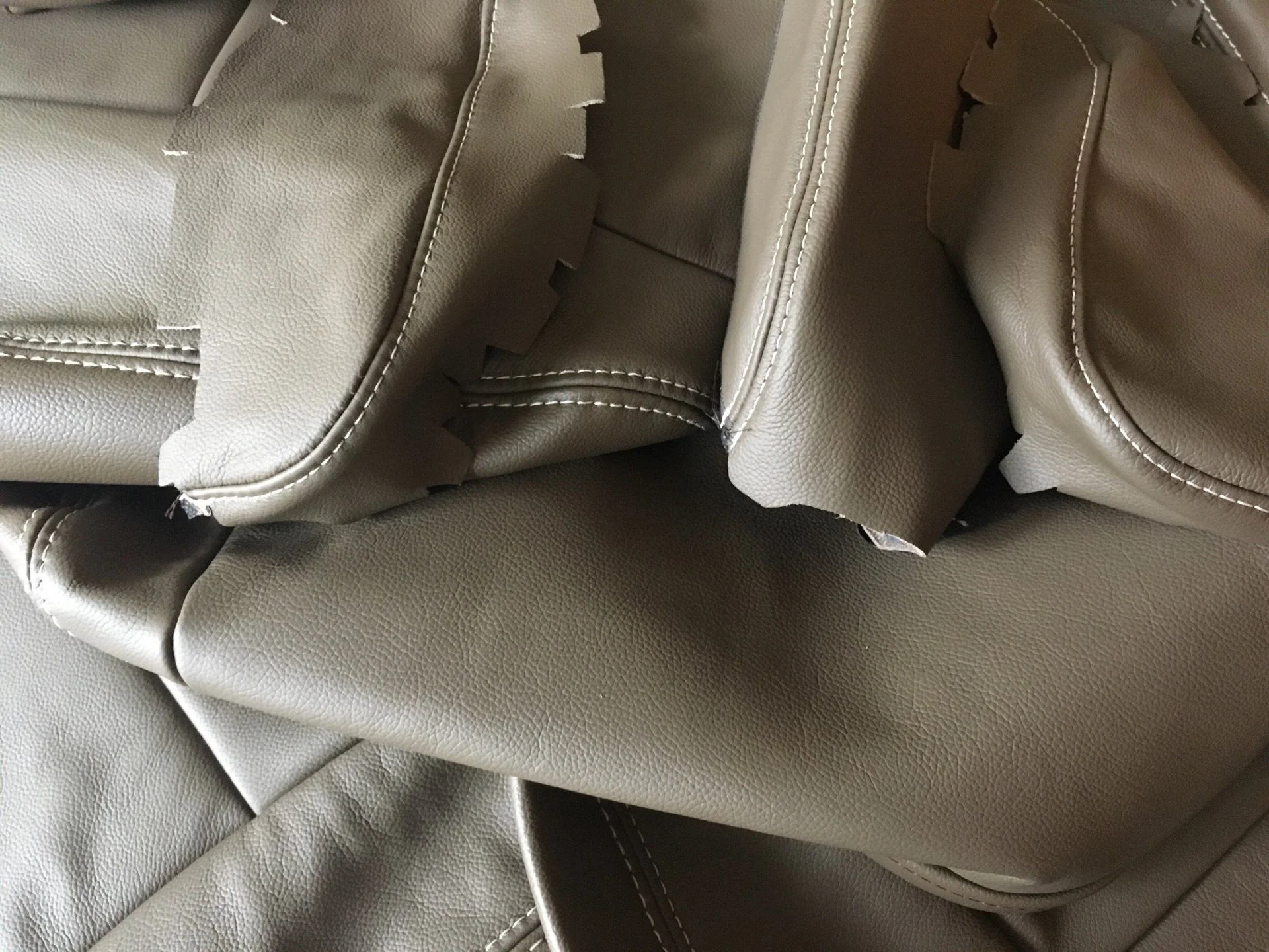

These aren’t set up for coolers, but here’s a pic of the leather in dark brown w/contrast stitching. @bdyer12 is putting these in his daughter’s LX450.

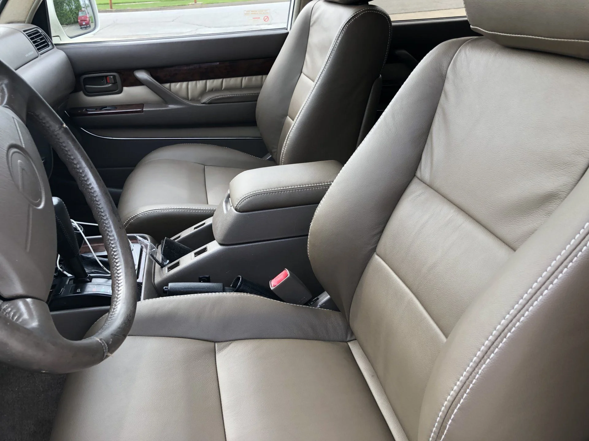

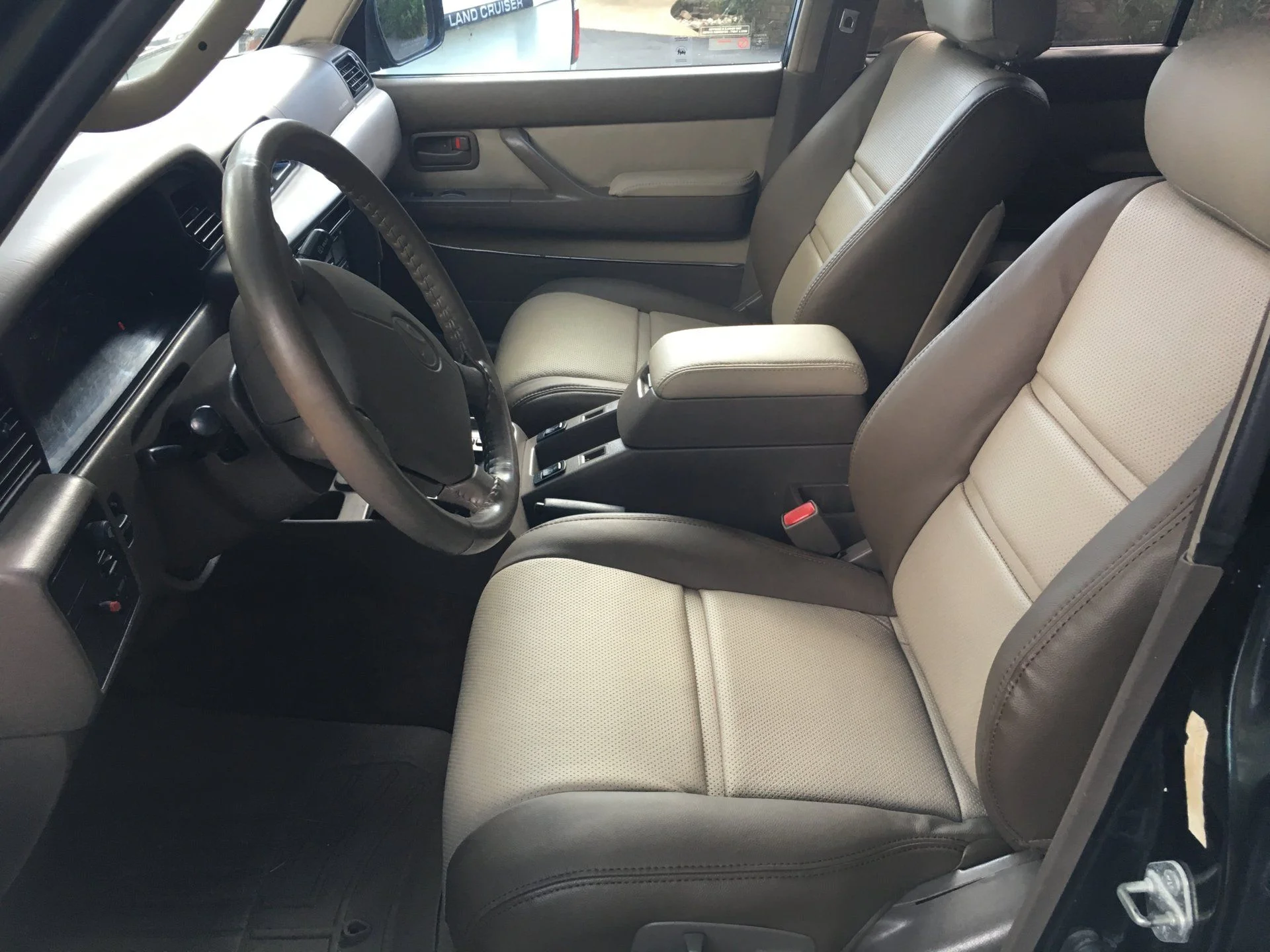

Here’s a couple of installed pics of the set above:

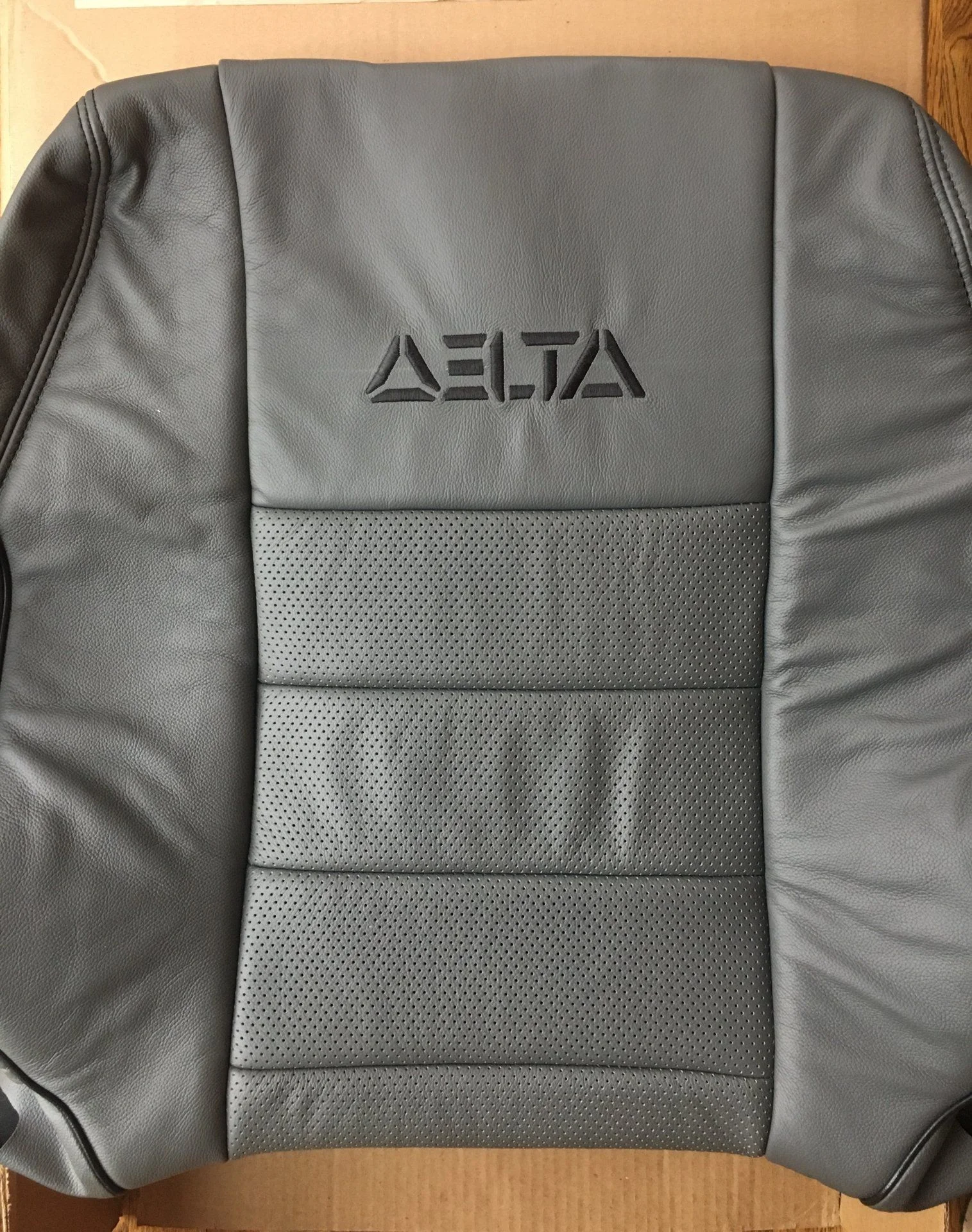

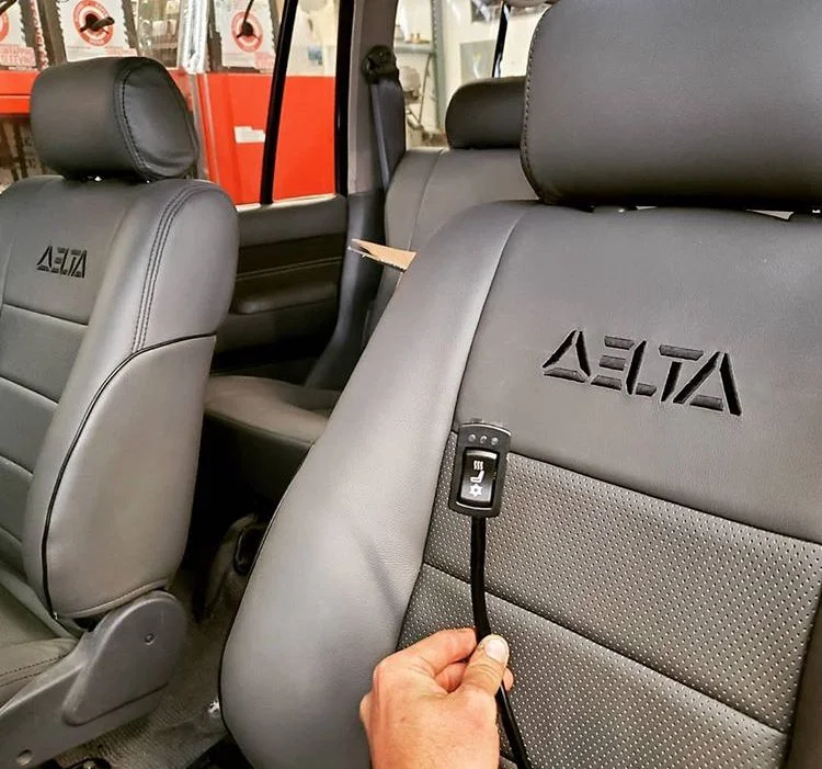

Here’s a heated & cooled set for Delta in the 91-92 cloth/manual pattern:

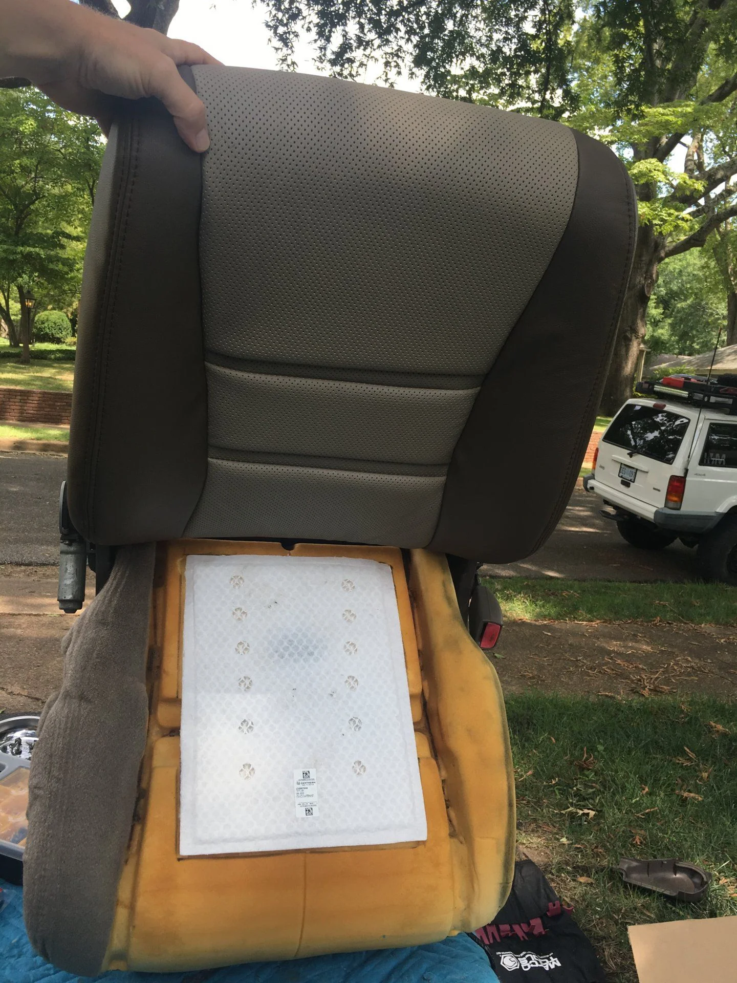

Can you feel the pad or vent tube in the seat at all when in use?
The distribution pads are recessed into the foam so that they are not seen or felt. The easiest way is to slice the foam to depth with a razor blade in strips or cross-cross pattern, and remove the pieces.

How did you manage to attach the leather to the seat bottom and back through the distribution pad? Seems like the pad is blocking the metal wire to which the leather is supposed to hog-ring to.

It does block the wire - those attachment points are skipped. There are enough remaining attachment points to get a good fit.

Did you leave the metal wire in place on the leather cover in that location? I would assume so, since without it there wouldn't be a distinct "crease" in the seat cover. But if the wire is still there, wouldn't it apply pressure on the distribution pad, essentially splitting it in half (and not allowing airflow between the two newly created sections)?

The crease comes from the separate panels being sewn together from the back. The metal wire used to secure the hog rings would not be used above the air distribution pads. They do contribute to the fit, but not enough for concern, IMO, if one wants the luxury of cooled seats.
Here’s some installed pics from earlier in the thread, they don’t look much, if any, different than non-cooled seats:

I missed this reply - no, you don’t feel the vent tube. The pad is recessed into the seat foam, so you don’t “feel” it per se as a separate object in the seat, but you do sit on it as it is now the top layer of seat foam.
The air pad and reticulated foam, in the few installs I’ve sat in, have had a slightly firmer feel than the original seat (with old original foam). Not in a way that detracts from comfort tho. But necessary so that the air distribution system doesn’t collapse and choke.

Thanks again for the reply. Last question - if i wanted to go for a PERFECT fit, do you think it would be possible to attach the seat bottom using the attachment point that you skipped in your install, through the distribution pad? And then split the air duct going to the pad, supplying both "halves" of the pad?

I would not recommend it, but if you do it and it works please post up!
