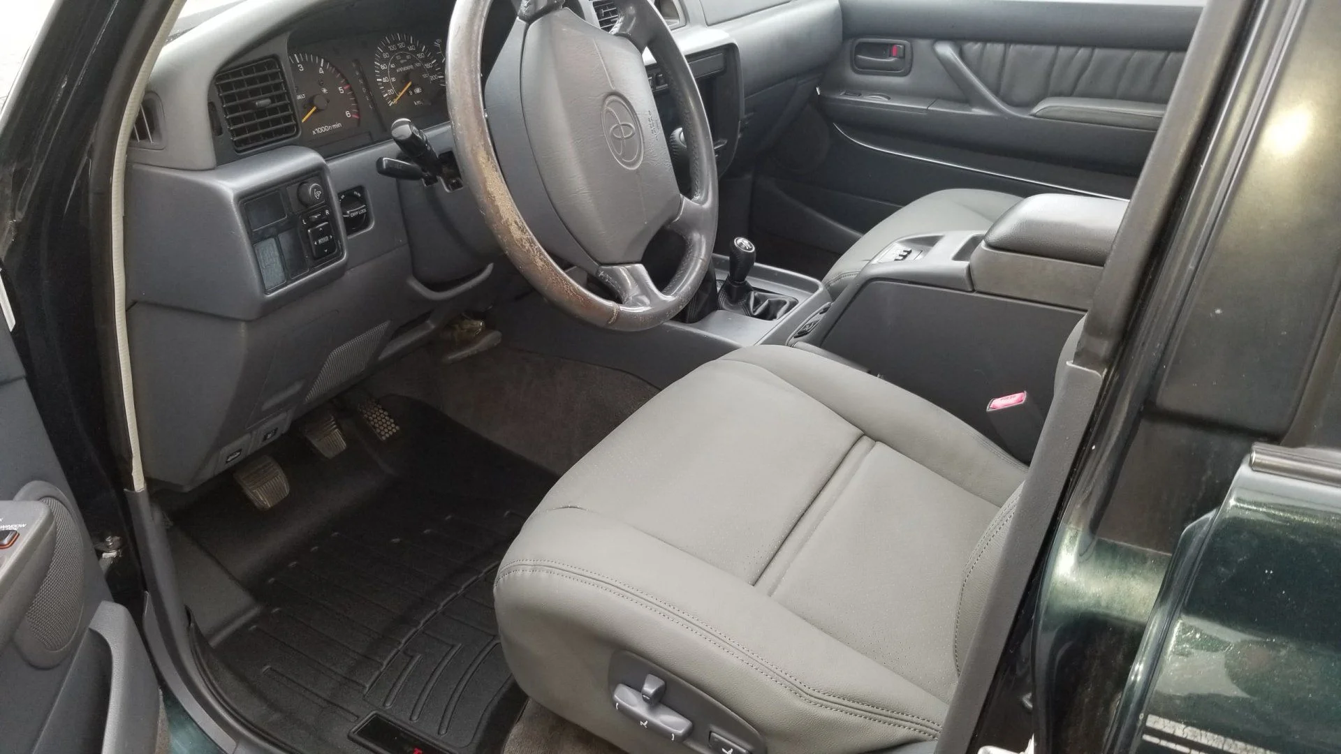

EDIT: Interior light shots made the leather look more brown than it really is. Here's a picture showing the Mosley leather against the stock seat in outdoor light:

Thanks, Looks great! I just thought you had ordered the darker seats that match the dash, console, etc. but those are the stock lighter ones?
