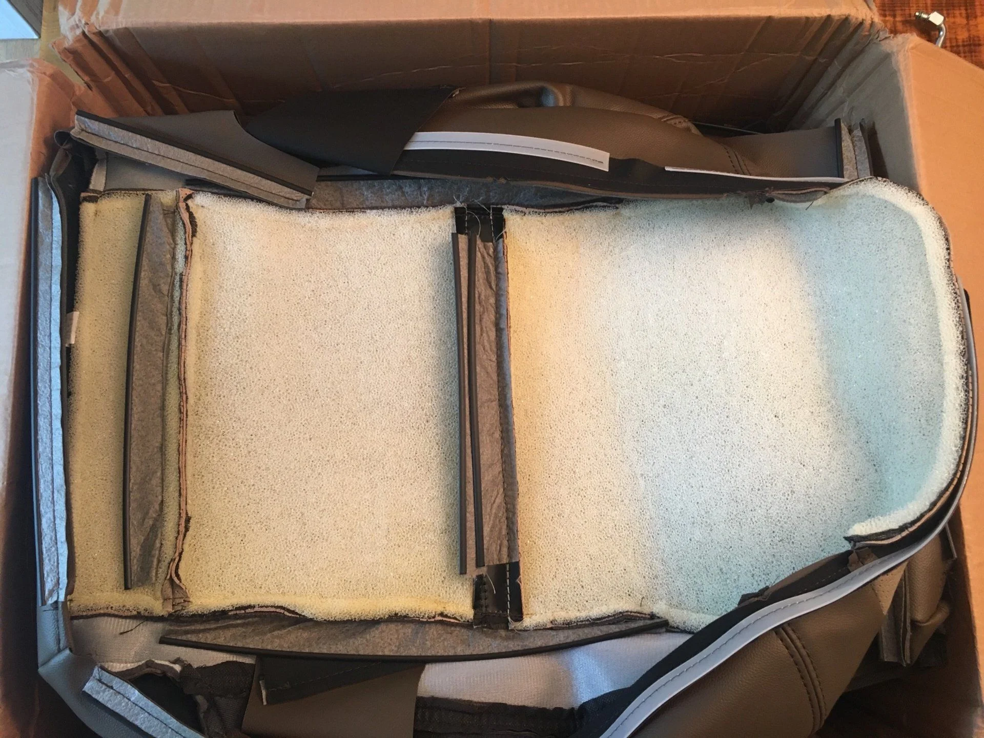

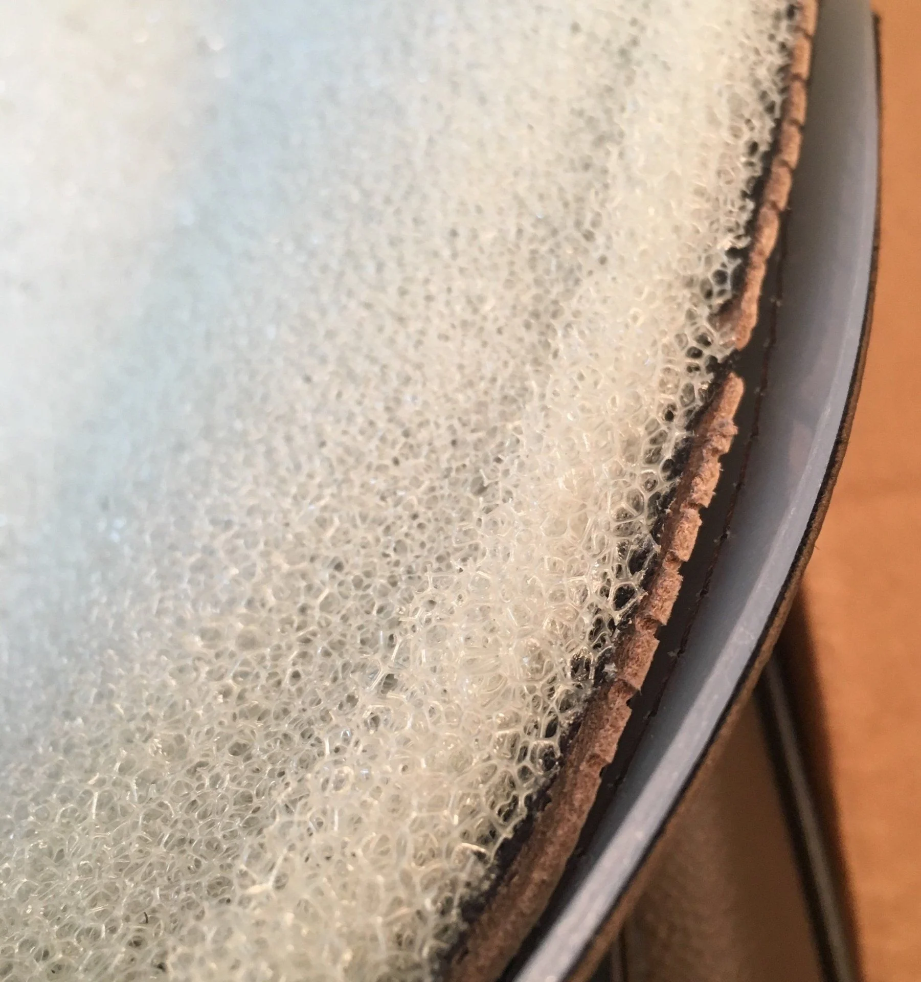

The key to making it work is the reticulated foam that allows air to flow through to the perforated inserts:

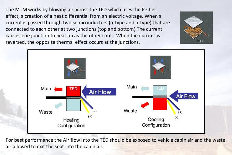

What's the working principle?
Cabin floor air, blown upward through the little holes?
Any chilling involved?
Seat bottom only? Or seat back too?
It uses a fan, ductwork, and a thermoelectric cooler/heater unit to blow cool air into the reticulated foam and out the perforations to your sweaty junk.
The thermoelectric cooler/heater (TED) operates on the Peltier effect (more explanation) to create a cool airstream at the expense of a hot exhaust airstream. This is the same working principal as a Coleman electric cooler. It doesn't get refrigeration "cold", but creates a 10-20 degree temperature differential (making this number up, I feel like I read it somewhere), which makes a huge difference when blown across your skin.
Heating mode reverses the electric current in the TED (thermoelectric device) and blows hot air with a cool exhaust. It pulls more amperage in heat mode, and I believe (based on the fan noise and lack of airflow felt) that it puts out a much lower airflow, the combination of which puts out a much higher temperature differential in heating mode.
The thermoelectric cooler/heater (TED) operates on the Peltier effect...
Got it. Thanks for explaining.

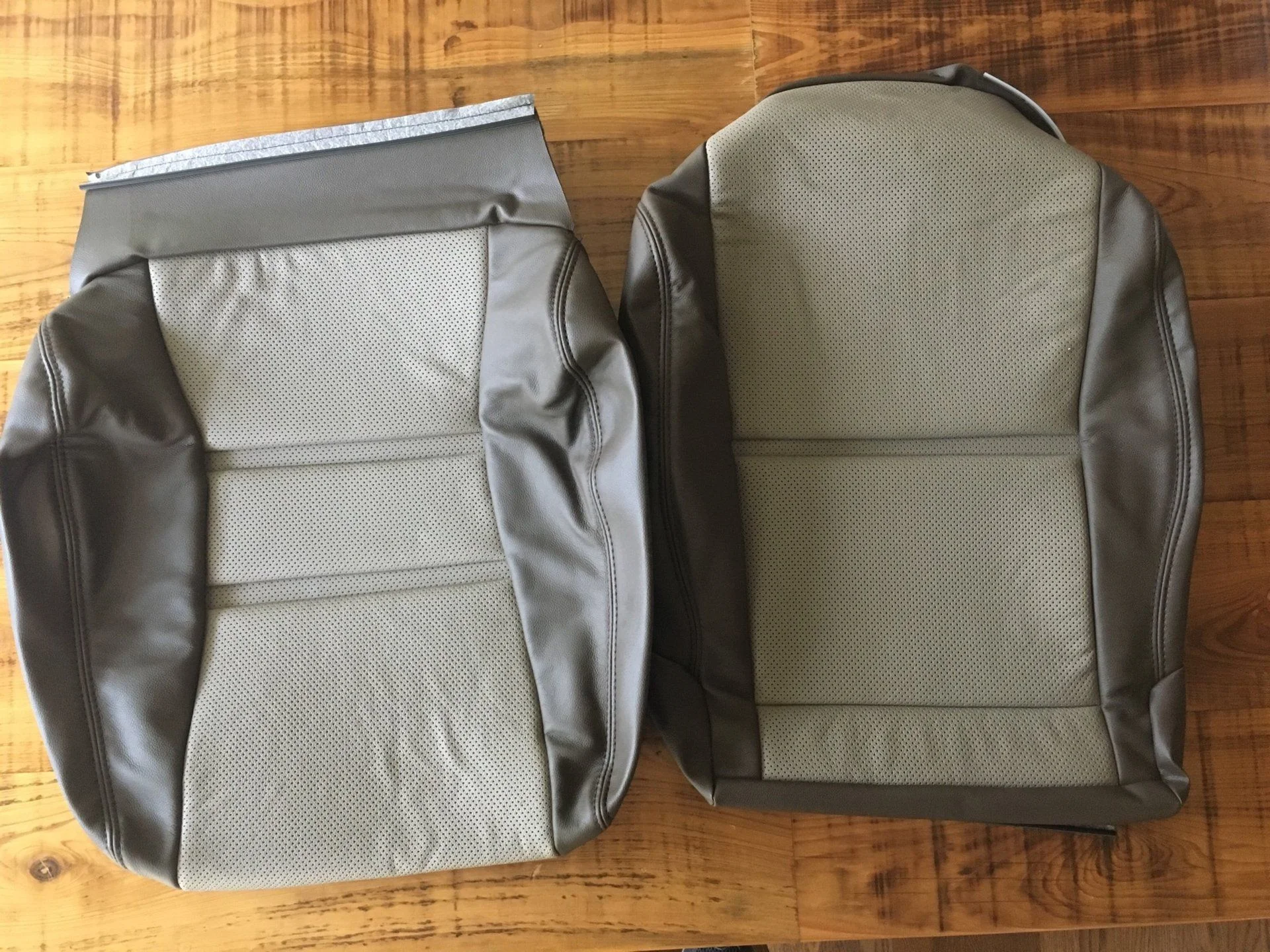

Here’s a front seat bottom & back. For maximum ventilation, we’re extending the perforations along the full length of the inserts.

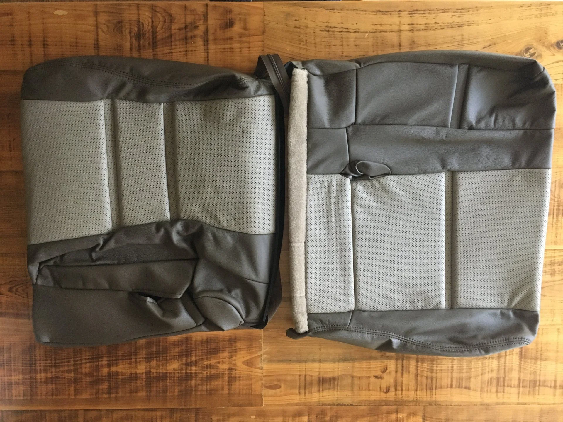

Here’s half of the rear seat. These aren’t getting coolers, but are getting perforations to match the fronts.

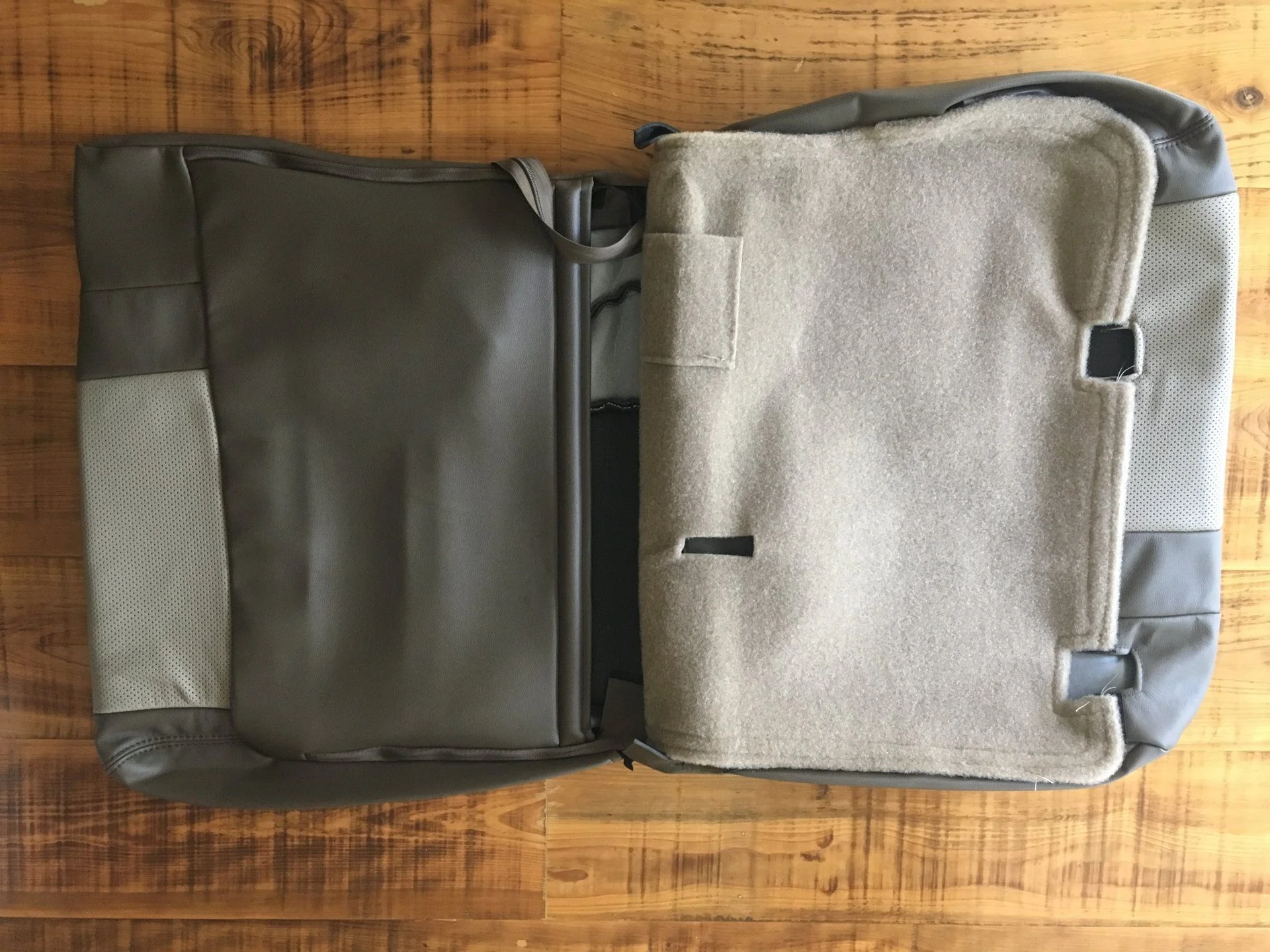

Here’s the back of the rear seats, showing the carpet that is exposed when you fold the seat forward:

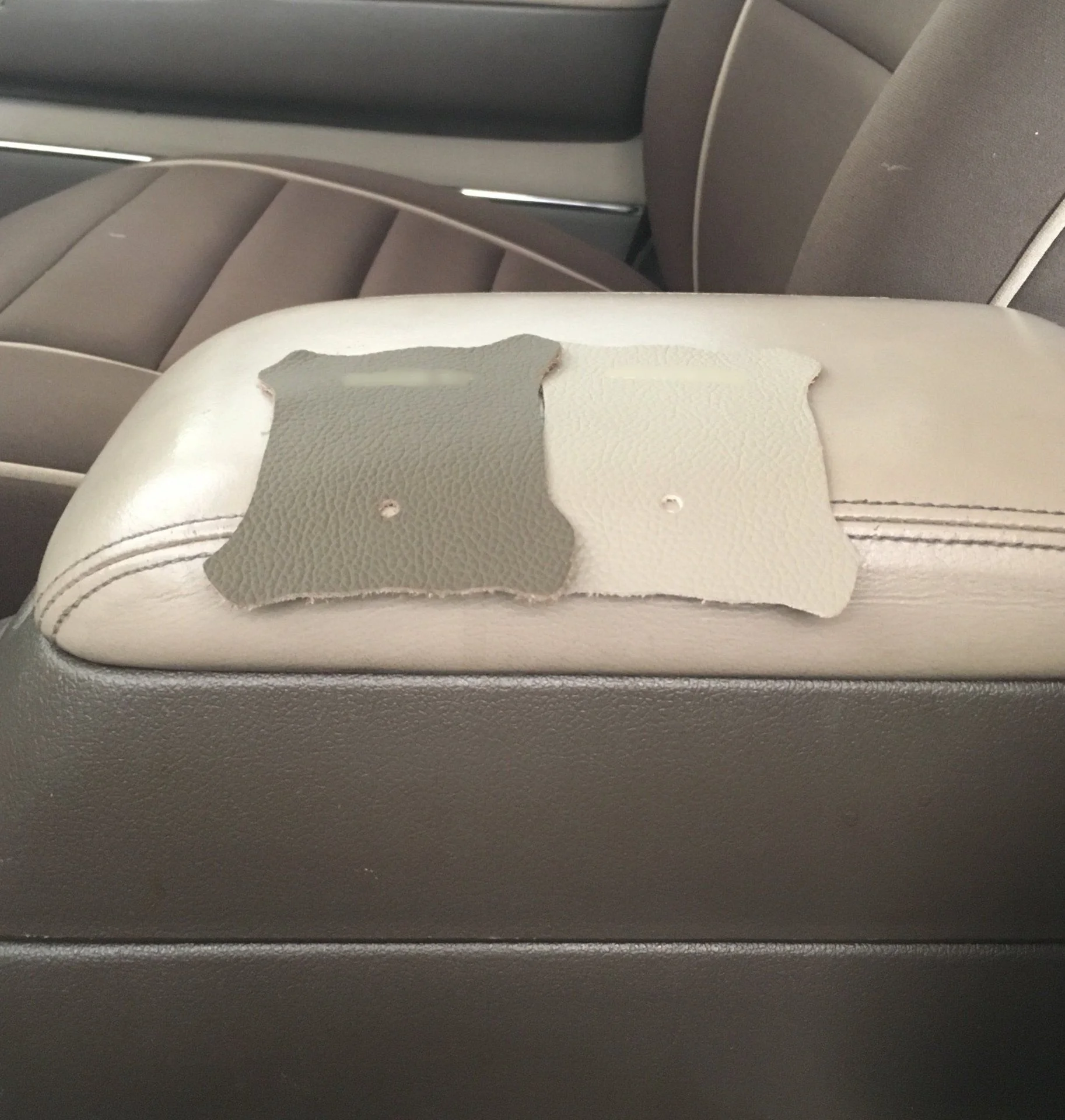

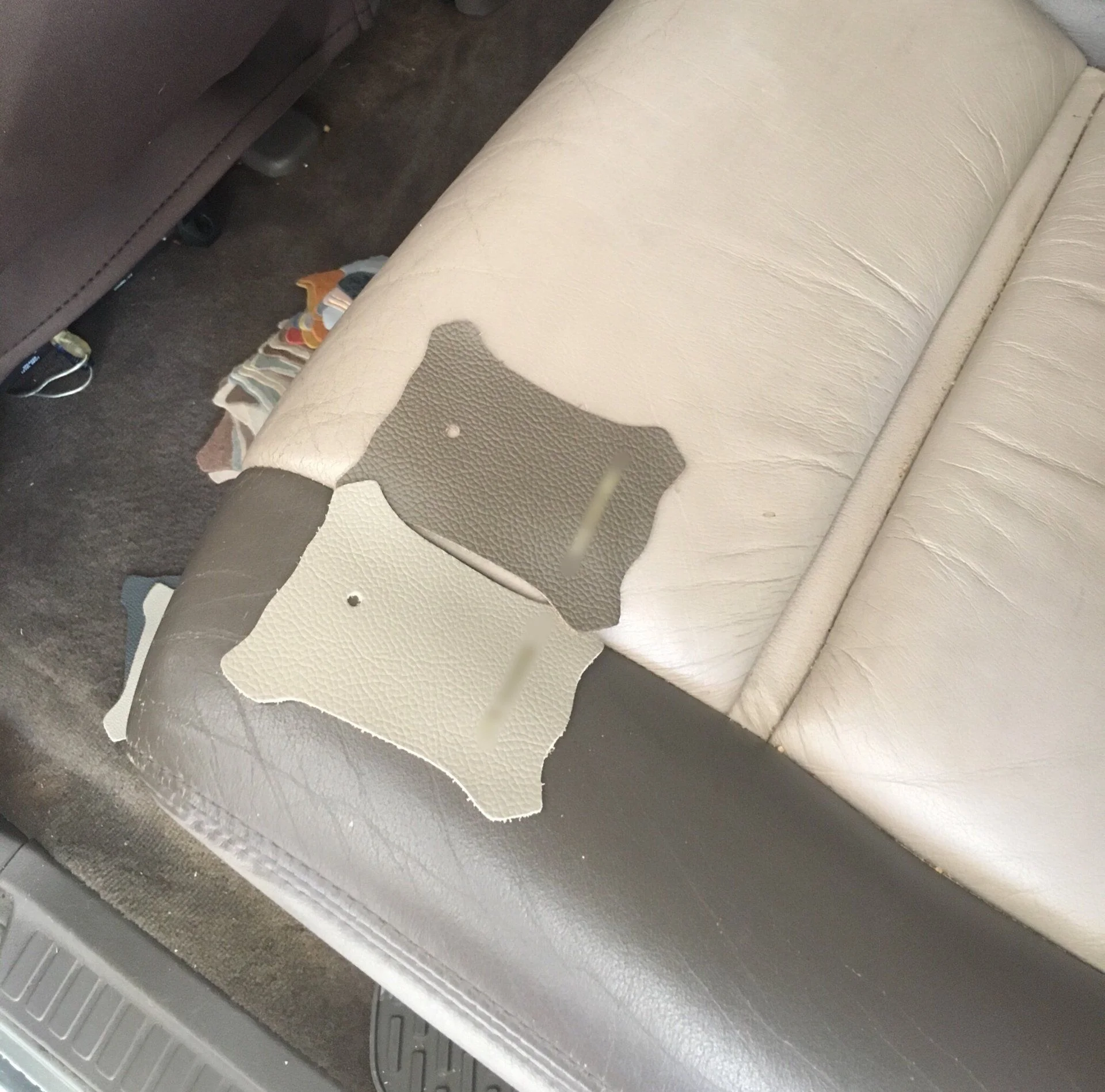

The color seems a little off in the pics, but here’s the samples laid out against a 40th interior...
It looks even better in person. Any differences in sheen, texture, or angle throw off the color through the camera.

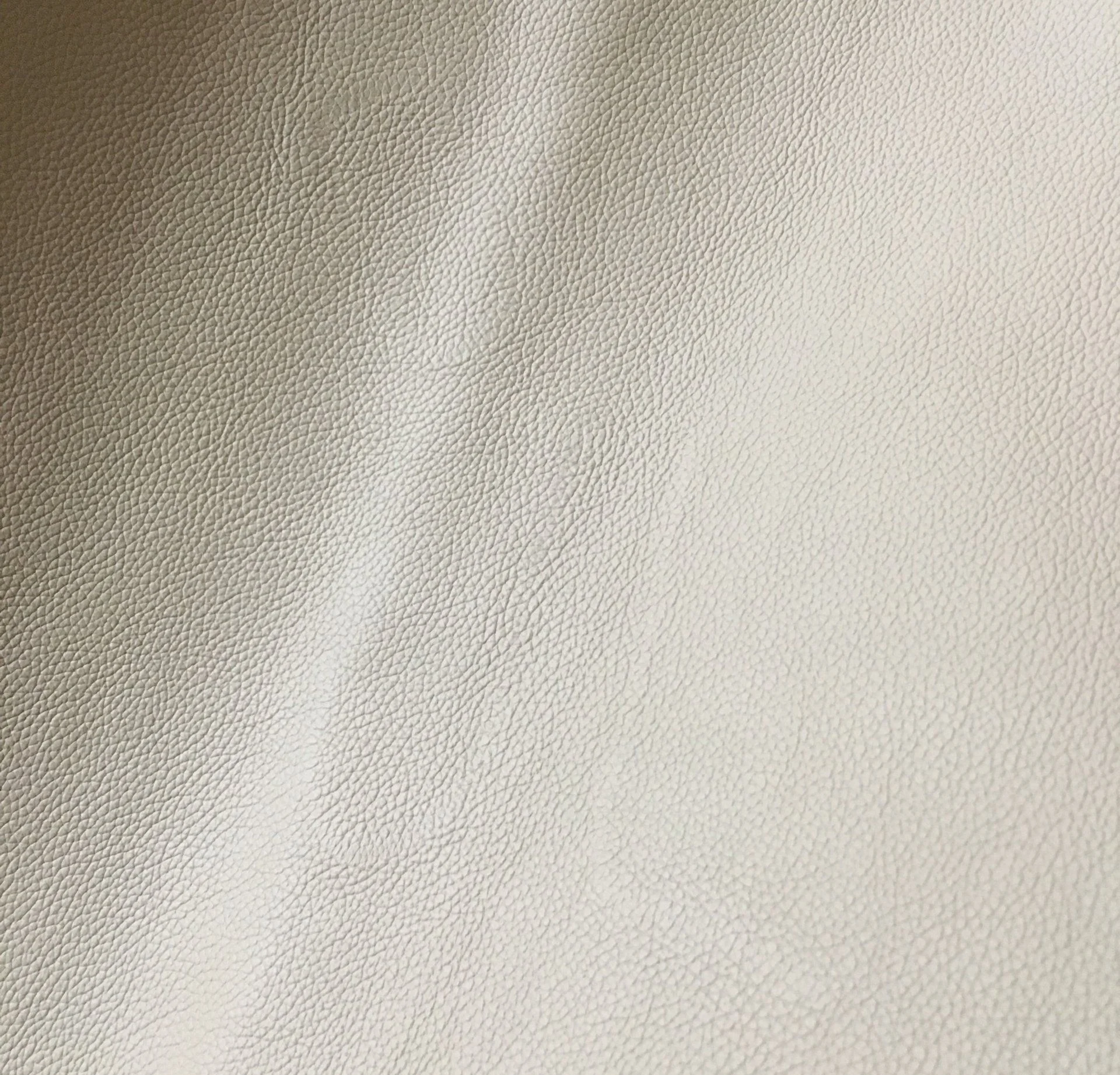

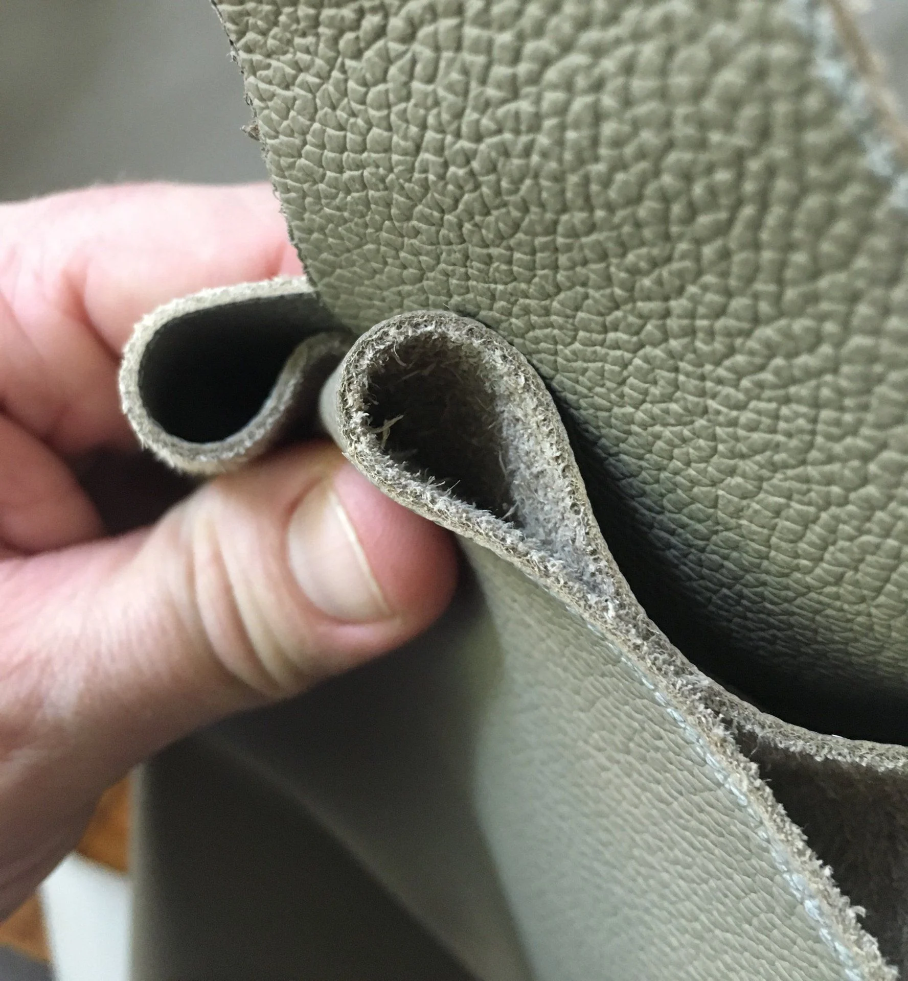

The leather is real deal high quality top grain stuff from authentic cows. Since it is from a living creature, it will have irregularities, so they add texture to the surface for a uniform appearance. (vs. Factory leather which has been sanded to a smooth surface).
I bought 1/4 hide for a sample, so I was able to see it without the foam backing...
Interestingly, when I unrolled it, you could see the mirror image of this cow’s brand, which scars all the way through the hide:
Turned over, you can still see it through the texture if you are looking for it:
