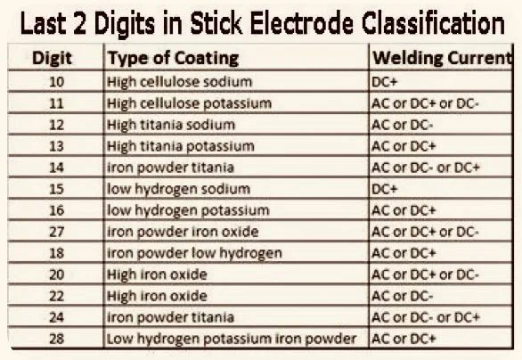

The โ€œ60โ€ is the tensile strength in 1,000 psi units.
The last two numbers encode two different things. The third digit gives (recommended) welding positions:
1 = any position.
2 = horizontal position and flat position.
3 = flat position only.
4 = overhead, horizontal, vertical down and flat positions.
The third and fourth numbers encode the composition of the flux, and as a direct result, the type of current (AC or DC) and polarity.
Sometimes you get a suffix, such as 7018-A1, which is designed for welding 0.50% molybdenum steel, a low carbon, low alloy steel typically used in applications such as pressure vessels and heat exchangers.
