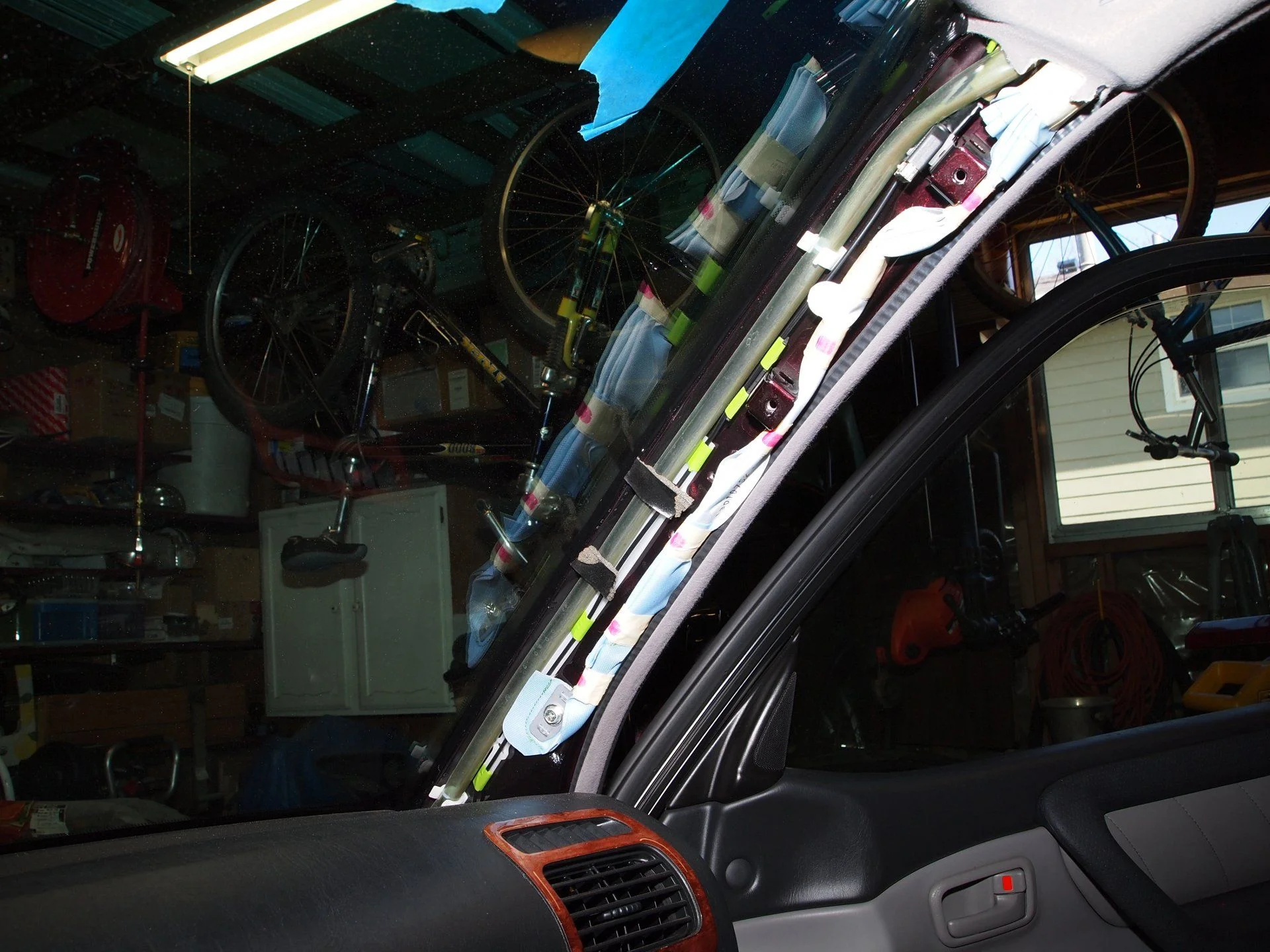

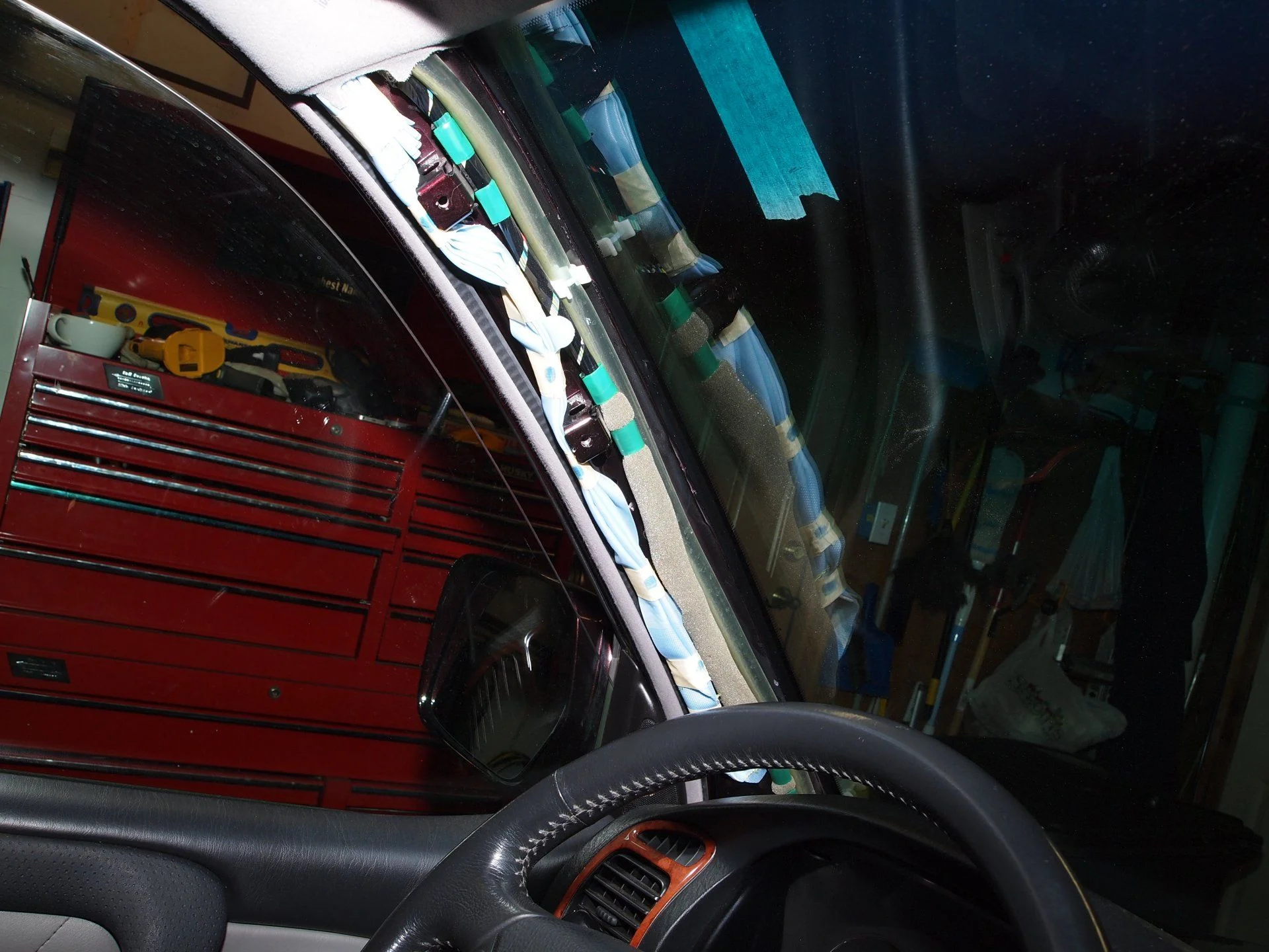

I didn't mention early; I also pulled interior side molding. Installer rarely pull these, and generally cause some minor cosmetic damage to them.
View attachment 1465880 View attachment 1465878 View attachment 1465879
Interesting they did something I've not seen before. Tech showed me two holes at top (of body) that Toyota uses for setting windshield alignment. The Tech tape under hole then filled with black poly. He said they've had Toyota's leaking water through these holes.
I am more and more becoming of the opinion we need to pull windshield every 5 years or so to say on-top-of rust. This one could have gone a few more years, I may have waited to long on my 01LC (The King).
The PS hole you're referring to was leaking in my truck. Swapping out to new glass led to finding a tiny bit of rust forming in the top PS / roof corner that would have been a nightmare 4+ years from now.

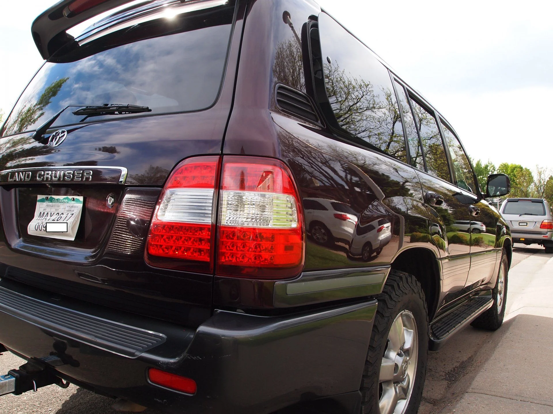

Love the LED tail lights:

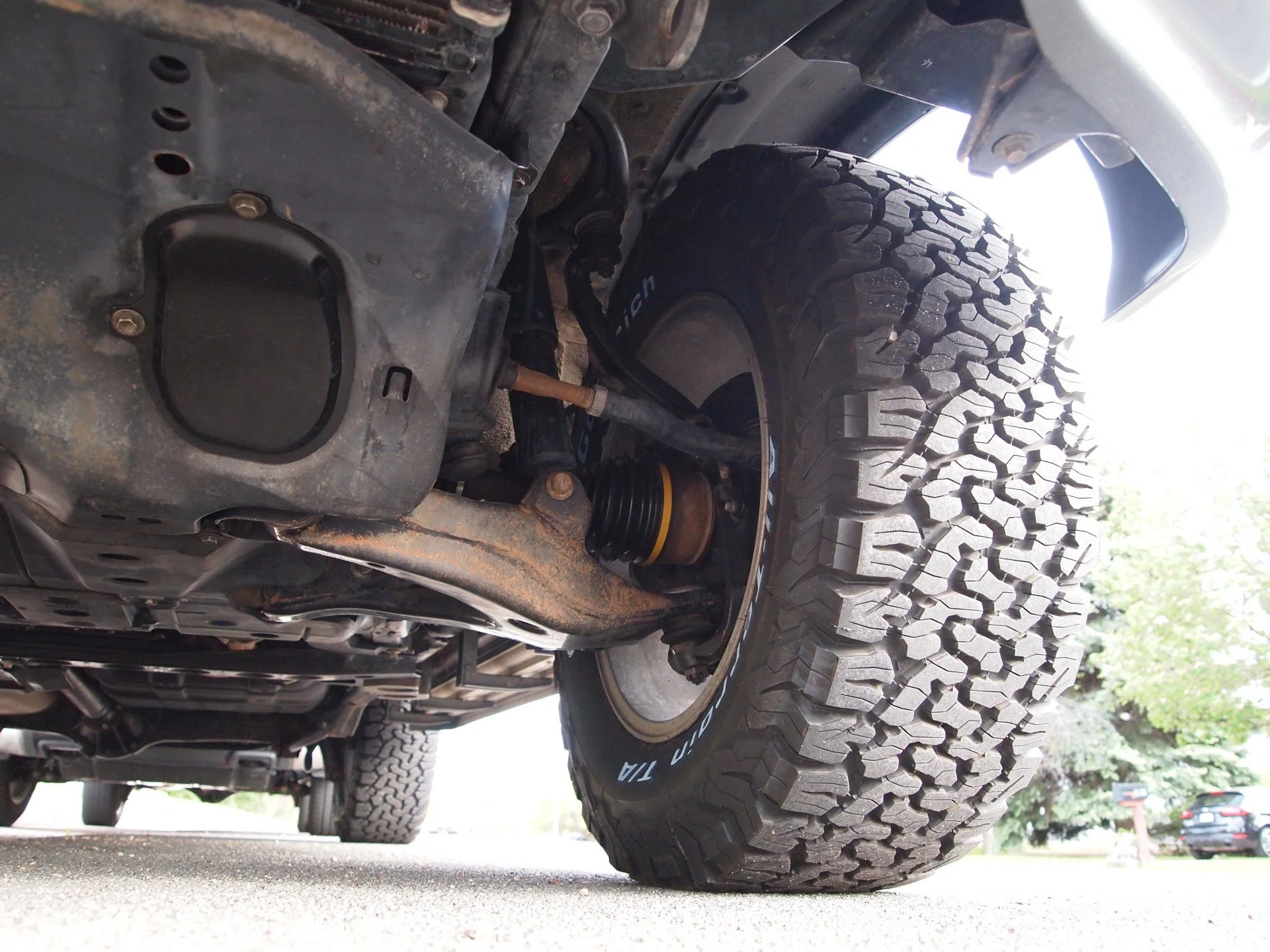

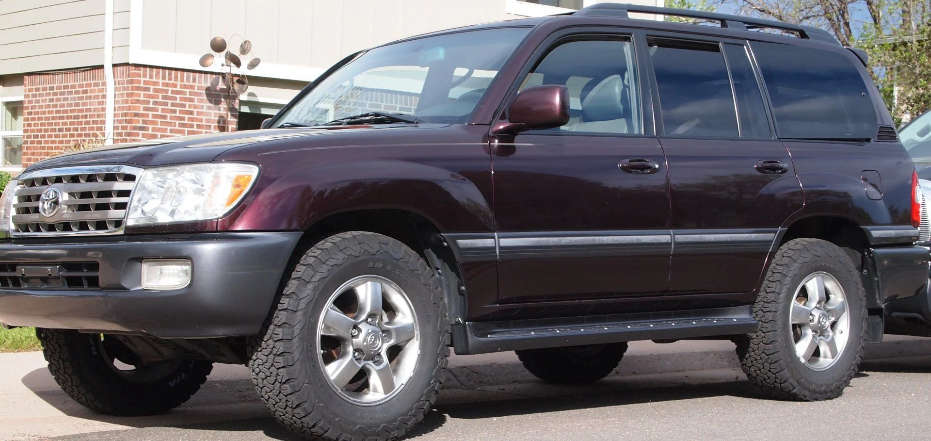

285/65R18 KO2's look great and ride supersized me, very nice !

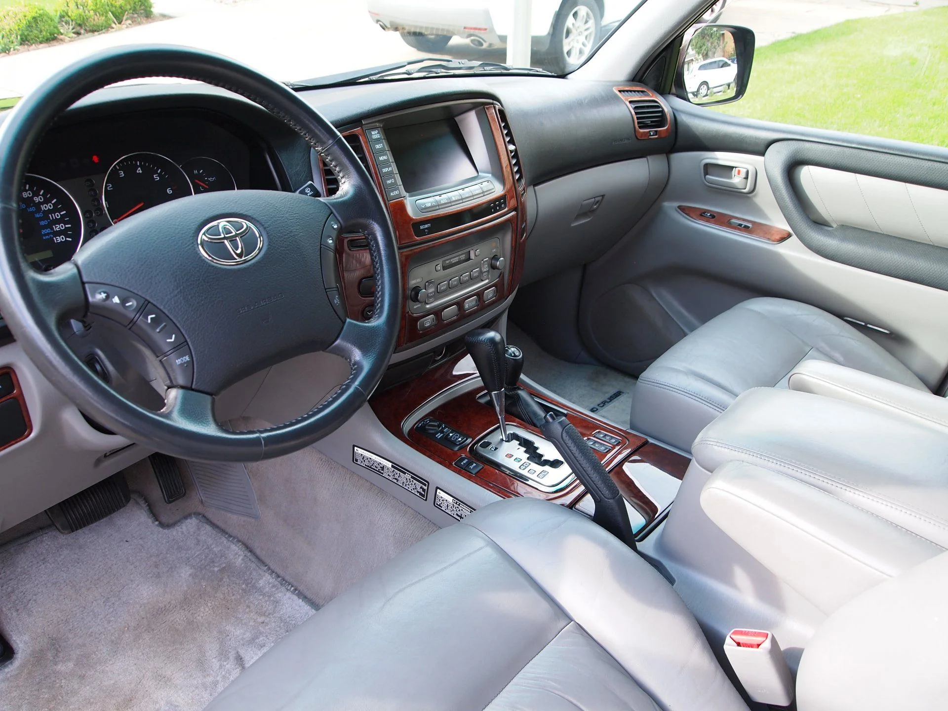

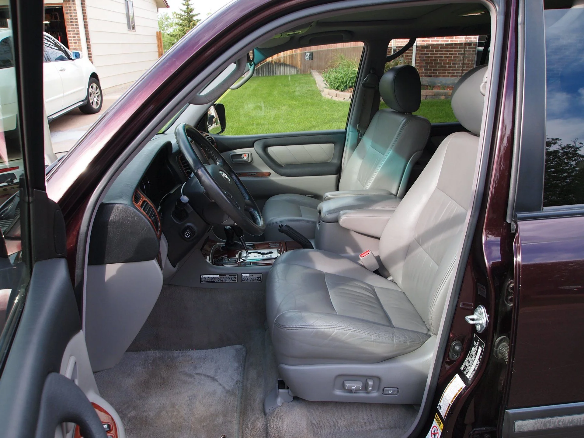

Interior cleaned up well, not a full detail but nice:

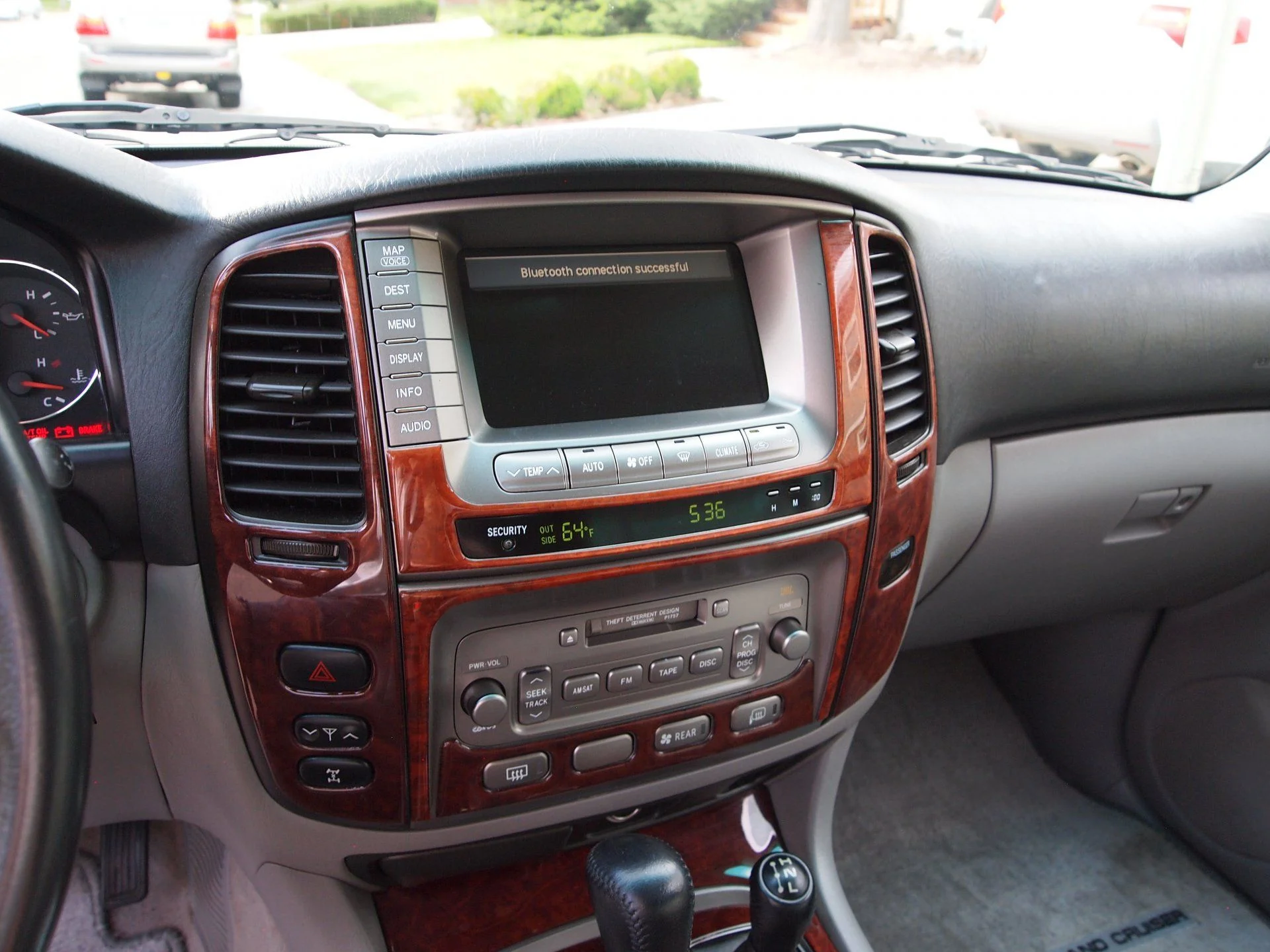

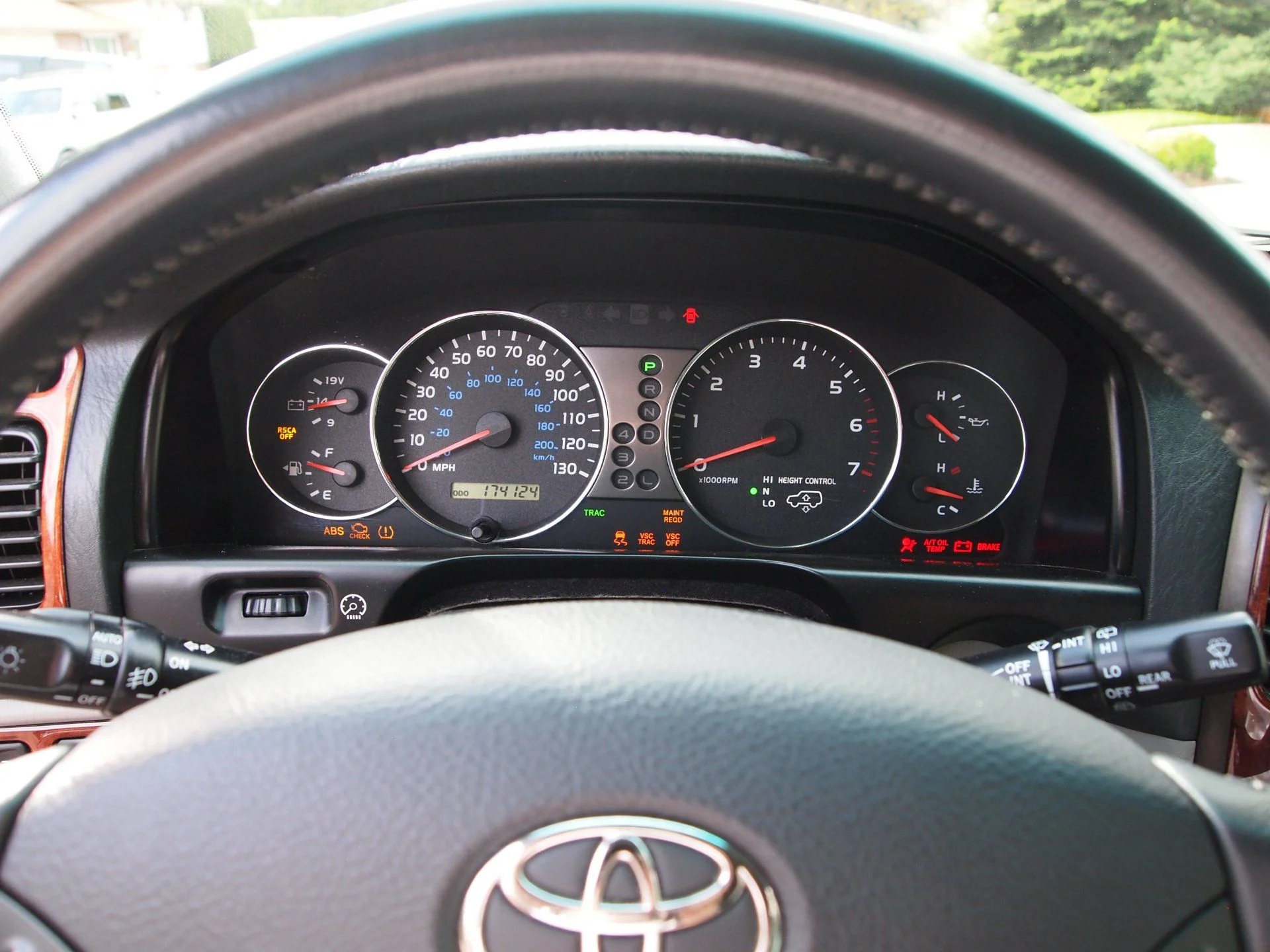

Love the hands free speaker phone.

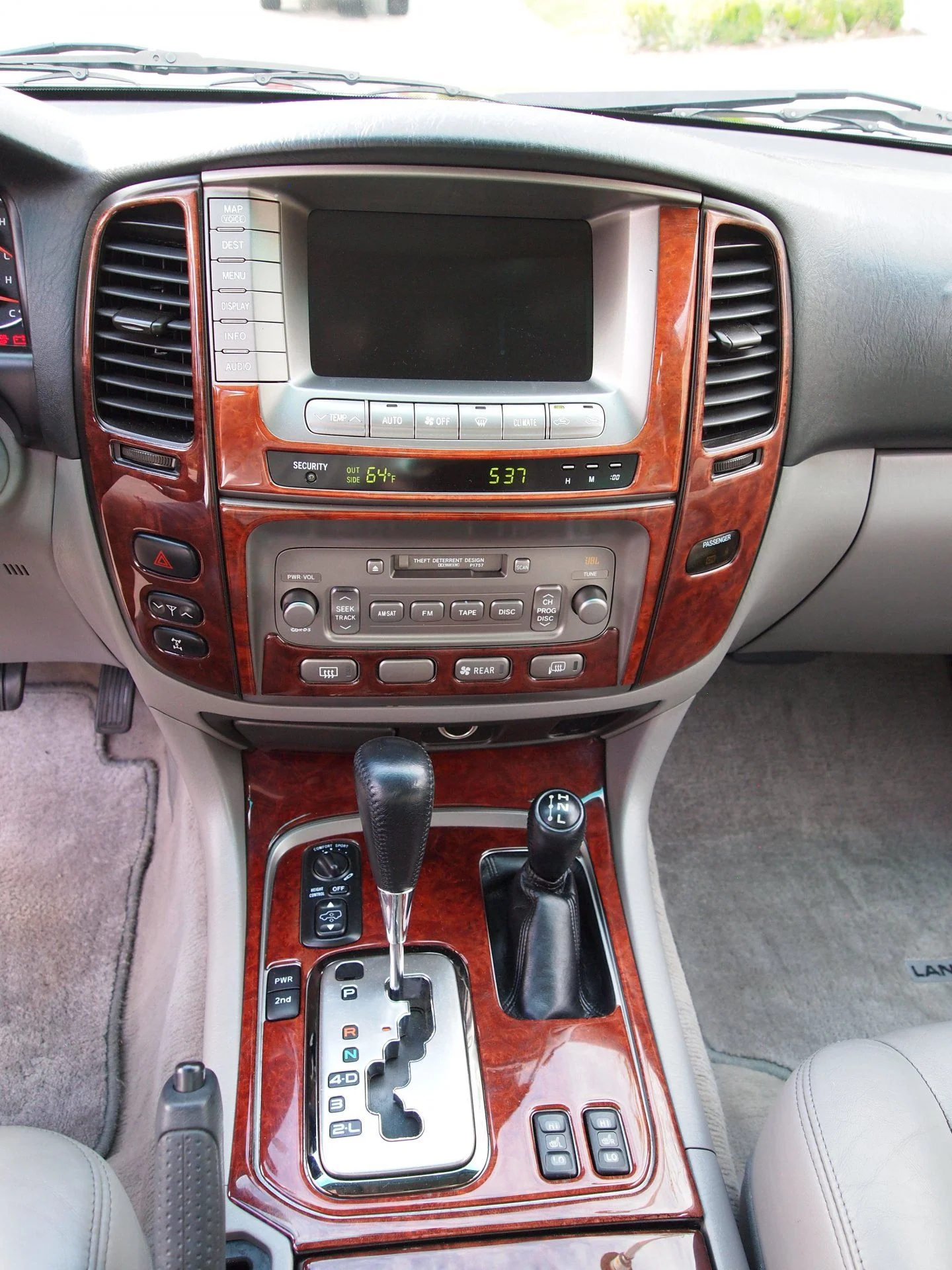

The new chrome bezel around the shiftier brought it home ...Sweet!

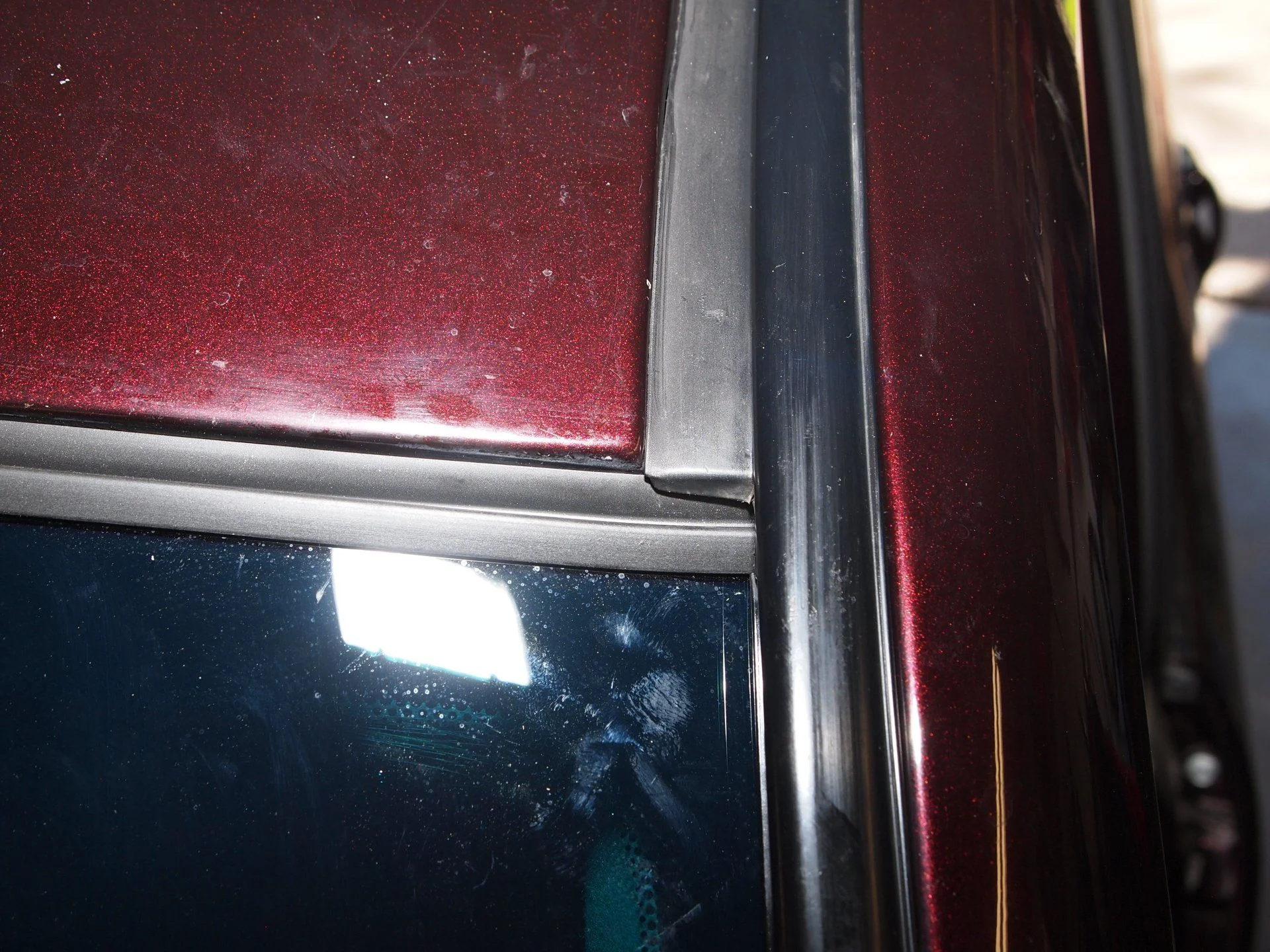

Windshield molding turned-out well:

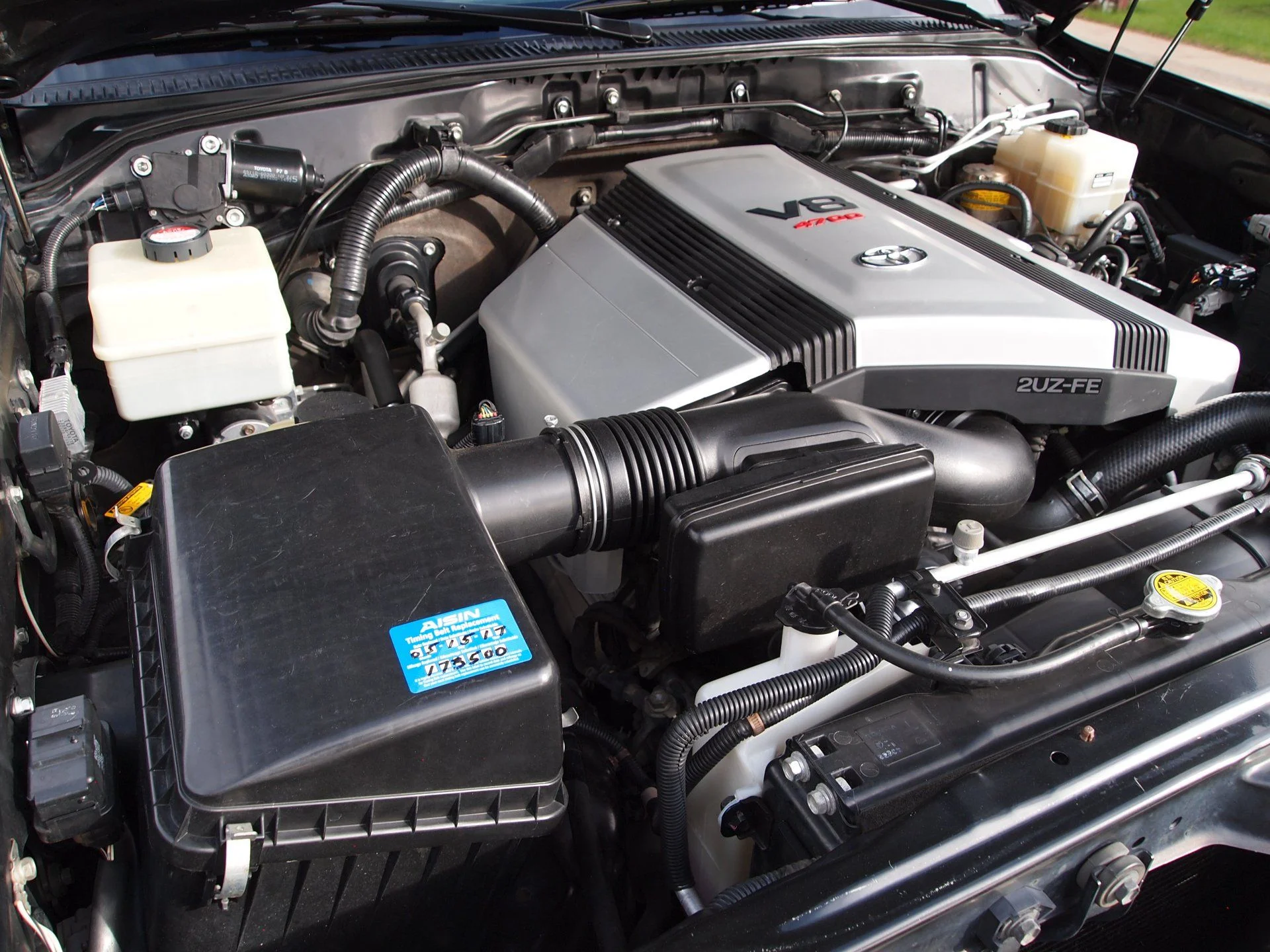

Engine, front end and suspension is where the real work took place.

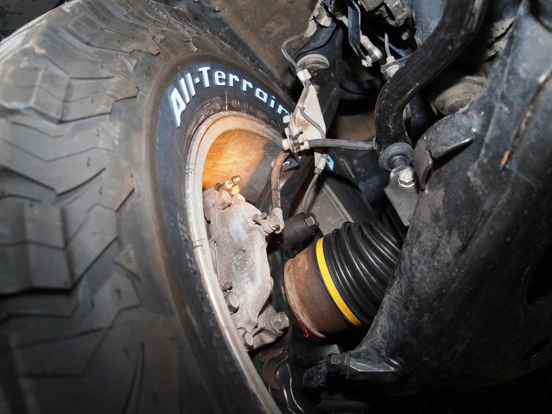

Brakes flushed, replace 1 bleeder front DS, all bleeder caps (missing). Cleaned out both plugged rears bleeders, one was frozen in caliper.
Flushed AHC fluid & replaced one bleeder cap. Will be replaced all caps as a PM in future if they don't pass water wash test (water in cap)

Front drive shaft CV boots & lube both sides replaced.
Front wheel bearings, races, seals, gaskets, claw washers and lock rings/washers replaced.

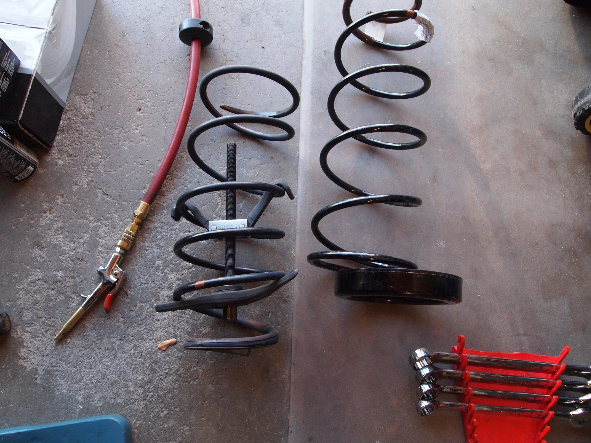

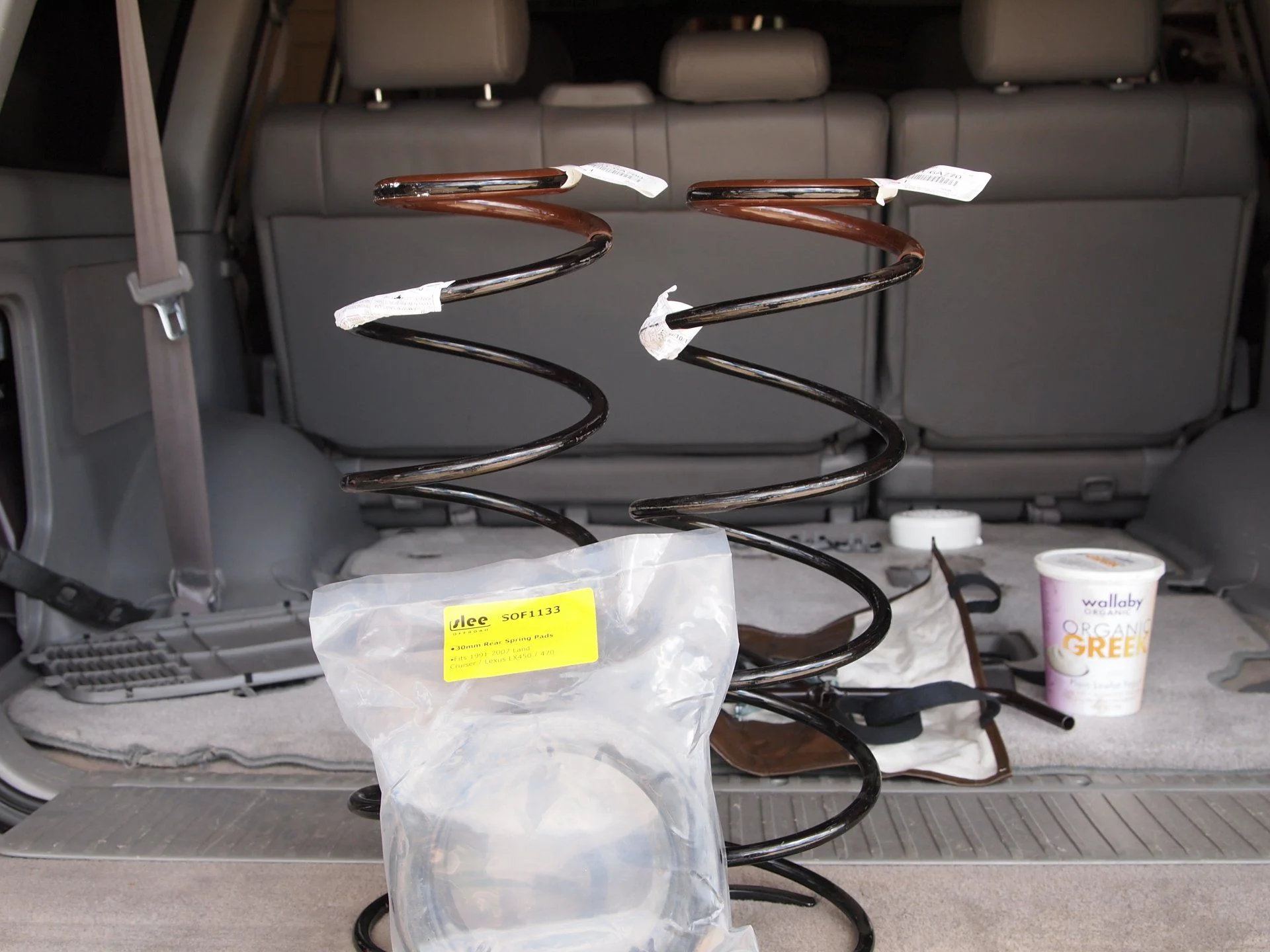

Coil spring replaced W/new OEM. 30mm Slee coil spring spacers installed lower AHC pressure to ~6.2 mpa w/KOS 285/65R18 in place.

2001 LC, great post! My 2005 LX developed a water leak coming from the top left corner of the windshield. There is a little bit of rust in that corner under the side/top moulding that allows water to sip in from underneath the rubber under the windshield (it is very small and is totally covered by the moulding). I've talked to Safelite and they can remove the windshield and come back a day or two after I do any rust repairs in that corner. (I've been to 4 body shops in my area an nobody wants to perform the repair. I can't believe it!) However, before replacing a fine, factory-installed windshield, I want to try to perform a cheapo fix and see how long it lasts.
I plan on removing the side moulding and top moulding (maybe replace them with new ones) and apply some kind of urethane/marine caulk in that corner to stop the water from getting in. Can the top moulding be removed and replaced without removing the windshield? I would scratch/sand down as much rust as I can with the windshield on, and prime it and paint if needed; to slow down the rust from spreading. But of course, I wouldn't be able to do anything with the part of rust underneath the windshield.
Any ideas? Feedback? Am I putting too much weight in keeping a perfectly fine, factory-installed windshield?
2001 LC, can you elaborate a bit on removing the rivets on the side moulding of the windshield?
Is this the right sequence?
1. Knock through the center shank of rivet.
2. Drill the rivet out
3. Remove moulding
I'm a little confused.
Use a 3m rust remove wheel then acid treat. Speak with Safelite, they have both and a black primer that great stuff. You'll see some more on this in my detail thread link in Whitelady Body trim polishing & correcting compounds (#40 more or less)
3. Remove moulding
You got it! Make sure to go very easy with the drill. You're only remove head of rivet. Do not drill into mold or through body. Safelite has some oversize rivet that I use by triming head for install, as my had been drilled (oversize) previously. The top of molding is held in the roof rut with two-sided tape. The windshield installer's just grab the lower have (rivet area) and rip upward. This bends the metal reinforcement in molding and it will never lay flat again. If you'd like to save the molding, heat with the sun or heat gun. Then pull a fishing line through under two-sided tape of molding.
You may need to cut out rust and weld in new tin (sheet metal). This takes welding skills. But and easier way may be to use fiber glass in place of tin. I did this as a teenager and it work very well and was easy to use.
You must get every bit of rust removed, or acid treat the lite stuff. If not it will return in time.
