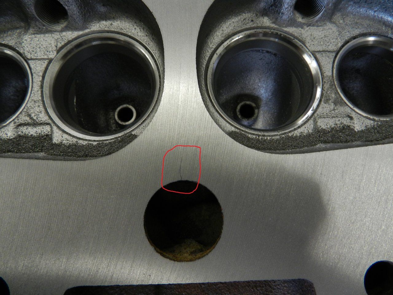

Head was looking good until we did the final surfacing of the deck.Once surfaced a small crack showed up. Fortunately there is a permanent fix for this. It is a 100% fix, not a band aid.

ooh, good to see it in loving hands!! Exited to see that up and running again, never seen a head getting stitched up again like that!
