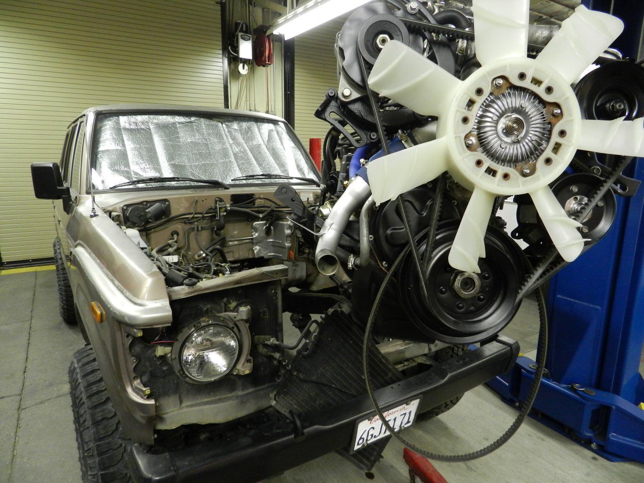

Well today is the day. Put the fresh motor in my FJ60. I wish I could say it went easy, but that last 1/4 inch was a hard fought battle.
