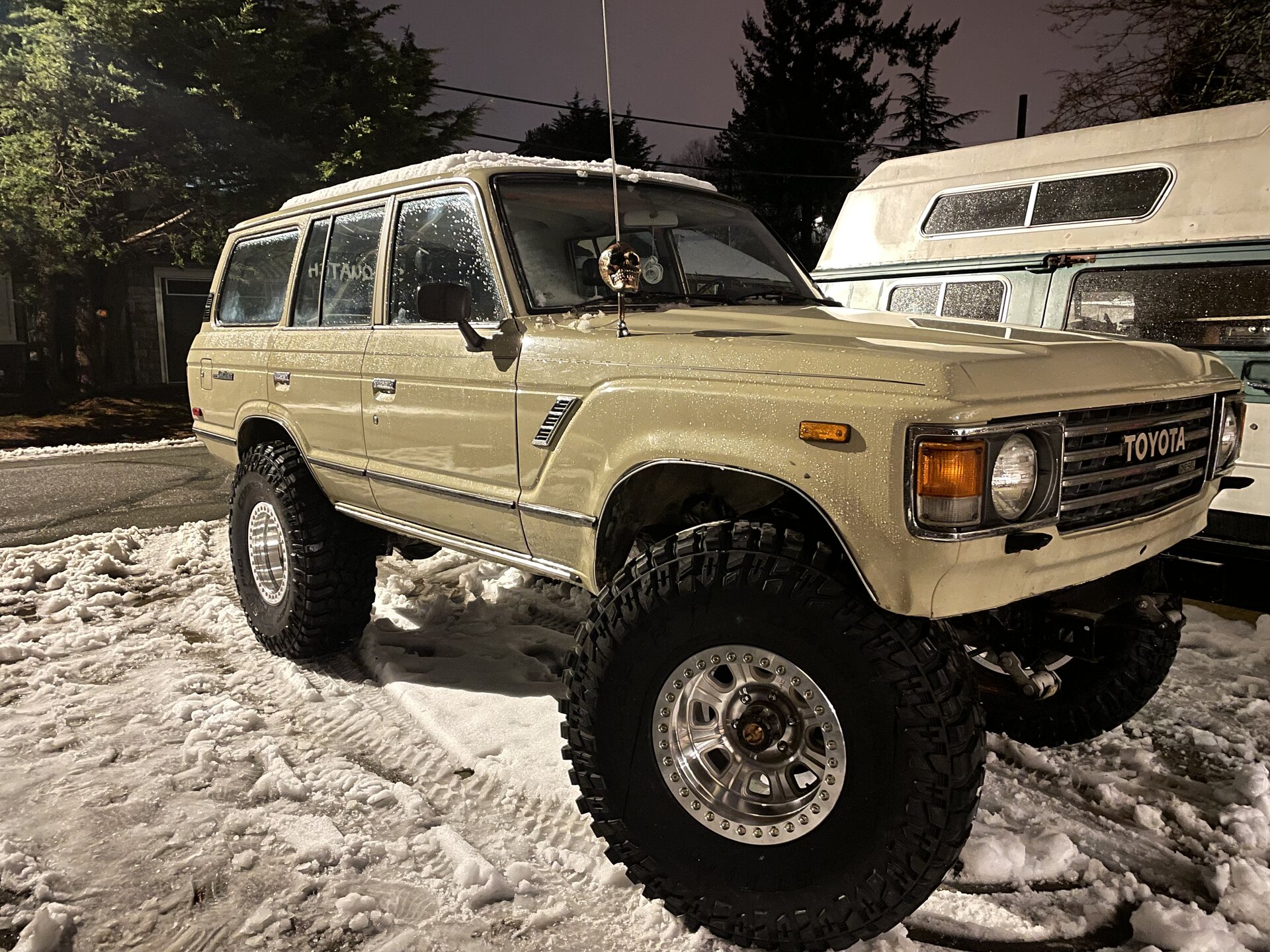

Completed? The project never ends! Here is a photo of one 40” tire and raceline beadlock i mounted the other day. Waiting on parts so i can mount the rest.

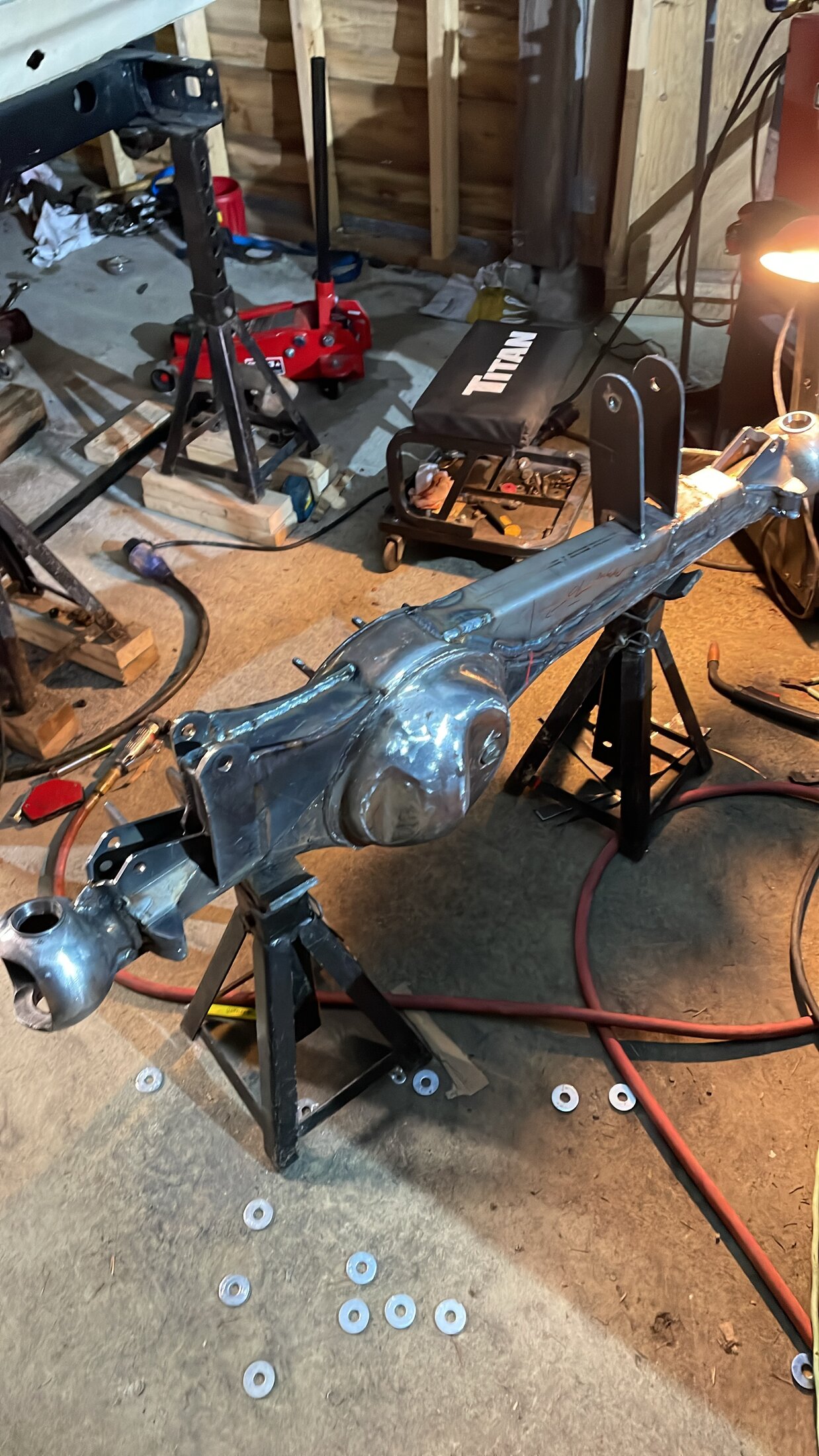

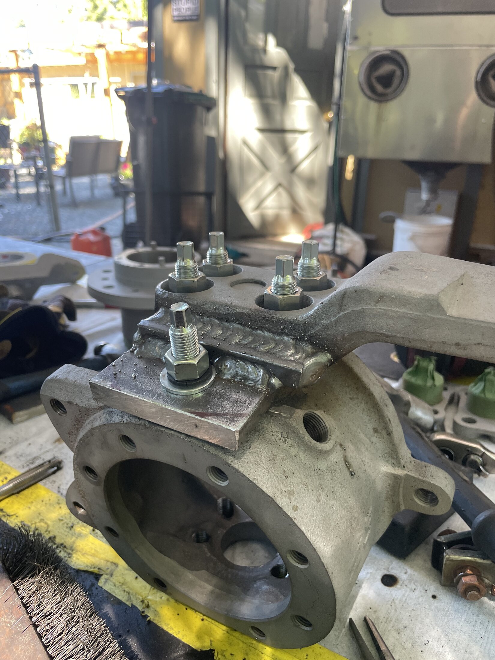

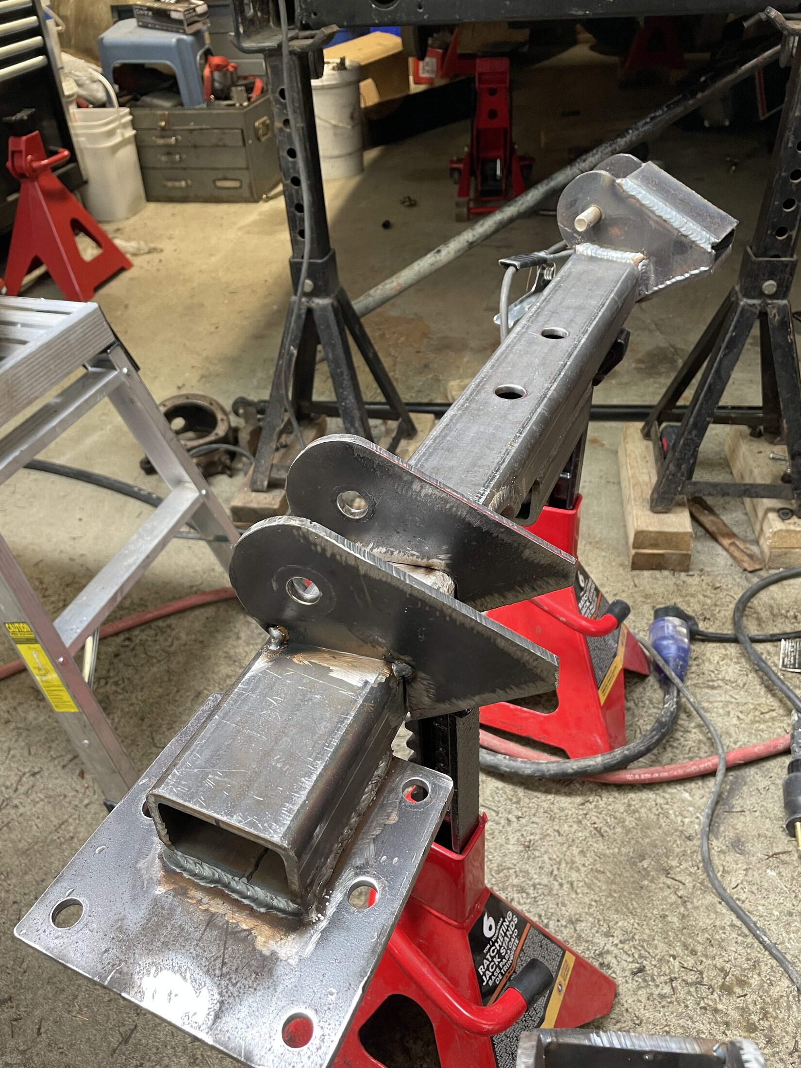

Parts are slowly arriving, marlin crawler eco seals, upper truss and knuckle gussets. Still waiting on my lockers, gears, and coilovers. Barnes 4wd is out of stock of there link kits. So i can only build the project as fast as i can get parts. I have ordered Ballistic Fabrication rear 80 series 4 link truss and diff armor, i wont start disassembly until i get everything in.

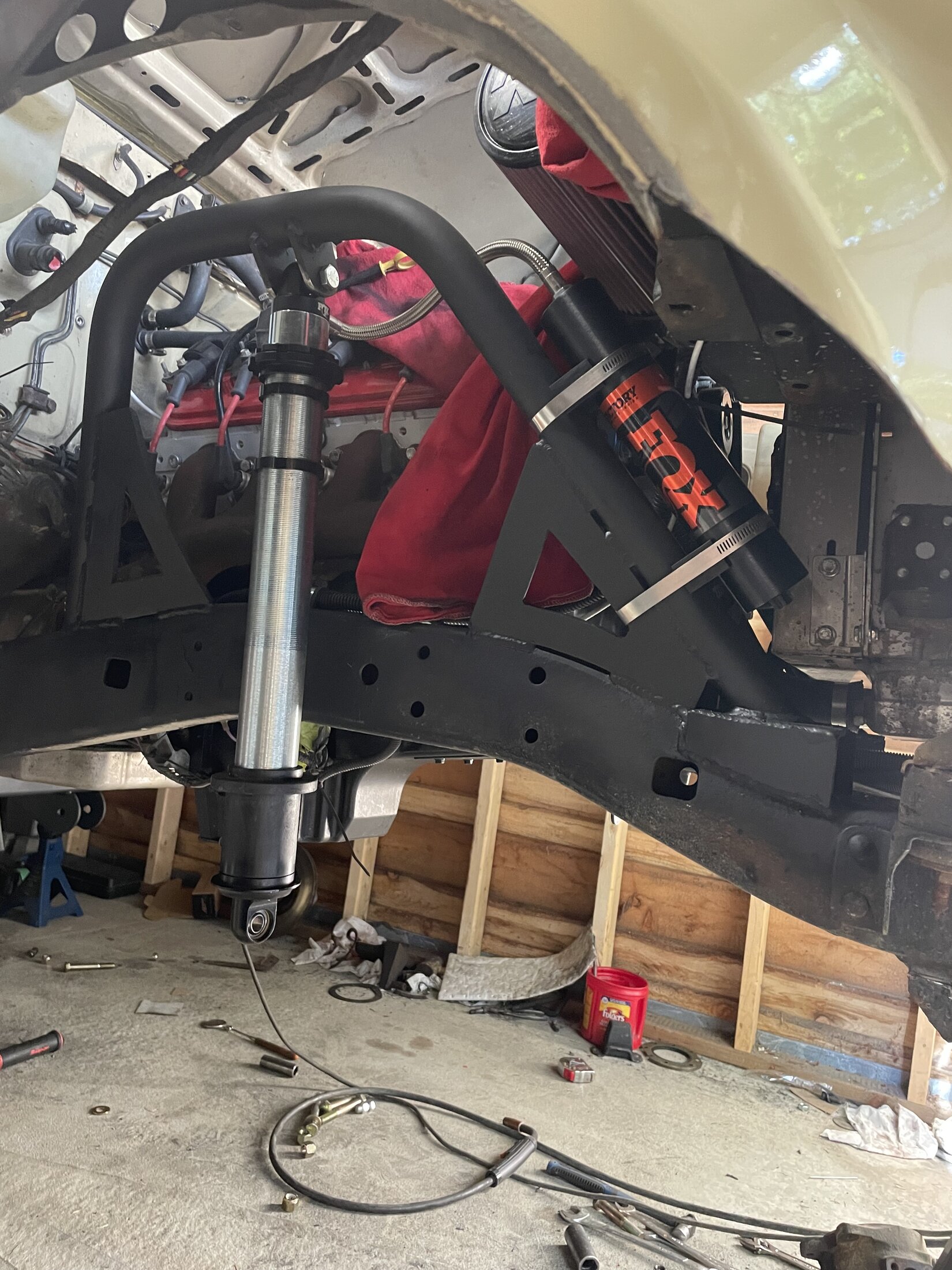

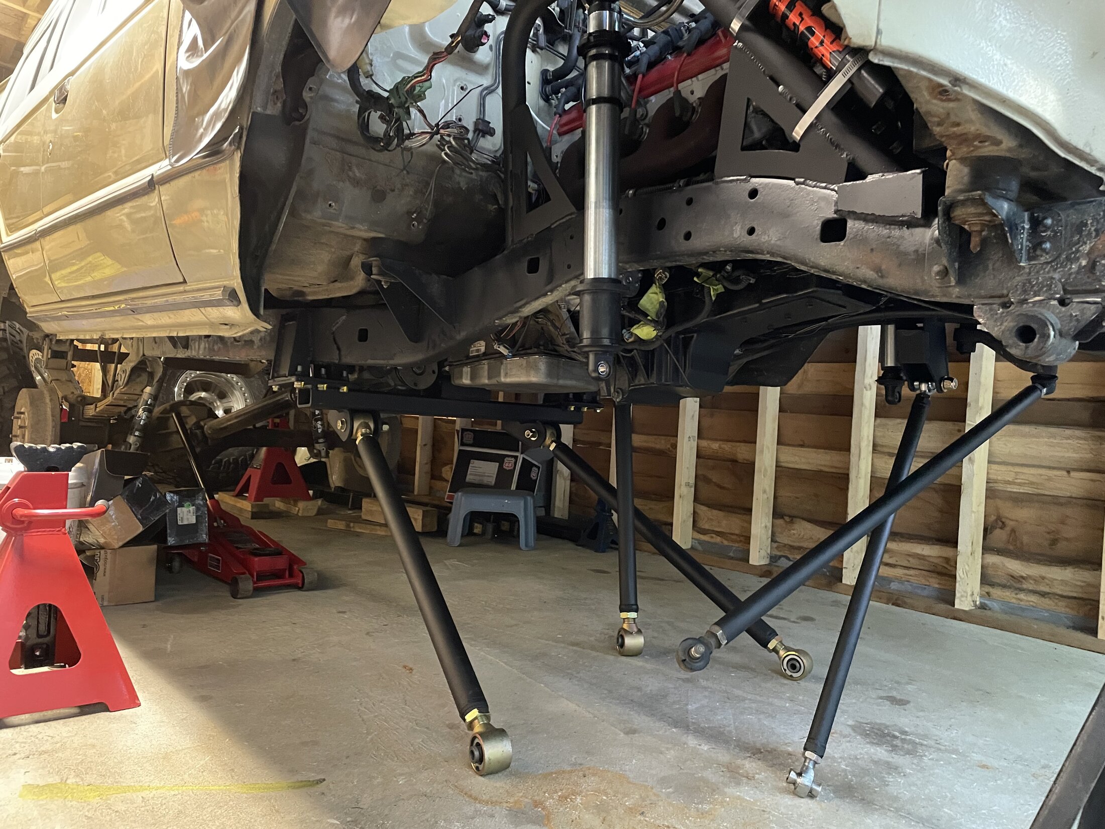

More photo dump, i have almost completed the 3 link conversion on 14” coilovers. Lockers and gears are set up. My compressors arrived and the last of many parts show up tomorrow to complete the my end of The Sasquatch build. We still need to get a tune on 91 and try and get as much performance out of the built 6.0l after its back on all 4

there was a lot of struggles and i was down to the wire. I was bleeding brakes on Friday and had my tuner drive 60 miles the following Saturday morning just to change some parameters and add timing. I scared myself a little when we needed to do WOT pulls and the performance from a built 6.0l is amazing. Even on 40’s this cruiser moves. The brake performance is better than stock the upgrades i did with all stock toyota parts was an educated guess if it was all going to work. The suspension geometry turned out perfect it handles extremely well and cruises at 55mph with one hand on the wheel. There is a few things we need to iron out but not until the truck is back from the fabrication shop for bumpers and sliders.
