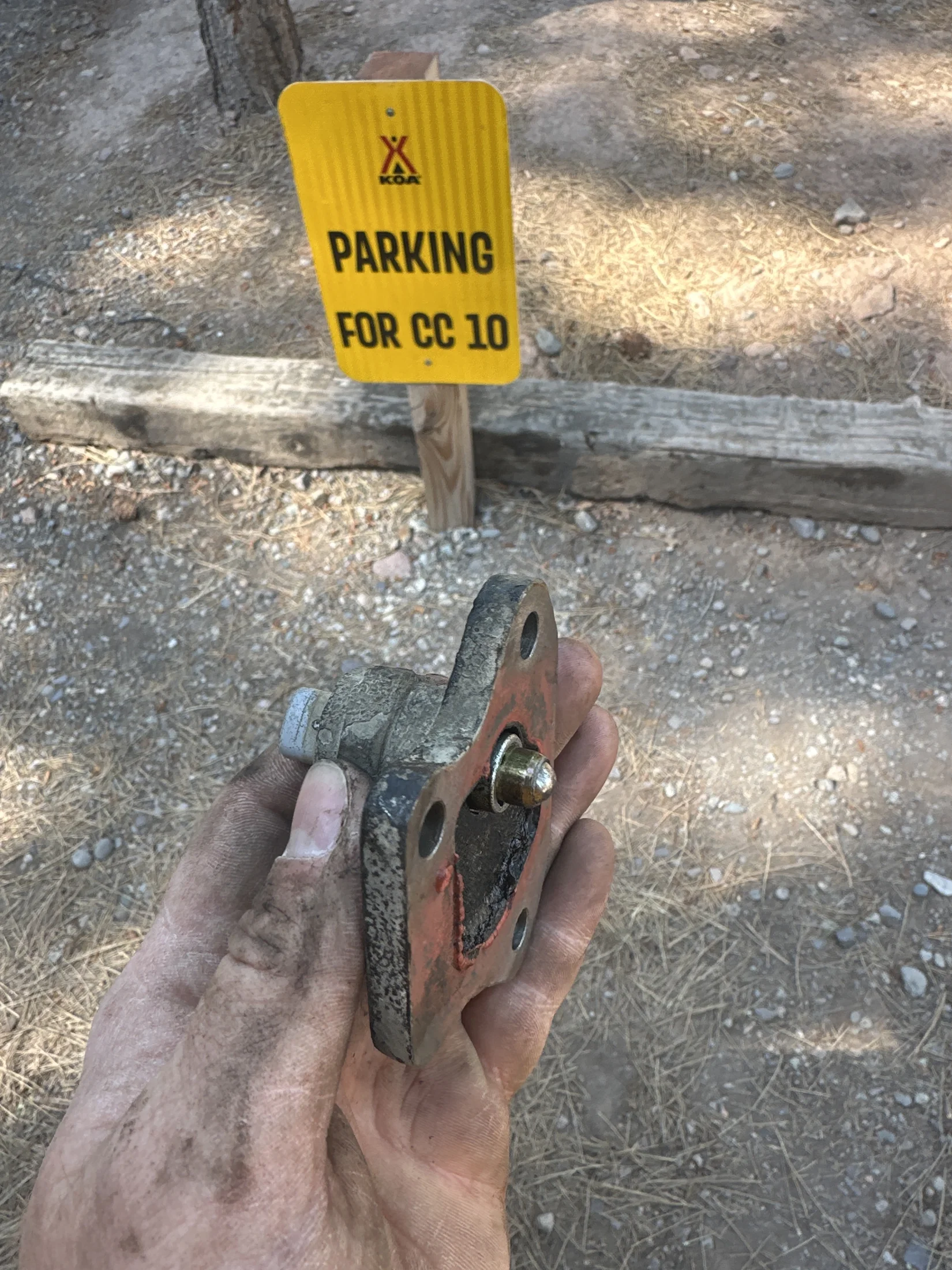

Would this rear diff locker limit switch prevent my rear diff lock from engaging? Rear diff locker wouldn’t come on, this switch doesn’t have continuity when pressed in.
That works the light . the locker will still engage press the button 50 times or so it will start working again . The contacts get nasty from not being used. If your locker still doesn't work crawl under the rig on the top frt of the t case you will see the same switch pull it 27mm do the same thing until it starts working . If that fails jump the tcase switch it tells the lockers the center diff is engaged and allows the the locker to work ..
Yeah I’ve tested the switch about a dozen times and no go. However, I’ve put everything back and the locker started to work. Not sure how it works without the switch functioning like I think it should. Possible my meter wasn’t picking up continuity.
Those switches rarely go bad the last click must have been the magic one. That switch only turns on the light in your dash your diff will still lock and the locker light will just flash . That is why I tell people to use thier locker couple times a year to keep the switches operating as they should
