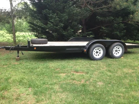

Lastly, probably the best mod since my SAS is the addition of my trailer. I've been pilfering trailers from a coupe friends since October but one finally landed in my lap a few weeks ago--Thanks Josh :cheers:
$1150 got me the trailer, a spare tire, 4 straps, 4 axles straps, a truck tool box and a chain dog. Not a bad deal at all.
