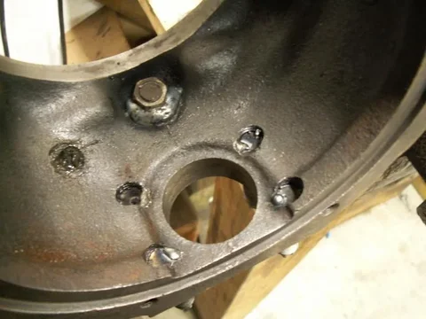

5th stud installed. One thing I did learn is that if you do not get the stud in very close alignment both horizontally and vertically with the other 4 studs you will not get the arm on or off. Obvious I know but the tolerances are very tight so take your time if you're doing this mod.

Keep in mind the order of assembly. Mount the steering arm onto the knuckle with at least 2 factory studs including cone washers. Then take your pre-cut 3/8 steel re-enforcing plates that are to be welded to the steering arm and set them in place. Now, tack weld those onto the steering arm and then measure for the drilled hole. This is where it gets a little tricky because the hole must be drilled at the proper orientation in order to get the stud at the correct angle. Now I suppose if you like sloppy holes it wouldn't matter but I prefer them tight. :eek:
Once drilled (remember the steering arm is still there now with 2 pieces of 3/8 steel welded) now insert the the 5th stud up and through the hole. Once you're happy with the location then weld the stud in place from the inside of the knuckle.
Here's where you know if you screwed up or not, try to pull the steering arm off. If you forked up and got the angle wrong you can't remove the steering arm because as you pull up it will bind with the misaligned 5th stud. Get it?
Okay, I kinda thought that might've been what you did when you said you welded it in. But when you said it wasn't a stud but a bolt, that pulled me the other way picturing it as removable. You shoulda just called it a stud - that's what it is now that you put it in the way you did. And yes, doing it that way would be a pain.

Get the hole drilled and tapped where you want it and reinstall the steering arm. Cut the metal "tab" that you need and put the hole in it for whatever size bolt you tapped for. Then, through trial and error, keep adding some bend to it (in a vice, off the truck) until, when bolted in place, it's lined up with the steering arm enough to tack them together. Pull it and the steering arm off with tab tacked on, weld it up while its off and you're done. There may be a tiny bit of adjusting afterwards if the welding moved the bracket some, but I can't imagine it'd be anything major. At that point, installation and removal of the arm from the knuckle wouldn't be any different than it ever was once you've removed the one extra bolt from that tab. Walla!!, 5th stud mod without all the hassle later due to alignment problems.
The target for the hole is very small and very specific, if you miss it you get into the ball of the axle housing. Notice the little nook in the pic where the bolt head is. (not my pic but same)

The drilled hole is not tapped, it's not straight up and down and nor does the tab lay perfectly flat on the knuckle so there are many variables to consider, thus the dry fit
The knuckle hole has to line up perfectly with the hole in the welded tab and be at the exact same angle so the bolt will fit through. The only way to do this is to drill the hole through both the welded tab (while in place) and then through the knuckle to accomplish this. Short of drilling out the hole bigger there is no adjustment after it's done.
Did you weld the knuckle studs at the inside of the knuckle like the picture you posted?

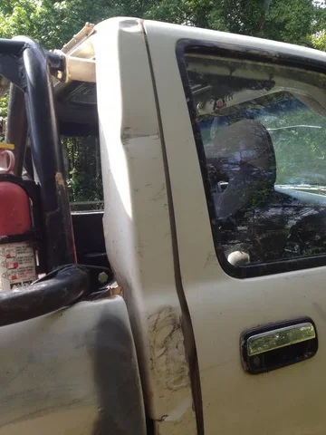

Trail 10-12-13 and out. As best I can figure I crunched the B Pillar near the bottom of trail 12 cause I really don't remember anything major happening but it's consistent with hitting a tree. The door wasn't touched b/c I wasn't running doors at the time. :hhmm:
