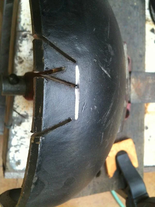

After emerging from the TC ride John and I both sustained nice dents in our front axle housings so John ordered up some 8" weldable pipe caps to resolve the problem.
So today I stepped out of the office around noon and got to work on mine, 3 hours later this is what I came up with...
Step 1: Cut along dotted line :wrench:
Step 2: Add a little bling/reinforcement:grinpimp:
Step 3: Weld to axle housing :banana:
Step 4: Never have to worry again!! :cheers:

That thing is going to fill up with mud on the first trip out. Where are the drain holes in the bottom?
Just stick a hose in it and let er rip!! The mud will come out.
you guys kill me, oh ye' of little faith!!
Drain hole in the making!:clap: BEFORE installation, geez! :flipoff2:

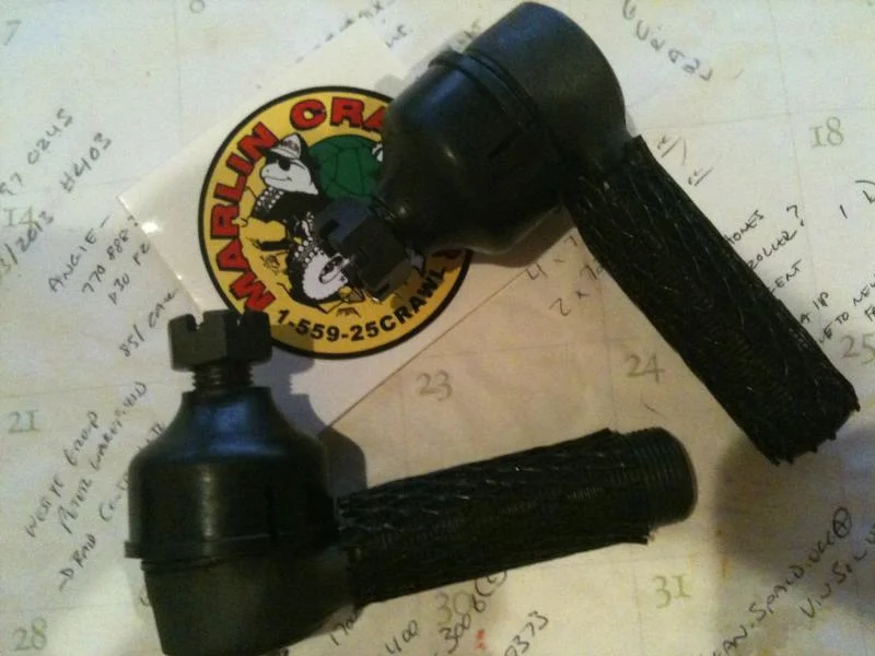

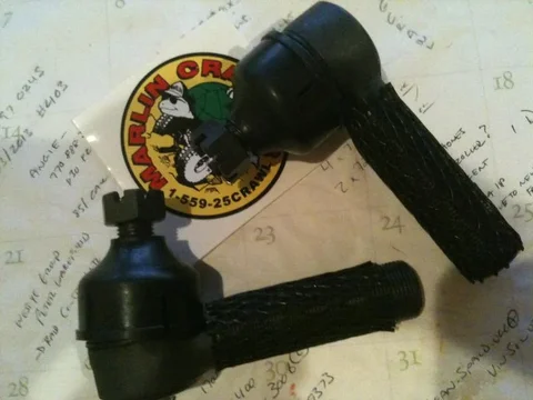

Well after bending the pi$$ out of my tie rod at GSMTR a few weeks ago and then driving home on a "booty fab" repair it was time beef it up a little. A quick call to Marlin and a week later I got some good TRE's and expect to have a new stronger TR build by tomorrow. That will leave my current "S" shaped one for a trail spare.
The problem, well not really. This is actually the result of the problem, a POS part.
The partial Solution

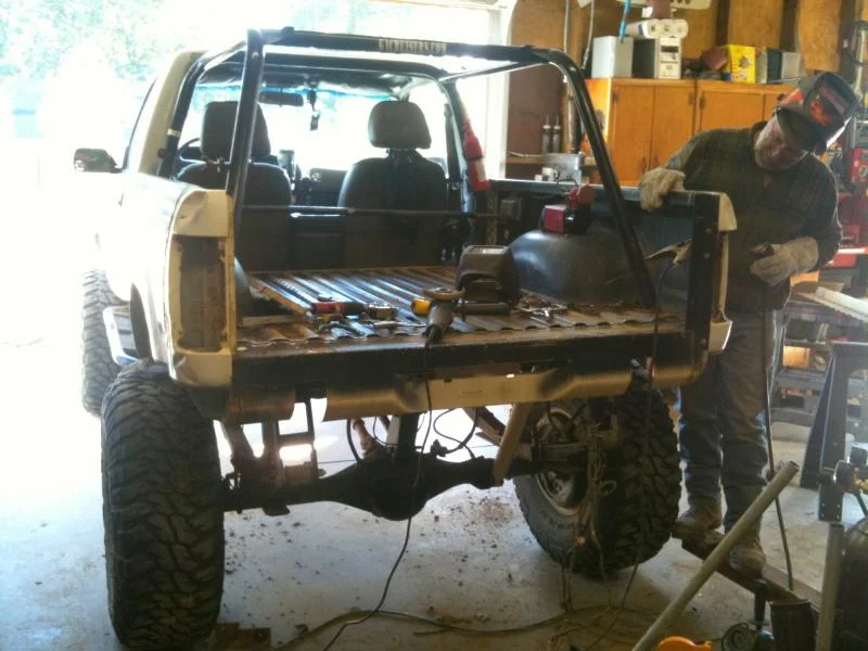

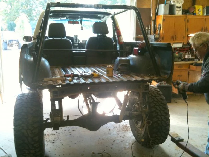

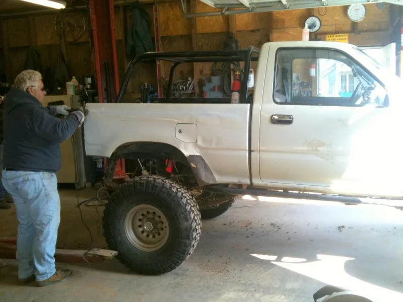

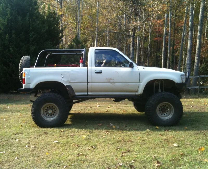

not finished yet but made good headway. lights all welded back on, now just to reattach the bumper and add a little body work and paint and we're all good.
Now just under 12" shorter

Been a long time since Ive seen it up on the Whee in the snow, but looks like you have made great progress!
