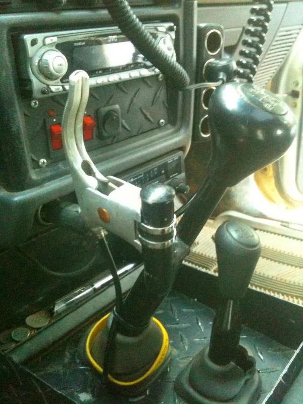

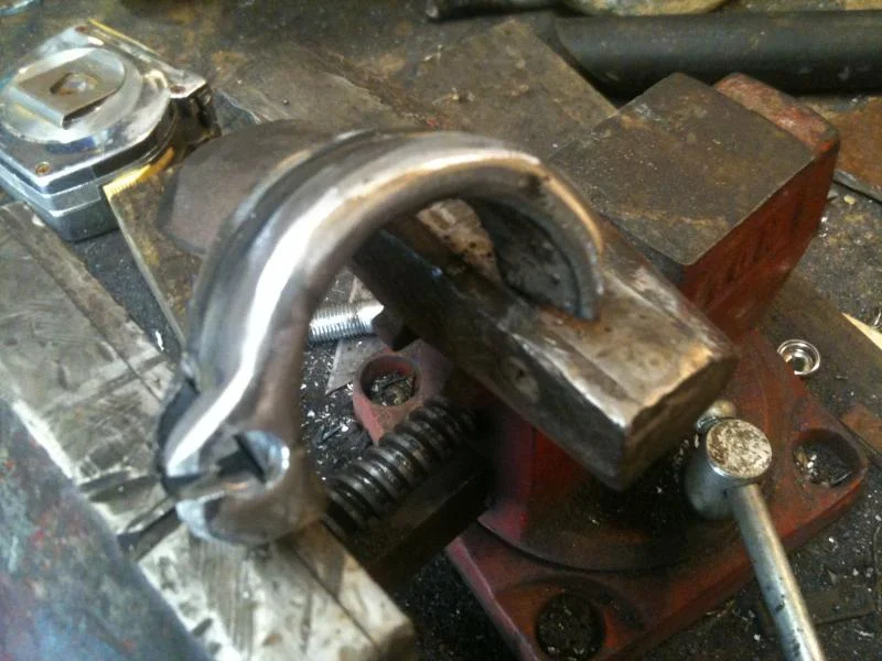

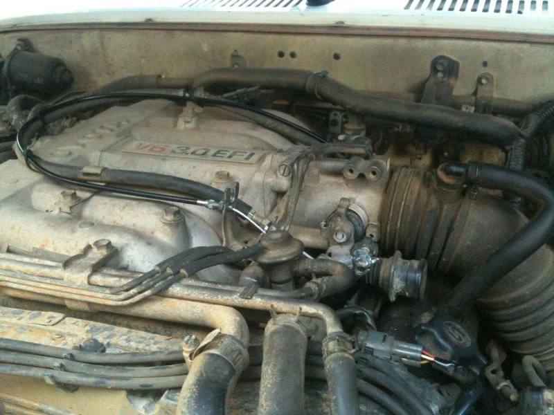

Finally got my hand throttle installed, gonna take some gettin' used to but it works. Pulled a hand brake from an old Schwinn 10 speed, found some brake cables at Wally world and a little fab work to tie it all together.
fabbed this up for the throttle body, pictured upside down the cable runs in the channel and slips into the hole on left side
ran the cable and strapped to the OEM throttle cable
mounted to the shifter off the left of the knob so it wouldnt hit when you pull it back.

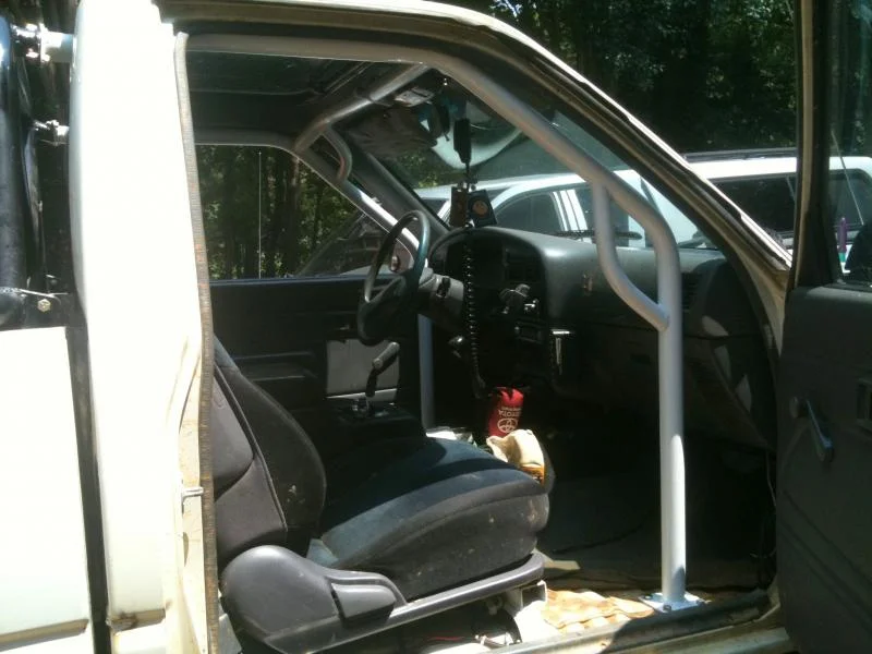

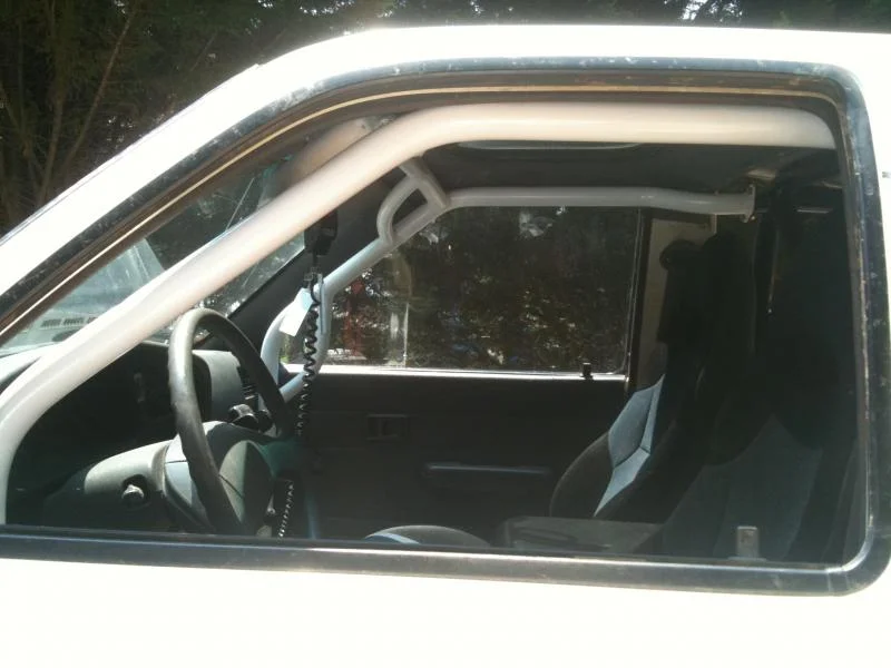

Where's your helmet? You're gonna need it with an in-cab cage aren't ya?
Nice job on it for sure though! I see its bolted to the floor; is it removable? Where'd ya do the bending?
it's close but you aint tall nuff to worry bout it:flipoff2:. Yep, removable. All bent, cut, drilled and welded under the burnin sun in my driveway.

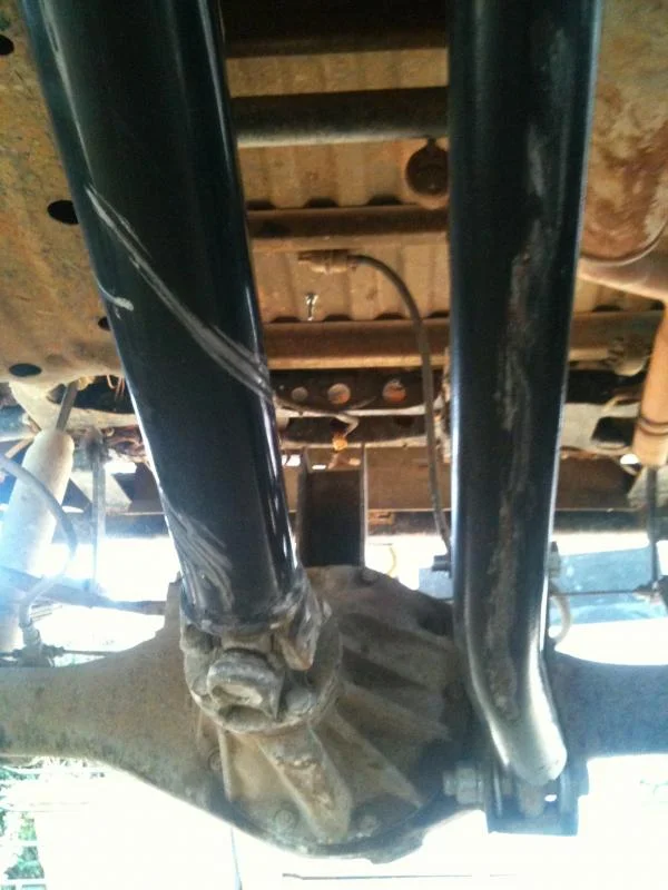

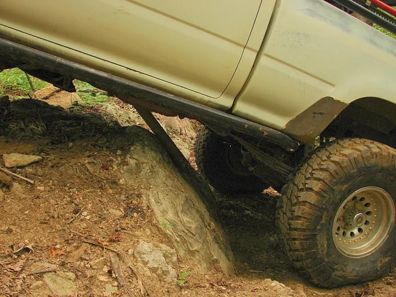

Finally got the junk running again. After breaking my drive shaft at Ralphs in July again I'd decided that I'd had spent my last dollar fixing the same part twice.
broke it trying to get up this rock, caught the shaft near the diff flange and snapped like a twig.

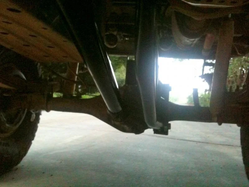

So, to prevent that from happening again I moved the trac bar from the top of the axle housing to run along side the drive shaft. It sits about an inch lower than the shaft and now acts as a guard against rocks.
Pre-bent it toward the drive shaft to get it close. Only thing left to do is flex out the rear suspension before burning in the welds and cut the shark fin off the top from the old bar.

dammit man, rubbin salt in the wound. :flipoff2: Ron's drive lines did the work, did a great job and super fast. 3 miles after installing the new shaft I put a nice new modification to it. :bang::bang::bang:

the evidence: An "A" for effort and a "B" for execution on the new trac bar, just glad it wasn't an "F"
Ron's wouldn't do Toy/Metric work for years...
I'm diggin' the traction bar/protector idea.. might steal that idea! :D
