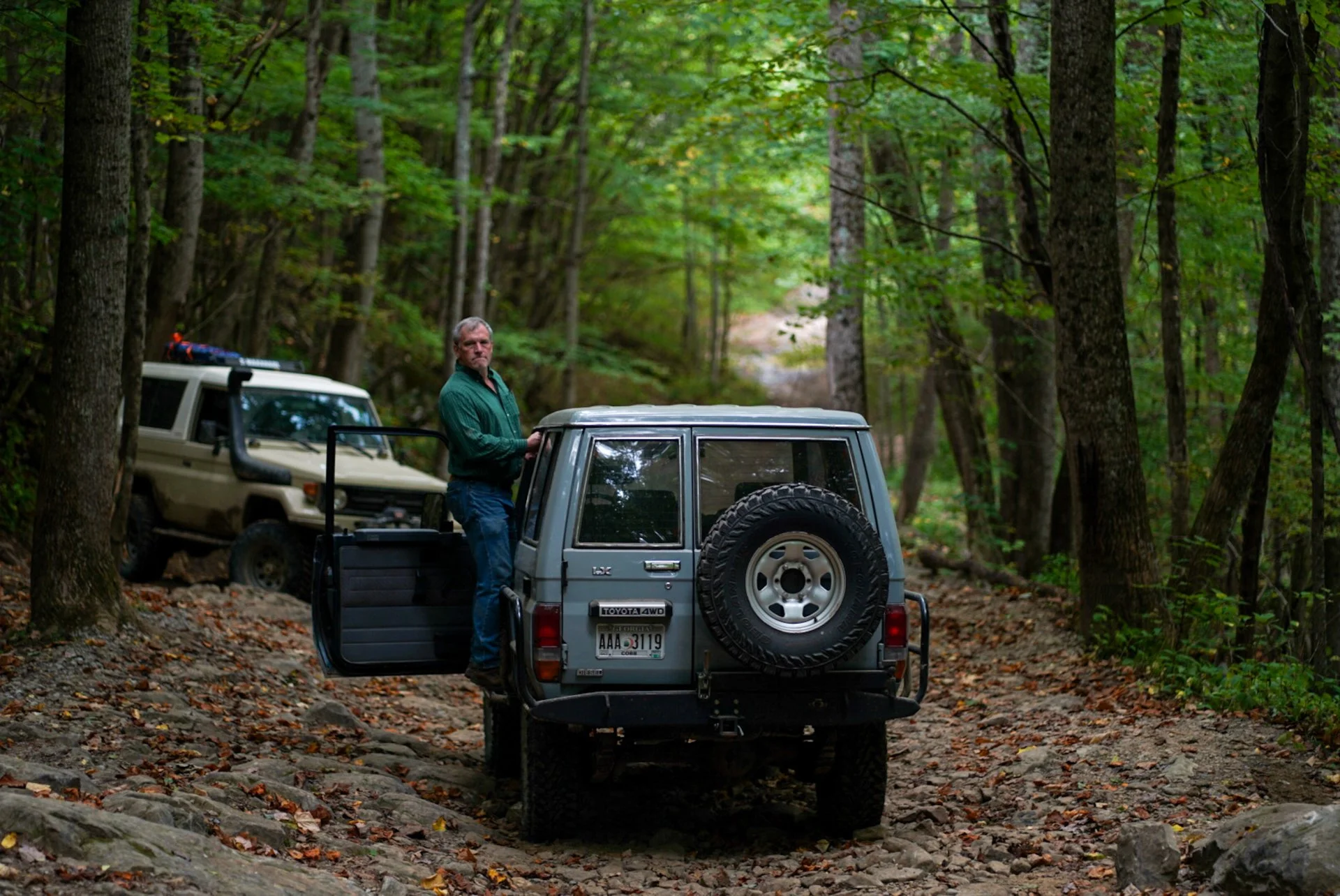

I have not been as productive in caring for the 70. Rather just out playing in the woods. Last Saturday, met some friends from an easy day of sight seeing in the Talladaga NF. These friends are very into Rovers, so most of the invitees drove LRs. We did have two Toyotas.
Coming down for the 70 Series Meet-n-Greet?
I even was lucky enough to have our youngest daughter along for the day (in this modern world, they even let medical resident have a day off here and there ... lol)
