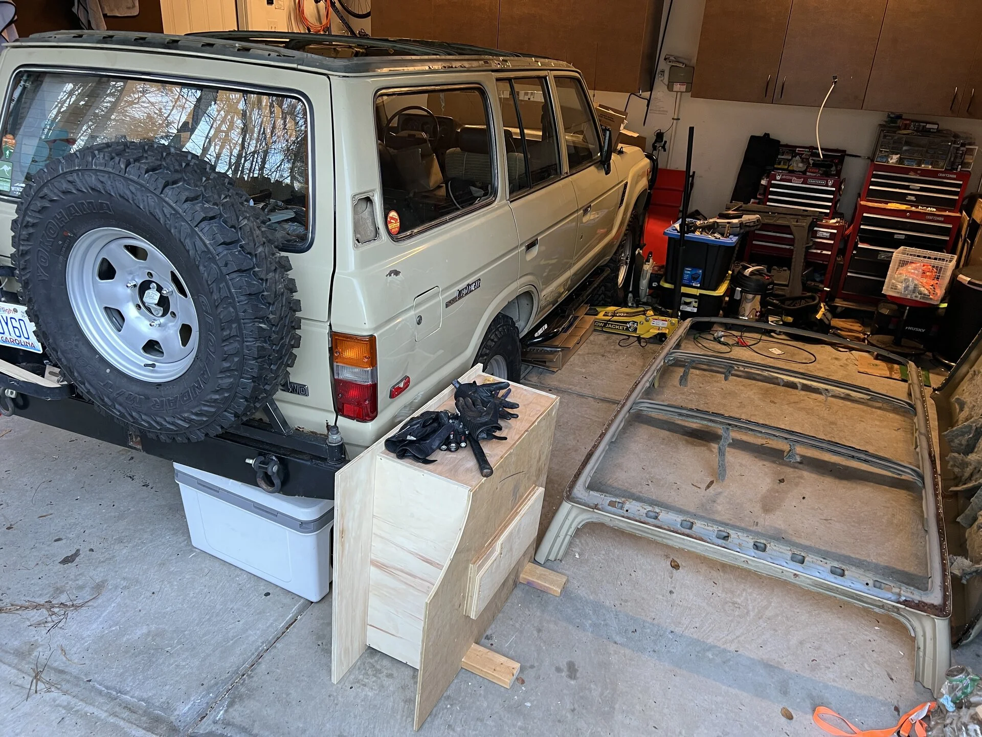

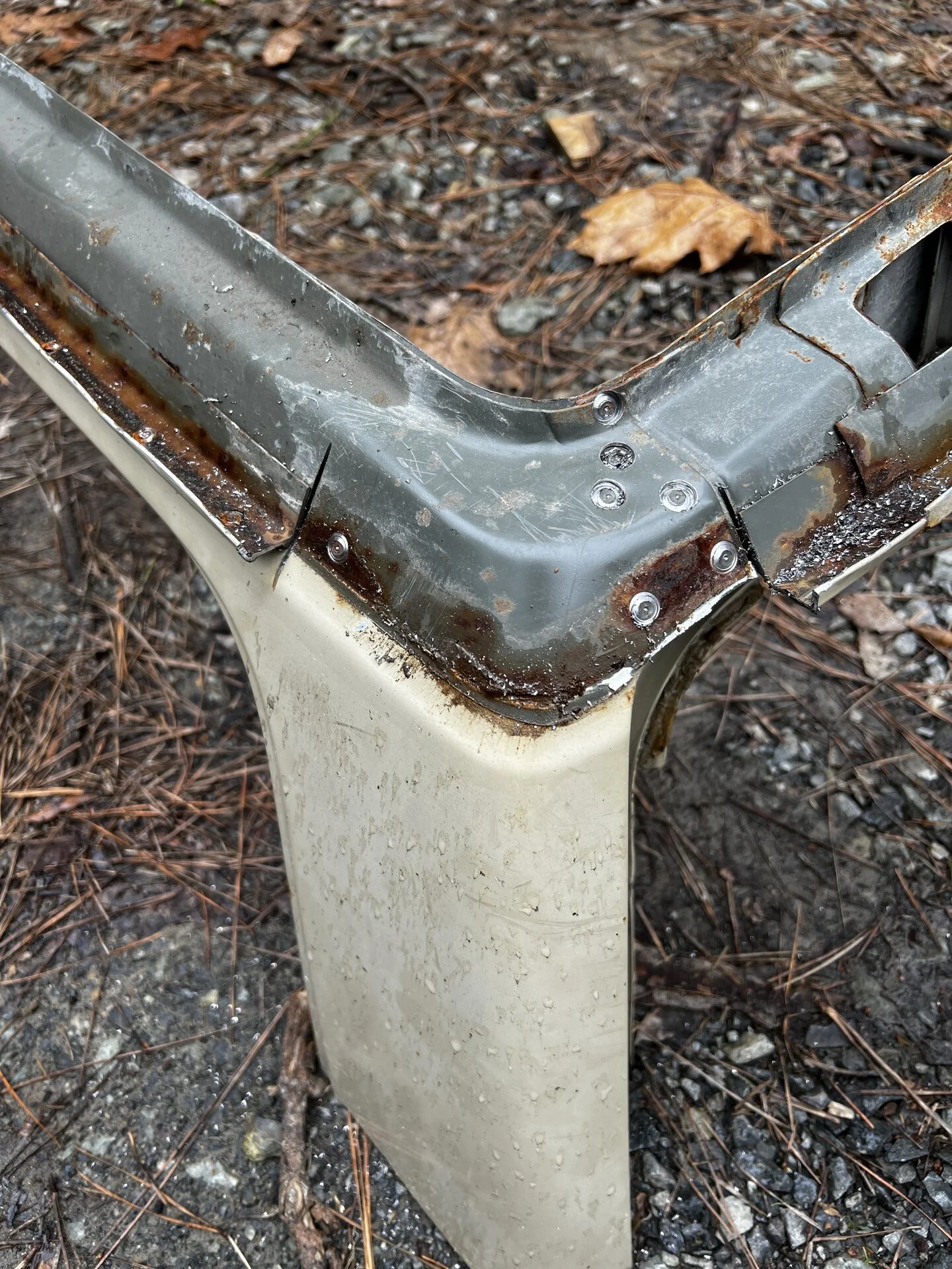

Yeah I could have reused the old skin and patched it. My "rust free" donor roof that I bought earlier in 2022 from someone turned out to not be rust free. Looked fine outside but, once I got the skin off, the inside was rusty whereas my factory roof skin looked rusty outside and was good inside. The donor skin is still in better shape than the factory one so I still plan to use it. It would be infinitely easier to patch it off the truck if someone didn't have a donor roof. Plus with the drip rails needing to be refilled on most of these trucks, given relatively low amount of effort it takes to remove the skin, there's no reason not to take it off for any type of roof rust repair. It allows you to check out the inner structure and repair it correctly.

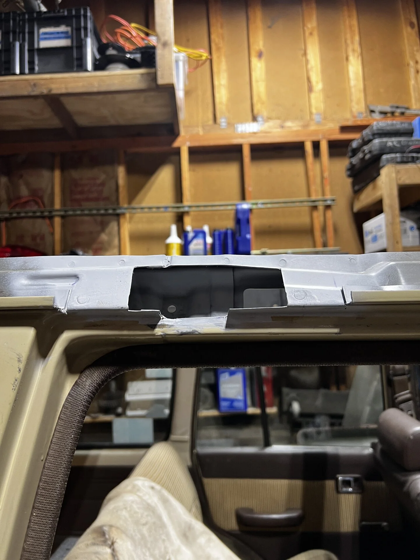

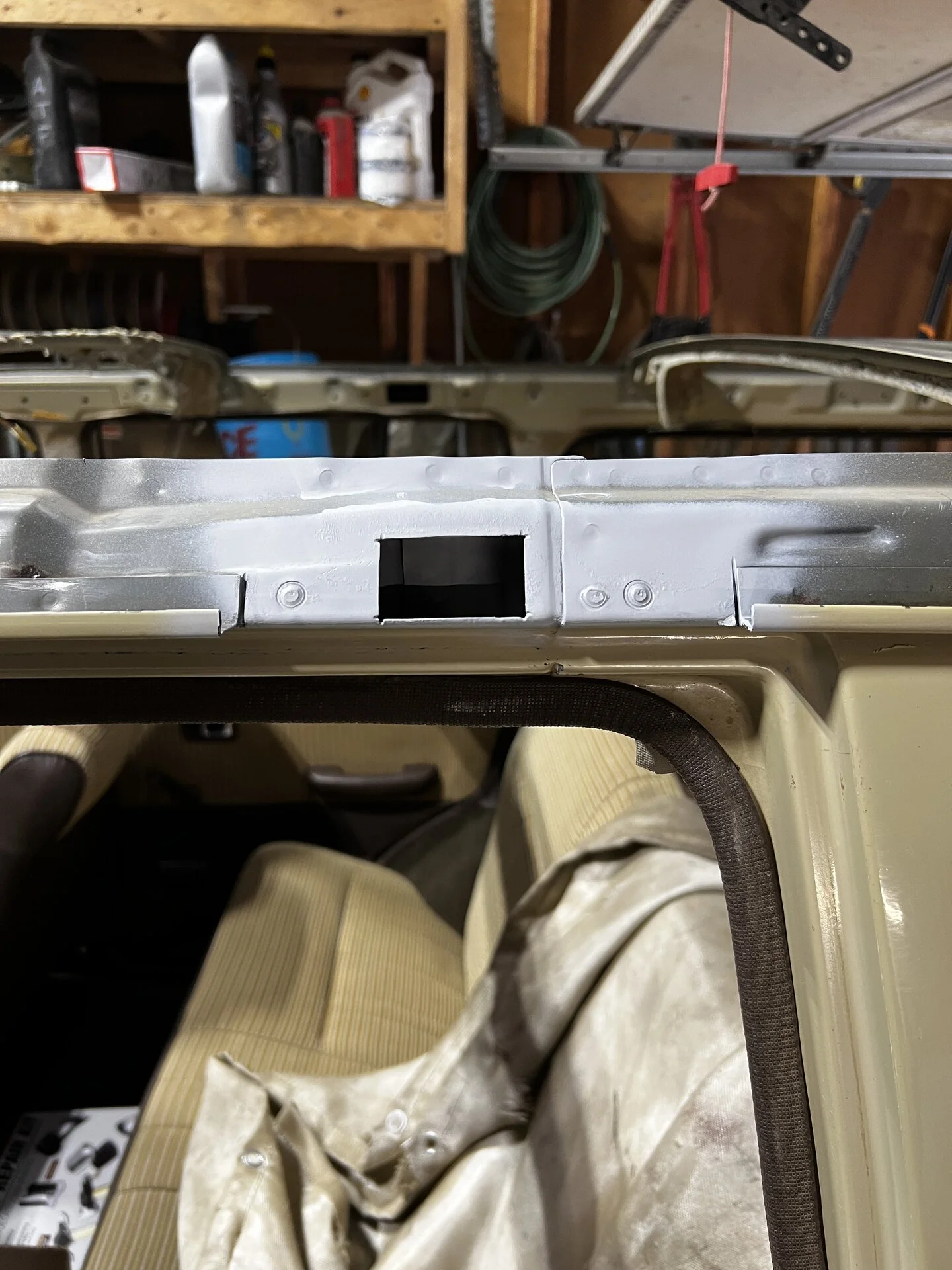

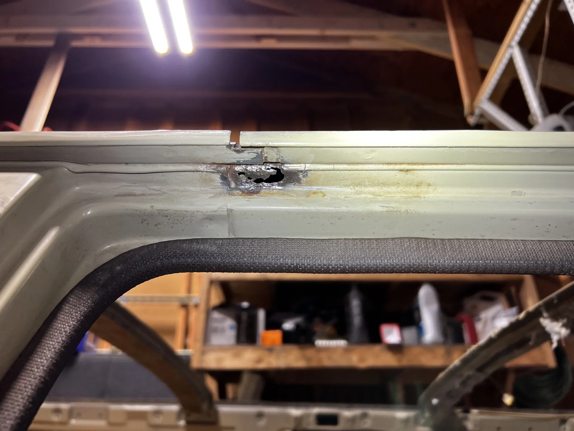

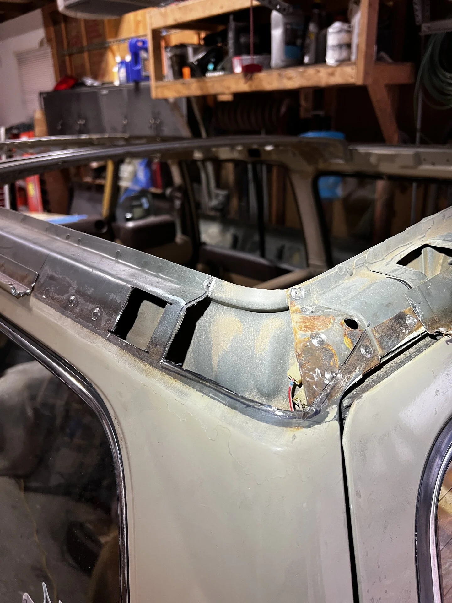

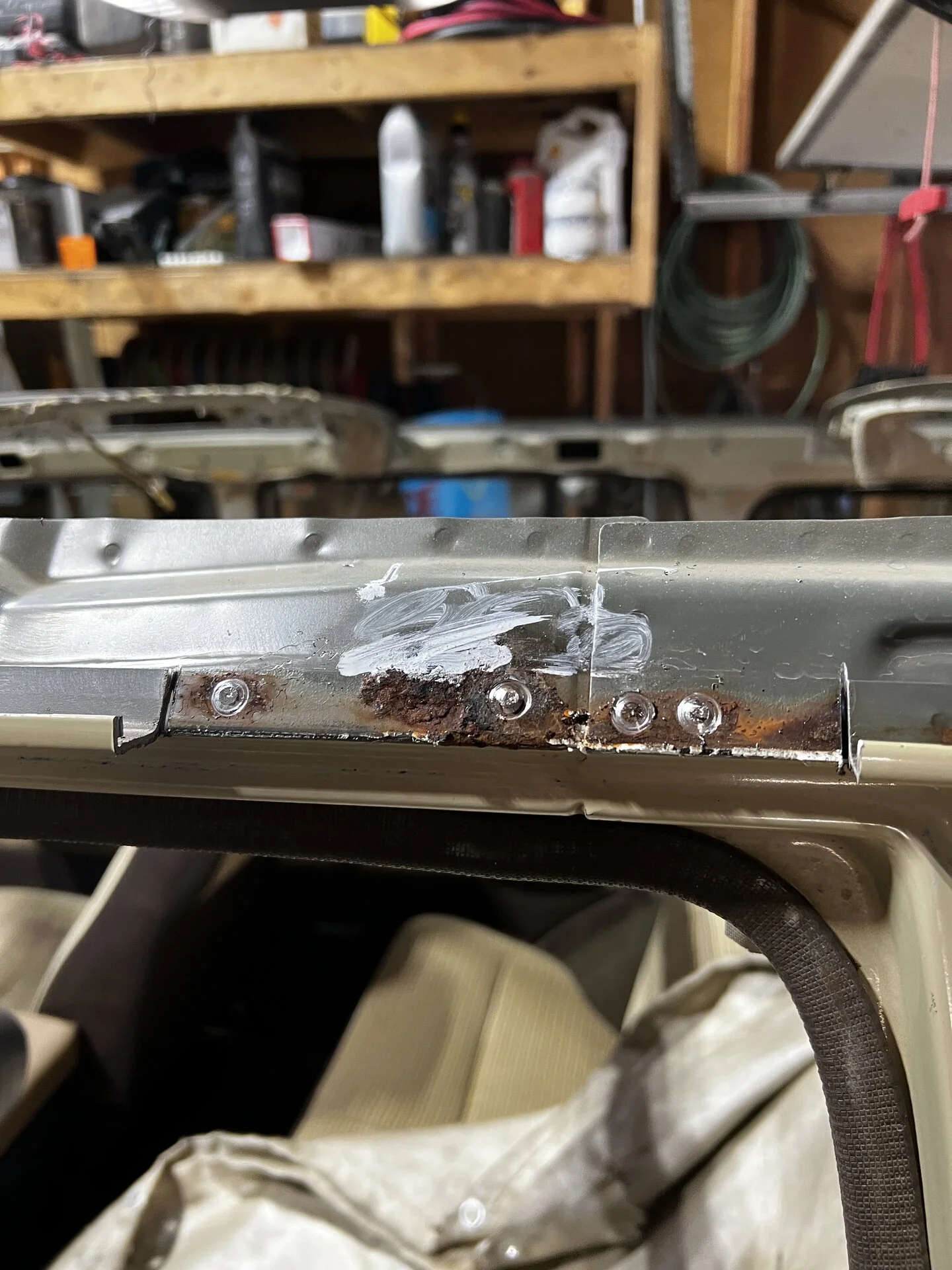

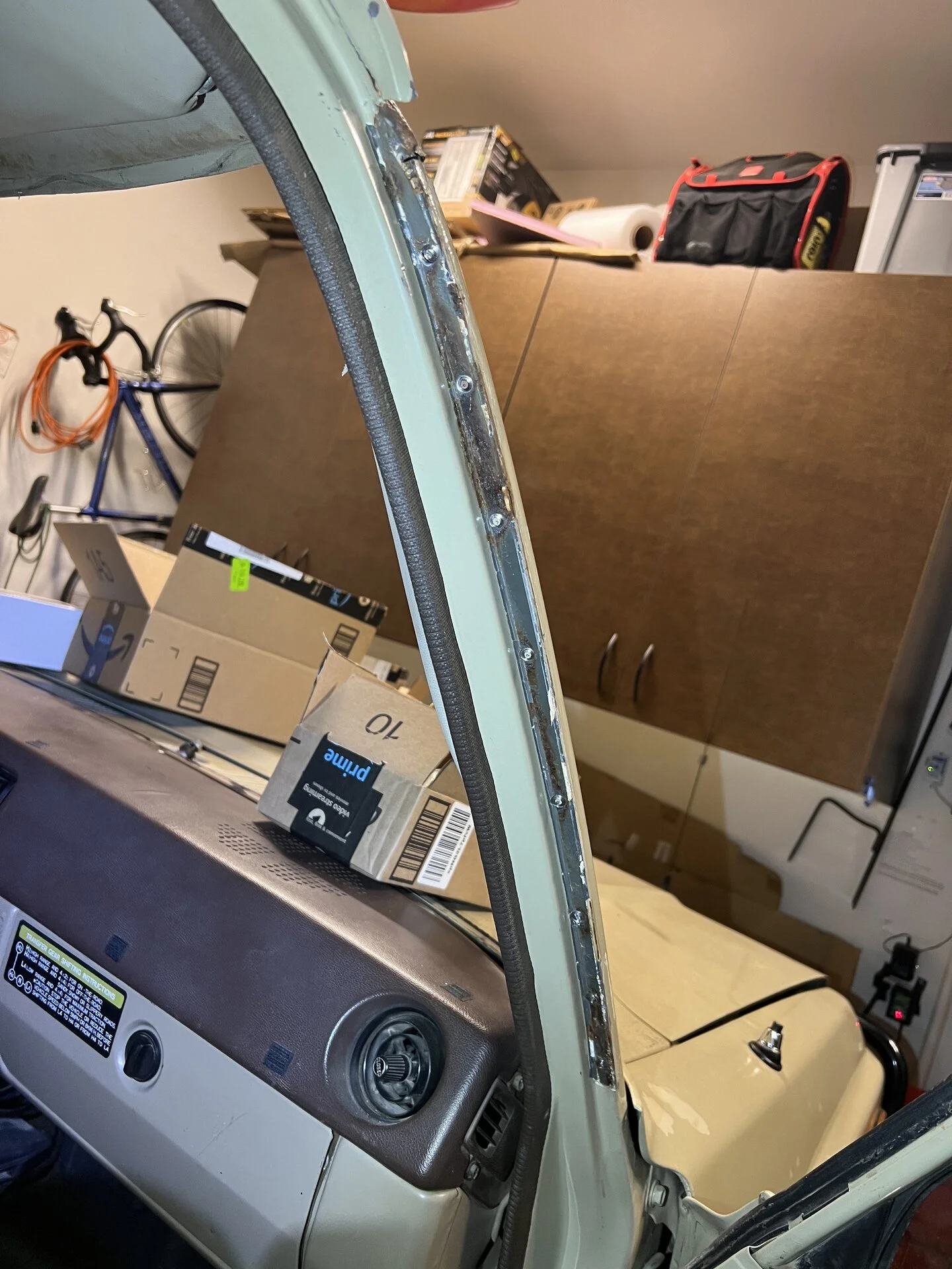

Both skins off and the a-pillar gutters are also off. There was a little surface rust poking out from behind the a pillar gutter so I zipped it off to check. Sure enough, just some mild surface rust underneath. Luckily nothing that can't be easily remedied. Metal work should start this weekend.
While the donor roof was advertised as rust free and looked great on the outside, you can see it was in fact, not rust free on the inside...but we will prevail!

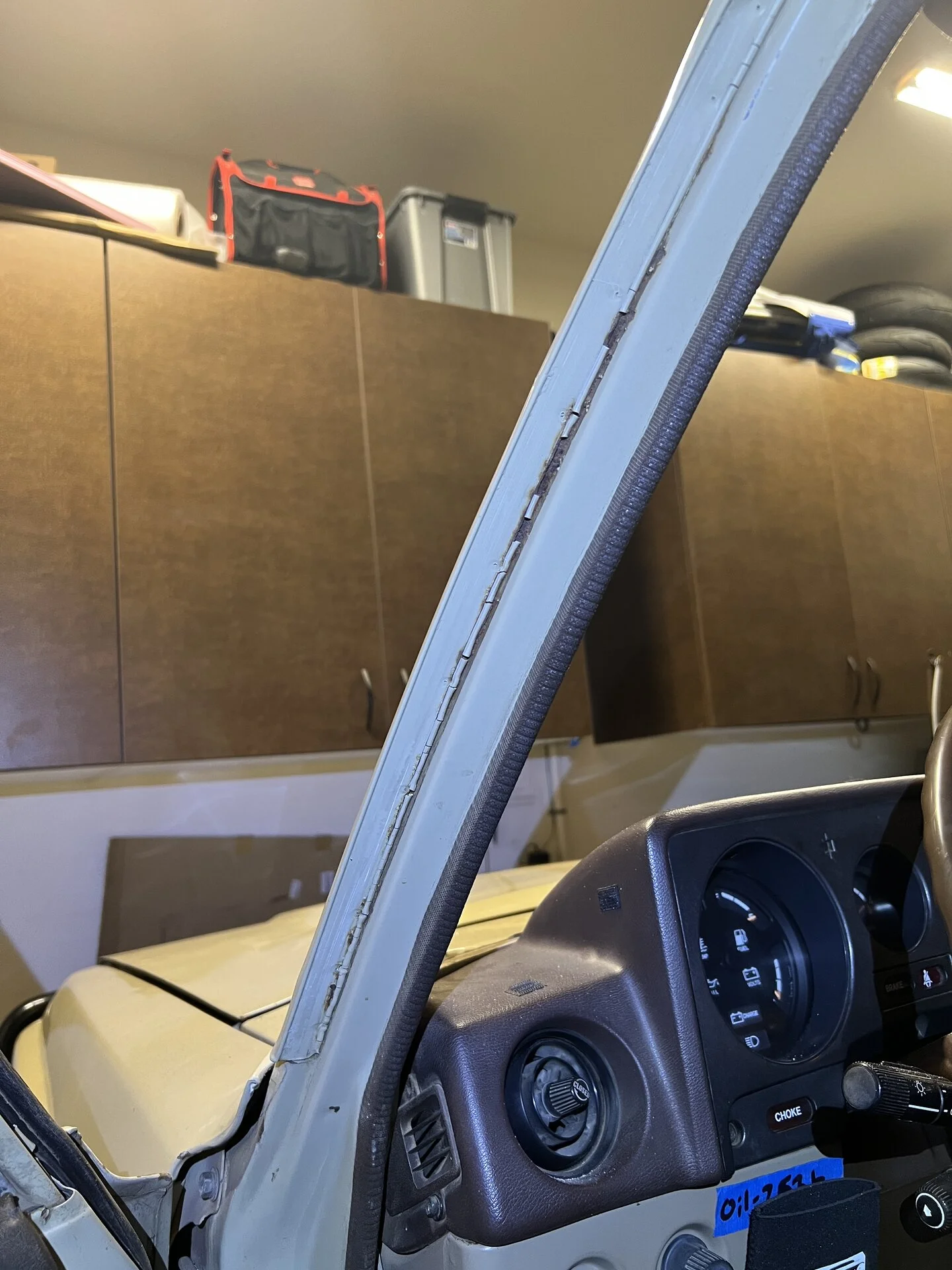

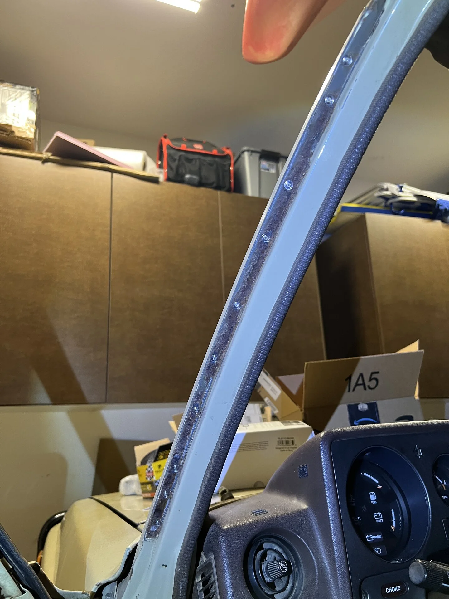

This is so awesome to see. I think 50% of the cruisers I see around here have that rust under the A-pillar gutter. After digging in as deep as you have do you think it’s possible to remove the A-pillar gutter without removing the roof skin? Appreciate your thoughts. Jimmy
Yes, they can come off without pulling the roof skin. There’s a small gap where it transitions down the a pillar that I cut to to separate it from the gutter along the top. Then it’s just spot welds along the inside.
If the donor roof is any indication, even trucks that look rust free from the outside likely have some serious rust on the inside.

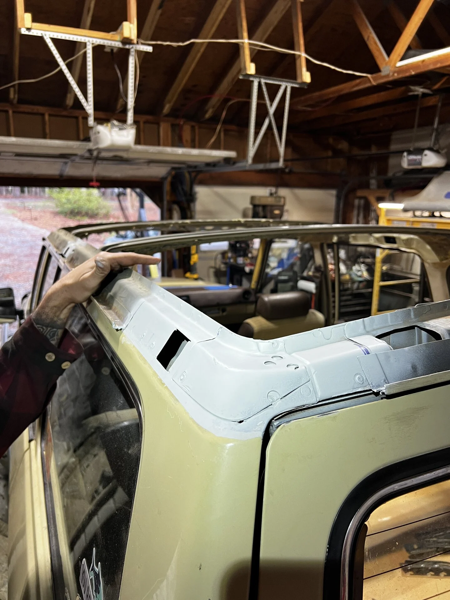

Today was the start of addressing the roof rust. I had taken the cap off previously but we carted the old skin, donor roof, and truck over to the healing room with @GLTHFJ60. Huge shoutout to Johnny for helping make this happen and offering to host the repairs in his garage!

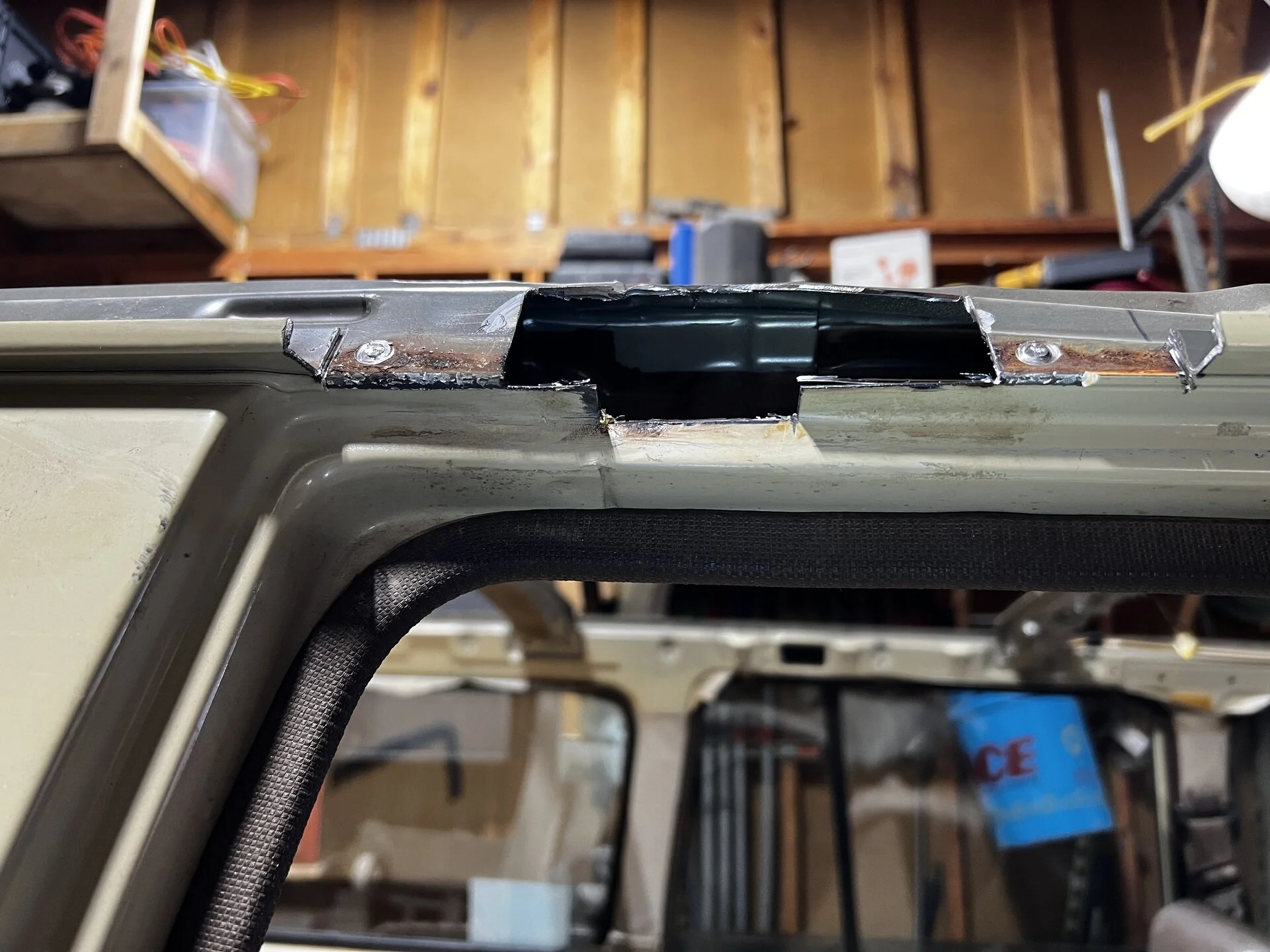

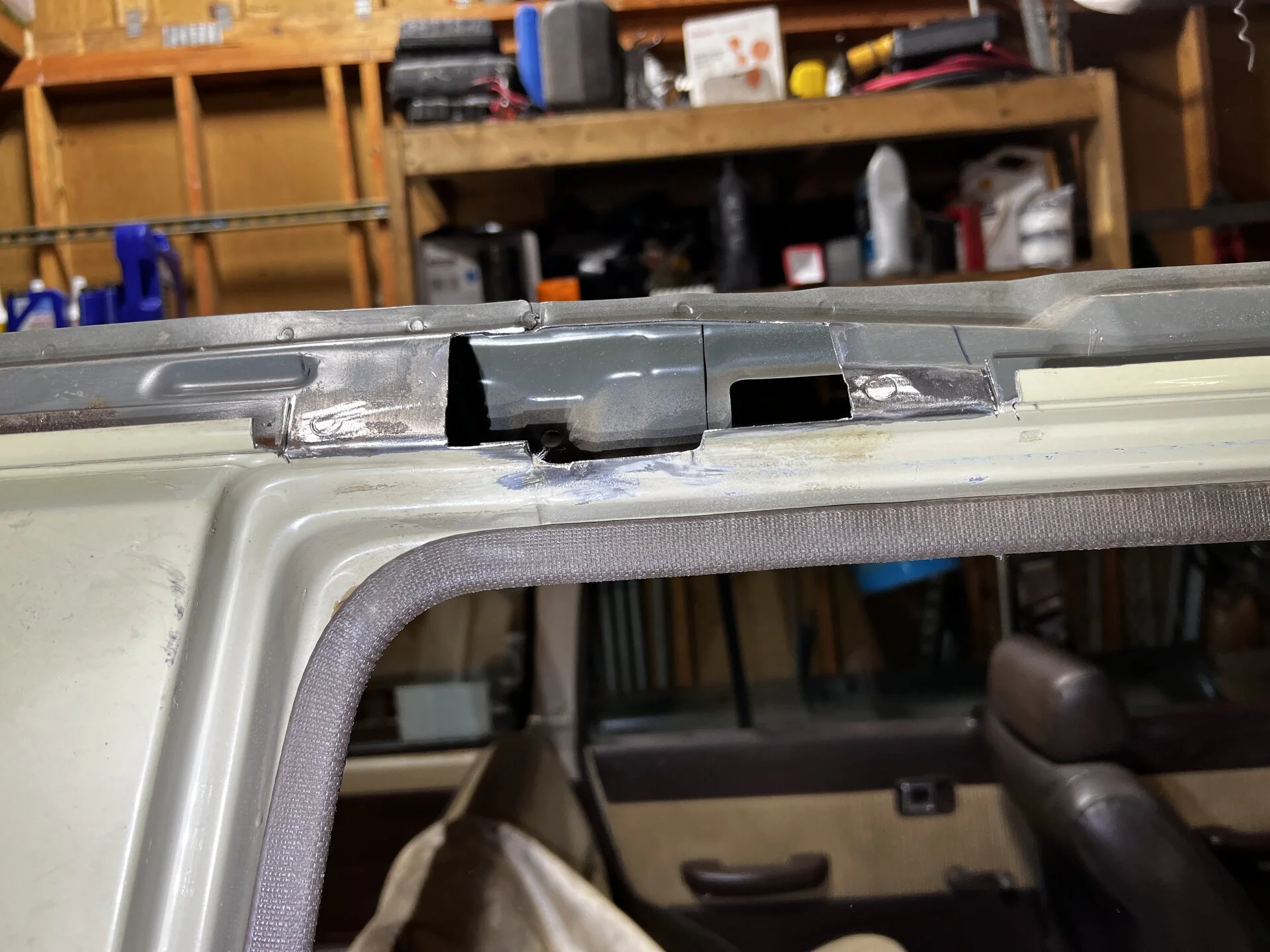

Today was mainly comprised of cutting out the rot and making some patch panels. We started on the area above the driver rear door. We followed the same steps on each area today.
1. Mark out area to be removed.
2. Drill out spot welds on the gutter and cut the gutter out
3. Wire wheel the area and cut out the rotten metal back to clean metal
4. Clean up the edges of the cut metal and prime with weld through primer.
5. Cut good metal from the donor roof and shape/finish to fit
Driver rear door.
Spot welds drilled and started cutting gutter
Gutter removed
Wire wheeled
Sectioned

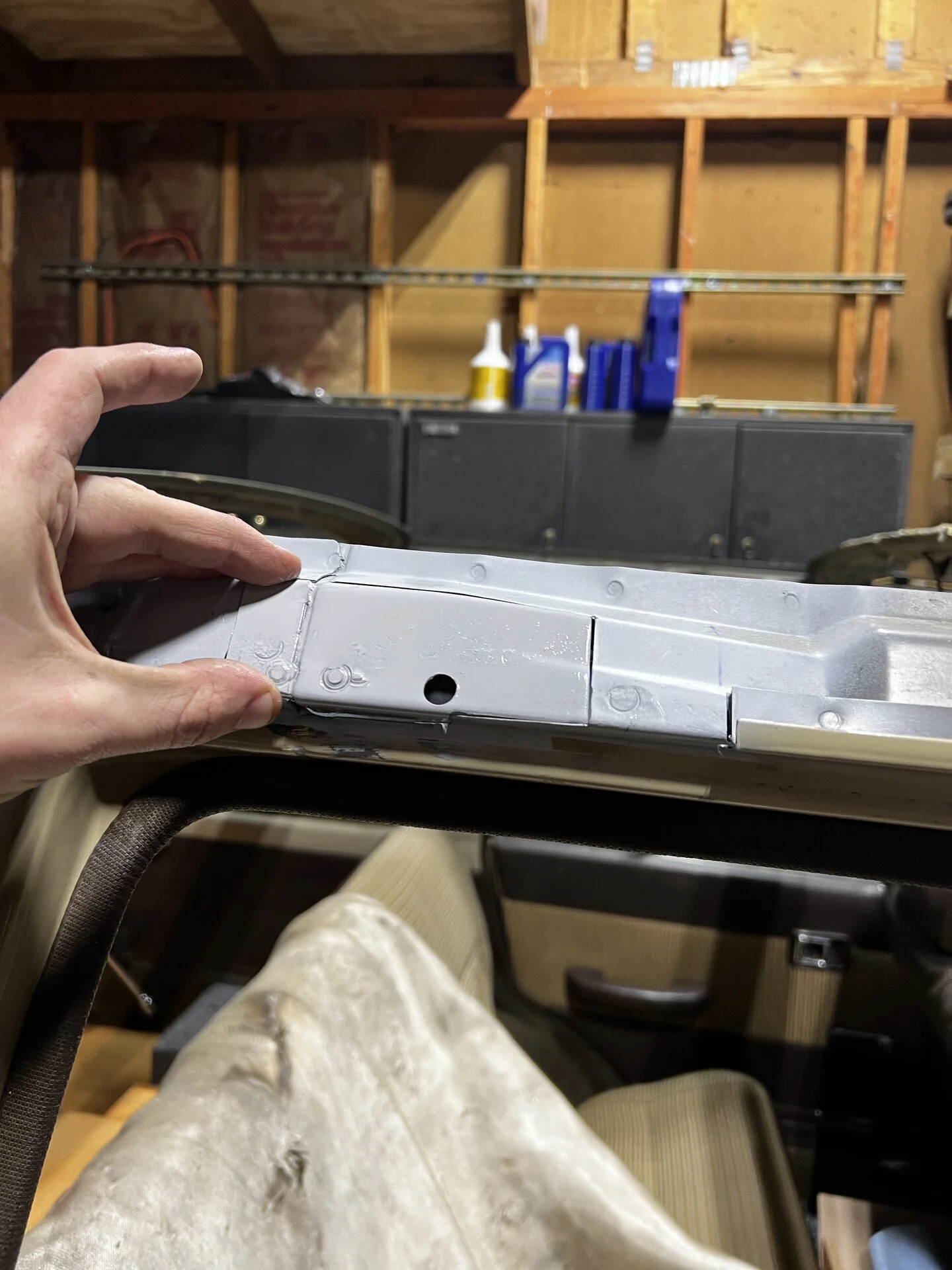

Primed
Rear corner primed and the big patch panel laid over top showing how well it fits

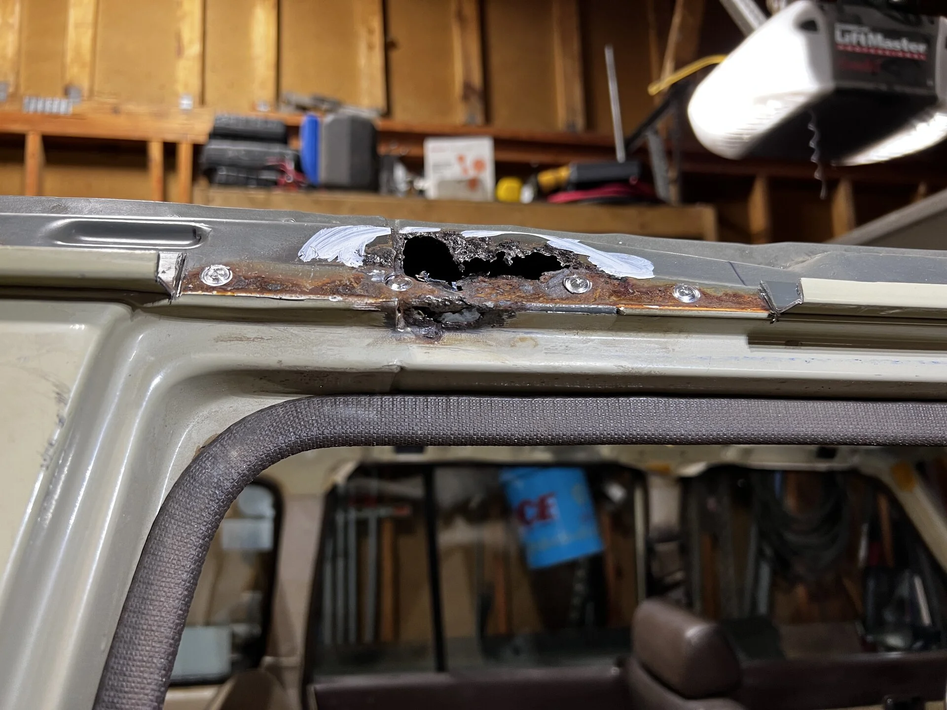

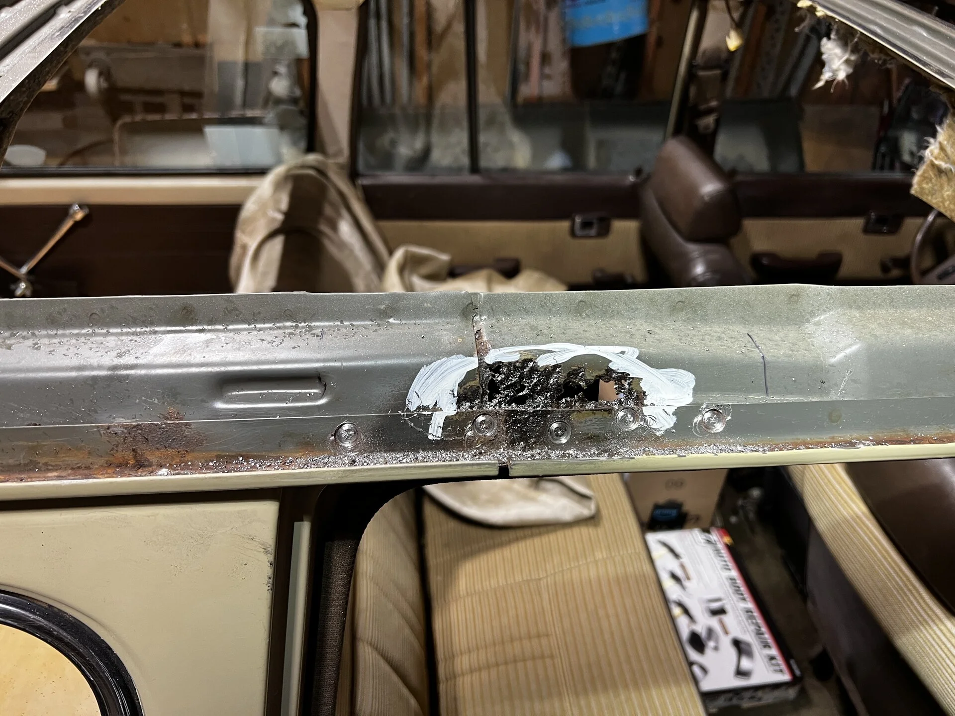

Next was the passenger side. There was only one area on the passenger side needing attention. We'd thought the passenger side would've been worse due to the rust going down further above the rear door but it ended up being an easier patch.
The area in question...looks bad!
Gutter removed
Rust cut out
Next steps will be to weld in the patch panels and weld the gutter sections back on as well as the a-pillar gutters which I took off previously. Then we'll move on to repairing a few areas of the new skin that need attention. I'll keep the thread updated with our progress. Once we get completely finished, I'll post a separate thread detailing the process to make it easier for others wanting to tackle this job to find and reference.
Of note, the primer is weld through primer. Good stuff.
