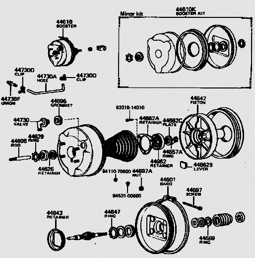

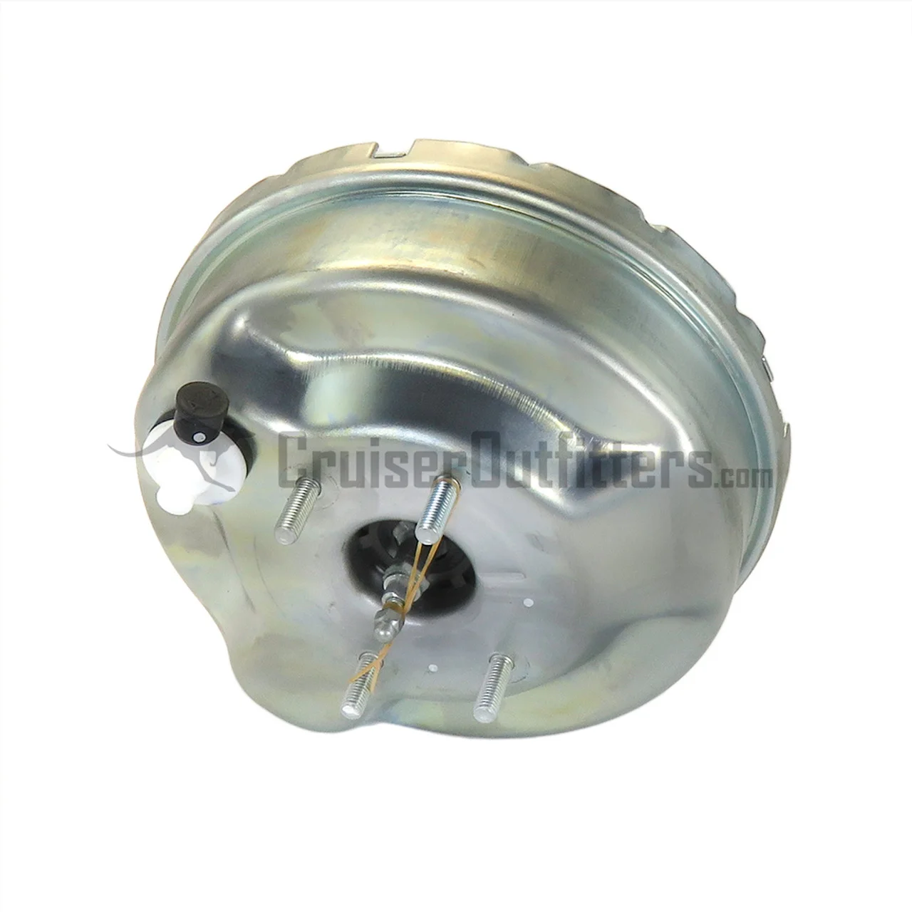

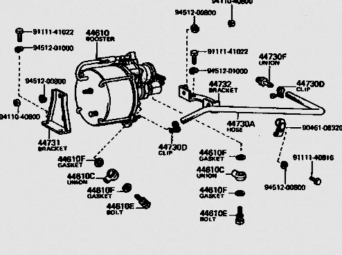

Ohh I did have a random question for the more knoledgable folks - did the 1971 fj55 have a brake booster?
Yes, as did some earlier models
3/69-7/70
7/70-1/75
The 1971 model year is the 44610-60010 ->44610-60030
This was the AISIN made OEM variant, NLA:
