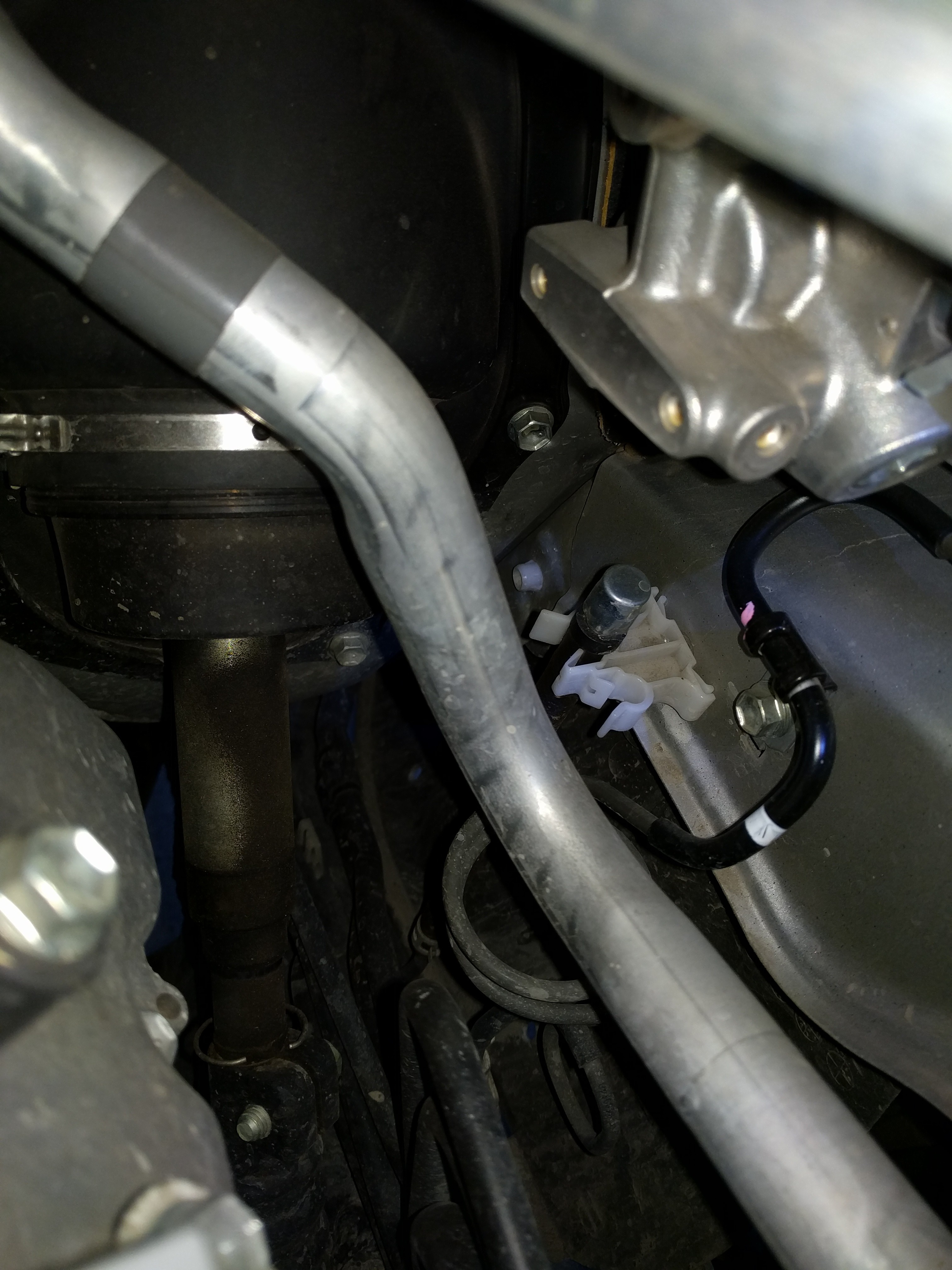

I crawled under the cruiser just a while ago and could not find the tyranny of the transfer case breather tube.

Got a picture?
Is it this thing? Silver capped hose in the white snap bracket:
That's the same cap on my rear diff breather tube...
