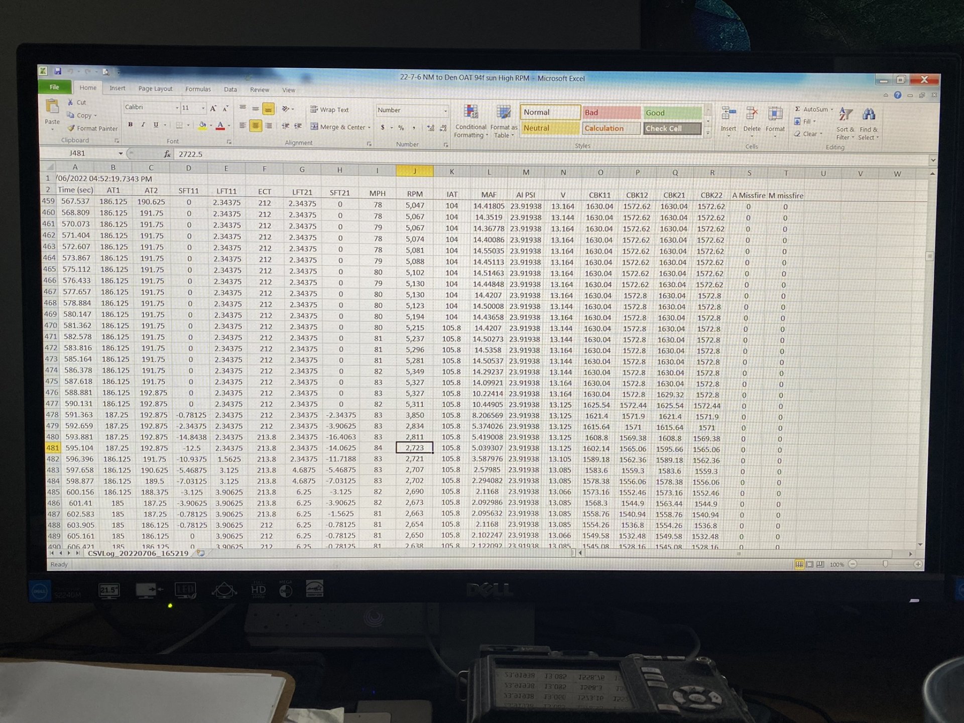

Here"s some screen shots of live view from my iphone and log I emailed myself (spread sheet). These are from and 07LX w145K I bought last month. I was doing a HWY high RPM burn out to clear any carbon & muck build up off CATs, A/F & o2 sensors. These were take on drive back from point of purchase at ~94f OAT, day of full sun, at ~5PM, just as starting to get overcast.

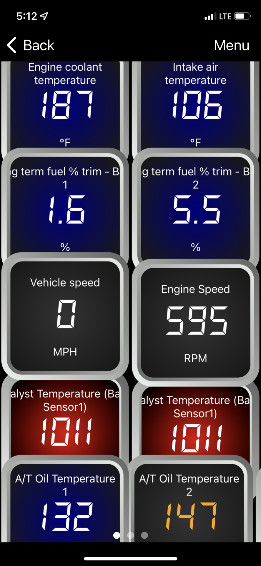

Screen shot of iphone while stopped, next day.

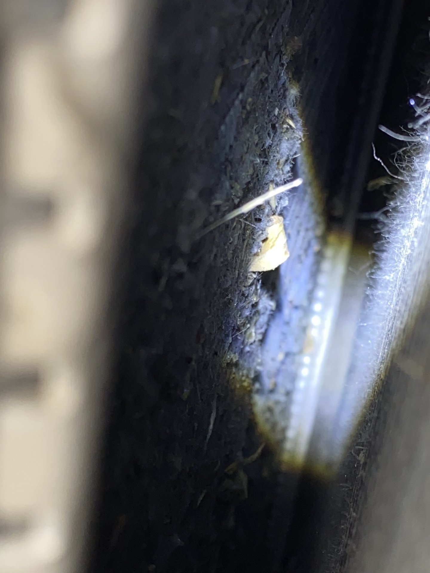

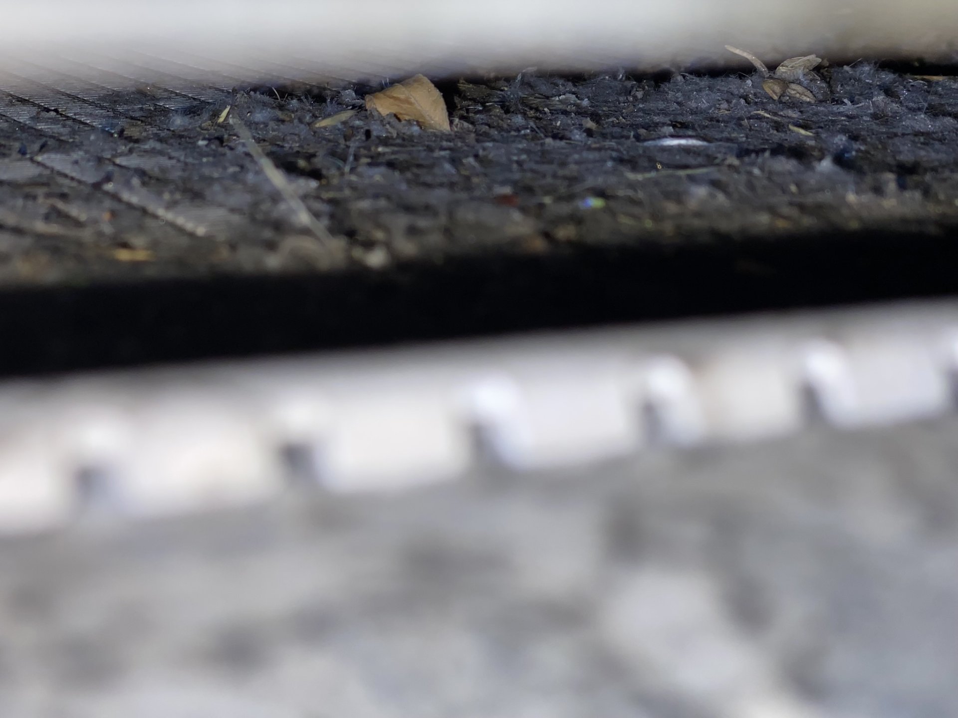

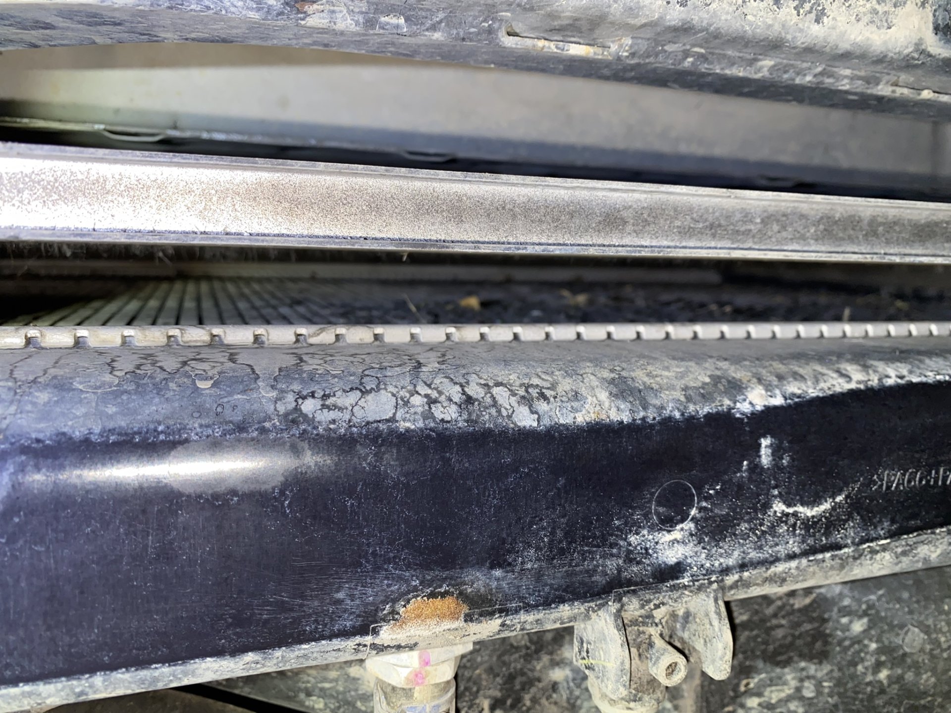

I found ECT and AT fluid #2 (automatic transmission fluid #2) temps getting to high, due to the typical radiator fins clogged. Likely guy who sold to me, probably didn't like they way in was running in summer heat. I've since washed muck from radiator fins, and drop ECT & AT temps from what's seen in spread sheet logs above, by about 20F.
Pictures of muck in radiator.
