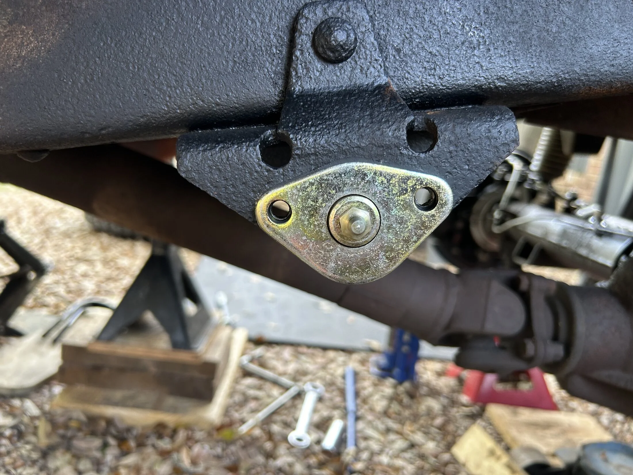

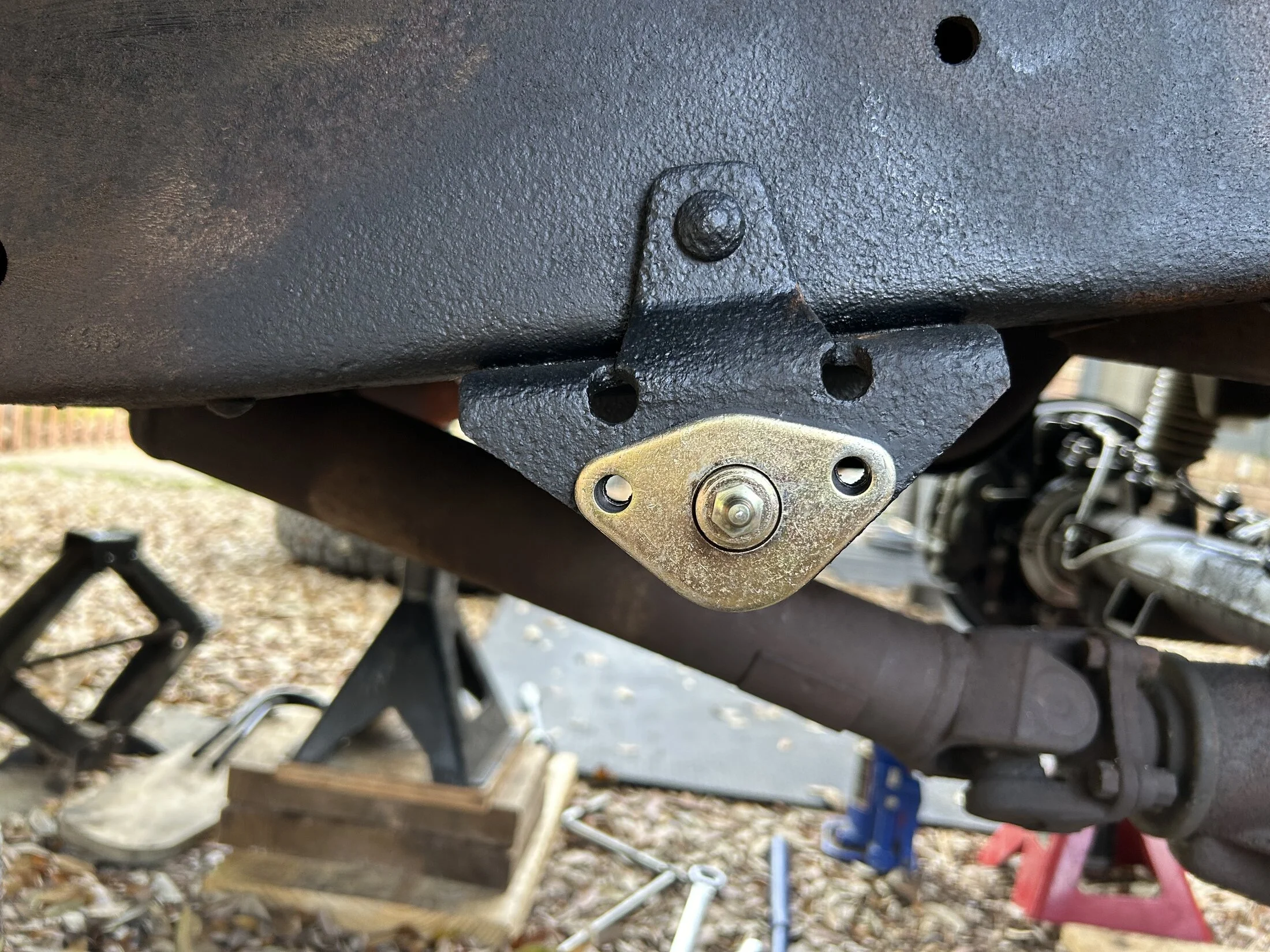

I heard back from Dobinson this week about my shackle pins. This was their response:
Sorry about that. That is very weird as this part number has been around for quite some time and we haven't had any fitment issues. If you can use a digital caliper and measure the distance of ours compared to oem?
If you want to make it fit, I would assume some grinding/drilling would do it.

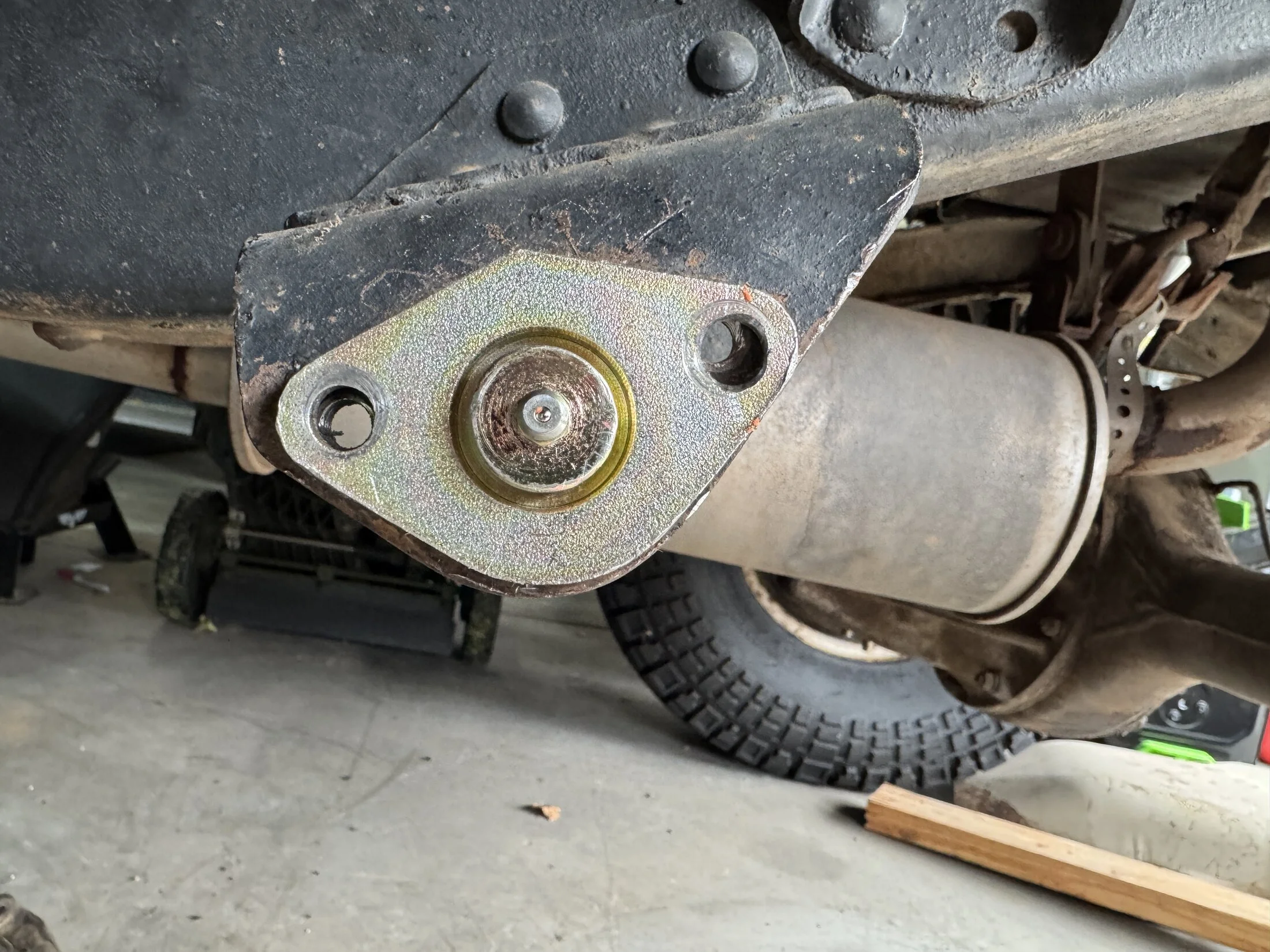

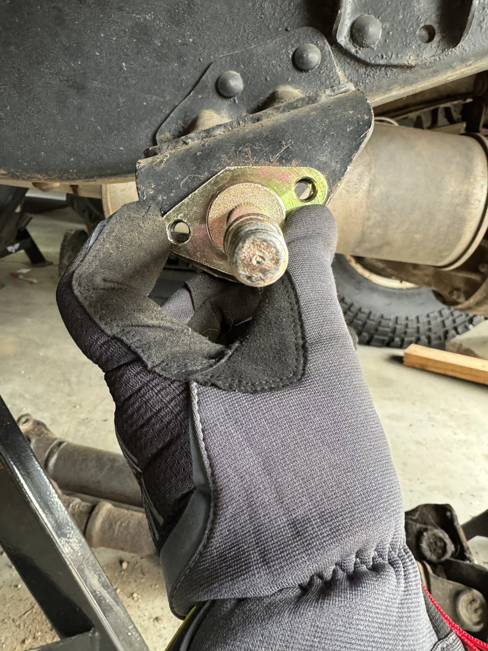

It’s definitely an alignment issue on my 40 because if I put the plate end of the shackle pin up to it, the holes align perfectly, but once I put the pin through the mount, they don’t align at all.
That first picture sure looks like it is out of alignment.
I had a similar issue with the same pin I got from cruiser outfit, just a fluke. They sent me a new one that fit lickity split. Makes me wonder if it was a Dobinsons?
Several of us know their springs sure suck.
Hard to tell, but both bolts wouldn’t engage.

That looks like a lot better fit than what I’m seeing. I’m almost tempted to order some OME pins and try them instead.
I had ZERO issues with the OME pins/springs when I had them in for 1500 miles, both fit and refitting them in vs the Dobi's. (I was looking for a softer ride hence the change after so few miles).
