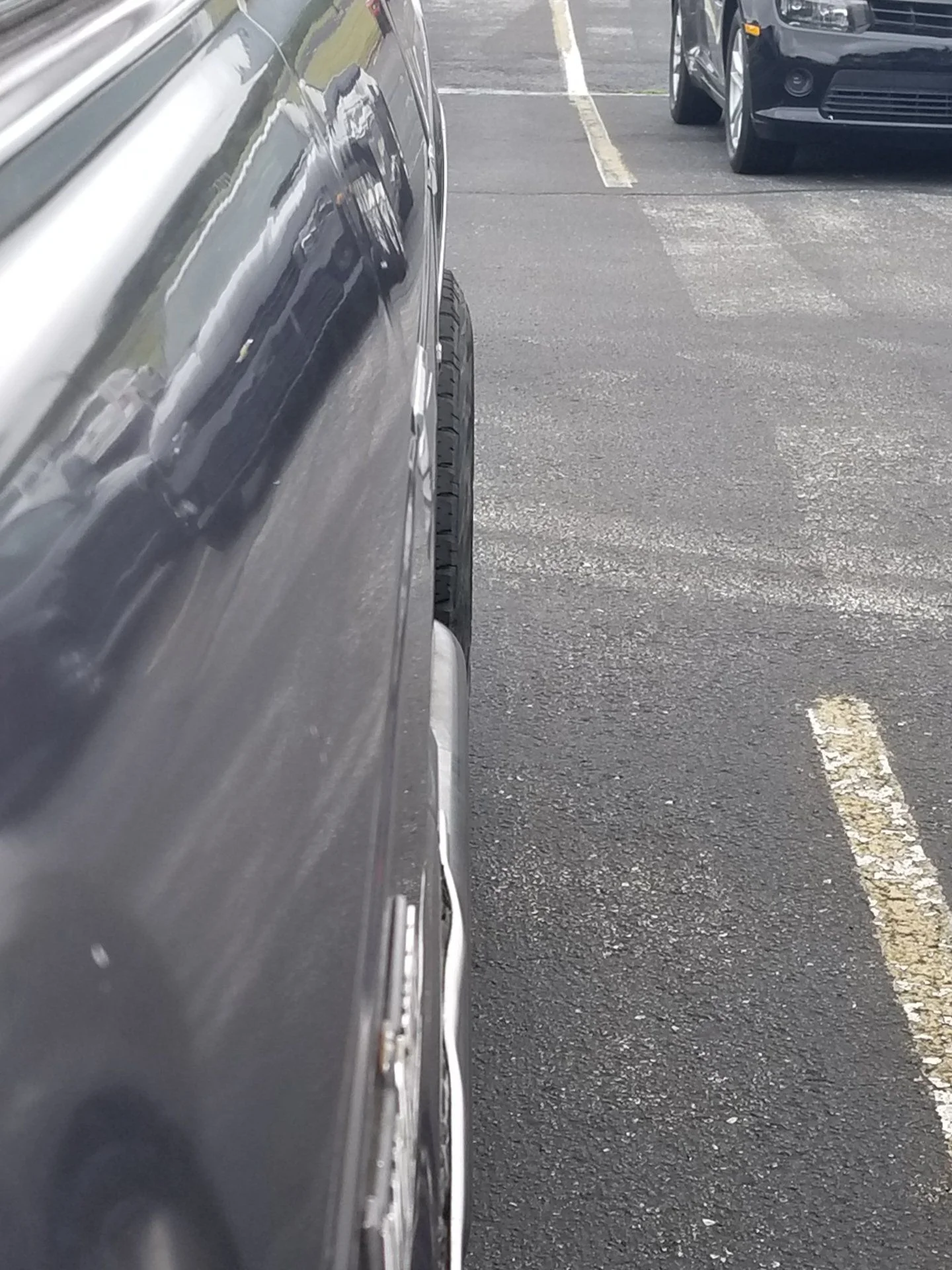

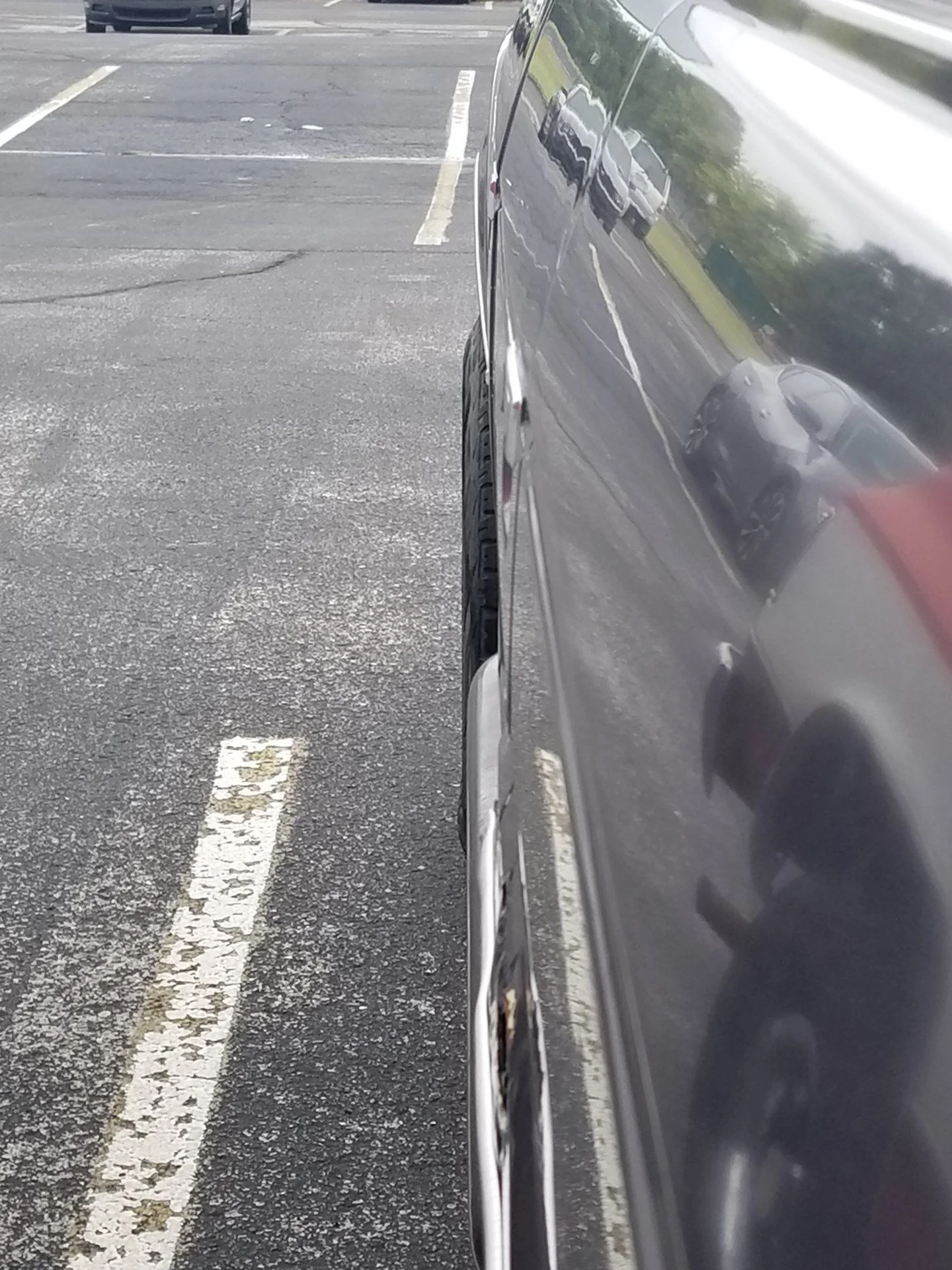

Just got the 1st bout of full-on, unabashed death wobble... lovely. Got back to the office and noticed that the passenger side tire is sticking out of the wheel well farther than the driver side by half an inch or so.
Now, I realize that leaf springs dont hold center as well as track bars do, but, c'mon! This seems outside of what is reasonable. Or no?

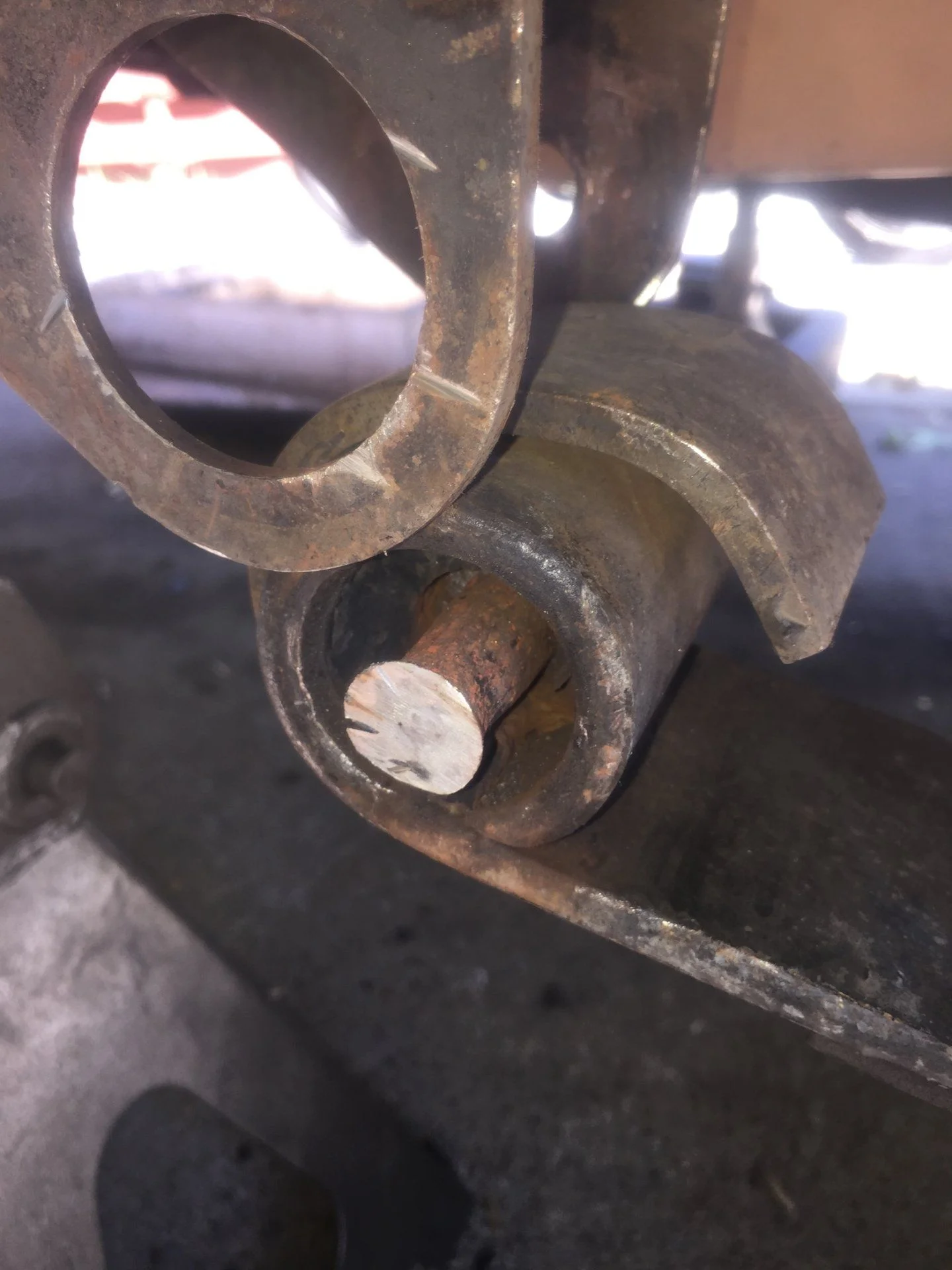

That pin that I showed in the pics above was bound up because the leaf springs are sitting at an angle. My rear shackles are bent and completely rust pitted. If the bushings are toast the axle can wander. I'm not sure if it's enough to cause death wobble but your tires probably shouldn't be protruding like that.

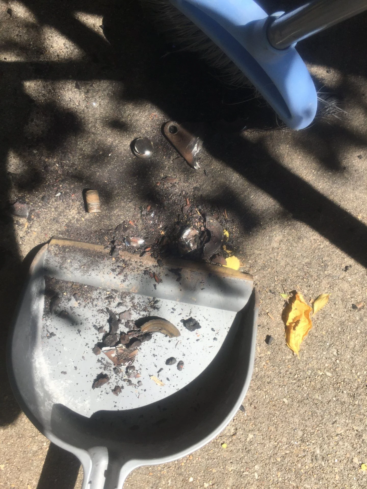

Tonight I'll commence the battle to disassemble the front suspension and determine what went wrong...:cheers:.

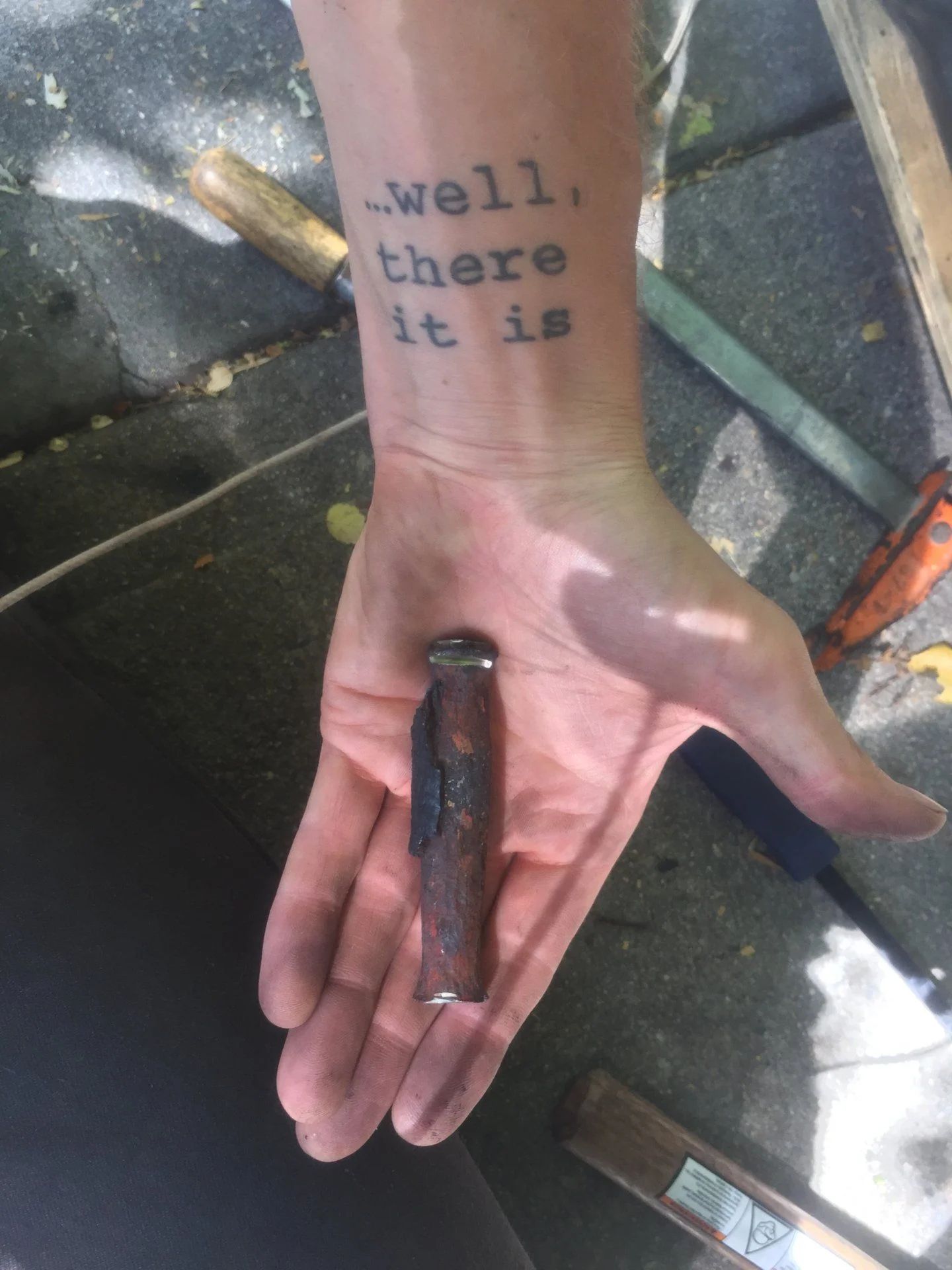

Whoa! Was not expecting to find a broken pin.
I went to back the nut off to check the pin and the thing just kept spinning. Bad parts, PO overtorqued... who knows. I'll be replacing all 4 pins and the u-bolts...
Glad you found it while you're OUT of the drivers seat... are they rusted and pitted?
Not at all. They looked reasonably new and are greasable. The springs and shackles got replaced some time relatively recently - still have their zinc coatings. I'm betting it failed at the grease hole mid-length. I wonder how often folks see this kind of failure on the greasable pins?
Not at all. They looked reasonably new and are greasable. The springs and shackles got replaced some time relatively recently - still have their zinc coatings. I'm betting it failed at the grease hole mid-length. I wonder how often folks see this kind of failure on the breakable pins?
