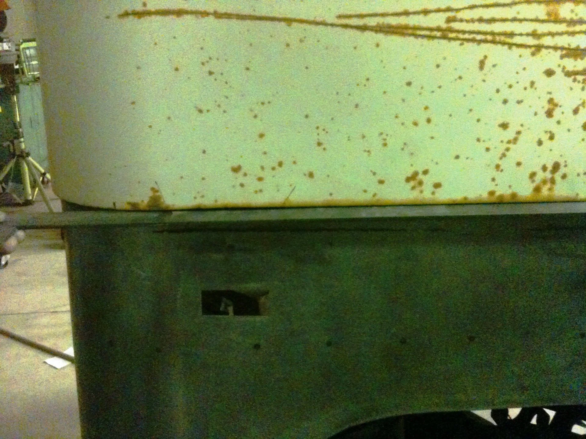

8 years ago (to the day) yesterday, the tub came off:
4-8-12-001-jpg.619611

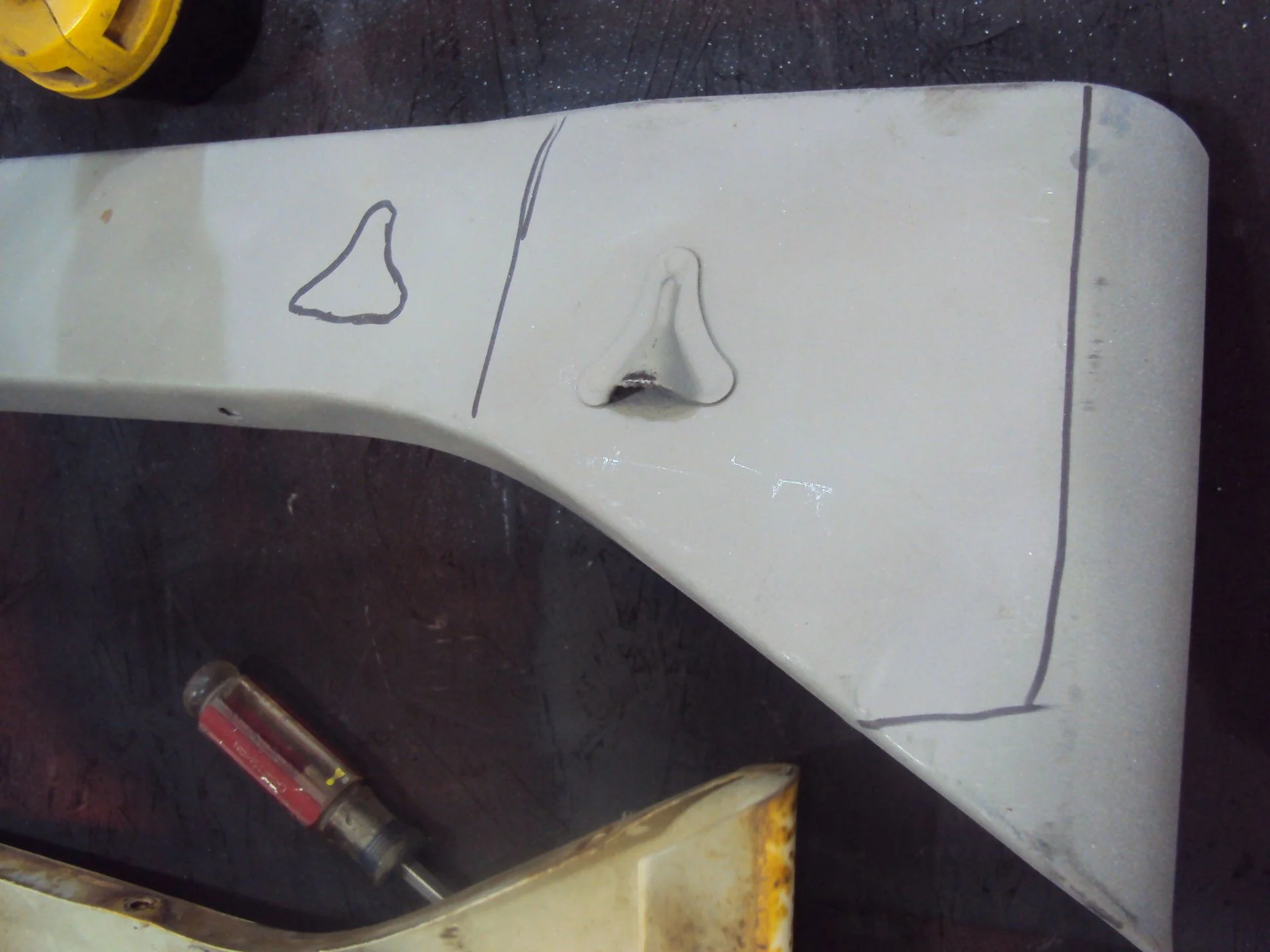

Going to the 70 series front turn signals meant we could not use the 40 series external hood latches in their original location.
When we had the fenders on for a test fit, we fitted the bibs and figured out the new location of latches:
After the move:

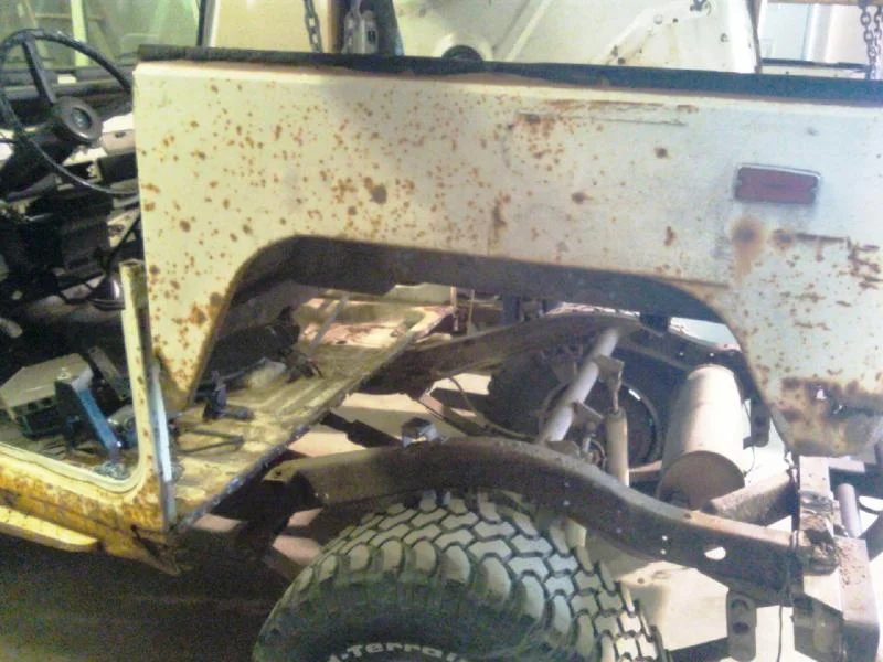

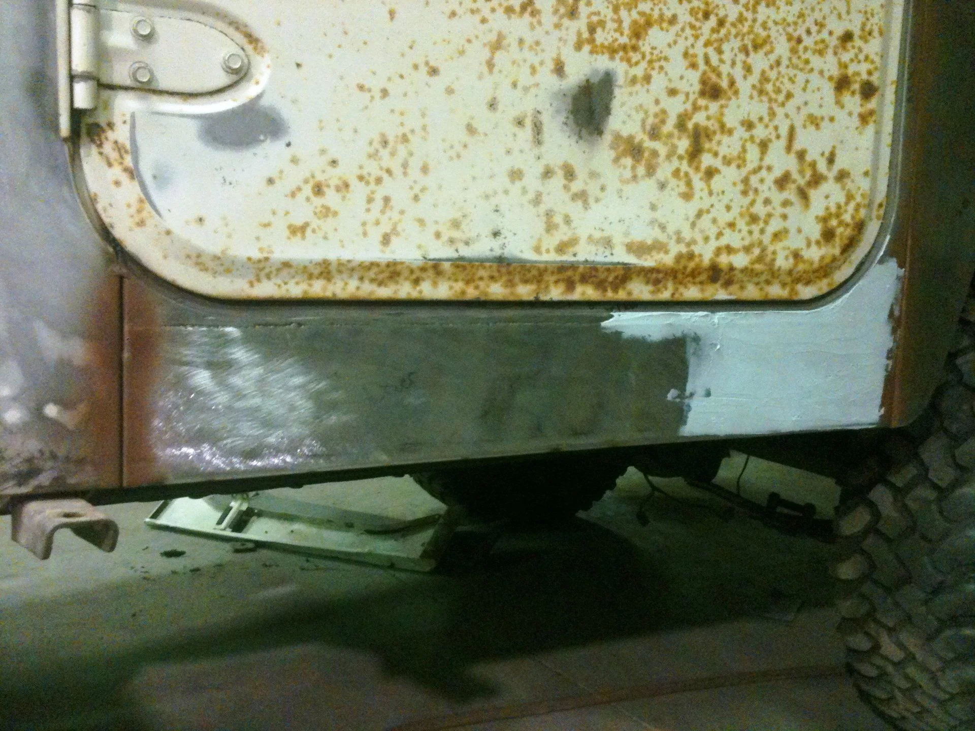

No good pictures of the original driver side floor.
This is what I could find, right after the tub came off:

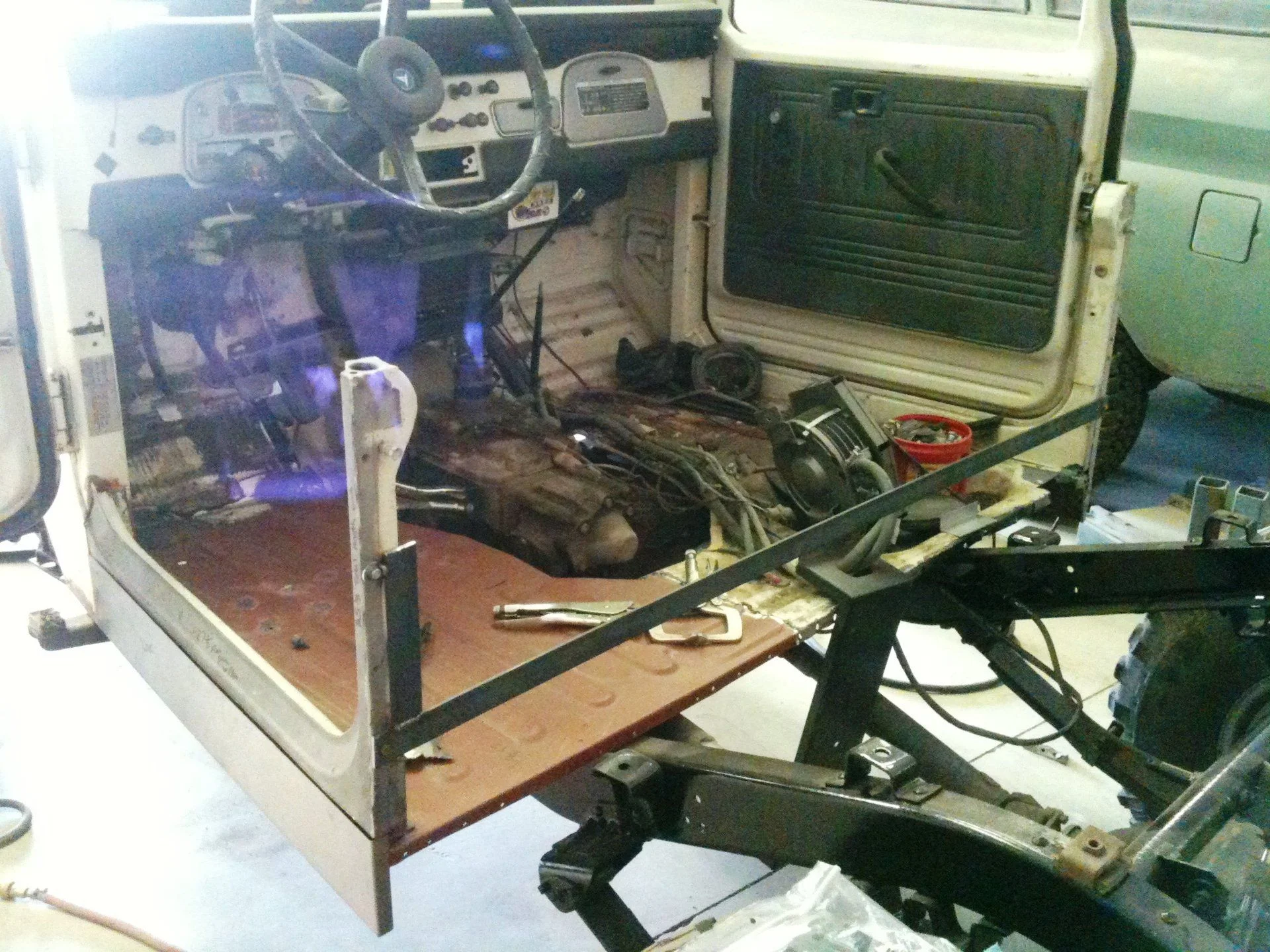

I can't remember where I got the replacement floor, I am sure I can figure it out. Here is the replacement going in:
