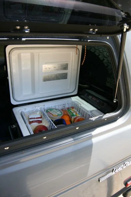

On your tailgate storage... is the plastic strong enough to stand on the tailgate to get to the roof rack?
jeff
The Lid is very strong! jump on it drop stuff on it. Only thing I have noticed is if you leave it open in direct sunlight the lid expands and cannot be closed till it cools down a bit.
Me and the Girlfriend just got back from a 9000KM trip out east and it was very nice to have the extra space and it is very quick access.
you can even cook on it!
.........Only thing I have noticed is if you leave it open in direct sunlight the lid expands and cannot be closed till it cools down a bit.....
That's not supposed to happen Matt, you need to swing back in, sounds like you have a bum piece of plastic. I found out that my FORMER plastic supplier slipped a piece of non-marine grade plastic in on me, thought I had accounted for all those lids.
The true marine stuff wont expand like that.
:cheers:
had the same problem-I think we emailed about it. I simply shaved a few mm off the sides, and now it is fine and closes even when expanded.
cheers,
J
cheers,
J
Yup, I remember that, that was before I figured out what was going on. Offer still stands to swap it out!
