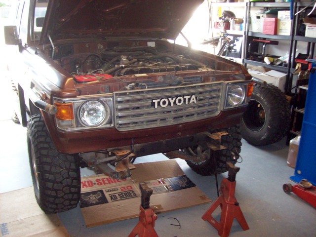

thanks man it was a lot of work and i still have a good bit ahead of me, with altering or swapping springs (tho that may wait a bit since i wont be wheeling it to soon) still need to do steering stops and mount ram assist and drill and tap steering box for the ram. along with other crap. it never really ends i dont think. but so far im pretty happy, this was a HUGE accomplishment on my list so im still pretty excited.
Get rid of those huge shackles and she'll come down a bit, then flex out the springs really well. They'll flatten out pretty quick and you won't have to take too much apart.
What's in the back of the 60? Front axle housing, but what's special about it?

and my shackles are newish stock

yea i need to do something, i have a pair of shorter shackles around here someplace but i would still need 2 more.
and yea its a front axle housing from a 78 or 79 or something for my green 40, im going to cut all the crap from it and have it prepped and clean for when i SOA my 40:steer:

Good Job! Those welds look nice. 2x on the smaller shackles...you can lose 2.5 inches right there. Thing looks HUGE.:clap:

That is huge. About 7" taller than my SOA on 33's.
If you go shorter shackles you'll probably end up with too much caster since your at 6* now :meh:. Go for the 39.5's

I know... im to damn tall by a mile!
i think caster will still be tollerable. i have a set of stock FJ62 springs i think im going to put under her to lower her back down and maybe some stock or slightly longer than stock length shackles if joel was seriously interested.
that should put me right back at normal SOA height. I still plan on 39.5's and im no scared to do some cutting to make em fit. i really like how freds40's FJ60 came out and that is kinda what i have in mine.
