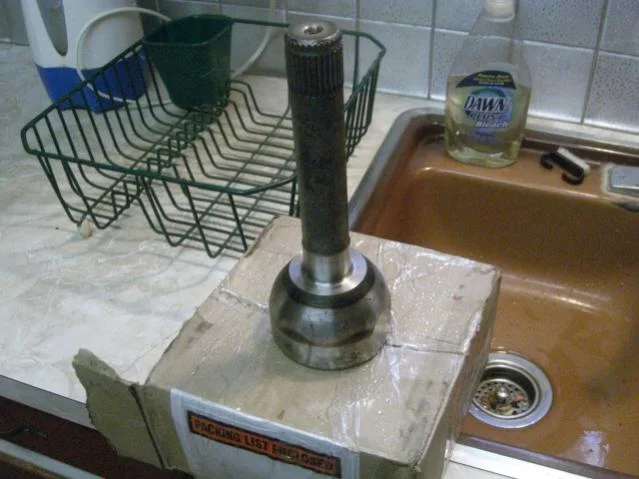

Well a big thanks goes out to Joel for seriously helping a brother out with a birfield, it shoed up today sometime a little before 2pm.
thing looks great, can tell it was attached to an axle but the innards dont look like they have ever been run. So thank you very much again man!!

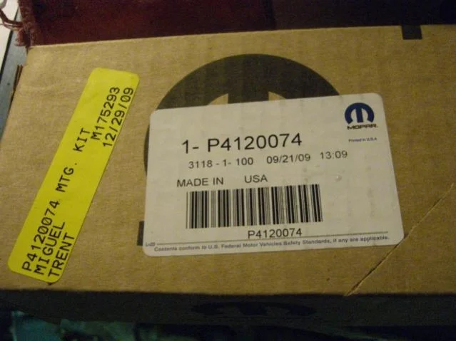

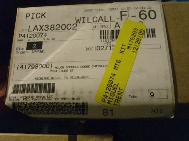

picked up some spring perches today from the dodge dealer they are for a dana / spicer 60 axle with leafs, the part number is P4120074. I got the part number from THIS thread. Now i had some trouble getting these as the guy behind the counter at the dodge place by my house didnt know what a "MTG KIT" was and couldnt pull a picture up to verify it was what i was wanting... he told me he was gonna order them, so when i got there yesterday evening to pick them up they wernt there.... he told me since he didnt know what they were he didnt want to order them... anyhow manager looked at the screen for 1 second and told him it was a mounting kit.... anyhow before this i was behind the counter looking with him at some different stuff as he was trying to find the picture... and i saw the list and cost of these, in the thread i linked he paid like 10 bux a box and there are 2 perches in a box, well my dealer was trying to charge me 15 something a box, it was plain as day on his screen that each box cost them $7.46 and that list price was $10.00 even yet he was trying to charge me over list! WTF? for those of you that have never sold parts before cost if what they get it for and list is what the manufacture suggest and retail (what you pay) is usually a little under list or at list price, and here he was telling me to pay over list... so i was a littl pissed by that. anyhow fast forward to when they wernt there the manager told me he would met me have em at their cost of $7.46. good im happyish again it at least covered my wasted fuel.
I will be using these for the SOA on this truck.
anyhow here is a picture of the mounts he boxes and my receipt.

last pic of the perch box.
Your welcome bro... your lucky I just found it last month

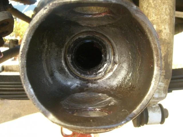

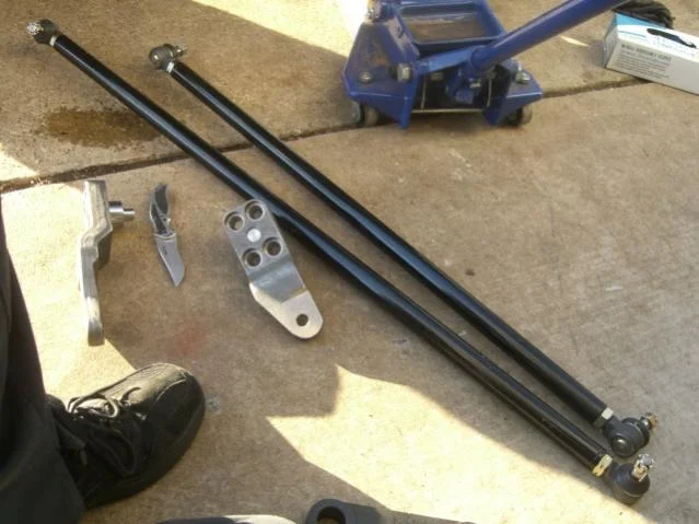

ok well today i brought home my 60 so i could replace the busted birf i broke at roundup last march.

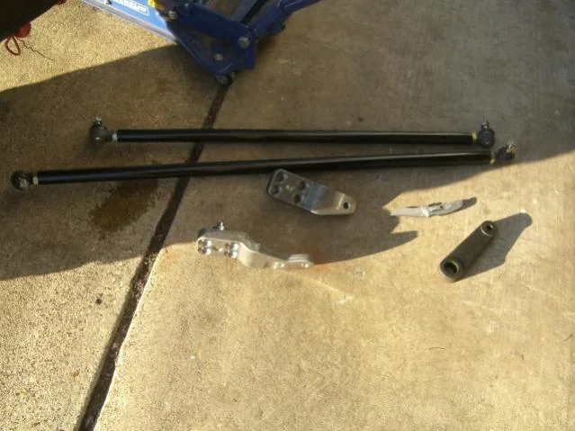

tore it down and decided now was a good time to see if my hy steer would clear and get it installed. so that is where the pics start.
this the trail gear kit, i got it on sale a while back. i thought i had ordered the angled pitman arm but apparently not. ill get it on and see it it will work or not. if it does cool if it doesnt ill either get another or do some notching.

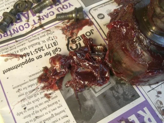

1.) got all the crap out of the housing
2.) messed up my marlin seal... had to put a stocker back in there for now.

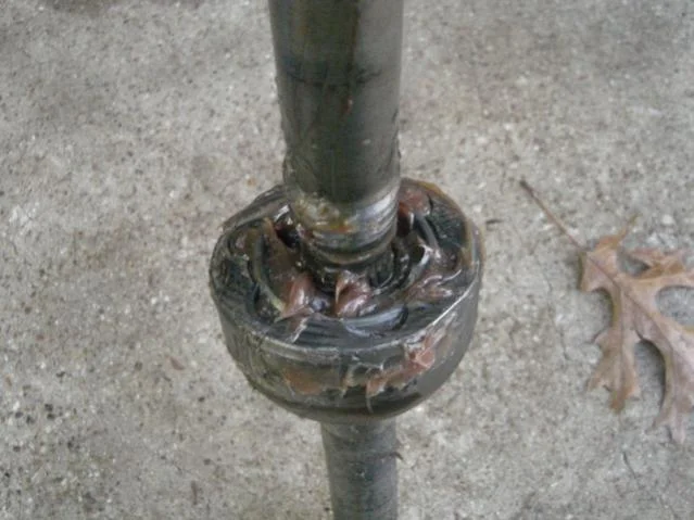

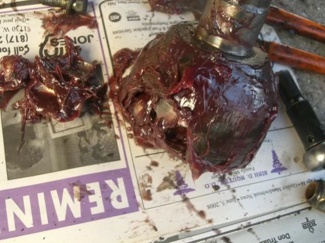

3.) pic of the birf ball and busted piece of the birf

1.) another of the damage.

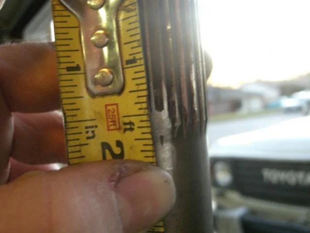

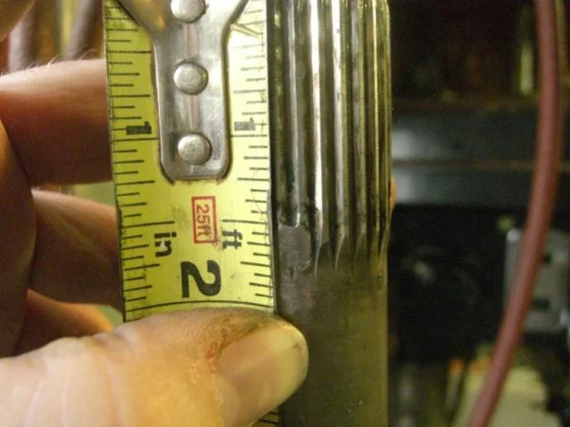

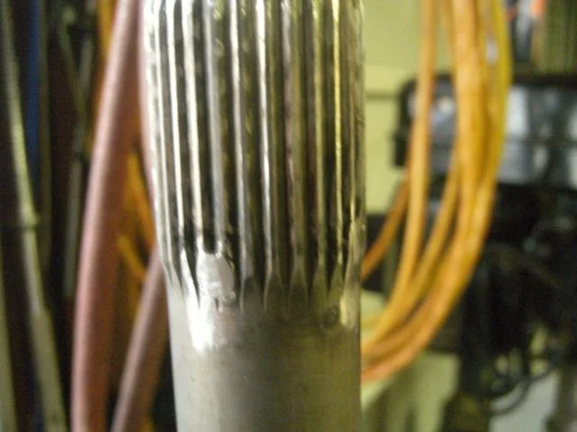

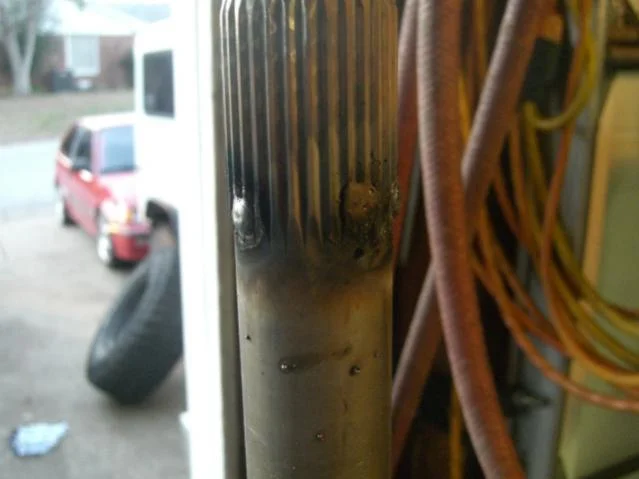

2.) i wasnt paying attention when putting the birf back on the axle and snapped the c clip in half. so i decided to do the mar tack or marlin tack on the axle shaft. (welded)
3.) mar tack ground even with the splines
for the marlin tack i did a quick search on here and found the info on another site HERE (i had to highlight the background to see it for some reason...) anyhow...
the reason for the mar tack is to keep the axle shaft from sliding out of the birf and going into the differential, you dont have to wory about it going to far into the birf cause it had that larger clip to keep that from happening. not to mention you dont have to bang apart the birf and axle shaft anymore or worry about havin to get that stupid clip in there anymore. all the information i came across said to leave 1-1/2" - 1-3/8" of splines for the diff. then after the tack is made grind it even with the splines and your done. the idea was to fill the gap. no need to get it hot or anything all your trying to do is get it on there enough to keep it from coming off. it wont see much stress so you wont need alot of heat, plus heating the axle shaft could have a less than desirable effect.
i read about this a long time ago and found it a great idea so after i broke my clip (and it reminded me about it as i knew i needed to do something) i figured it a great time to get it done.

1.) another of the welds ground smooth

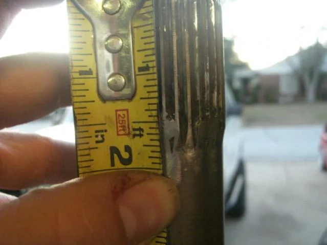

2.) showing length of splines before tack, I made 3 tacks and this is the highest of them all. came in right in between the recomended spline lengths so im happy, the other 2 tacks are right at the longer 1-1/2" spline length
3.) nother one of the tacks.

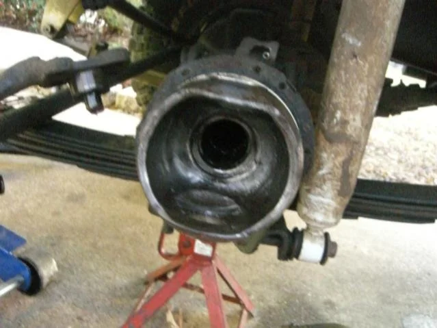

3.) and old seal out.

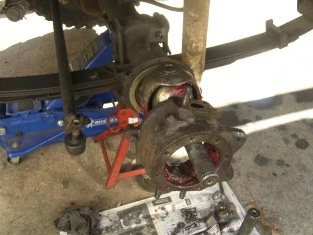

thats all the pics i took, i got the knuckle back on but i had a knuckle bearing failure / me apparently not pay attention and tore it up and smashed it. so now i need a couple of bearings. i have a link to the thread HERE on some of that information. so if anyone knows where to get a knuckle bearing locally please let me know, if you have a part number thats even better, as this big girl is tore apart in my driveway right now.

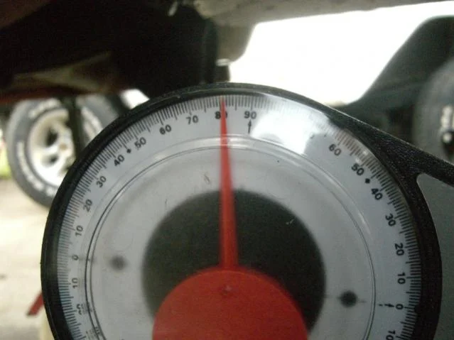

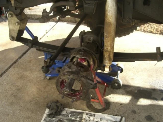

OOk well todays update... what was originally just a birfield replacement seems to have taken a slight turn...
1.) how i left it the other day after i smashed the bearing (i found out why by the way)
2.) same
3.) pinion angle at full droop with how suspension is / was.
:EDIT:
i should mention that the next posts for todays update were not really thought out or pre meditated, more of a "ya know what screw it im doin it" kinda thing.
i may not be doing it the way some would suggest or any of that crap but im doing it my way and if it doesnt work i can always fix it later.
