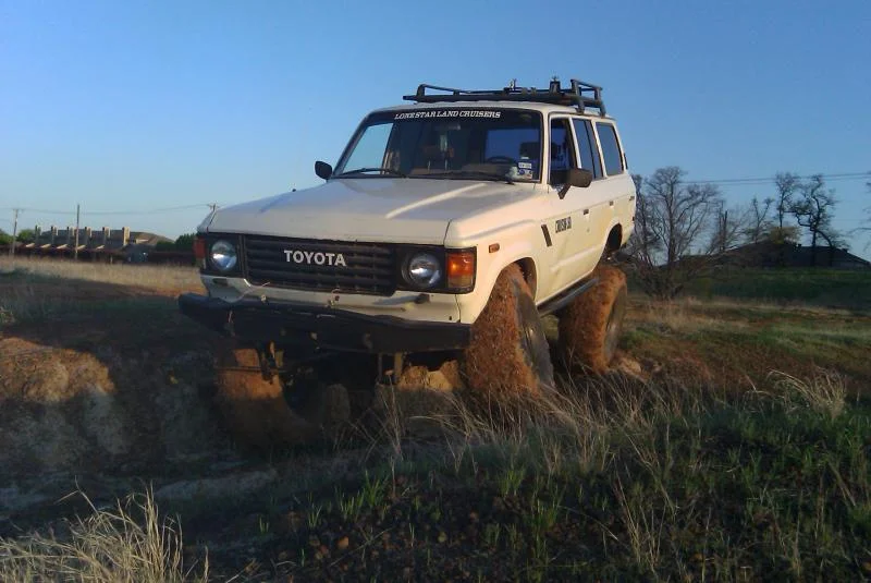

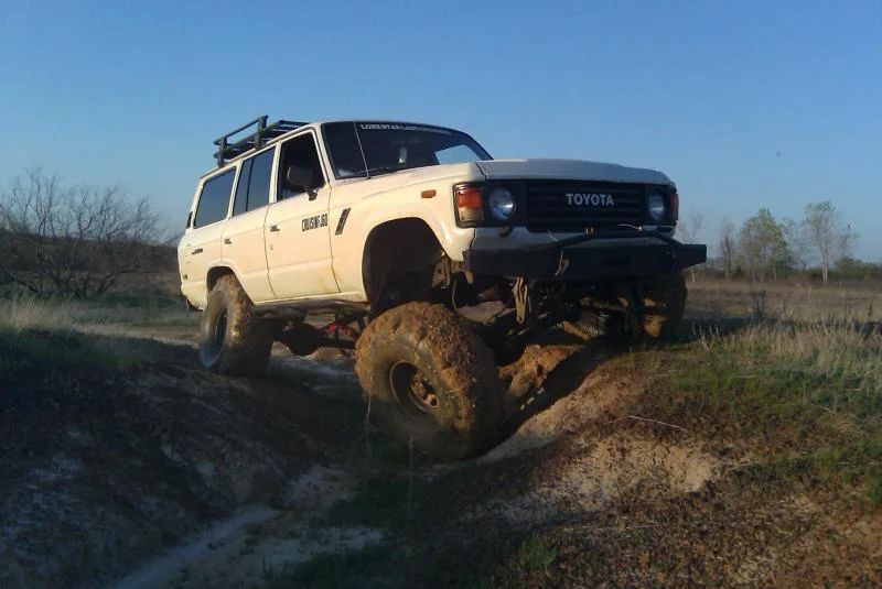

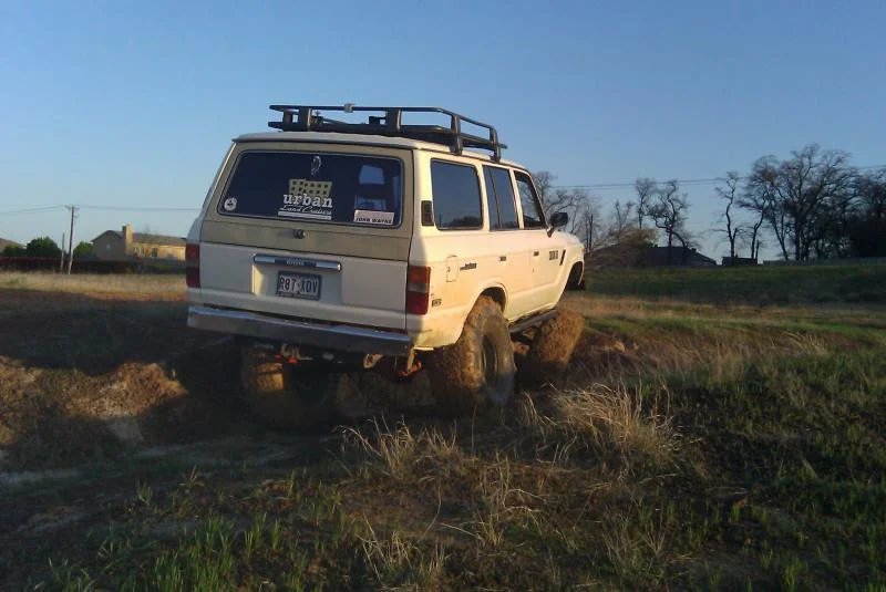

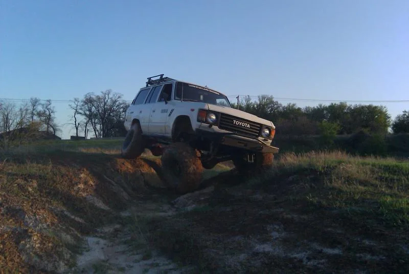

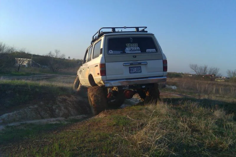

a couple pics of said hill for some to understand the size (tho the pics make it look smaller) focus on the angle of the truck im in not so much the stuff in the pictures.
one from the bottom ...what a muddy mess that was

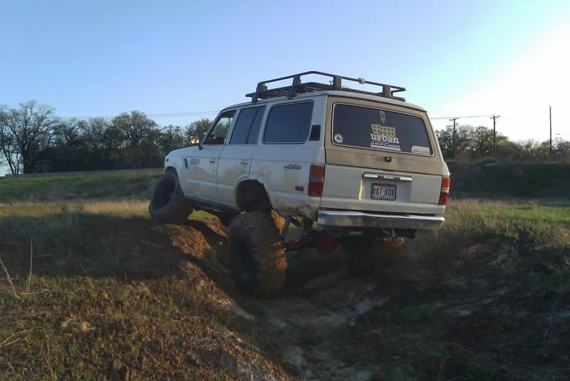

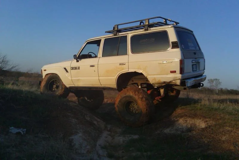

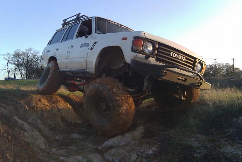

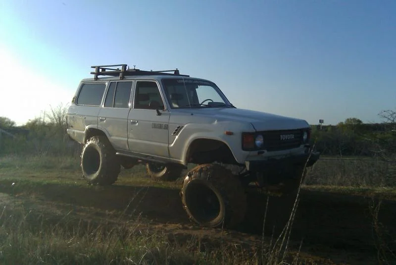

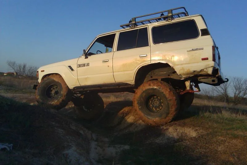

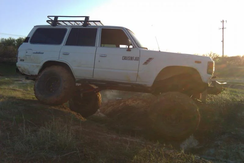

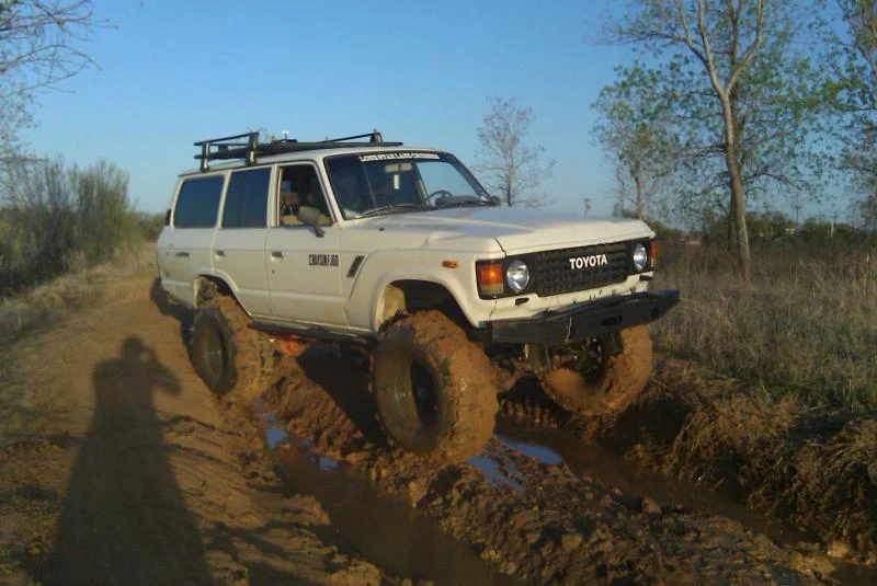

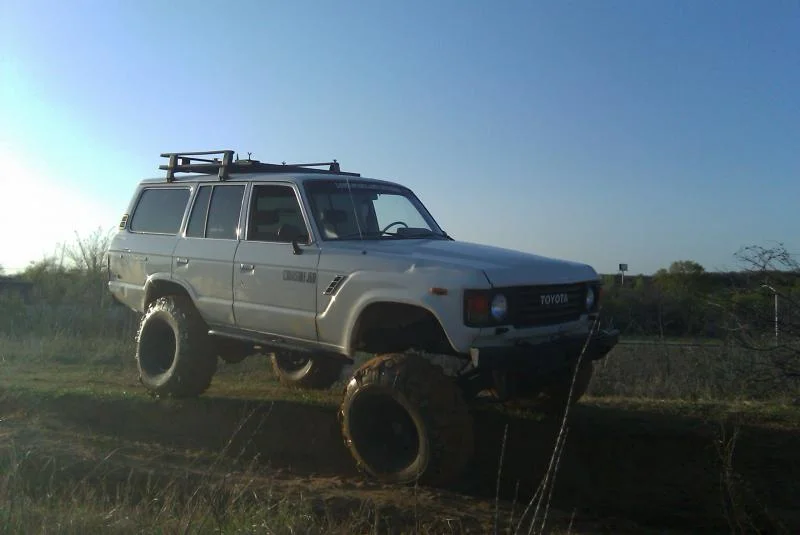

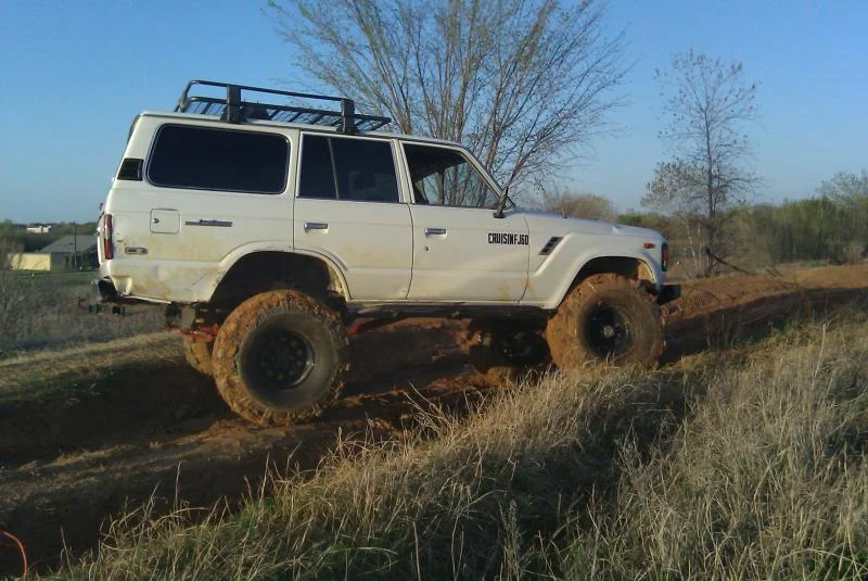

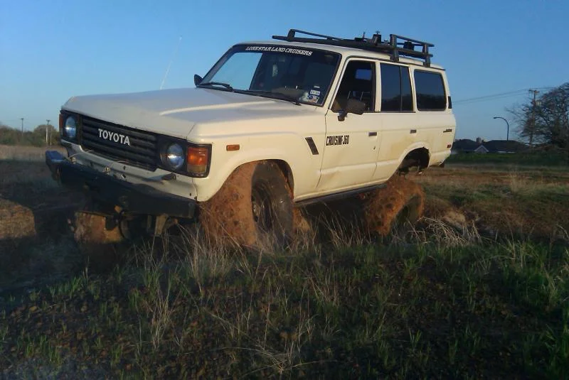

then i decided to go out and drive it around, which later led to me getting some poser shots of it flexin up.
here are those shots, just keep in mind it is on 38.5's (which look small to me:meh:) so it kinda gives you an idea of the flex.
more.

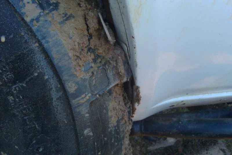

found it does rub a little when bound up pretty good, im not running any bump stops and the springs are inverted so im not sure what i want to do, i want the truck to sit lower so when that happens i will cut the fenders up will then i think ill see if it doesnt just bend them out of the way.
