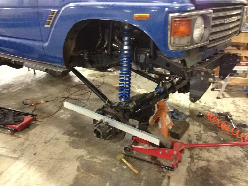

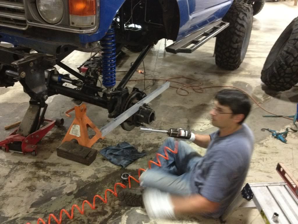

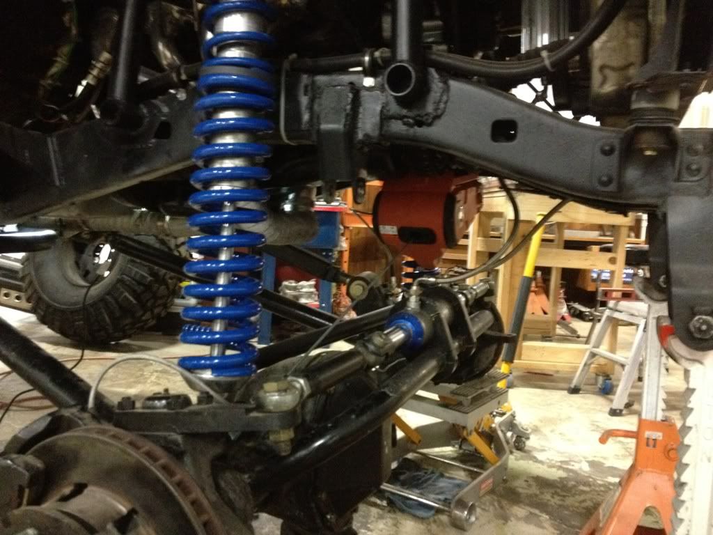

So the order of business Tues night was to get the alignment done and get my heavier main coilover springs on. Without a proper car lift things got interesting getting the springs on. I dont know how the heck I got them on in the first place.
First Mike explained to me in great detail on how to set up the "alignment" bars that we made and how they work... and after about 10 mins of his detailed explanations the info finally sunk in and I understood what we were doing. lol

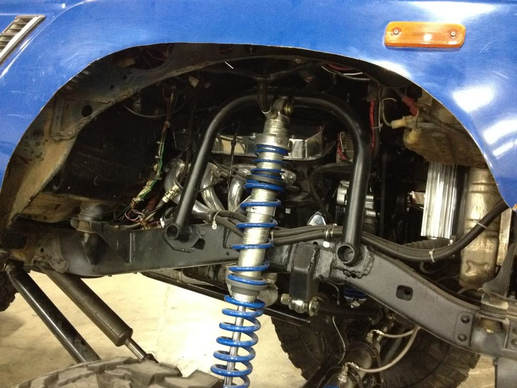

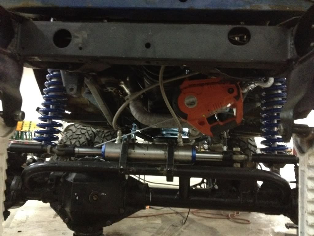

Next was the main springs. With a 3 link, the axle moves laterally in an arc depending on compression or droop. Since the new main springs were a bit taller than the previous set up that meant that the axle shifted to the frame side panhard mount. This meant that the panhard had to be removed and lengthed to compisate for the added ride height ( sad about this). After a few hairy moments we got the springs back on but the axle was difficult to move because the wheels on the floor jacks were bound up.

Why you increase main coil length .?
Every time I am about to cut those perches they end up being handy. Their day is numbered though. The greasable pins are all yours at that point.
I increased the spring rate and length for a couple reasons. The aals increased the height in the back so I had to adjust for that. Next at full droop the springs would go slack even with "triple rate" springs in there. And last because I didn't like how soft the suspension was.
I am going to wheel like this for now. I just don't have the energy to cut off the front suspension again to lower it. When the time comes to do that I will also 4 link the rear...
I just want to wheel it for now. No more going backward.
You need longer shocks in this coil overs. ;-)

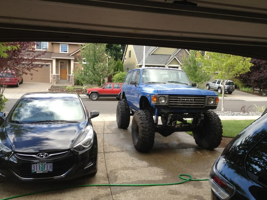

Planning on lowering the front end? It might be perspective, but it looks 1000 feet off the ground in that shot.
