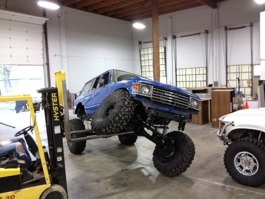

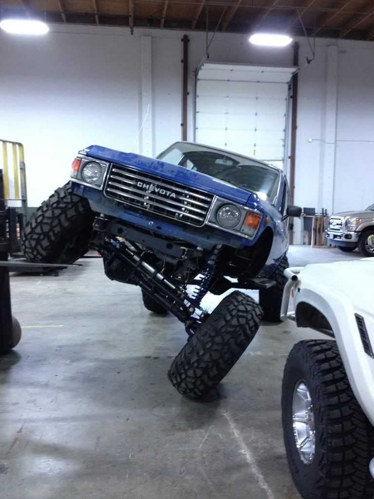

I like the Chevota badges were did you find those??
The truck as a whole is bad ass too ;)

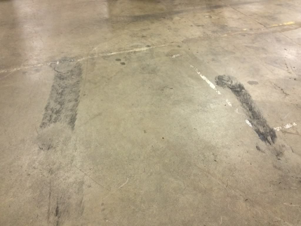

Nice burn out!

Here's the link for the "chevota" badge. If it doesnt work just get on ebay and type in "chevota" in the search field.
