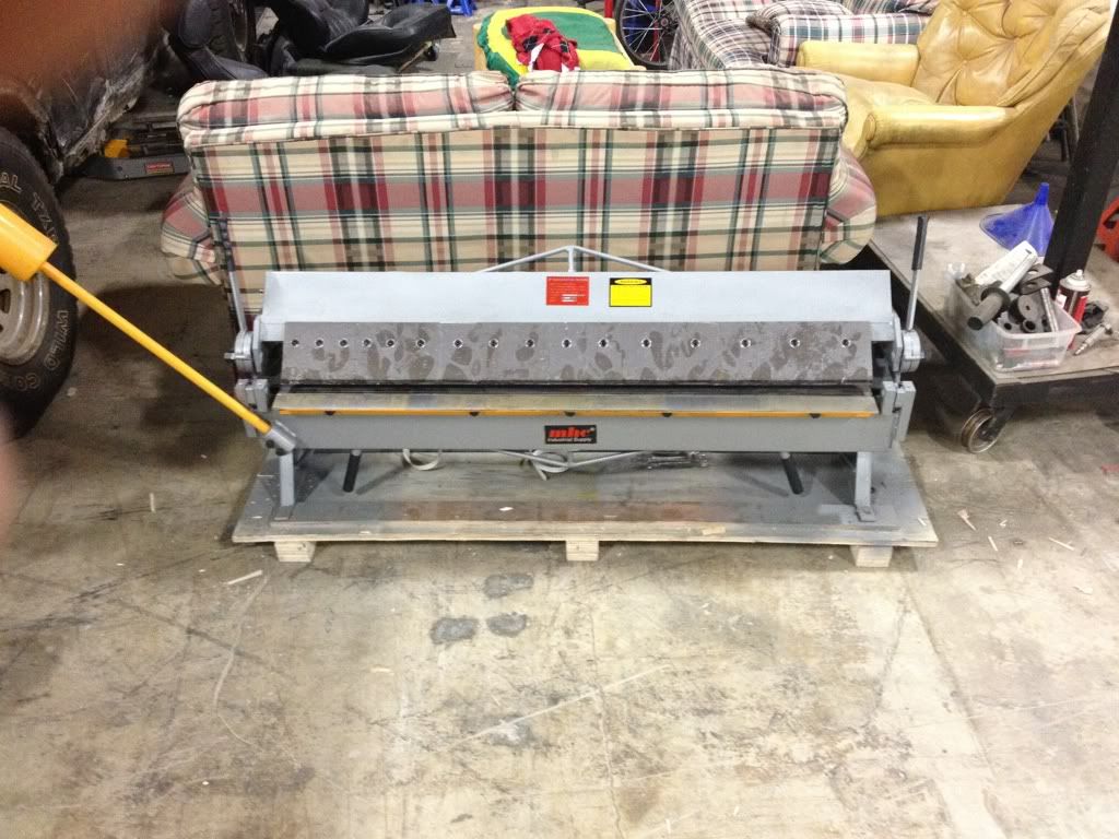

This just came today... should help in the sheetmetal dept. :) This and the swag offroad press brake kit I got for my shop press should handle most of the sheetmetal needs on the 60 and for the 55 when I get to it.
48"x16guage box an pan brake... I need to build a stand for it. Wish I could have afford a tennsmith but this should do for hobby use.

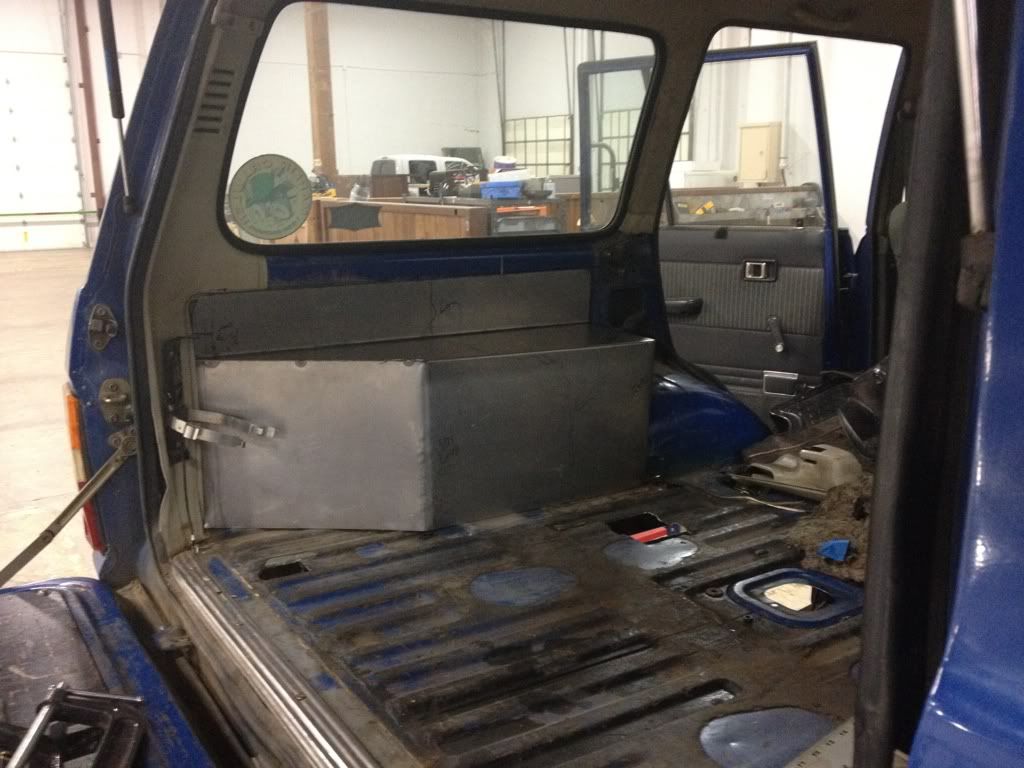

Got to play with my new brake.

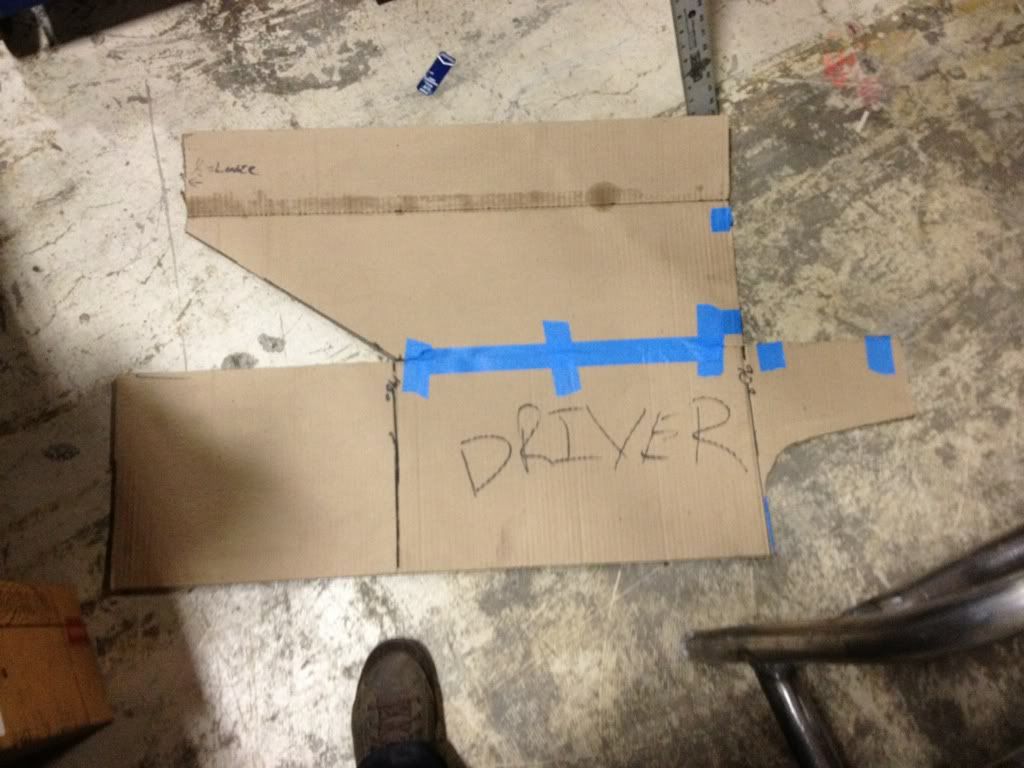

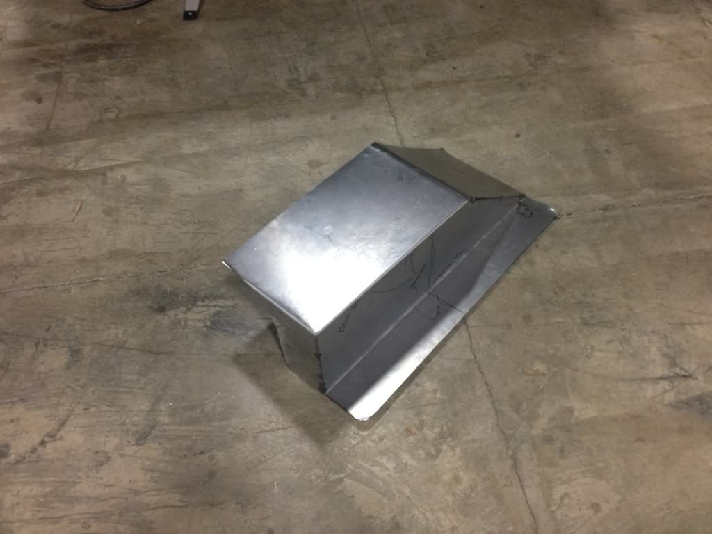

First I made a template with some cardboard (actually my a fried made a rough template then I made another 2.0 version of the first template) Here it is flattened out:

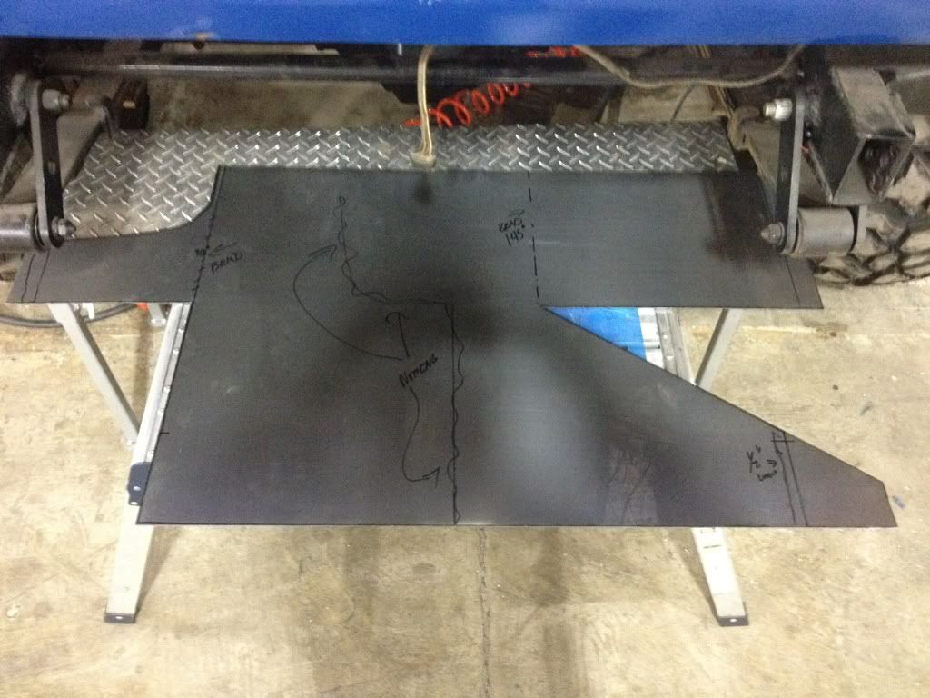

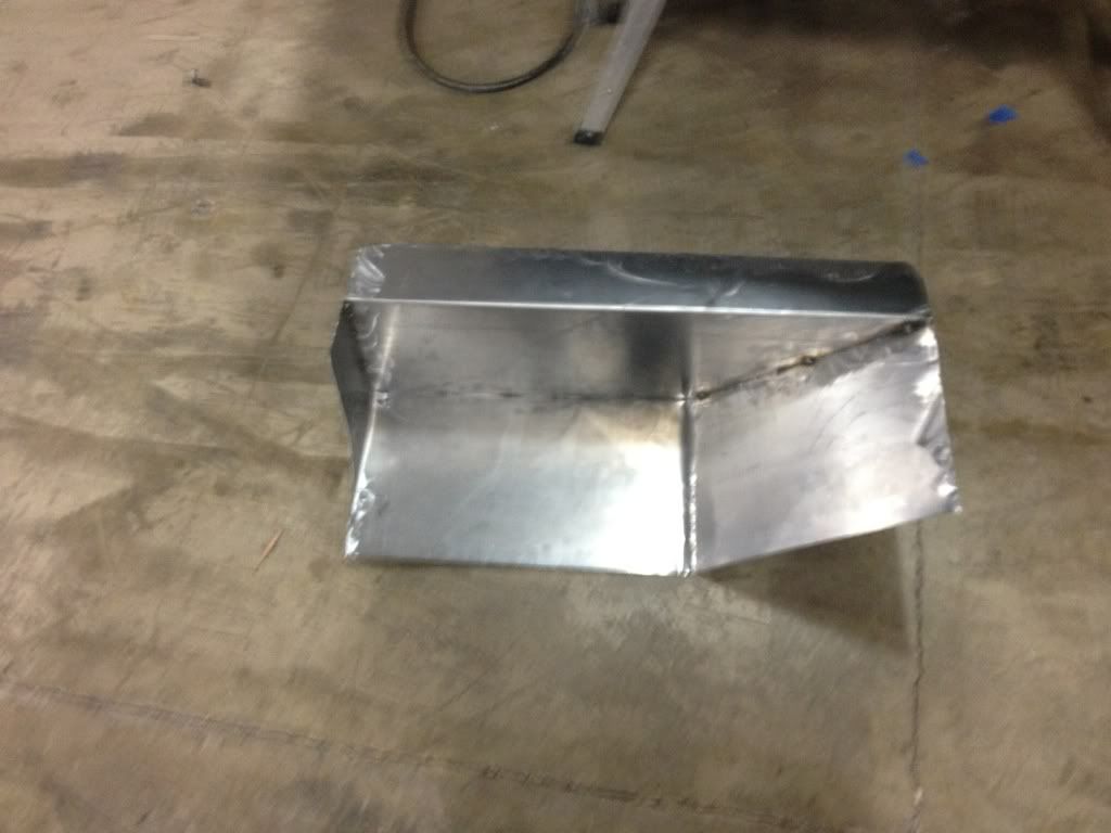

Then I transferred it to some 16 gauge steel:

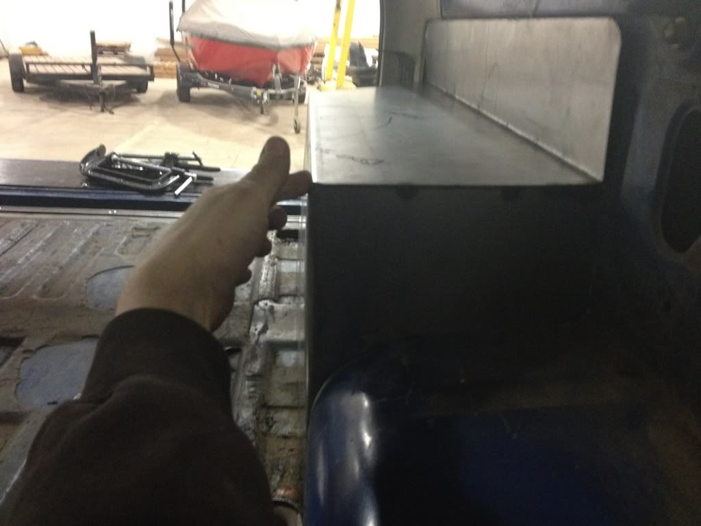

Then started bending and put some light tack welds on it:

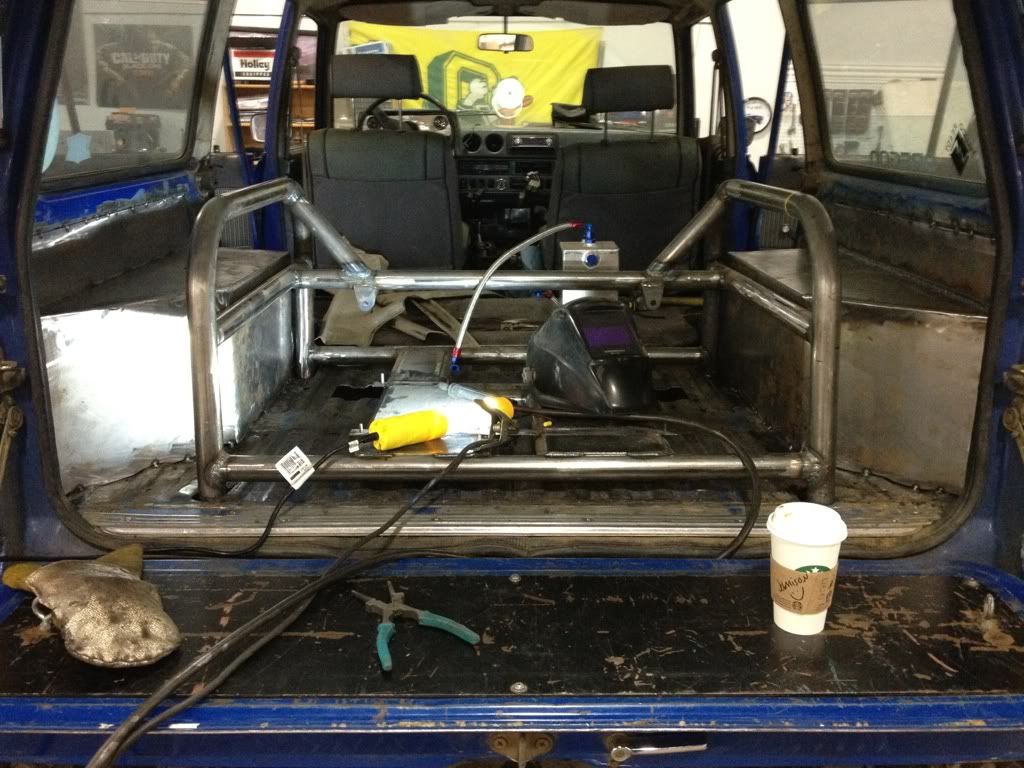

it took a lot of patience to clip, grind/sand, plasma, etc but it fit pretty darn snug in there. I've got a couple spots on the fender that need a bit more tweaking for the ruffles in the floor board but its not too shabby so far:
Plan is to weld it into place....
ha, they are built from 16 gauge so I bet they would work as jump seats. :)

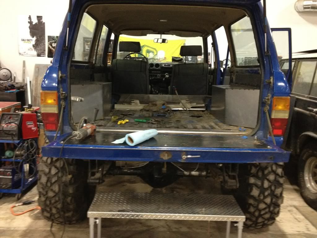

Still got a bit of grinding to do but at least I'm moving forward again. I am thinking about Rhino lining (the DYI version) the interior rear section after I get them all welded into place.

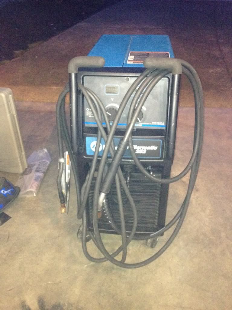

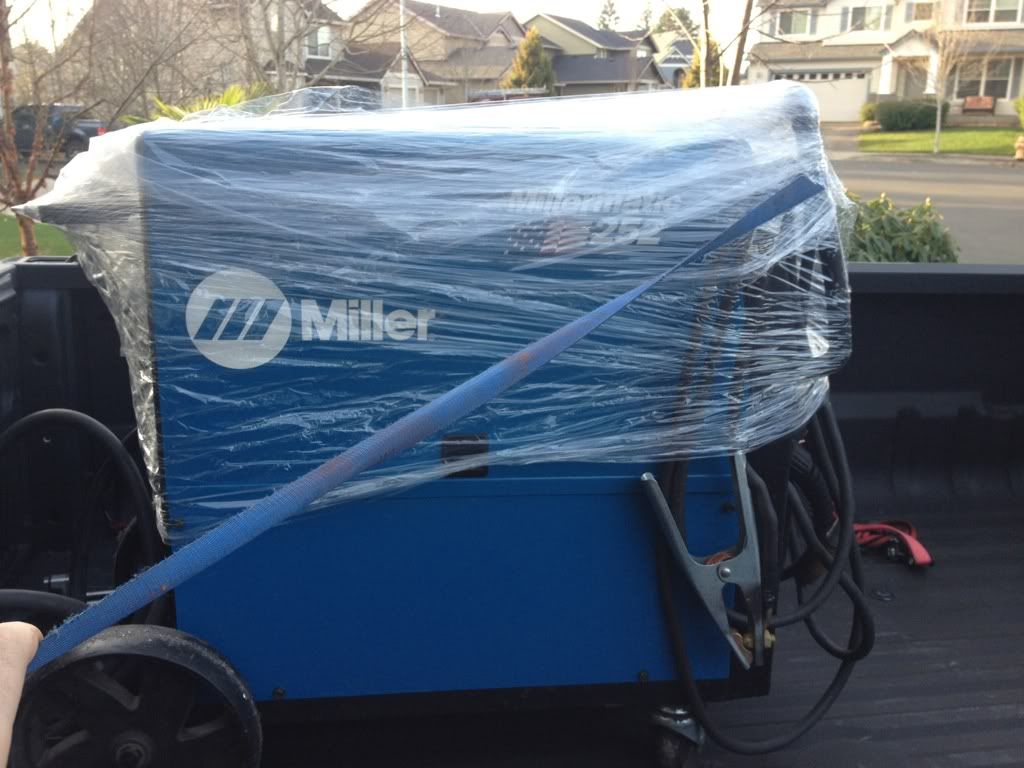

Thanks to Metal Tech... I got some sloppy seconds. They got some unbelievable new machines in there. Crazy to think that they upgraded from this but they did. Although I was very happy with my old welders they felt like toys compared to this thing:
The last pic doesnt show it but I got the fenders all welded in this morning. The coating that is the back of fj-60s comes out like butter with a air chisel by the way. Like an idiot I spent an hour grinding/sanding it out. Live and learn I suppose.
