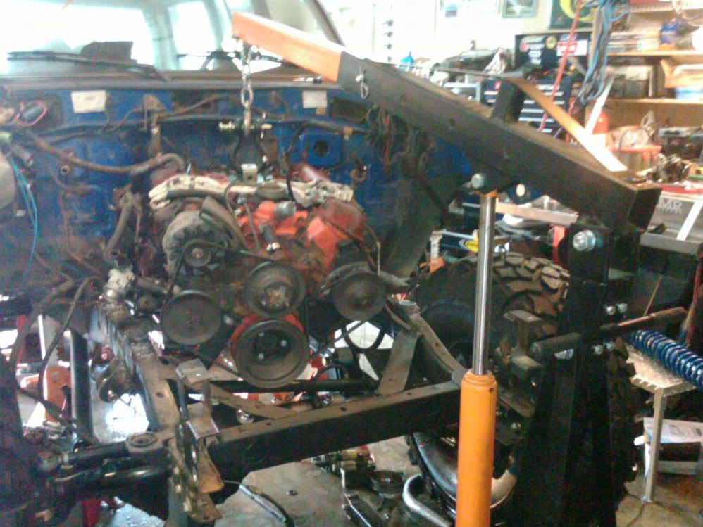

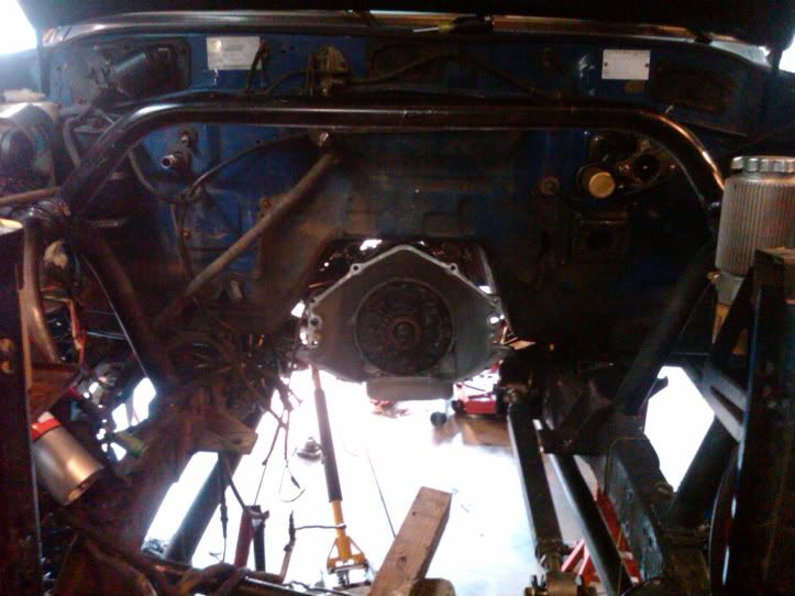

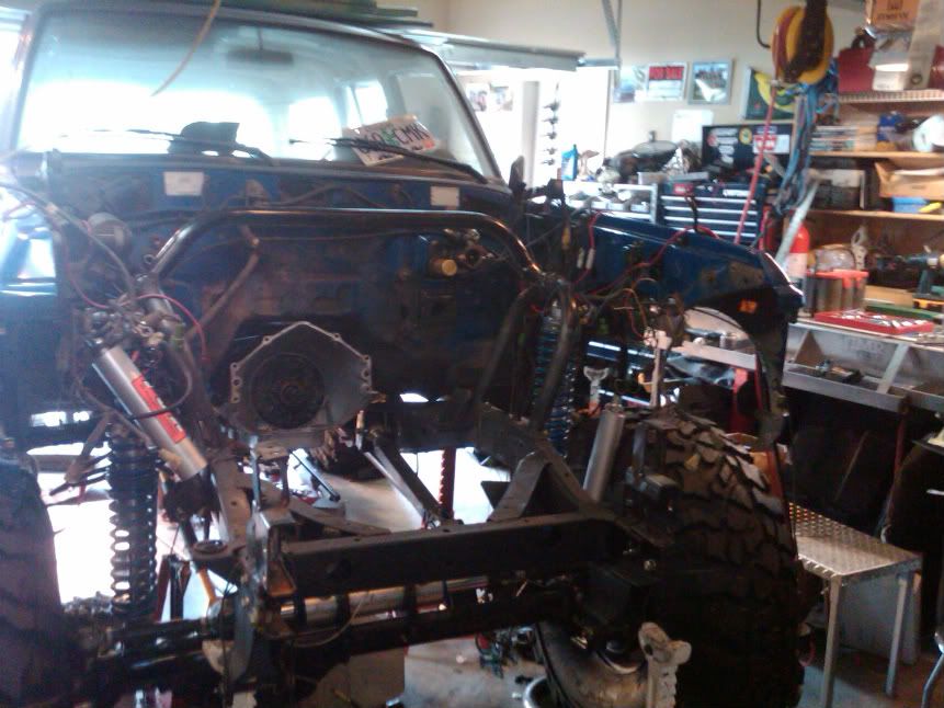

I seem to be going backwards on this project...
At least it's the same truck... I keep bouncin back and forth from Patches to Pickle .... Now I got Mama's Sancho :lol: I can't keep up with witch
one needs what... But back to yours a Bigablock in the snow and mud will be SWEET

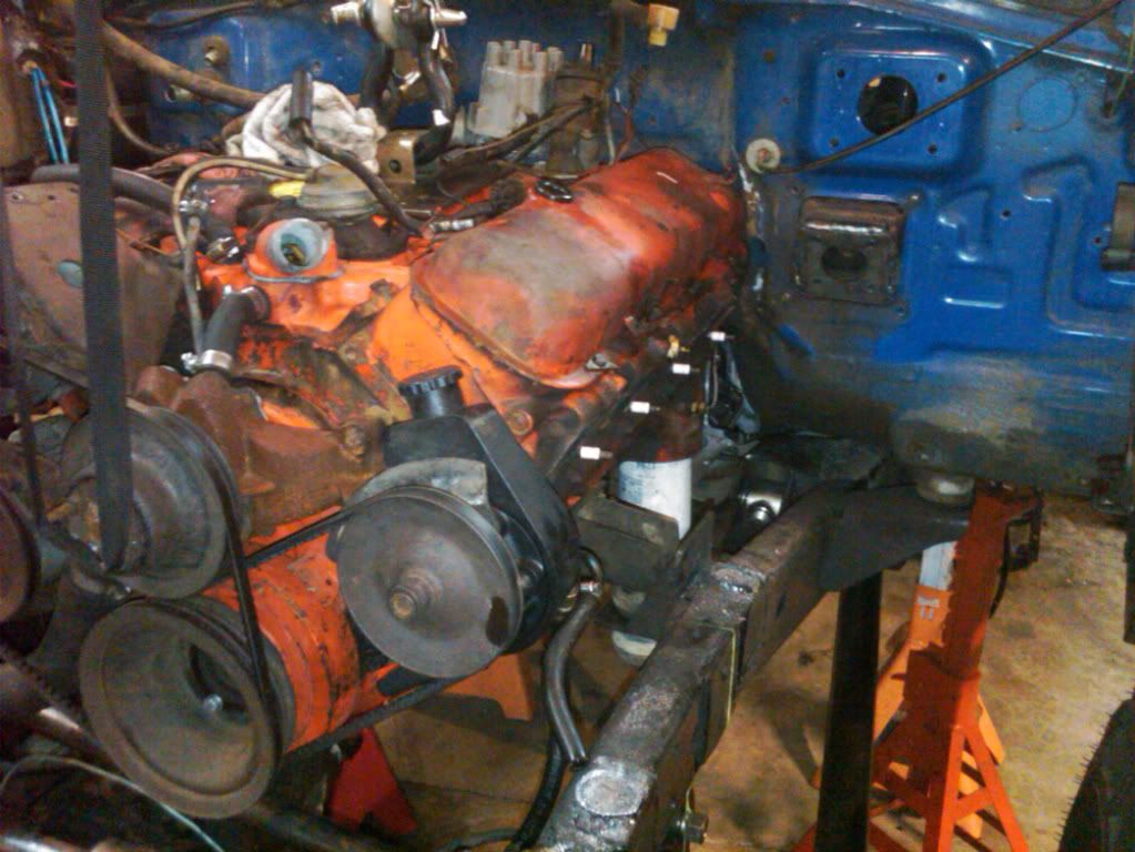

Great to see some cruiser time. What are the engine plans (mods, seals, etc.) and what color you going to paint it?
Orange, Black covers, gray accessories... pretty traditional chevy colors.
Plans for the motor are in the air. The downfall of these big block is low compression ratio which is about 8:1 which is not optimal for propane which I intend to run. Leaving it how it is and adding a xe268, performer intake and adding headers put it in the low 400 hp range and 500ish torque. I'm not exactly convinced of this with the compression ratio that low. I think it could end up being a dog... better than the 350 but a dog for a 454. Now, if I bump the the compression with some domed pistons to about 10:1 to 11:1 and increase the timing to get some of the BTU value back I could easily get into the upper 400s to 500hp and 530 torque range.
The problem there is feeding it enough propane at that point. I think I am going to call cary at gotpropane and see what he has to say. Honestly, I'm not interested into getting into the motor past the intake and cams.... and I dont really THAT much power... but I havent ruled it out either. :)
too late... I just called Cary at Gotpropane.com Hell of a dude. I ordered the kit. He said the 8:1 would just fine. He said "run it.... if want more just bump the compression down the road". I like that idea since the block was rebuilt not too long ago. If I want crazy power later-- it'll be available.
