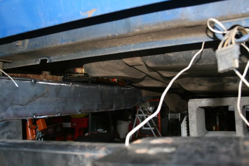

so to prove to myself that cutting the body that far back was a good idea, I bolted up the axle to the wheels and looked. This is at ride height... I refuse to go any higher (25" to frame rail with the 42's). Leaving it there will only give me 2" of bump MAX.
So then I crawled under there and found two more obvious hang ups...
1. The gas tank. Its hard to see in the pic but the top of the pumpkin is too close for my comfort and the axle isnt even all the way back yet. One launch off the sand dune and it'll munch it. hmmmm.

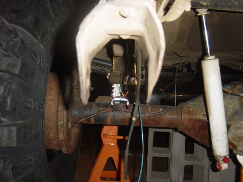

2. Springs are going have to be pretty flat. I'm moving the spring perches but I think I'll have to "french" in the front mount and sleeve the rear side which also means boxing in the frame rail back there.
I better start tracking down a fuel cell. :)

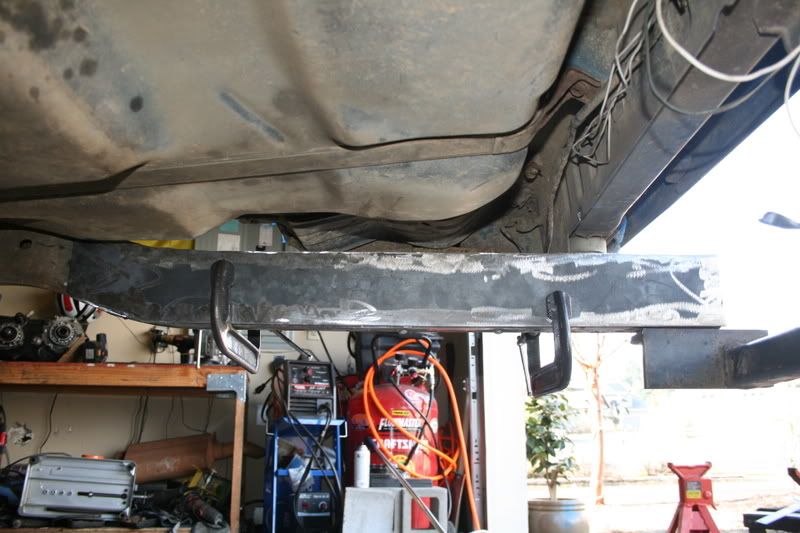

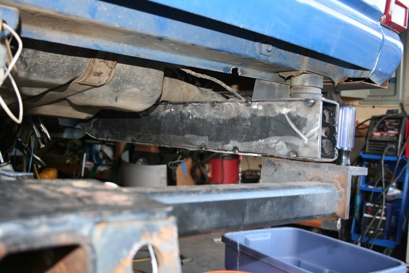

Boots and Dirtgypsy came by today and we got a bit more going:
Cut out the plate for boxing the frame
after a lil' trimmin:
tacked:
other side:
tank dropped:
intermission with Mike's bad ass 60 with a turbo 4bt:
cut the holes for the sleeves (rear shackle mount).

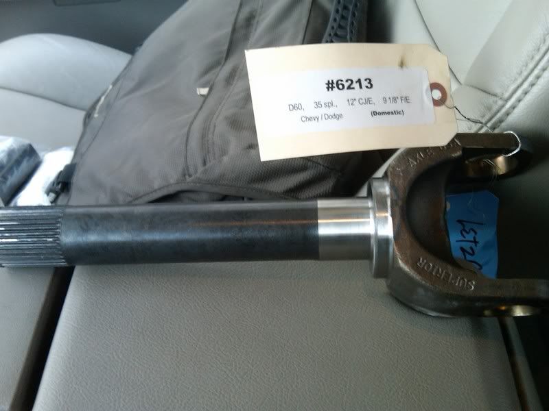

You should have seen how he was whiling around his 35 spline stub shaft! I have serious doubts that this set of axles are going to break. I'm afraid to take a ride in it because I'm already tempted to start saving for tons.
