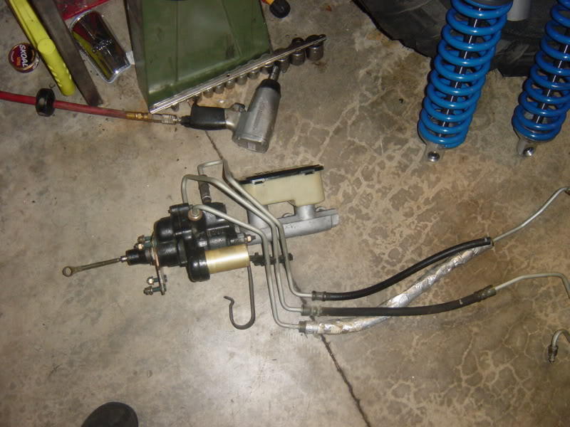

nothing really worth noting or picture worthy... I cut my link stock and took it over to LCNW to have them bore them to accept the tube adaptors. I also cut off all the link brackets that were on the D60 and started grinding the nubs off that I couldnt get close enough with the plasma. The grinding is what is really really slowing me down. There are only limited hours I get to do this between getting home from work, eating dinner, hangin with the fam, and then trying to get some grinding done before the baby goes down. I should have some decent time this weekend to get all my grinding done and setting up the brackets for the links. I might also start mocking up my crossmembers if my hydraulic kit for my bender gets here from copperhead fab too.

I have very limited room in the garage so bending tube was a problem. I decided to go cheapo hydro so that I could put the bender on a cart and push it around and get it out of the way when not in use. Should be able to bend up some coilover hoops now. :)
holy cow that is just sexy (bender) the truck looks good too. How long are those coil overs? looks like they will stick throgh the hood when you get them mounted.

The coilovers are 14" travel. I'm going to set up the hoops/coilovers at full compression and it'll be close. I'm not afraid to cut the hood if need be though.
I've been playing with the idea of 63" chevy springs for the back and moving the perches so that the rear tire will be closer to the end of the 60. Doing that will require some MAJOR trimming. Somthing similar to "Tippy R" or Baxter's rig for the rear cut outs. I've already hacked the rear fender somewhat so why not keep going? :rolleyes: I have something else in mind if that doesnt work out though. :cool:
How does the full-hydro do on the street? What size ram are you running?
Build is looking good!
There is all kinds of back and forth on running full hydro on the street. I bought a 3.5 turn orbital so I should be ok for the occasional road use this thing will see. The ram size..... ummmm big? I should probably figure that out but I still gotta finish up the other stuff first.
