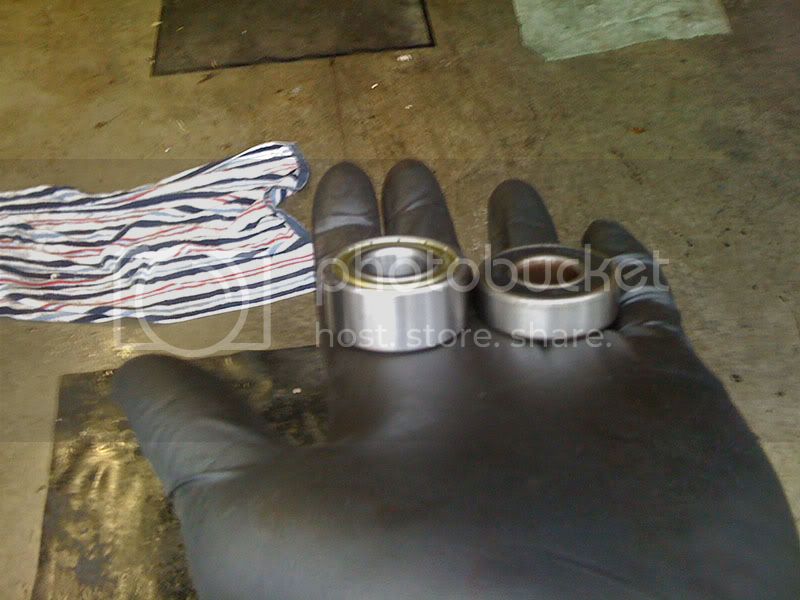

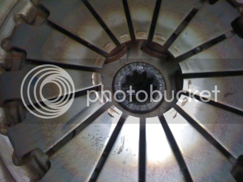

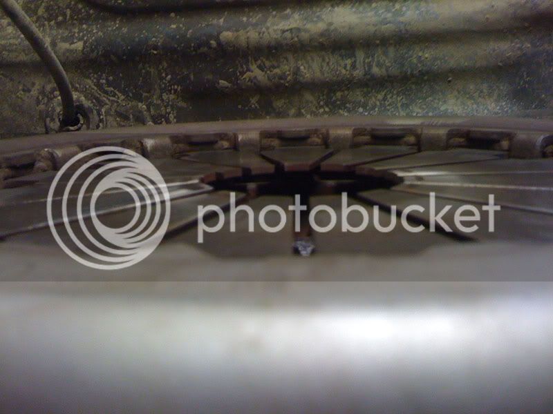

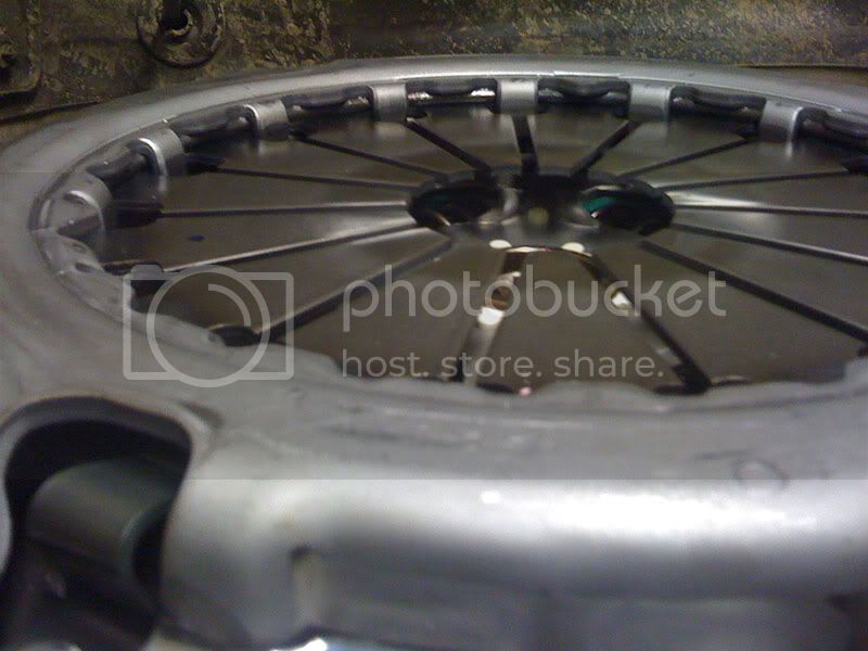

The springs on the pressure plate did not wear evenly. Not sure why. Chris said although the noise was loud from the bearing, it would have lasted quite a while. He rebuilt the clutch and installed a new pressure plate. He also used a larger bearing. Chris emailed me some pics. Here they are:

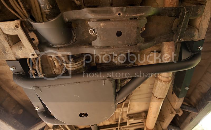

Here is a picture of the notch that LT at Metal Tech put in my crossmember and also the skid plate he made for my t-case. I think the only problem now is that the skid plate might be in contact with the t-case because now when I am stopped at a light and I'm idling, the entire body vibrates. As soon as I start to rev up the engine, even before the clutch is engaged, the vibration goes away. I think I might put some spacers in where the skid plate attaches to the frame. Anyone got any suggestions on what I should use for spacers? I guess I could use washers but I think something like plastic or rubber would be better. I think I just need to lower the skid plate a little so that it is not in contact with the t-case.

I also just realized that if I have the clutch disengaged when I am stopped and the body is vibrating, the t-case should also be disengaged and not vibrating either. Any one got any ideas on where the source of the vibration could be? It didn't vibrate like this before I took it to Metal Tech and it significantly vibrates since I got it back from Metal Tech. Maybe I'll try spacers on the skid plate just in case to see if it makes a difference. Any suggestions for what I should use for spacers would be greatly appreciated. Thanks.
:beer: Chad
Why not take it back to Metal Tech? If there is a clearance problem I would figure they should take a look at it since potentially there is contact from a part they made for you.

Looks to me like the pressure plate was not torqued evenly. So, who ever installed that clutch is at falt, not the parts.
Confused on how a "bigger" pilot bearing would help wear on the pressure plate and throwout bearing.

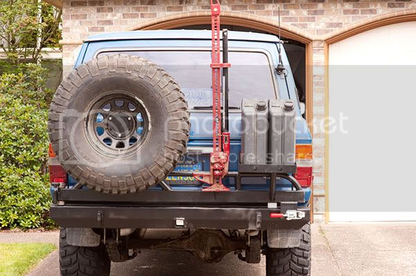

Love the thread, I'm hoping its still alive. I was wondering who made the rear bumper? I don't recognize it from others I've read. Looks great. Do you have pictures of it during assembly if you build it yourself?

The rear bumper was made by Jim at Solid Rock Off-Road in Colorado. He doesn't make them any more (as far as I know). I need to get an extra latch. One of the people on the Trek had a latch exactly like that one snap on them.

Hey Chad,
The latches are made by a company called DeStaCo, you can get them fast and reliable from McmasterCarr, or a bit cheaper if you search.
McMaster-Carr
(Go to the page with the "pull action" toggle clamps)
Don't get fooled by the prices, you have a large expensive one there, a lot of folks get the small cheap ones since they are cheap, but they are not up to the task.

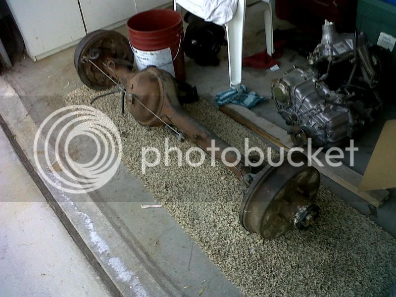

I currently have Poly Pro chromoly semi-float axles. I need to pull them and check for wear. I need to install new lug studs anyways. I broke one stud during the ACT 2010 and its time for them to be replaced. But the FF should be fun. Does anyone know where to get spare FF rear axles? Oh, and can I use my current third and install it with the FF axles or do I need to use the third the axles came with? I would assume I could use the third I have now. It has an Aussie locker in it and it is 4.11. Just wanted to make sure.
:beer: Chad

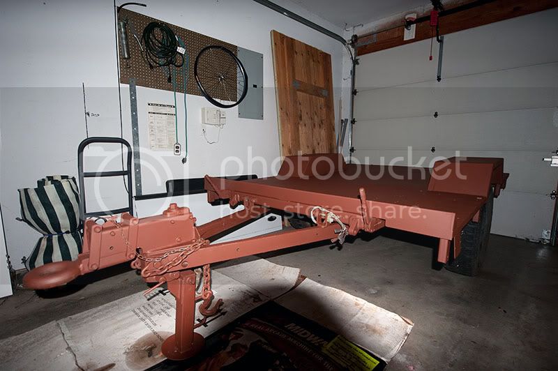

I also just bought this off-road trailer.
The plan is to get some Super Swamper LTBs in 35x12.5-15 and trailer them up to the Alaska Cruiser Trek 2011. Then I'll put them on at Mark W's shop and drive them to the trailhead from there. I'll also leave the trailer at Mark's shop. I think my Mickey Thompson Baja Claws will be pretty worn out by the time I've put two trips to Alaska on them and been driving them for a few years. Tire tread can make a big difference on the trail.
