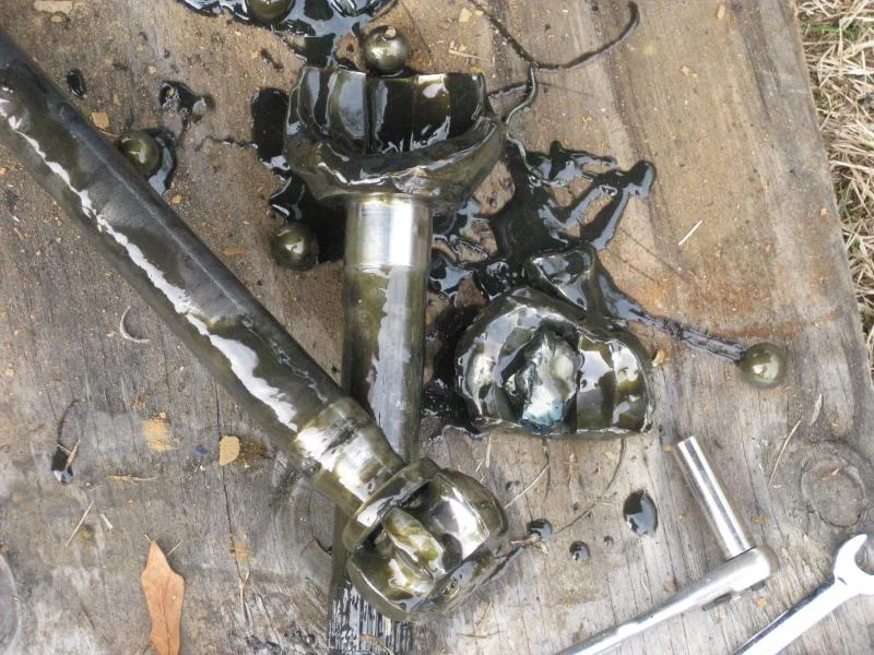

I think the doors look pretty good, just got to finish painting to match the truck. Also got some longfields ordered so I can finish the front axle rebuild should have done that the first time!!!!!:bang:
