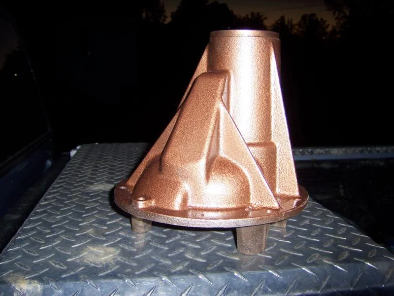

O.K. thanks for the info on the fram. I'll just leave mine for now maybe later if I decide I'll do away w/ them, as for the welds that is the ends of my sliders I just capped them off. and finally YES my kit has arrived here are some pics of todays progress!:clap::beer:
