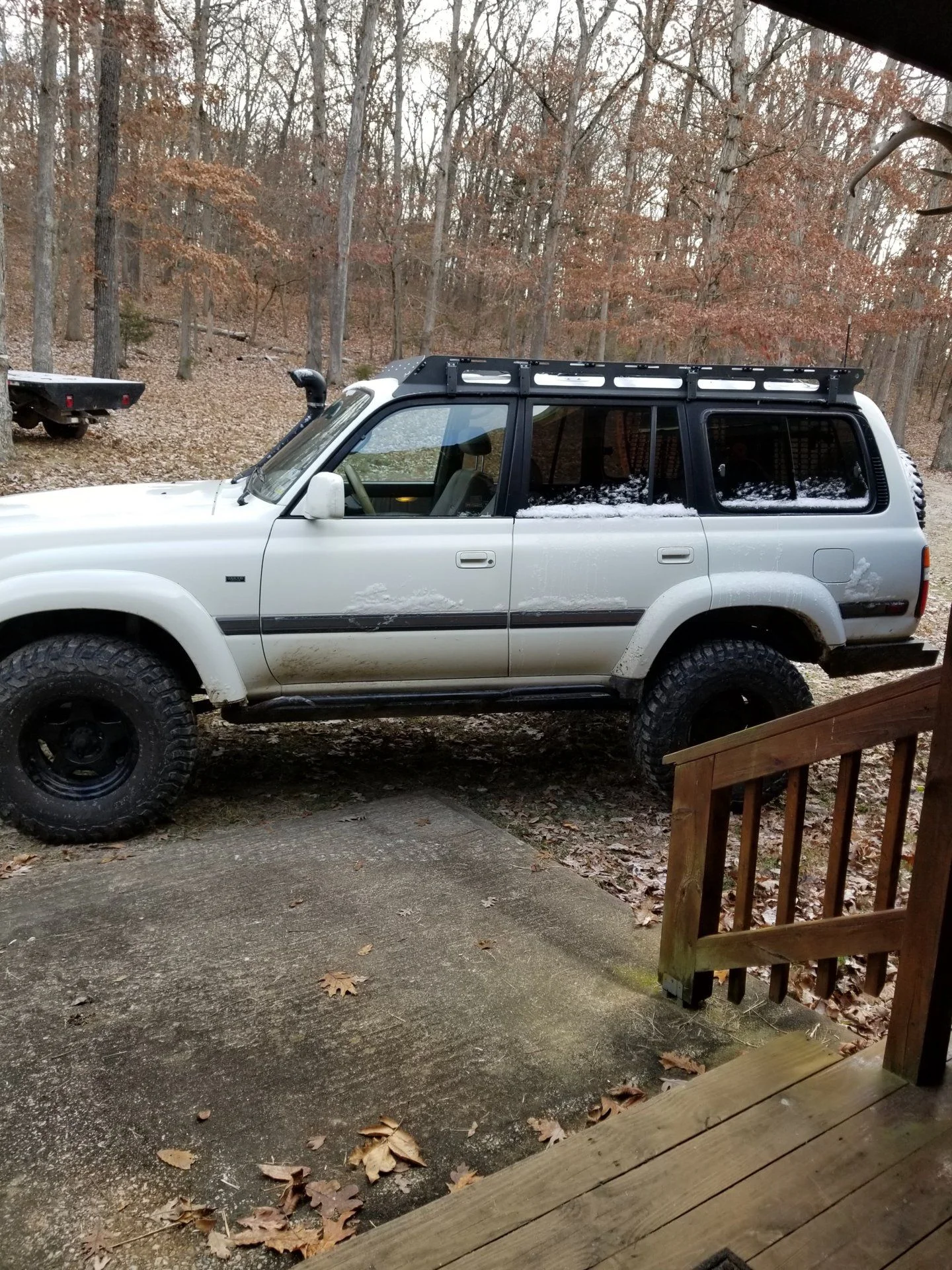

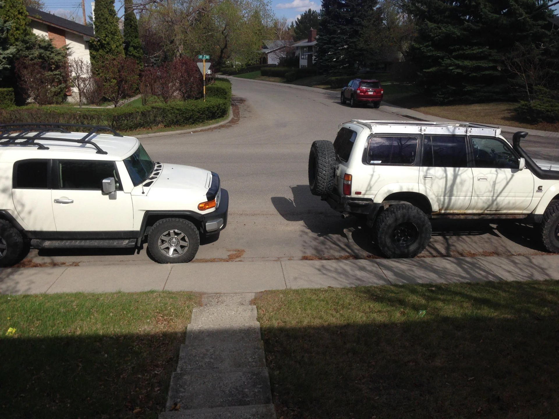

I built a rack for my 80 the other year and I believe someone on the site builds/sells something similar. Some pics of the rack on my 80, to show you can have something lower profile
Edit: isn't really higher than the factory rubber trim on the roof, some more pics in this thread: ultra low roof rack

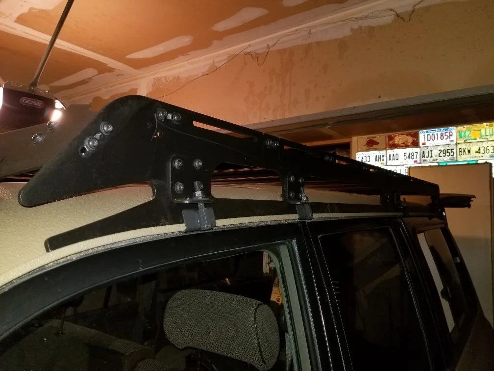

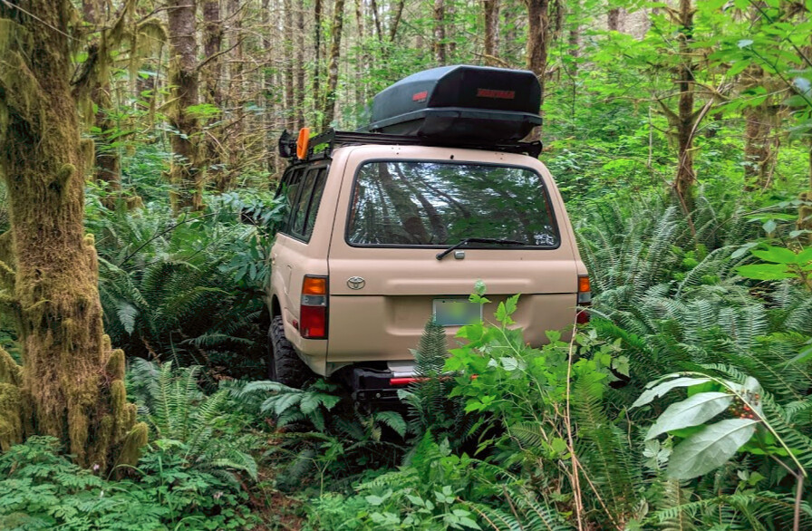

Rack's on! And I must say, it is splendid. buddy and I threw it up there the day before a weekend rough riding, in which it performed perfectly. I haven't really bolted anything to it yet, just used bungies and a rooftop carrier.

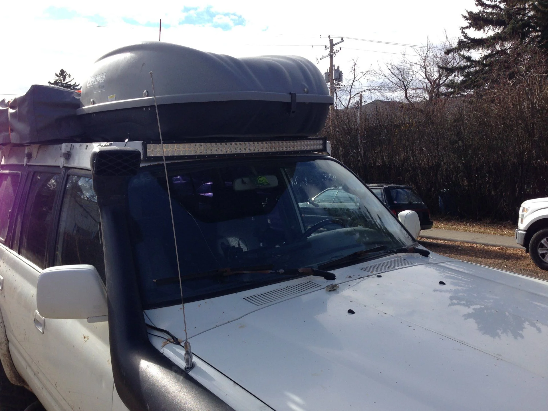

The CMI folks made me an excellent deal on a 40" KC light bar too. Here are some assembly shots
All-in-all, very happy. I take back my previous gripings about timeliness and customer service concerns. Looks to me like they've ironed things out and deliver an exceptional product at a super-low price.

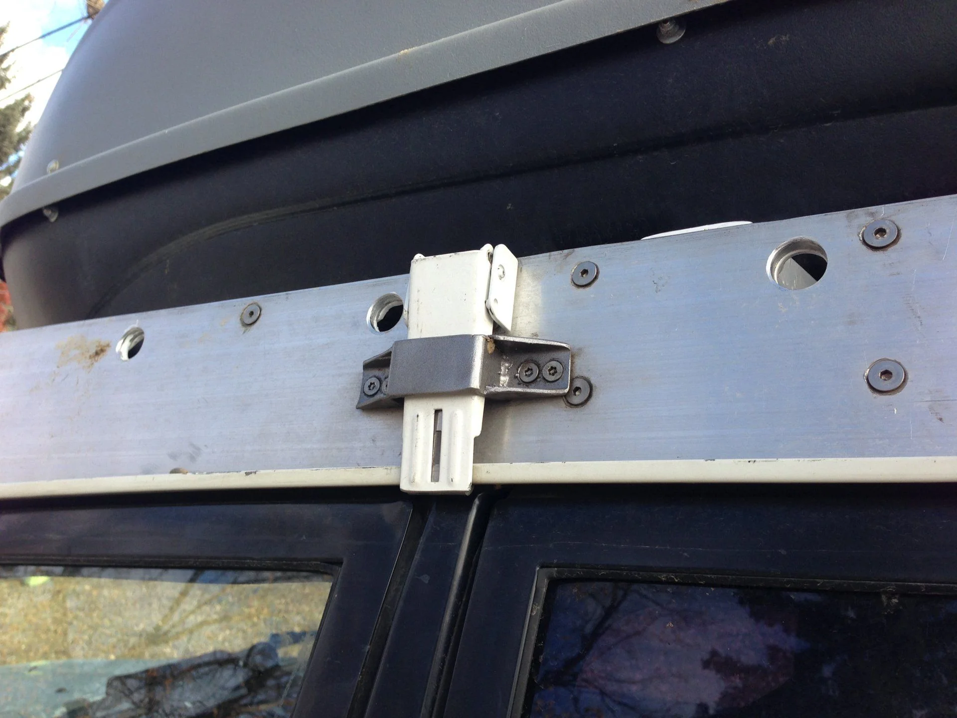

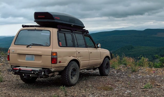

Carl, how did you attach your Yakima box to the Prinsu rack? I have the same rack and a similar cargo box (a Thule actually) but the bottom of the box is recessed so it doesn't mount flush to the rack. Does the Yakima have a flat bottom?
I'm throwing together my own solution for now at least, but wondering if something exists. I'm coming up empty here.

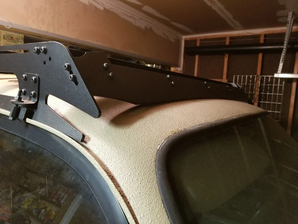

Bowfin rack is a 10. Nothing about it that i don't like and if your looking to buy from active cruiser member then its a double plus. I personally think the rack attachment is heads above prinsu.
What are the differences over Prisnu? Im not seeing it or any.
Biggest difference is prinsu uses a bolt type of attachment. Not sure if they have addressed it yet but several threads on having to source specialty washers to get the angle correct and not hit door.

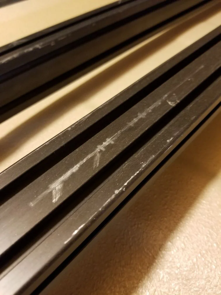

You can see the scuff marks I'm talking about. Nothing major and it would clean up very nicely to repaint. But the rack is aluminum so it's not going to rust. Also, if used, the rack will just get scuffed again so I'm not going to touch it up.

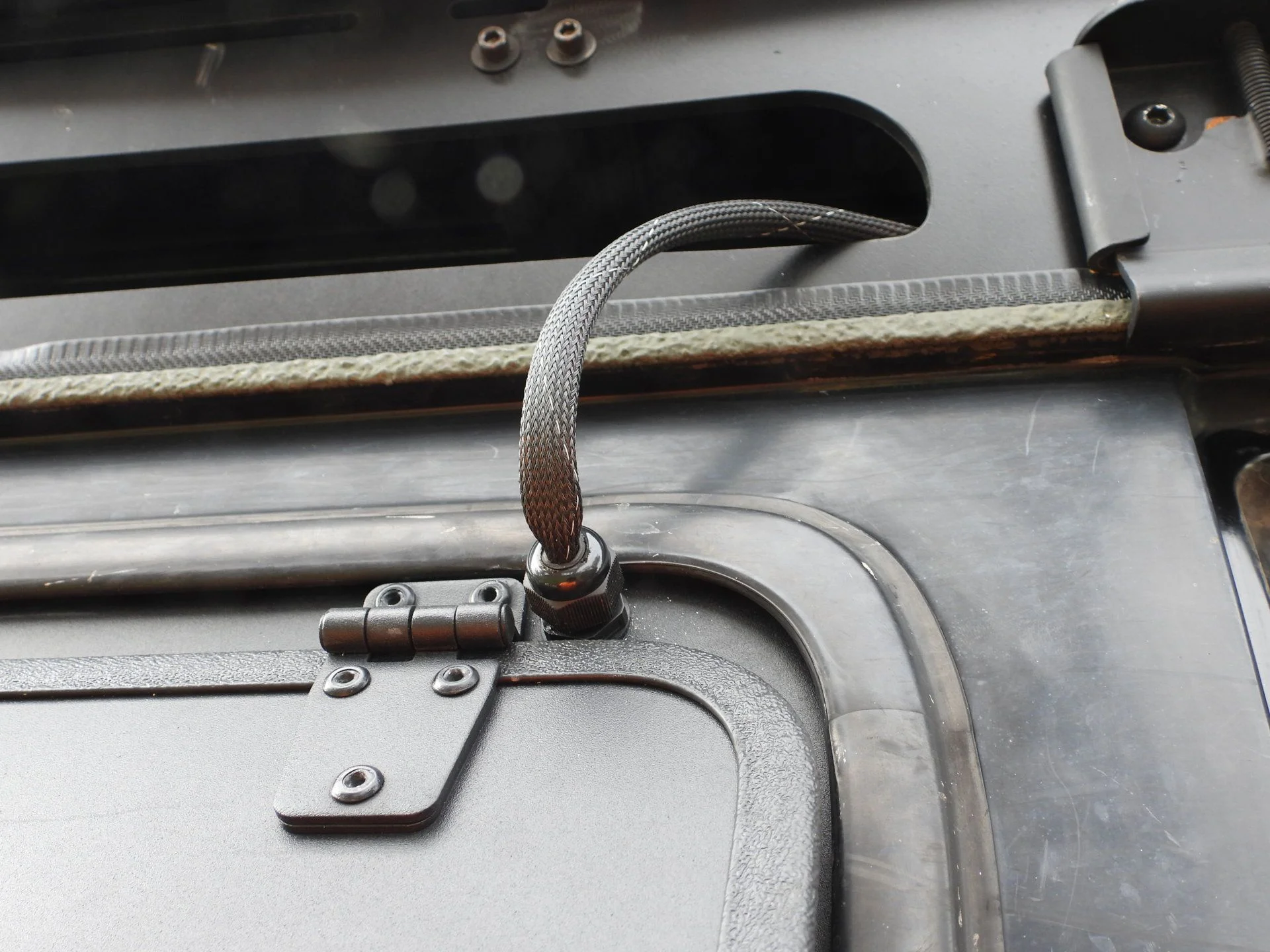

The light bar fits down into a cutout area in the wind deflector. The base of the cutout is the 1x 2 extrusion. You just use 4 t-nuts/bolts (included when you order the light bar style) to bolt the brackets that come with the light bar.
