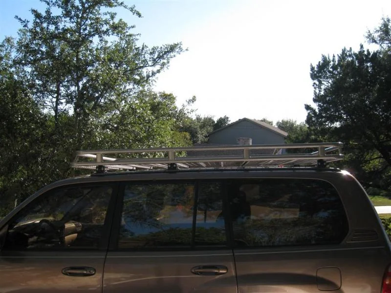

Dave...are the feet/attachment points part of the Front Runner package?

Agreed - I have the Front Runner as well with the Large RTT from Camp Lab. Very versatile. I haul a canoe up there too, for me the basket would just get in the way. If you want the best of both worlds you might look at a Hannibal Rack, it's pretty much the same as the front runner but I believe they have sides you can put on to make a basket when needed.

Dave,
I finally got it on. I needed to drill a hole and countersink into each rail for the missing hole in the middle tower location of each rail. No big deal...I just expected it to fit since its a 100 series specific rail system. Yoter100 relayed he had to do the same to his...
Also I can't reposition the rack, front to back, without taking the vertical risers that attach to the rails completely apart: There is not quite enough vertical clearance for the special 'flat' nuts that reside inside the rail channel. That would have helped me a ton! The rail channel ID just needs to be about 1-2mm taller to make it right.
Now that it is on I'm happy with it.
Yeah, that's the only thing I didn't like. The AO mounting feet were way easier to access and made repositioning easier. It's not a big deal once you get it positioned where you want it.
