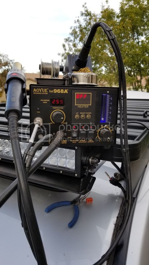

@619TOY thanks for the info. I managed to pull the connector apart and soldered it back on.
The word "overkill" isn't in my vocabulary. :p

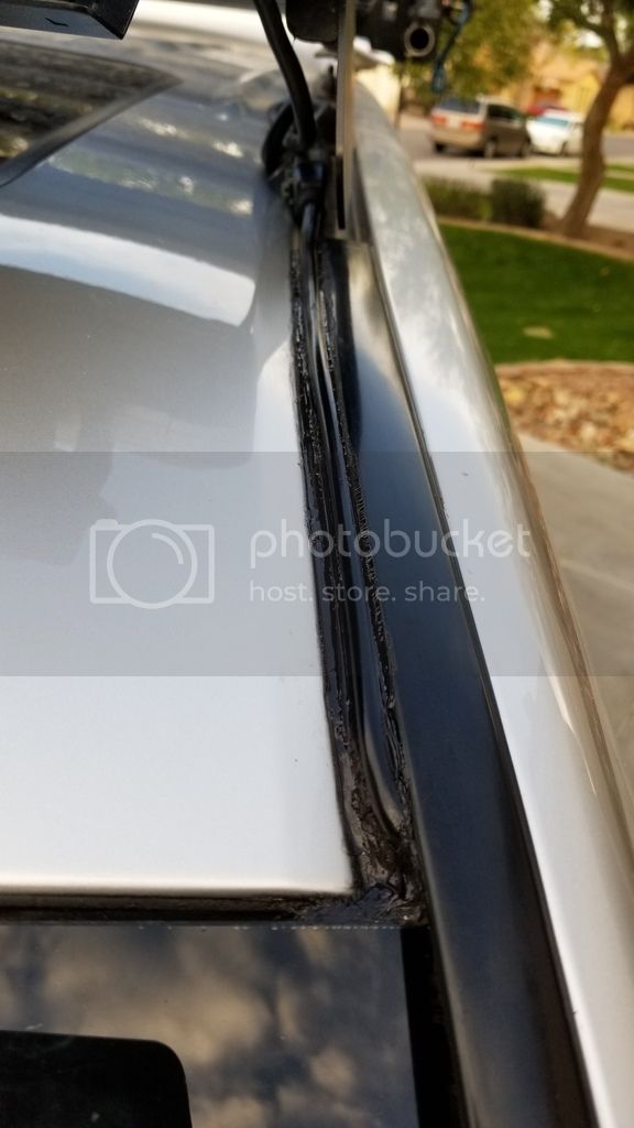

Also finished up the silicone where the cable exits the A-piller above the windshield. There isn't room within the channel past this point. Unless you are looking for it, you don't even know it's there!
