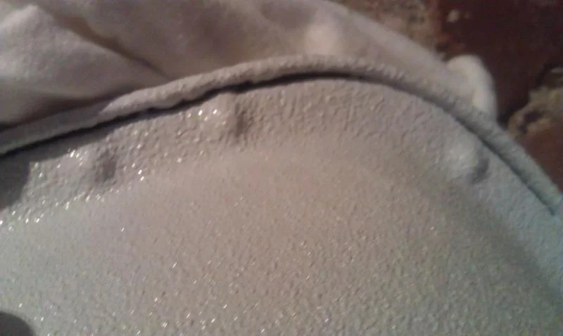

The roof gutter thing has been threaded to death, but my situation is a bit unique.
I completely stripped it down and then had the local Line-X guy shoot it. It turned out awesome, but didn't nor was it intended to fill the gap around the gutter.
My question is this. SEM or Sikaflex??? Seems like there are positives and negatives.
SEM is self leveling, but requires a special gun and needs to be painted.
Sikaflex seems to me to be more like caulk so I would have to be more precise, but is marine grade and doesn' need to be painted.
Any thoughts??
