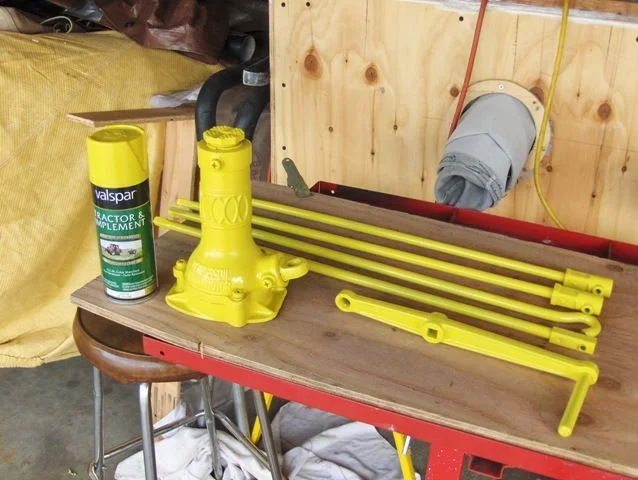

Decided to clean up my jack and handles. The jack was taken apart, cleaned then sand blasted and cleaned again. Greased reassembled and painted with 2 coats of masterseries and finally the yellow. Which by the way I think is a little to bright for OE.

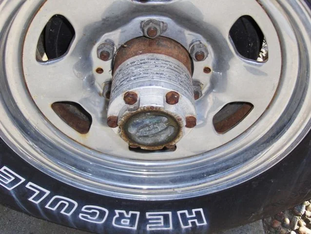

Can anyone tell from the pic below what vintage my locking hubs are from?

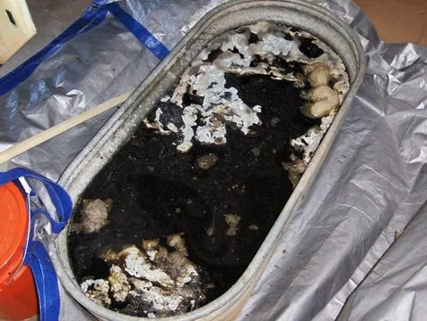

It's been a while but I've done a few little things to move the project along. Most recently I started a molasis bath to soak some rusted parts in. They have been in there 6 or 8 weeks and I looked at them today. I was impressed. Since the water temp was 48F I was afraid that the results would be less. I pressure washed the parts and they flash rusted pretty quick so I need to decide how I'm going to deal with that. It's too cold right now it paint so.....
I didn't get pics of the items before and after:frown: but I will use this system again without a doubt.
I have some stuff in my scuba stash that i used to stop the flash rust on the inside of a tank after it's pressure tested so i think I might try spraying that on the metal.

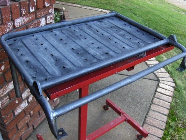

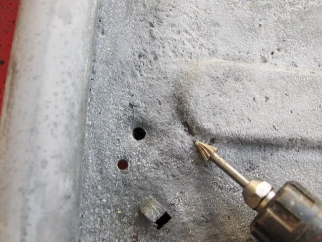

After the molasses bath and a quick blast with some sand I still had those pesky little black pits to remove. So I did it the same way as I did my running boards, with a rotary tool. Digging each and everyone of those pits out. I just don't want them there!

If you do the molasses bath think about doing it in a container with a lid. I covered mine with a tarp and that worked well. Very small parts, springs, brackets and some nuts and bolts I put in a jar with a lid.
