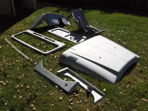

I finished sanding the hood last weekend and got a couple of coats of masterseries silver on it. Today I sanded the right fender and have the first coat on the top side. Hopefully monday I will finish it ans then move ob to the left side.

A coat of master series. I will need to sand the runs and brush marks before spraying with primer but this metal is protected! Every square inch has been sand blasted with a Speedy Blaster and boy does that take time but for now it's all I have for the bigger stuff.
looking good :)
