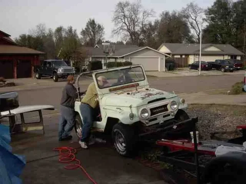

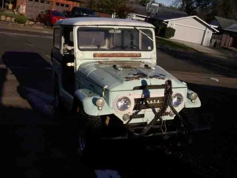

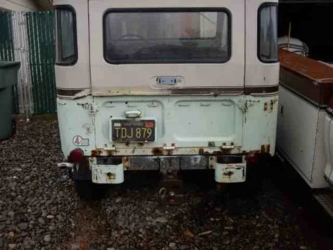

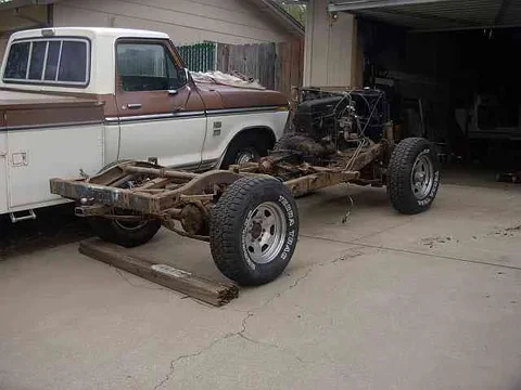

This is how the project came home
Now I'll have to figure out how to upload more than 3 pics. I bought a star yesterday just for that reason.
I've already gained a wealth of information from some of you here and am looking foreward to the rest of the project.
How she looks now
Current photos

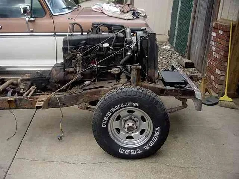

I still have motor mounted to the frame. it's a great place to store it for now.

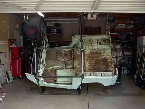

I put the tub on a Poor mans rotisserie for some body work. Besides having a 1/2" of bondo on one corner the PO drilled over 100 holes. 3 of them were to mount a 3 point Roll bar to the frame. It has the typical rust but I don't think it's too bad for a 65. The 3 holes have been filled and I'm working on the rust now.

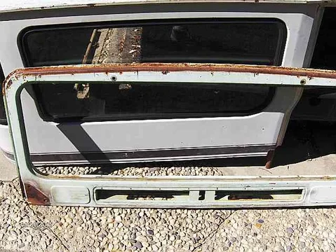

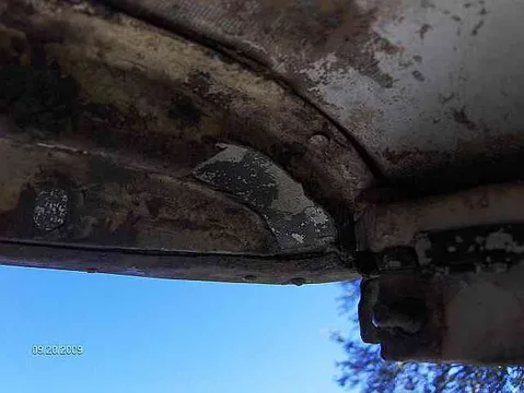

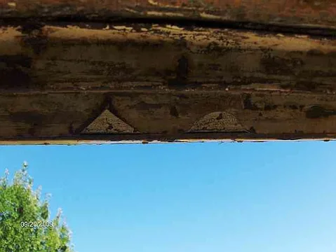

Observant eyes mentioned to me in a different thread that my top (newer) didn't fit the windshield frame correctly. So I went and got the frame out of the shed and took some pics. It amazes me how observant some of you are! I will get a Paki Top to complete this rig so I may not do much to repair the current top. But just in case, ANY ideas on how to get a good fit would be nice.
No holes in the frame to bolt the top to. I won't be drilling any either so what ever I come up with have to work around that.
The top was cut away in the corners and notched for the wipers.
This top was never attached to the rig. I set in place to tow it home. I think that the PO bought it and tried to get a fit. He told me that it wasn't very good and may not work. I thought I had it figured out when I did a little body alingment but never checked it out. Eventually it will have a PAki top so I may just have trading material here. We'll see.

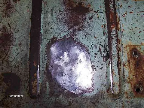

Filling holes

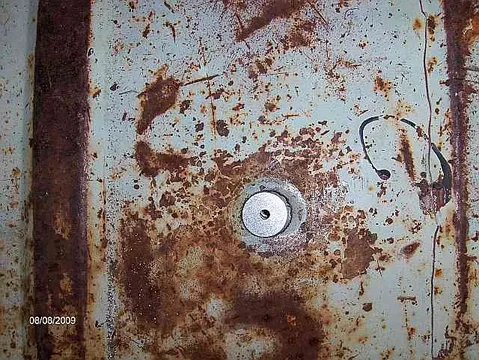

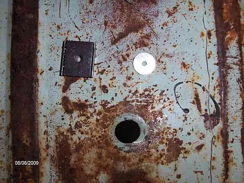

Thought I would try my luck a filing a hole creatd by the PO. I read on one of the sites about using a washer so I went to the store and bought some the same thickness as the tub steel and with as small a hole in the center as possible.
I put a small magnet underneath, set it in place and welded it in very slowly.
All in all I think it came out OK. What method do you use to fill holes. Most of mine arn't this big
Rod

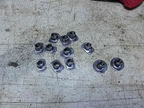

Weld nuts
During the disassembly several bolts twisted off inside the weld nuts. I looked all over for the correct one to replace them. All I could find were the ones from McMaster Car. I took a grinder to them to get a better OE look. Any one have a source for the real thing?
I also need a few of the captured weld nuts that are around the tranny hump. No pic of those.

During the disassembly several bolts twisted off inside the weld nut Any one have a source for the real thing?
Rod
I've used the nut-serts (pop rivet type). Not having the proper installing tool I tacked them on the exposed collar and compressed them with a regular bolt. :hillbilly:
The captured nuts around the tranny hump are regular nuts in a welded on cage, you can open the cage and slip in a new nut.

I will have to look into the nut serts, sounds like a way to go. When I was removing my tranny hump I used an air ratchet and it made a pretzel out of a couple of the captured weld nuts. I found these at McMaster Carr.

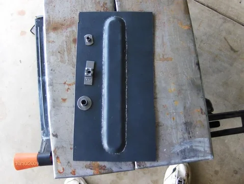

I also tried my luck at recreating one of the ribs for a rusted area of the wheel well. Used the techniques learned in a thread elsewhere in MUD. (sorry not sure how to link that here). Not to bad but I think I'll have another go at it to see if I can make it a little narrower. I used sheet metal that is 1/16 in thick and it is tough to hammer. I may have to go a little less than 1/16 to get the look I want. Has anyone esle tried the hammer and chisel/brick bolster method and have any other helpful hints. I only used a chisel but that darn thing took me SEVERAL hours to make! My hands are sore! :crybaby:
