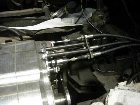

new mount on adaptor

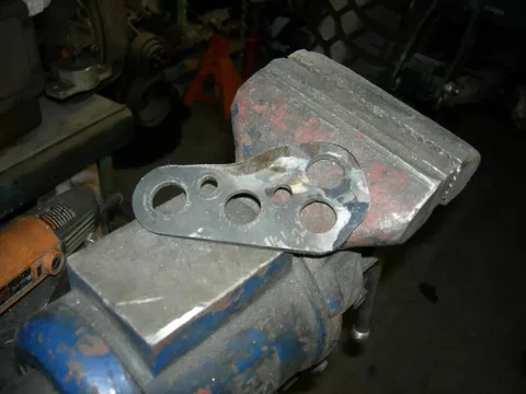

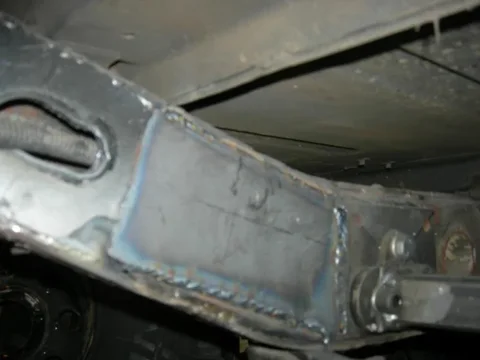

after cutting into the square stock it bowed a bit.
used the press to straighten it out

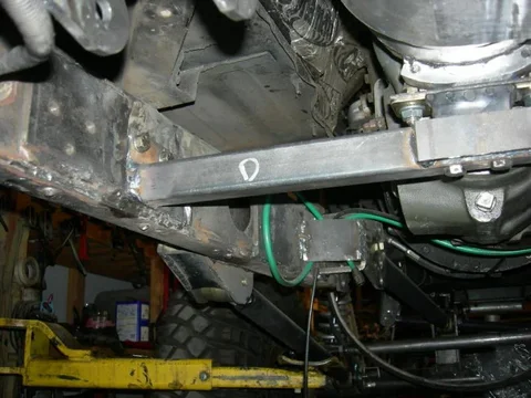

welded in the attachment plate
drilled holes and made room for pan head allen

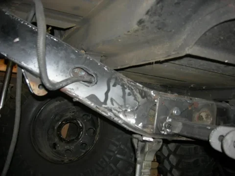

had to make some studs out of all thread
cut off wheel and a thread file

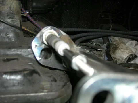

used some garage door brackets as attachment points

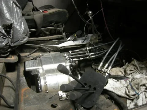

you would think the vendors for the tcase and shifter would tell you about application problems before hand.
enough shifter pics
I cant time the cables right now because I really dont know where they are going to end up.
I will most likely have to get rid of the center console and put them there
