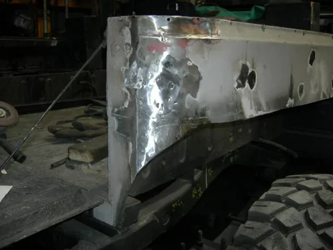

more pics

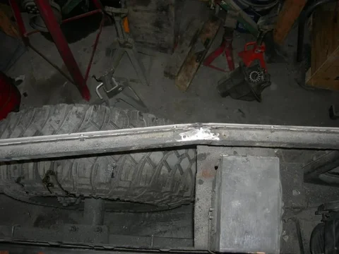

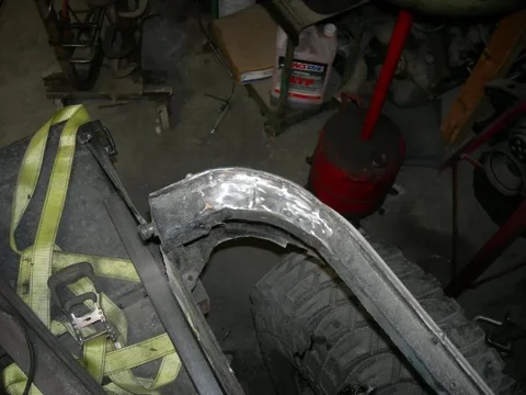

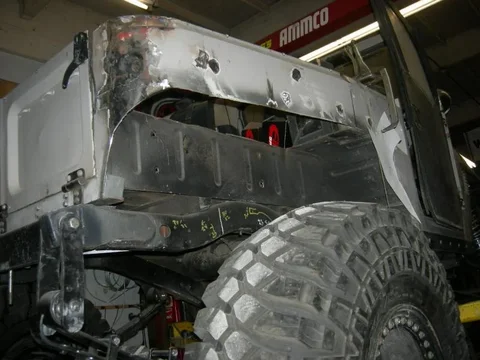

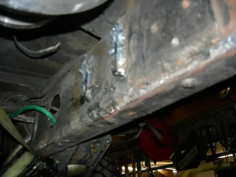

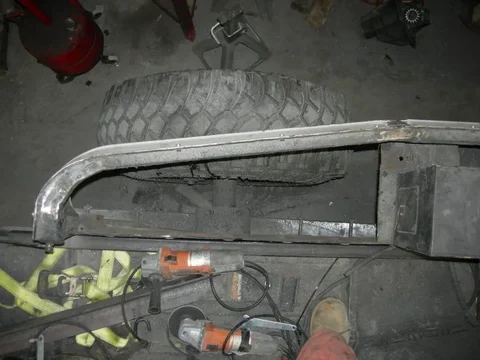

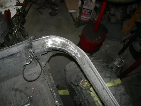

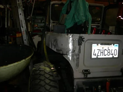

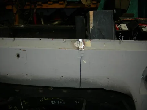

mid body line. Had a clamp in place at the time of bend but no pics

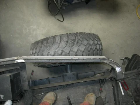

pulled the quarters together with a strap (not pictured)

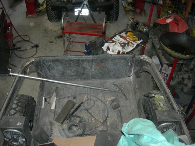

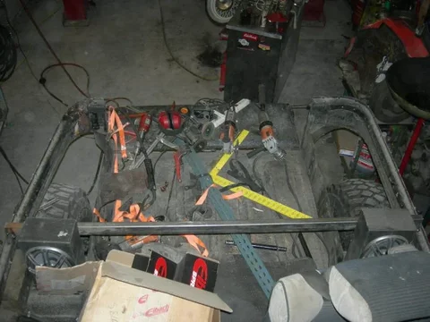

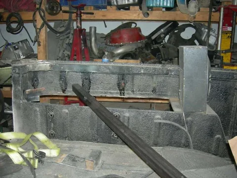

picture from the top

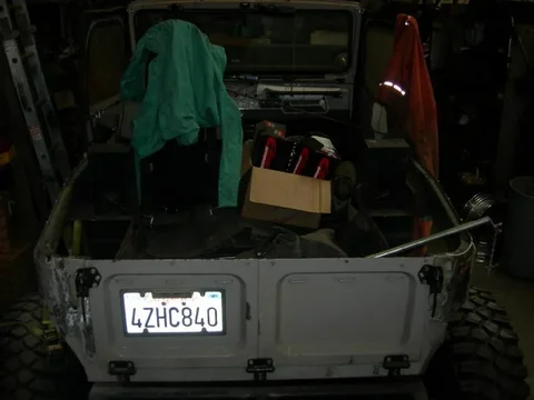

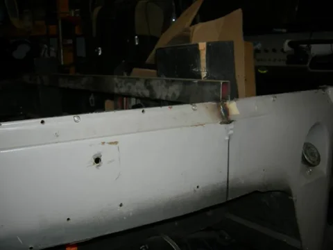

Its hard to tell form the photos how much its dovetailed but its pretty close to the the same width as the front bib.

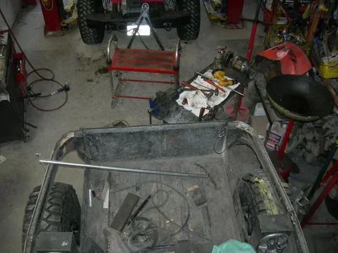

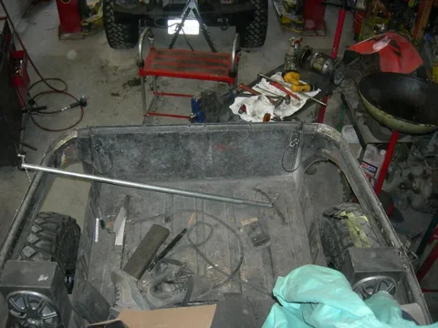

sloppy work area
I am going to leave the wheel wells open until I get the shock hoops welded in

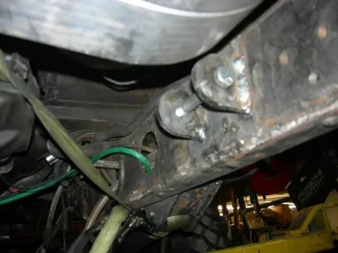

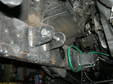

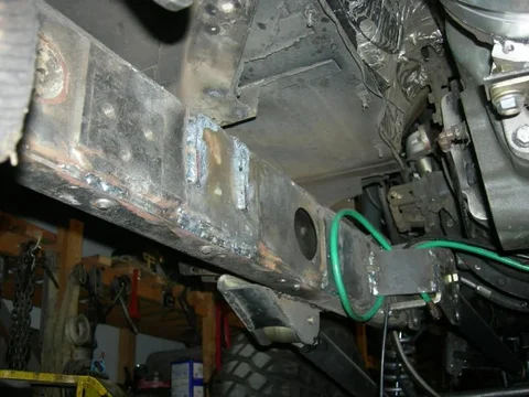

My one question is are you mounting the tcase to the rear crossmember? If you are, I know your going for beef but I just don't agree with an extra mount. The flex in the mounts will not be allowing the drive train to rotate around the same axis if you know what I mean. It will cause the adapter to flex as the engine tranny tcase assembly torques. Just my thoughts, I hope I have explained myself well enough.
FLYINGLOW
bustanutley

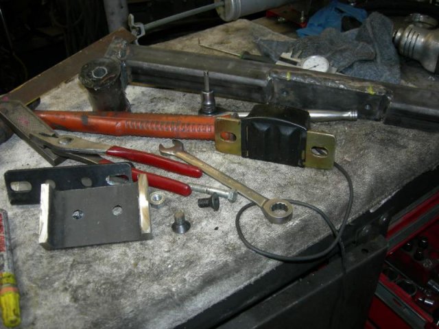

The rear is what I consider a removable crossmember and will be used as a mount for the rear links and frame stability mid way of the frame. The crossmember also has a poly bushing mount for tcase SUPPORT only.
The tcase mount (forward) was giving me hell and I had a devil of a time with it. I have a better mount that attaches to the bottom of the novak adaptor but it hangs down below the frame.
Are you guys suggesting that the tcase mount that only has poly bushings on the frame rails will not allow the the drive train to rotate/flex??
If thats the case I will change it now.
Thanks for weighing in on the issues and please respond to the above question.
I continually make mistakes while working on my junk by myself with no supervision/help.
The poly bushings will not allow for enough movement when you give them so much leverage against the drivetrain. If the chassis twists at a different rate from your belhouseing mounts to your x-member with the poly bushings, you are going to induce a pretty substantial torsion load on the drivetrain and will end up with matting surfaces coming loose which will result in sealing problems, or worse yet, breaking the adapter. Poser set his up like yours but is frame is reinforced heavily.
Here are some photos of what I did, I have the same setup as you BTW, but with an atlas instead of a mosterbox.
After thinking about it I agree with your assesment and I will redo it this weekend.
Yes that is what I was thinking. Without that torque tube cross member you are opening yourself up to more frame flex but there is no other way around it with a trive train as long as yours.
