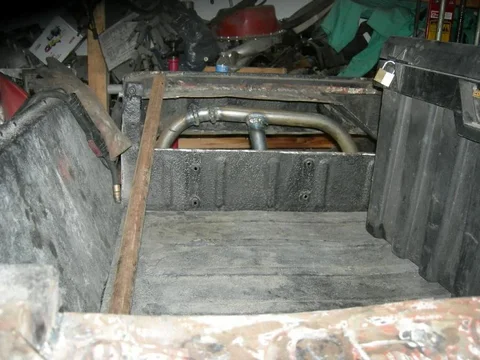

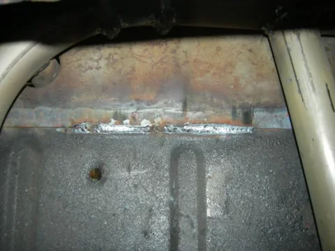

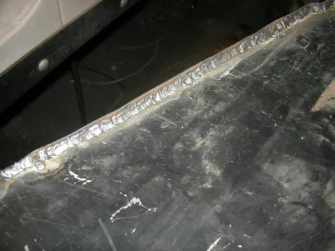

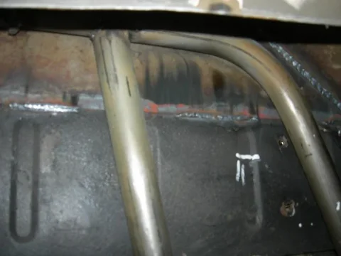

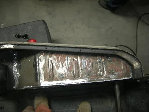

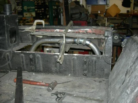

started to cap off the rear wheel wells.
Was working late and the bead roller was unavailable so I decided to use the original wheel well that I cut out
clamped in passenger side

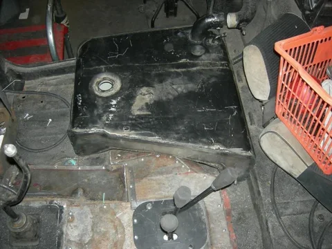

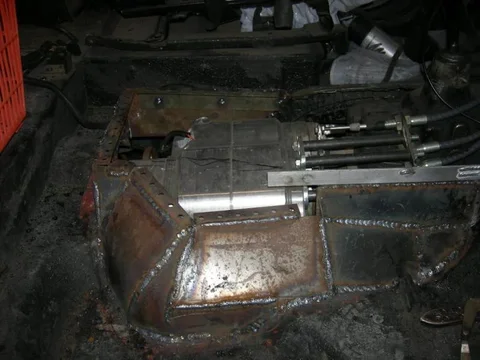

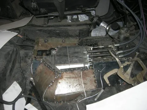

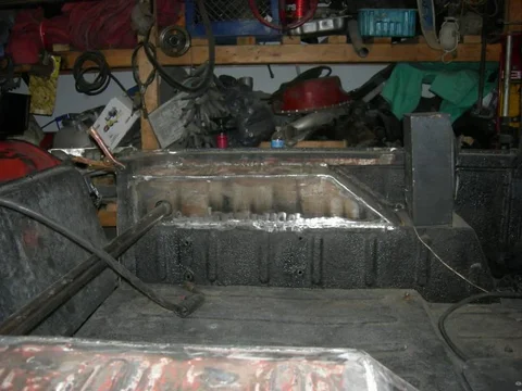

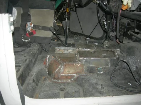

the beginning of the tunnel cover
it's pretty ugly right now

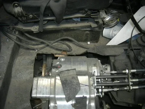

I am going to put the gas tank under the passenger seat so I am trying to keep the tcase cover low
that's it for know

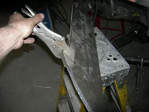

The tunnel cover is ugly but I could not figure any other way to do it.
Took a full day to finish

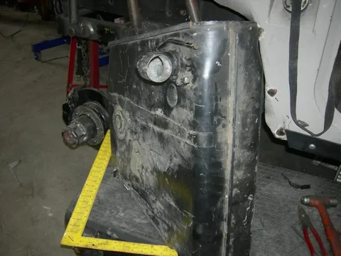

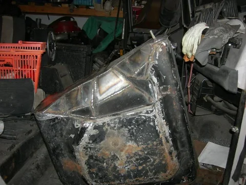

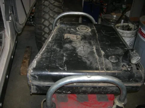

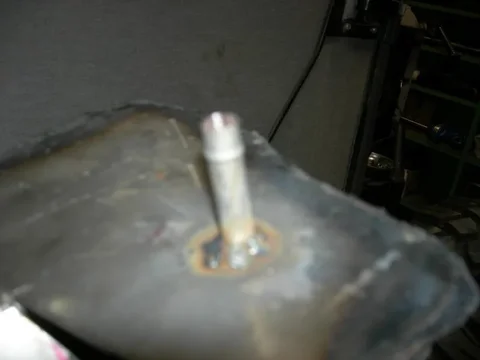

Moved on to the gas tank

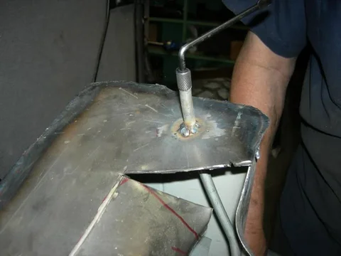

had to cut a little more off the tank to fit the tunnel cover
tank partially finished

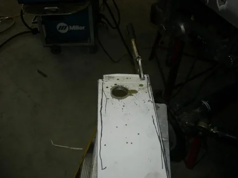

I am going to pressure test for leaks then I am going to have a local shop line the inside and outside of the tank
I am anxious to see what the tank capacity is. I am hoping it holds at least 10 or 12 gallons...

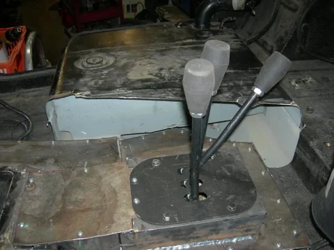

snug fit

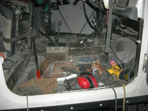

Diesel Dan,
The tranny hump comes off the floor in 3 pieces for access to the shifters, the tcase and the tranny if and when I need to ever take them out.
I havent timed the shifters yet but hopefully soon..
I can see about 2 days of fabrication work you have done there.
You are going to have one heck of a time adjusting the linkage with the welded on tranny hump. Did you already add fluid to the T-case? :hhmm:
LOL!
I should have known you would not have welded it to the floor pan. :o
Diesel Dan,
I havent timed the shifters yet but hoefully soon..
