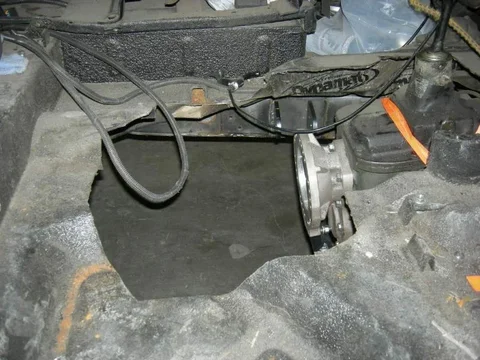

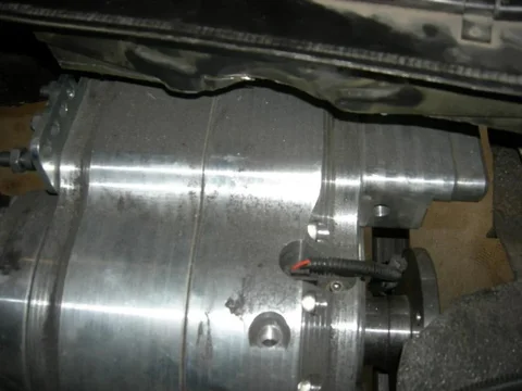

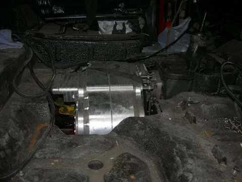

I guess the plan is to build a new tcase hump.

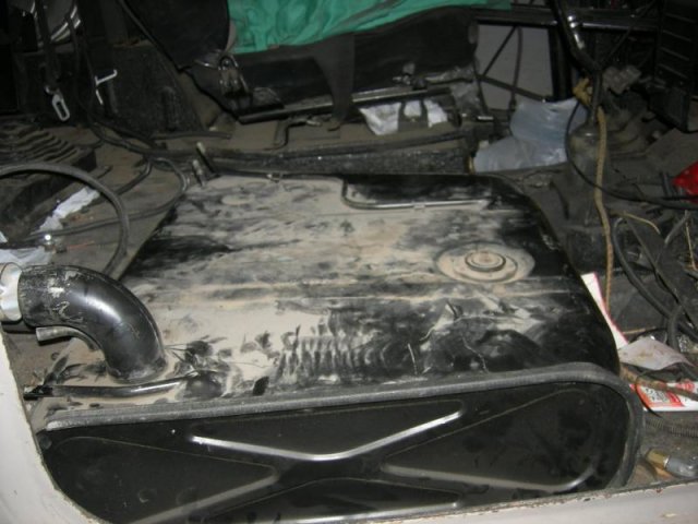

I am going to try to keep the stock gas tank in the stock location.
I guess I will cut into the tank and reweld it.
I haven't seen anyone else modify the stock tank but I am sure it has been done.
If anyone has modified their stock tank please let me know.
I dont want to put a fuel cell in the back.
I am trying to stay as low as possible and the tcase is above floor about 5 inches
I went with a 2" body lift so all my gearcases would fit with minimal pounding.

I didnt even think about baking the tank, thanks for the tip
pics tonight or tomorrow
I feel your pain, I wanted to modify my tank but copped out and bought a cell instead. I think you will have to get the tank baked to get the fuel out of the pores of the metal so you can get a good weld that seals.

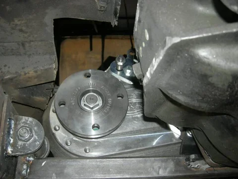

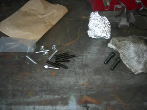

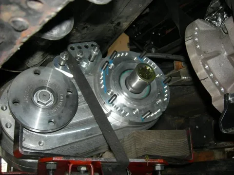

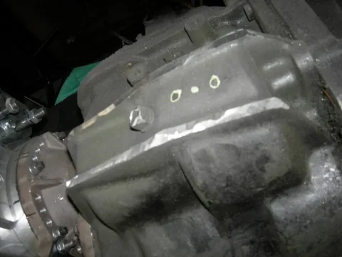

tcase installed to adpator.
RTV junky

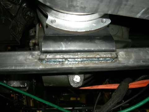

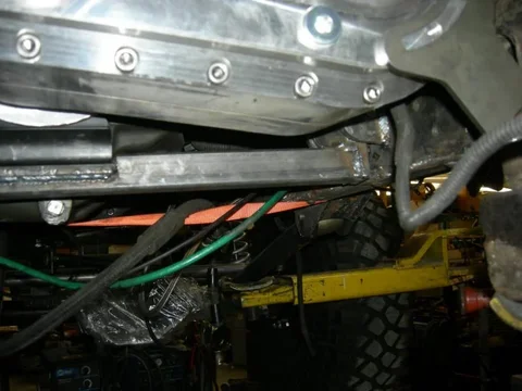

cross member installed and be used for the rear lower links
tcase support on the wrong side but I could not figure out how to support the tcase on the passenger side. I have since came up with a couple of ideas
a big hole in the floor board
I am not using my old tank because it was lined a couple of years ago and there is no need to tear it up

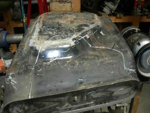

grabbed a fj45 tank

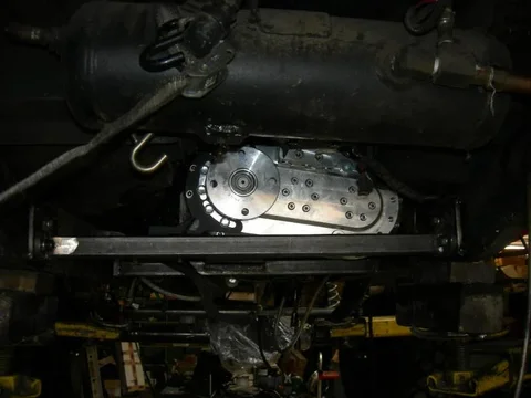

decided to use this late model tank because of the emision lines I will use for a fuel return and vents
scribed a cut out line

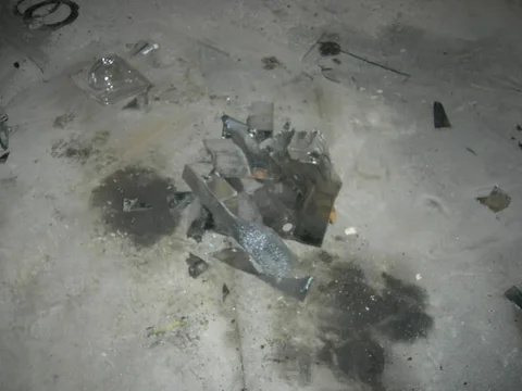

defumed tank then cut into it
fits pretty good.
I think the stock tank is 18.5 gallons and after cutting out tank I think I will only lose about 4 gallons give or take

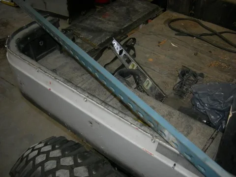

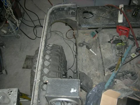

started working on the rear body
the plan is to dovetail the rear
the first pic is approx angle of the dovetail

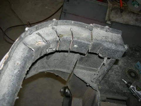

The liner is toxic when it gets hot/melts
cut the wheel well out of the passenger side
drivers side
